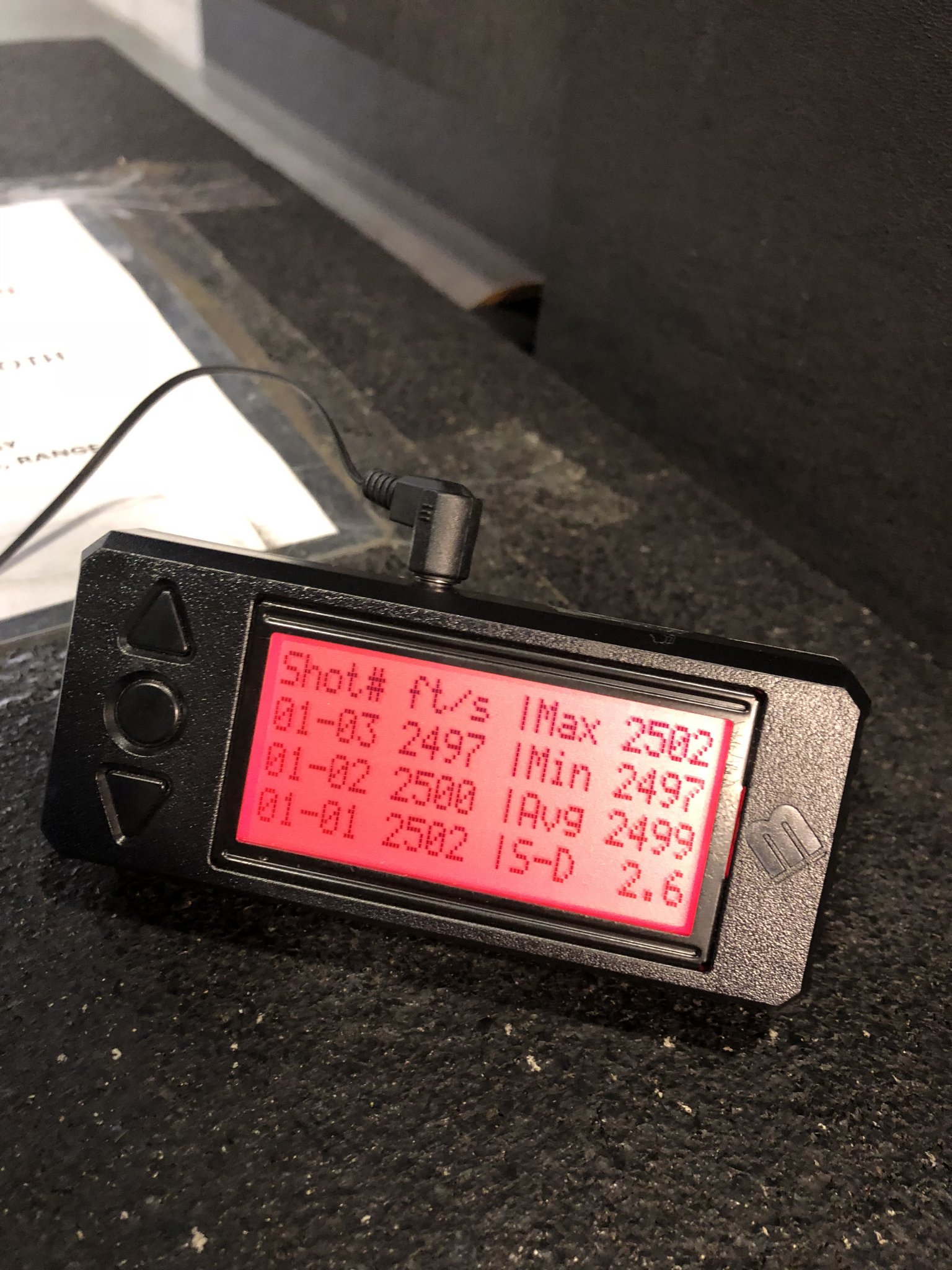

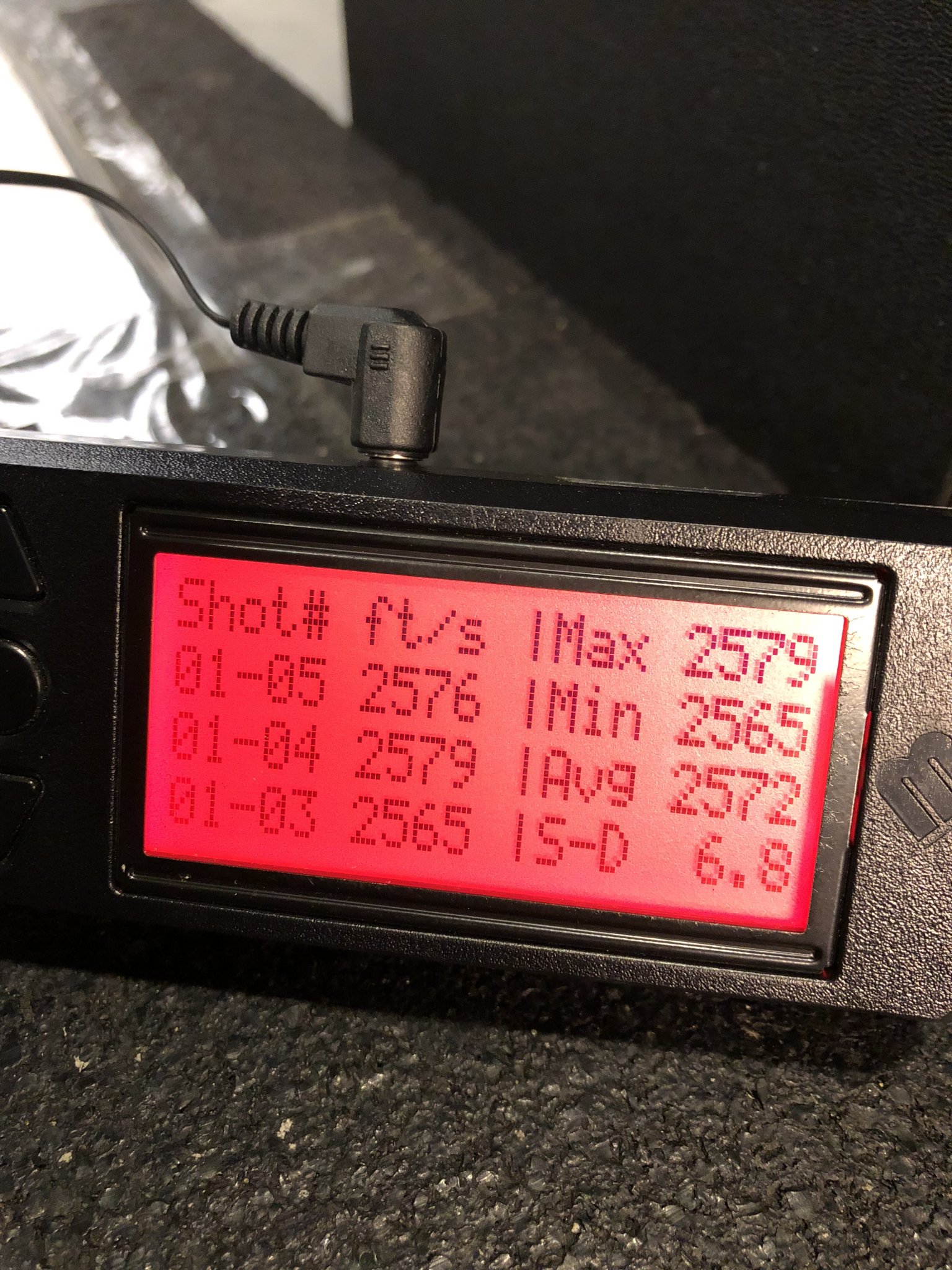

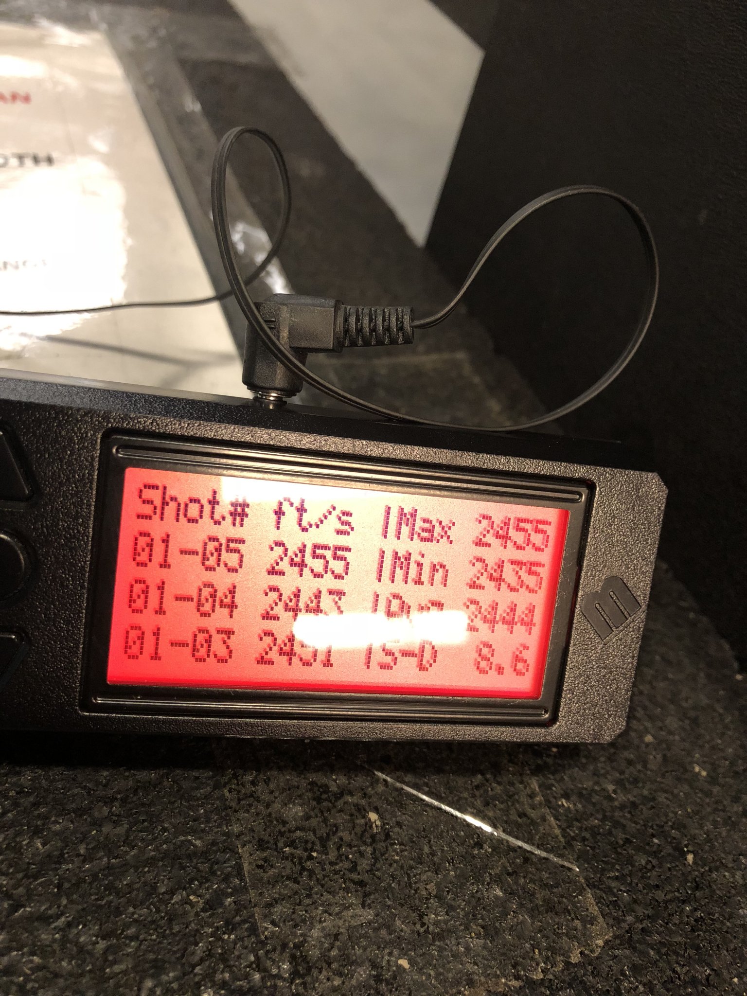

I’m not affiliated in any way. But I’m totally impressed. I bought two boxes (100 total) of Peterson small rifle primer 6.5 CM brass. I just wanted to try it out and needed a little bit of brass but wanted to try it before I committed fully. I paid $72.xx shipped from Eurooptic after a coupon I had. I’m not normally a weigh and sort my brass kind of guy. But for kicks I weighed 30 of them. Less than 1 grain spread. 168.8-169.7 and most of them were closer to the 169.1-2 mark. Very consistent. All the mouths were perfect because of the way they package them. Made in the USA too. Love that.
On to the shooting.
16.5 inch Proof Carbon 1-8 twist 6.5CM in my Q Fix rifle.
Load development landed right around 40.8 grains of RL16 with a 147 ELD M and a CCI 400 primer. Speed was right at 2500 FPS or so with an SD of 2.6. I’ve fired this brass 3 times and it’s awesome. Very consistent. Check it out. I feel no need to pay Lapua money.

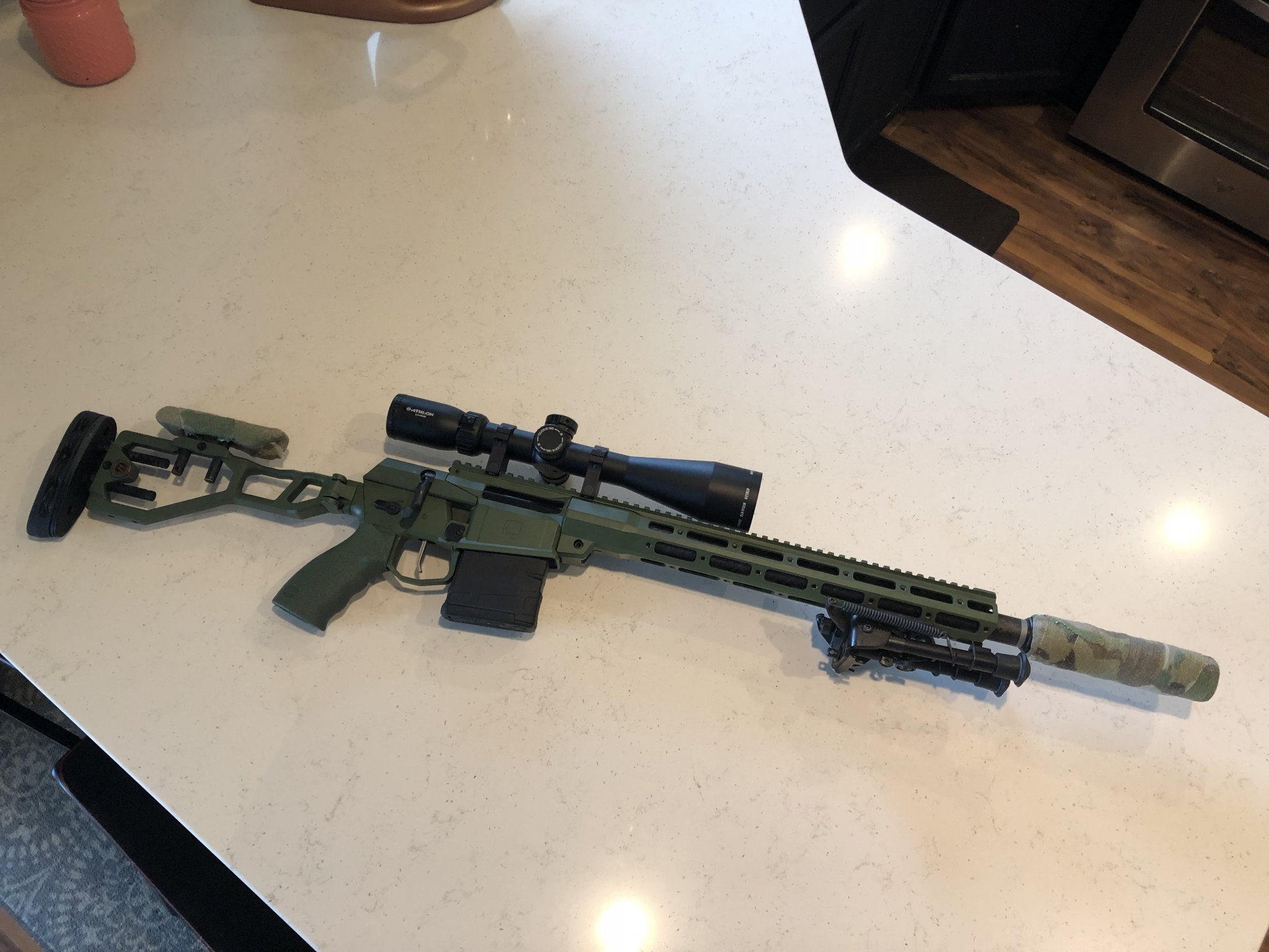

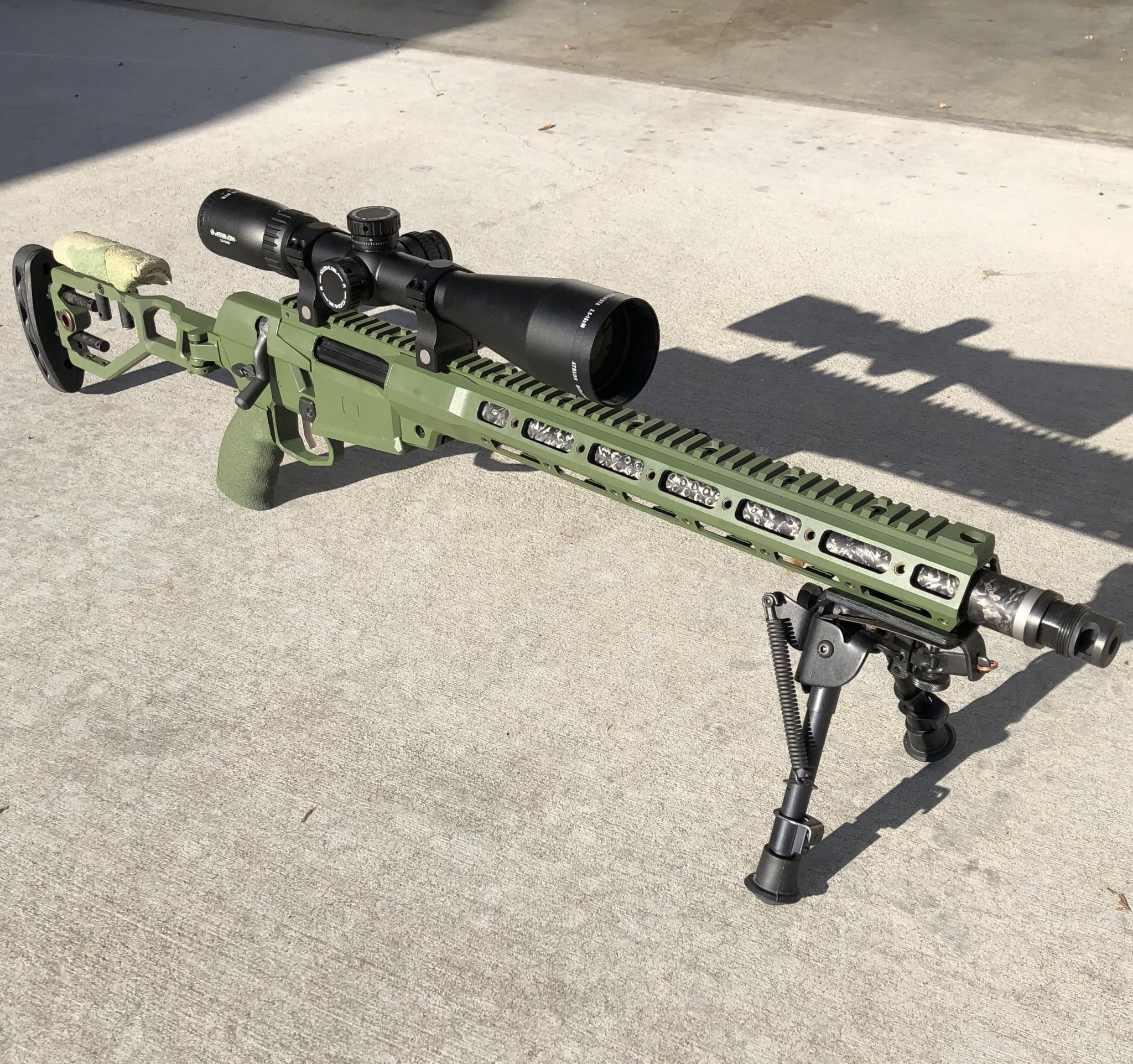

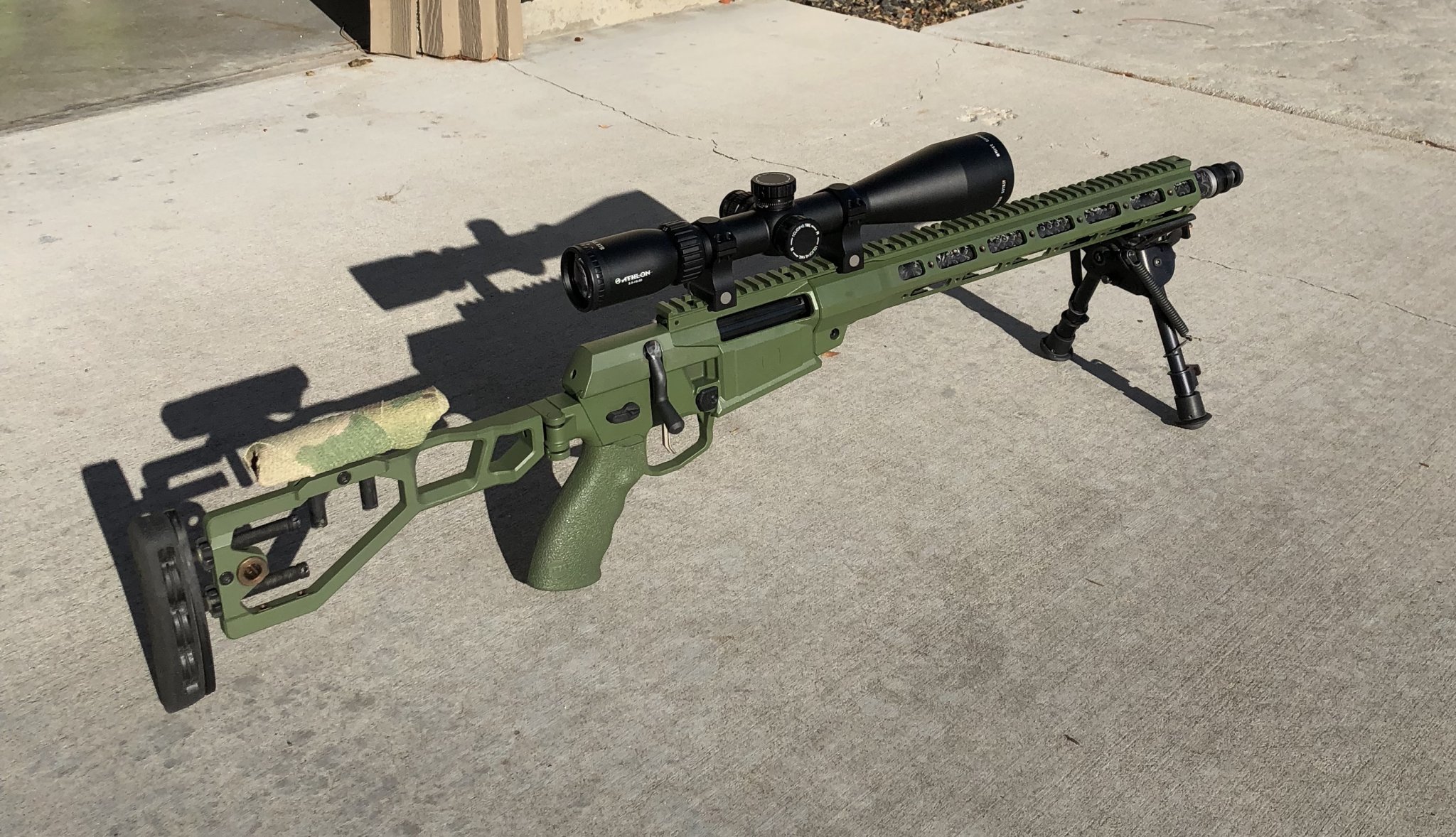

Got any pics of your rifle? I'm curious what a 16" Proof looks like.
Proof barrels are legit

I don't get this SD 2.6 when you fired only 3 rounds. What was you SD after 20 rounds?

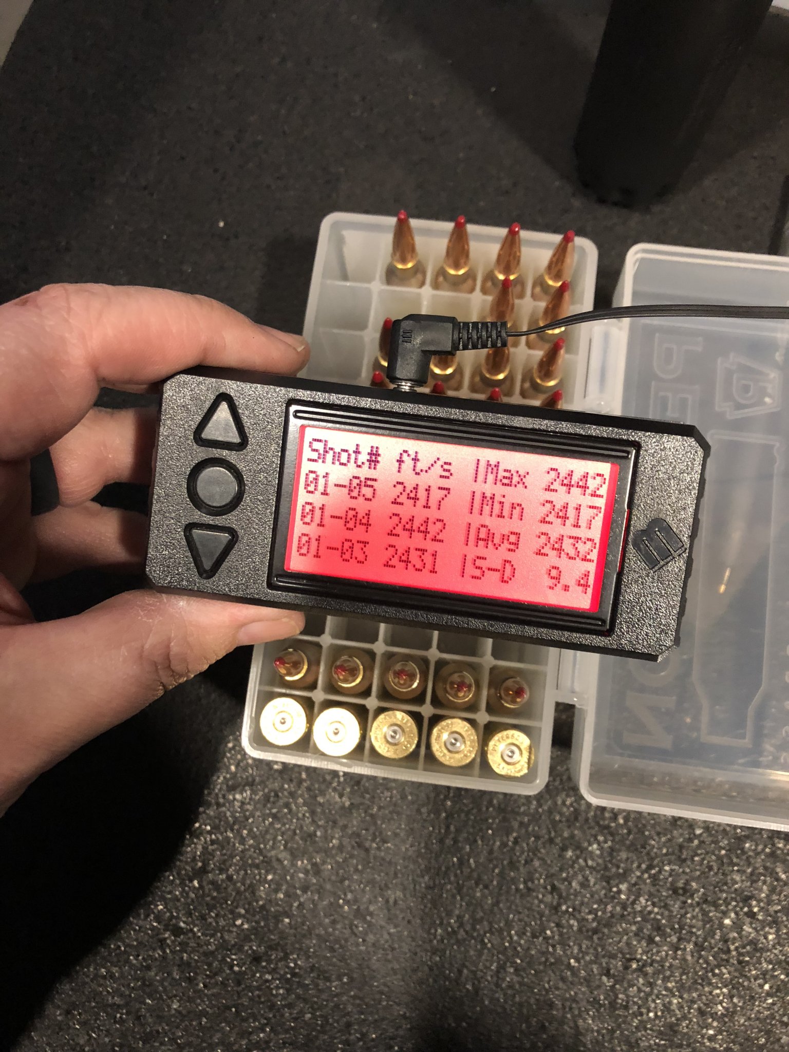

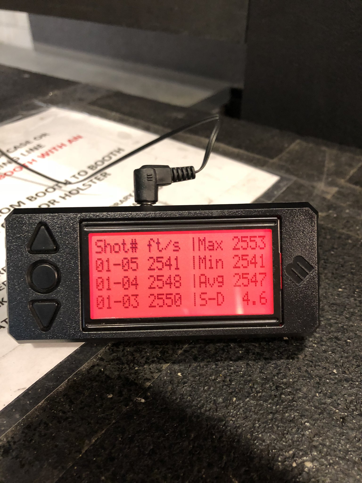

The load development I’m doing on this new barrel and brass I’ve only been firing 3 to 5 loads at each charge weight. I’ve got more loaded up to test again. But the loads have been consistently single digits. I’m happy with it.

My loads are for 10 shots as I don’t think 3 will give you a valid velocity. I would have run 20 but I had 10 left so that is what I did. This load has been shot to 1345 and tracks right on with my Sig 2400
