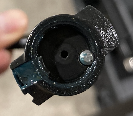

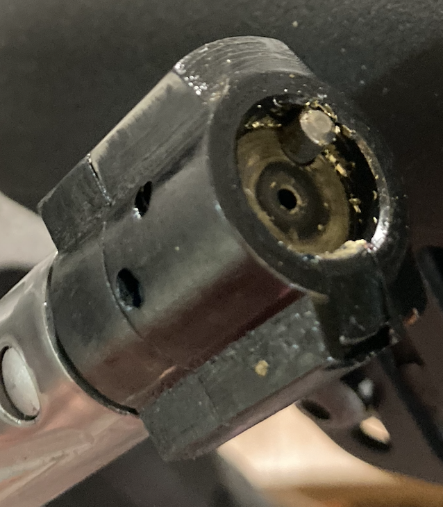

@dmuffman80 Before and after pics of the bolt head. I clean off the grease prior to shooting.

and that guy has a .296” fired necks. More clearance than you have and the same problem. Have you tried other brass?

Yes, similar experiences, though im not having any stuck or sticky bolts.
Previous brass I've use have been Hornady and Norma without any concerns/signs of pressure.

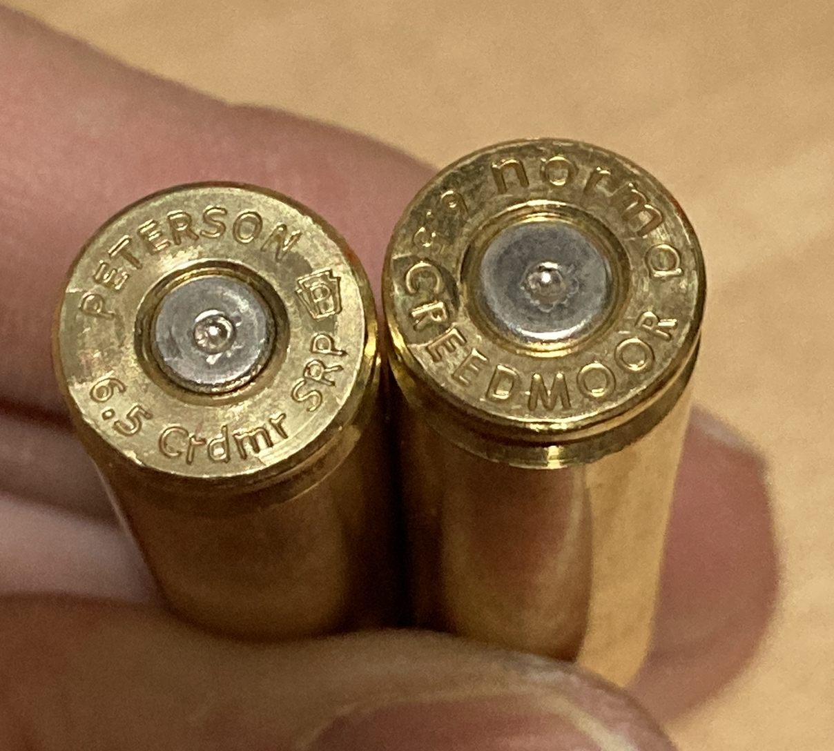

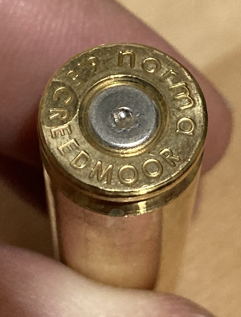

I went back to the range today, and ran some more tests. I brought with me some factory Norma 6.5CM (i forgot to bring some factory Hornady 140 Match) and another load of the Petersoon brass with Hornady 140 ELDM and H4350
After carefully inspecting the the heads of the Norma, I could see the marks left by the ejector. To keep things consistent, I measured the necks on the Norma and Peterson:
  • Norma Fired Outer neck = 0.2945
  • Norma Factory loaded w/ bullet neck size = 0.2920
  • Peterson Fired Outer neck = 0.2945
  • Peterson loaded w/ bullet neck size = 0.2925
Dropping a Hornady 140 ELD-M through the mouths of the fired Peterson was fine. Needed a little aligning but they went down. Norma fired brass was not going down.

You have neck turning in your future.
It's looking likely.
Not sure if it's worth it at this point, but i lean toward staying safe than anything else. The (factory) barrel has 1300 rounds through it, and its about this time that i started seeing these signs. Fouling? A re-barrel should be sometimes this year.
