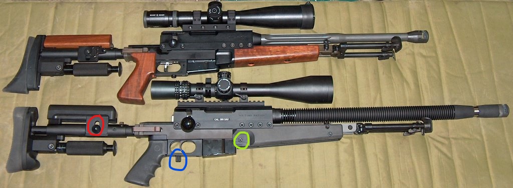

Hi,
DISCLAIMER!!!!!! I have not put my hands on a PGM in about 8 years so the below things may have been fixed, I doubt it because I know the original designer.
The issue with barrel change is not how fast it can be done but more along the lines that 4 hex screws and pull barrel out procedure is not modern. The original designer of that process calls it the screw and grip....They need to put better indexing points not only on the barrel extension but inside the receiver too. It is literally a slot cut down the bottom middle of receiver that flexes open and screws hold around the inserted barrel extension.
Buttstock and Cheek Piece...while they do adjust, they adjust very little compared to modern rifles.
AND...personally...I just cannot support a firearms manufacturer that imposes its' own ban onto the market. PGM (They blame France Gov) will not allow their BMG to be sold to the USA civilian market.
Edited To Add: (Figured pic would help, lol)
Red highlights that cheek piece is barely at 1" adjustment range.
Blue highlights the mag release is not conducive to pressing and pulling magazine in 1 motion. It is way too far from the magazine.
Green highlights the forend by its attachment nature HAS to flex due to the single screw attachment method. I have spent the past year testing forend attachments and that one absolutely sucks, lol

ok, so made a typo there. I meant to say the rifle has not had many changes in 30 years i believe. They have added a rail on the right of the 4 hex screws.
this rifle does have a special place in my heart as my grandfather, a Spaniard, fought in the French foreign legion in France's vietnam war. So i like the idea of a nice French military sniper rifle.
However, I expect the rifle to perform on par with some of the best offering today, because at the end of the day, it's performance over a collectible relic.
You really seem to know your stuff, appreciated, I am gonna jump on your Hoplite thread.
