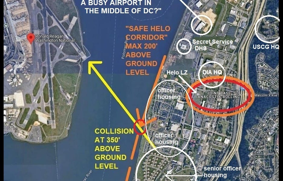

I landed at KDCA last night 40 minutes before the crash. Looking at the available info, JIA5342 (the CRJ) was cleared for the "Mount Vernon Visual Runway 1". When they switched to DCA Twr frequency, the Twr controller asked if they could accept RNWY 33. JIA5342 accepted and they were cleared to land RNWY 33. The Twr controller told PAT25 (the Blackhawk) about the CRJ traffic, it's location, and to maintain visual separation. These communications between the Twr controller and the commerical and military aircraft took place on two different frequencies simultaniously.
From what I can tell, I'm guessing that PAT25 probably thought another aircraft on final for RNWY 1 (AAL3130) was the traffic it was avoiding. This has been a huge problem in aviation for decades. Ironically, a PSA 727 colided with a Cessna in San Diego in the 1970's under similar circumstances. ATC is generally fantastic, but they are always pressing pilots to "call traffic" so that seperation becomes the pilots responsibility and not the controllers.
What I can't stop thinking about though, is how the Twr controller clearing JIA5342 to land on RNWY33 put them on an intersecting path with PAT25 that was on specified route. All at night, at low level, and in congested airspace.

Best info and summary I’ve found so far:
TLDR: ATC put these aircraft in a situation where they would be de-conflicted by a couple hundred feet vertical separation at best.
Helo declared visual separation but almost certainly was looking at a different aircraft, and also popped up above his max altitude just before the collision. RJ was on the correct approach, but may have dipped slightly below the ideal glide path…still within the envelope/cone for that approach though.

I attribute zero blame in this to ATC. Vis 1 Circle 33 is normal RJ ops at Reagan.
Helicopter was twice told to maintain visual separation. Despite the CRJ being lit up like a Christmas tree the helo didn't, and in combination with the helo being where they weren't really supposed to be, 67 people died.
The end.
ATC followed procedure, and passed separation responsibility to the helo crew, but that’s too simplistic to say they played ZERO role in it. We all know mishaps aren’t made up of 1 factor…but several.
Directing circle to 33 knowingly put the airliner beak to beak with the helo, at night… then ATC allowed (helo requested it, assuredly as their normal procedure to prevent getting delayed over and over while flying their usual “VIPs” around DC) ALL deconfliction responsibility on 1 entity looking at thousands of lights, including several airborne. “ATC gave sole responsibility to…” is a little too technically ‘washed my hands’ for reality.
Helo appears to have broken the 200’ ceiling, which is just another hole in the Swiss cheese. A major error, yes, but alone doesn’t cause the mishap. I’m willing to bet they (errantly) climb while visually locked on the (wrong) airliner…which means they aren’t looking at the correct airliner, nor their instruments. Their sole focus is avoiding the airliner.
Asking someone if they see traffic assumes they ALWAYS see the same traffic you’re asking about. This works until it doesn’t…which is why it’s retarded at night without some other form of confirmation (which doesn’t work with 2 entities that aren’t communicating directly).
The real question…why has this known risk been accepted to the point of “normal.”
If the helicopter was actually on Route 4 (laterally and/or vertically), the accident never happens.
If the helicopter actually sees and maintains visual separation from the CR7, the accident never happens.
Again, these are normal DCA Vis 1 Circle 33 RJ ops that have happened for decades...why an accident now? Because the helo was where they never should have been and didn't maintain the separation they said they would not once but twice.
My critique for the Army EP who (seemingly) allowed a 50% bust on route altitude around inbound civilian airliner traffic without saying anything is for another day.
“Pass behind CJ” means fly the aircraft, not stay on the route laterally. We’ve already acknowledged the vertical error as a major contributing factor. I also explained why it likely occurred.
Asking “do you have traffic in sight?” more times doesn’t increase its effectiveness…they’re STILL looking at the wrong traffic. The controller’s intuition was telling him that very thing, hence asking again. Instead of more comm burden, I’d suggest better would’ve been “Your interval is at YOUR LEFT 11 O’CLOCK, 1/2 mile”, which would immediately inform the helo crew they’re looking at the wrong aircraft. Even better, “TURN LEFT 160 IMMEDIATELY, TRAFFIC 11 O’CLOCK, 1/2 MILE.” Yes, this isn’t REQUIRED as sole responsibility was granted (by helo request to avoid delay to their flight) to the helo, but that doesn’t mean ATC no longer has the ability (with the only God’s eye view) to help.
Again, asking for / granting visual sep in busy airspace AT NIGHT is retarded. There’s a reason it was accepted as normal.
