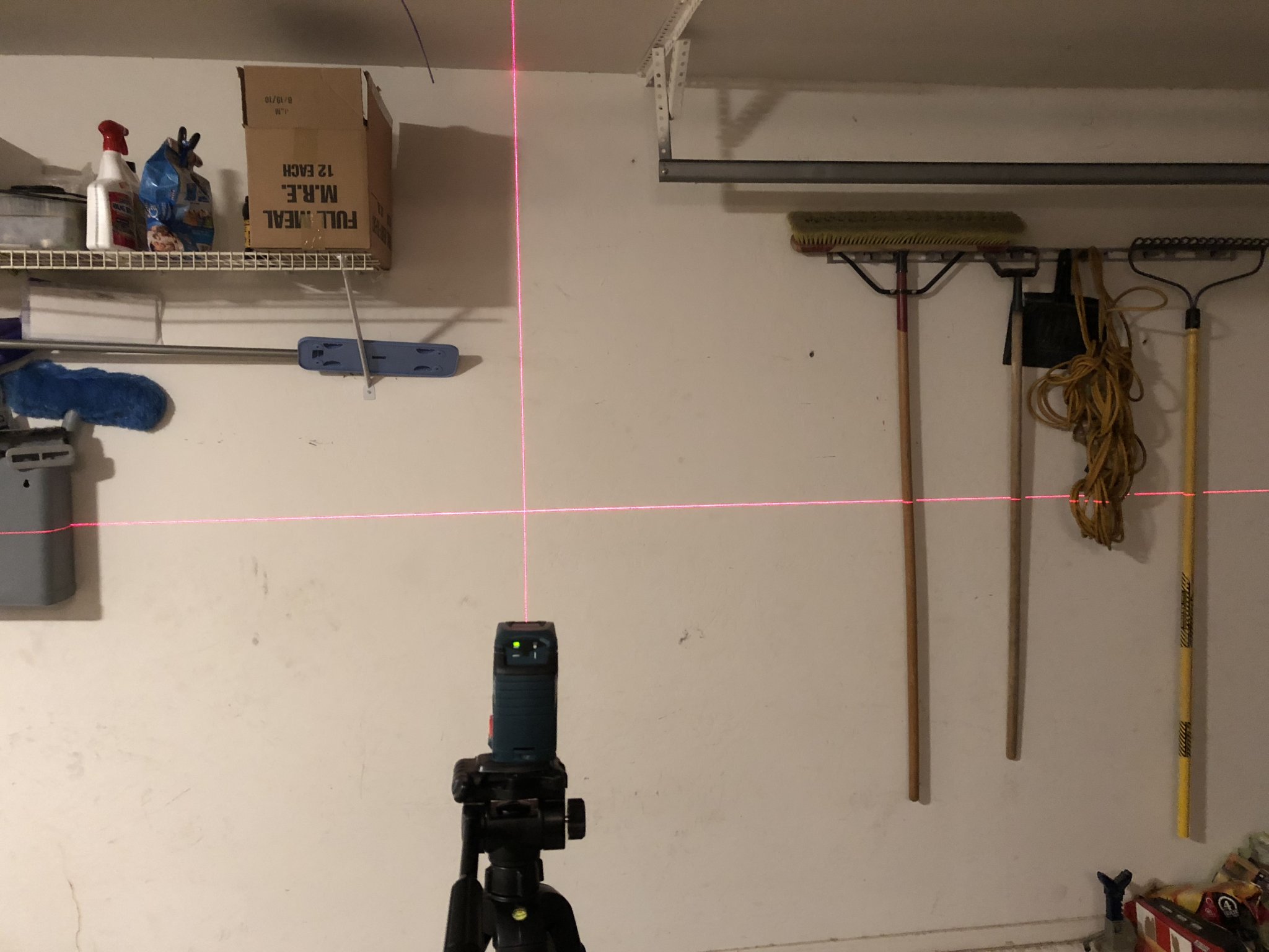

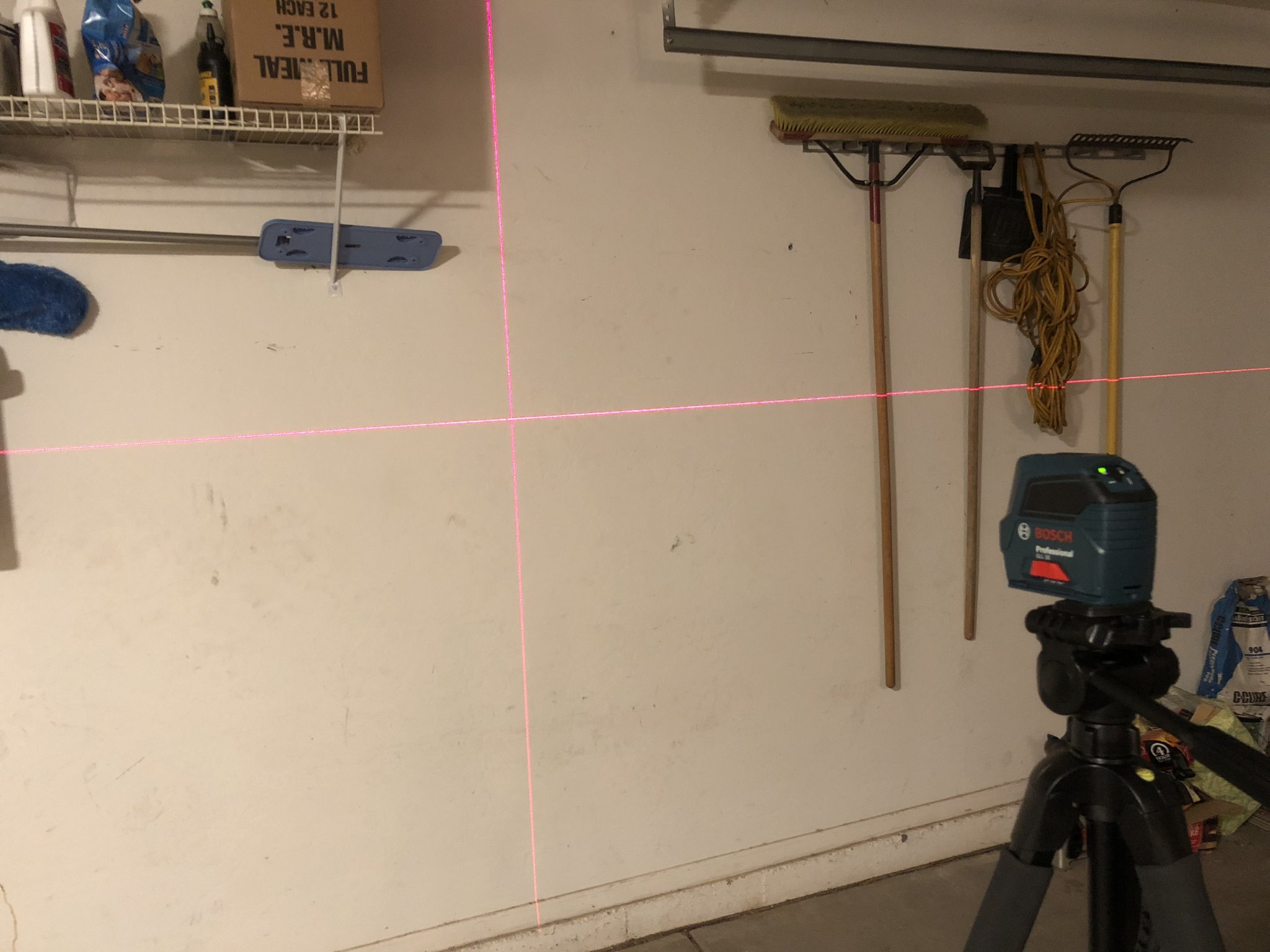

    What model is that?
    This is the exact one I have, but I paid for the 360 degree option when doing work around house
    https://m.lowes.com/pd/Bosch-65-ft-Laser-Chalkline-Self-Leveling-Line-Generator-Laser-Level/50285089
    But they make a hundred different models with varying features... And anything with the two axis should work fine and save a few bucks if only buying for this purpose
    For example
    https://m.lowes.com/pd/Bosch-50-ft-Laser-Chalkline-Self-Leveling-Line-Generator-Laser-Level/50273919
    https://m.lowes.com/pd/Bosch-40-ft-Beam-Self-Leveling-Cross-line-Laser-Level/1000237835

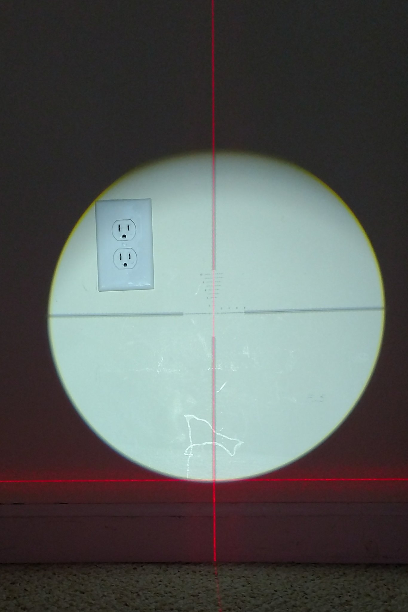

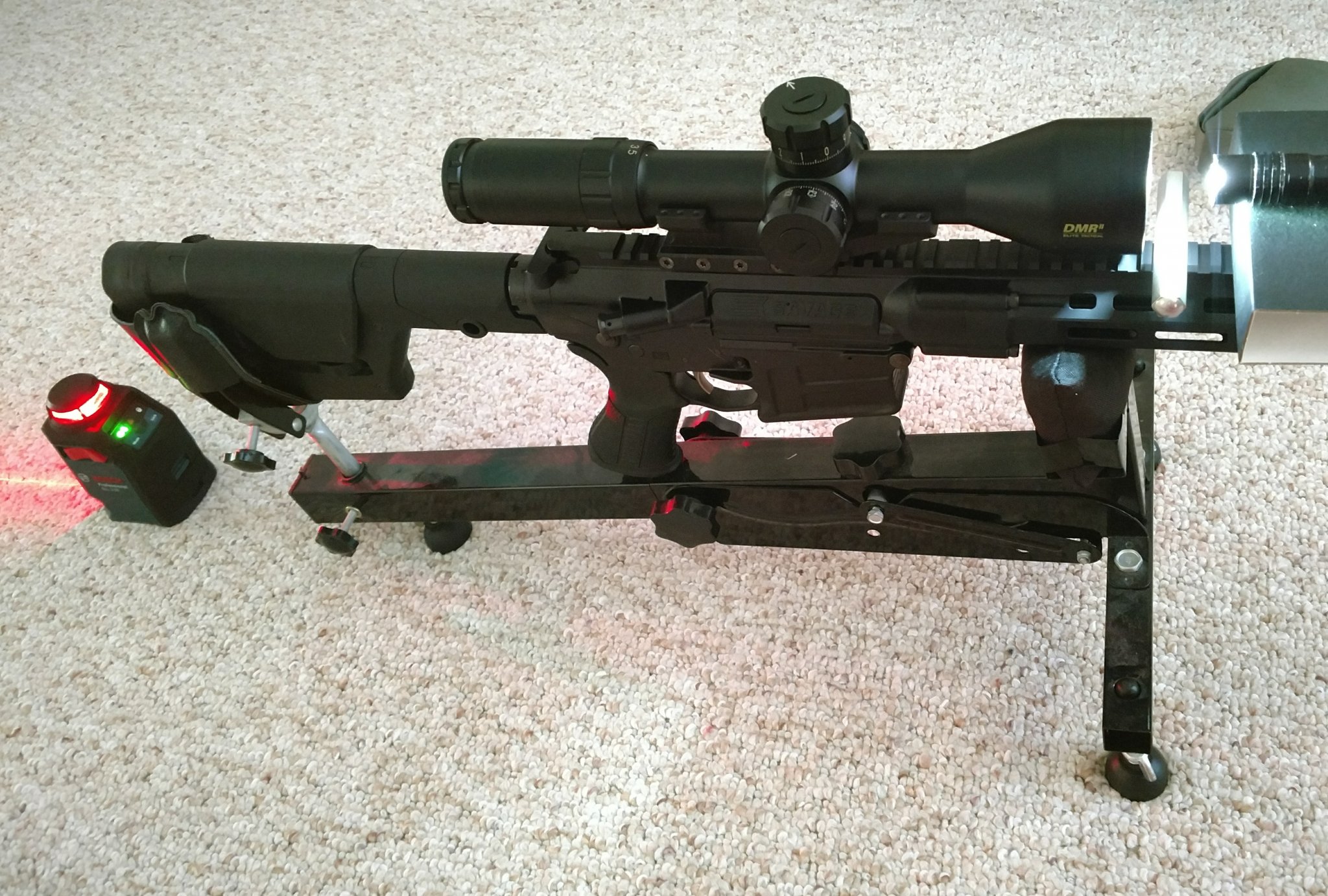

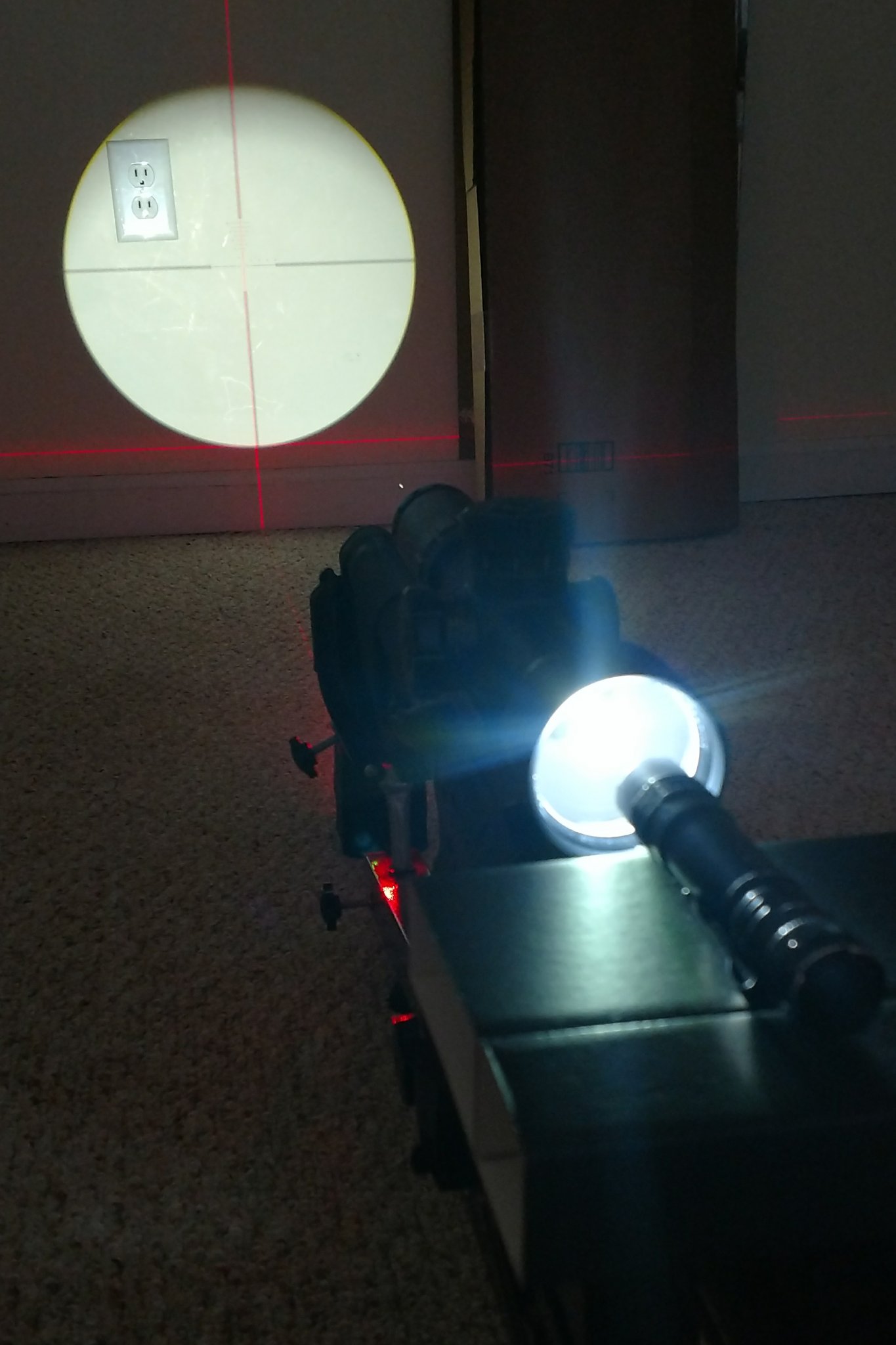

    While were on the subject, I use the flashlight through the objective method myself. I noticed the other night that the Spuhr leveling wedge didn't quite get it done for me on a S&B I mounted. I put it up for the night, and am going to get it back out of the safe tonight and finish the job. I have a question though. Is it ok to use the level in the Spuhr mount as a reference point for the receiver being level, or should I get a small level and place it on the receiver itself when finish up this evening?
    I've always used rings in the past, so the level in the Spuhr is whats throwing me off in trying to think through of the best way of doing this.
    Thanks fellas.
    I like a 3' carpenters level, use it to verify the Spuhr level, set a small level on top of 3' level ..... never ends. :)
    Never found a Spuhr level to not agree with the carpenters level.

    Just picked up the RRS Scope Leveler to try out, save some money using rings.
    I just ordered those, too. Stupid simple idea! My process has involved a surface plate and Tubb Bubblevel.
    I think I've got one of those laser levels and will use that to verify my setup. Fantastic simple idea if you've got one.
    Hate to burst your bubble guys. But you've got to level off of your elevation housing. If you level off your reticle and it has some cant in it (manufacturers have a acceptable range for reticle straightness) you will be inducing error as you dial up for elevation as it dials in line with the housing, not the reticle itself. Checking the reticle is only a good method after youve leveled off of your housing to make sure your reticle isnt canted from the factory to a point outside what is acceptable.
    Not bursting my bubble, but two different problems...
    Level reticle this way then shoot a tracking test. If it doesn’t match the scope is going back to whoever made it.
    You put your reference line up for tracking test (another thing the laser level works well for btw, then hold reticle level with the line and shoot tracking test) and see how far the reticle differs from the the turret tracking
    The machining fit between various turret assemblies can have some misleading machine tolerances in them as well.... If you want To use the scope, then use the bottom of the scope not the turret cap.
    There are 100 ways to approach a problem and they each have their benefit and downfall, doing them in this order gives me a method to measure error of each part of the equation
