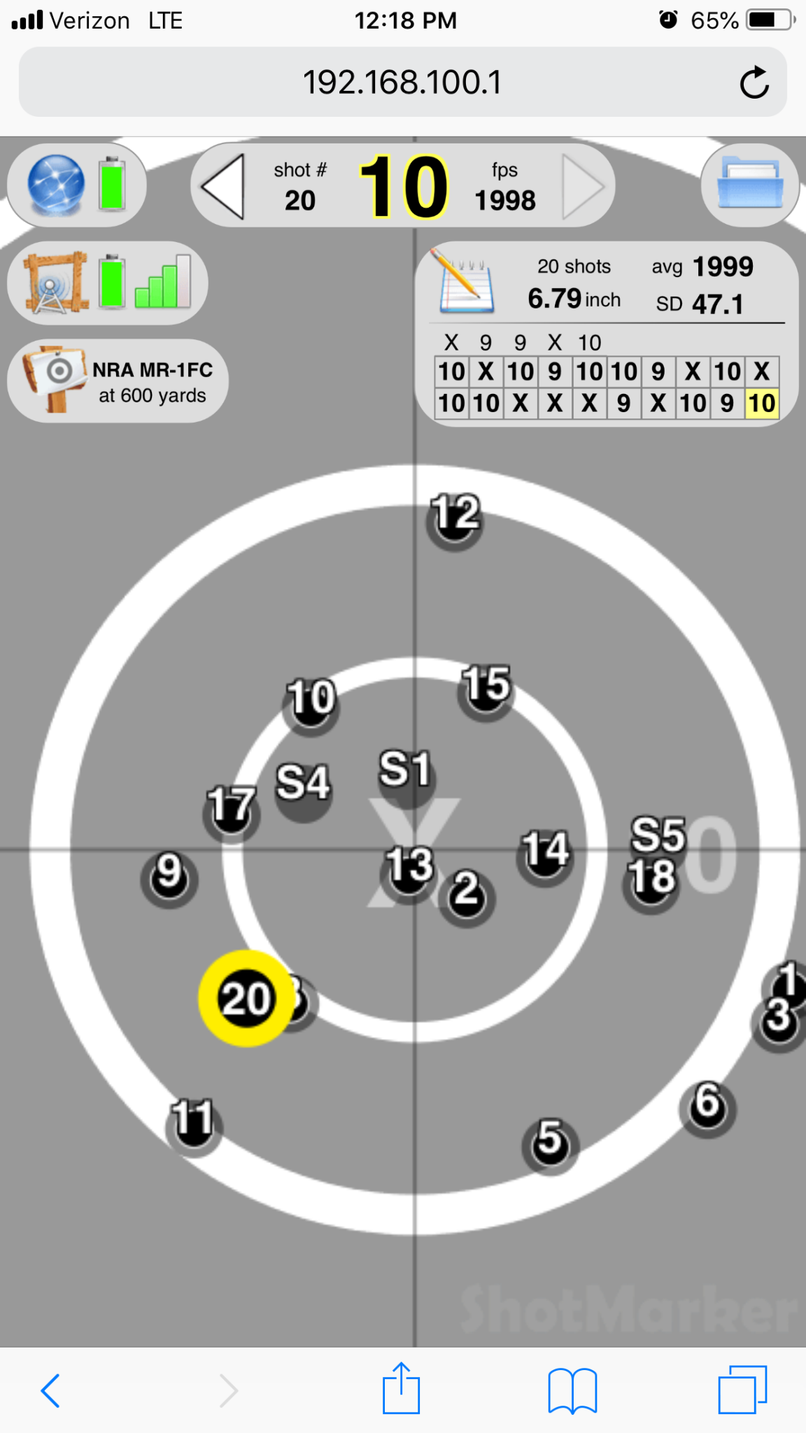

    This is a group I shot fireforming for my prs match gun last weekend in the wind and cold. I did not answer the poll because I cannot hold every shot within .1. I can however get an accurate average.

    This is not entirely true. Even in consistent conditions, most shooter’s groups open up considerably at distance.
    Frank mentions this a lot.

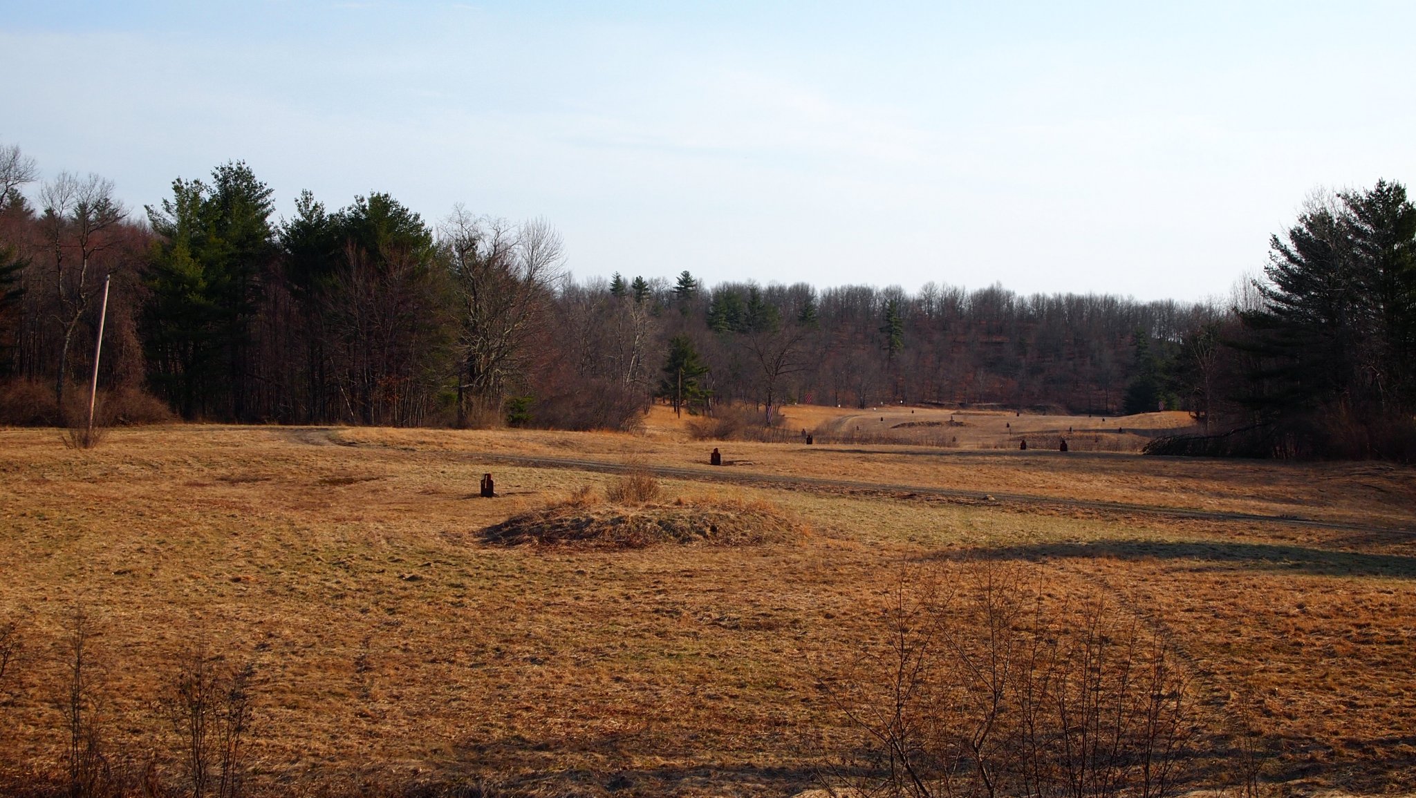

    One of my life endeavours is to shoot here...
    Its kind of a storied range on the local mil base. Steel out to 1000 meters. Twenty targets.
    A perfect day would be my .308, one box of FGMM 175.
    Draw up a range card, mil the plates through the scope, eat a sammich, attempt twenty first round hits.
    Torso plates so every things bigger than MOA.
    Holding to the .1 mil wouldn't be necessary but 20 rounds 20 hits would be a challenge for me.
