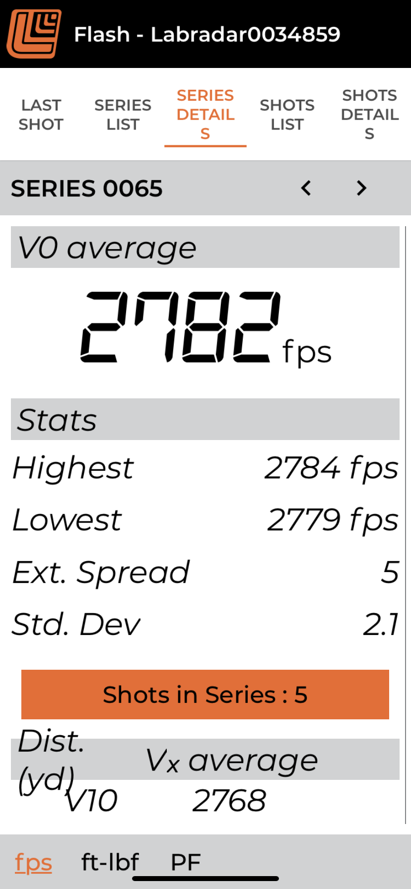

Here’s the node I settled in at:
26” DesertTech
42.2gr H4350
140ELDM
Lapua brass
Remington 7 1/2
2780

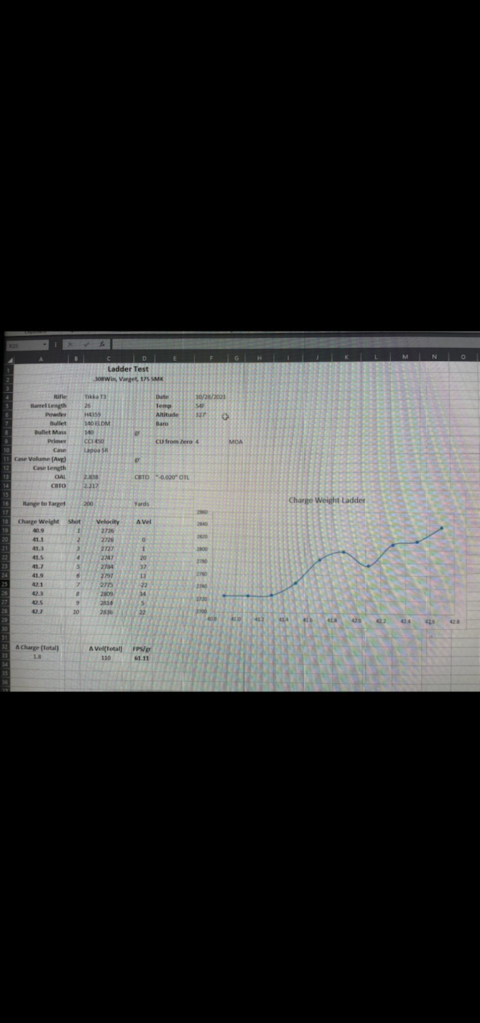

This is data we got out of my Tika with a 26" krieger barrel. I am redoing this test with fired brass since this one was done with new but with 3 shot groups on the low end 40.8 to 41.6 since I had very little deviation on the low end.
I am not understanding why, but I am getting better results with less.
Terminus Zeus
26" Proof Barrel
SMK 140gr
H4350 41.2 grs
Alpha LP Brass
CCI 200 Primer.
2,810 FPS
It does not seem to matter what brass I am using or primers for that matter. It stays the same.
Anyone have any idea why I would be as fast as guys shooting 42 to 42.5.
Terminus Zeus
26" Proof Barrel
SMK 140gr
H4350 41.2 grs
Alpha LP Brass
CCI 200 Primer.
2,810 FPS
What are you measuring the speed with?
This is highly dependent on the components being used and your lot of H4350.
I developed a load of ~2830 fps with 140 Berger Hybrids using 42.5 grains of H4350, Lapua SRP brass and CCI BR4 primers.
No pressure signs, runs about the same velocity as factory Hornady 140 AMAX's through my 24" barrel. Can't guarantee my recipe works in other rifles with different components and H4350 lot numbers.
Terminus Zeus
26" Proof Barrel
SMK 140gr
H4350 41.2 grs
Alpha LP Brass
CCI 200 Primer.
2,810 FPS
because of a hundred possible reasons
Reactions: FuhQ and Jakeweb09
Terminus Zeus
26" Proof Barrel
SMK 140gr
H4350 41.2 grs
Alpha LP Brass
CCI 200 Primer.
2,810 FPS
One reason is you have a 26” barrel which is longer than your typical 22-24” barrel used for this cartridge.
Another reason is that your chamber is tighter than theirs. Tighter means less case volume because the case can’t expand as much.
Their powder could be slower burning than yours. Slower lot means less pressure per a given charge.
Small vs large primer. Small primer, less pressure so you can add more powder.
Weather.
Alpha cases are heavy. So you’ll get a little more velocity just from that.
Blah, blah, blah.
Hornady brass is great, btw. I like it a lot. I don’t have any issues with it.
