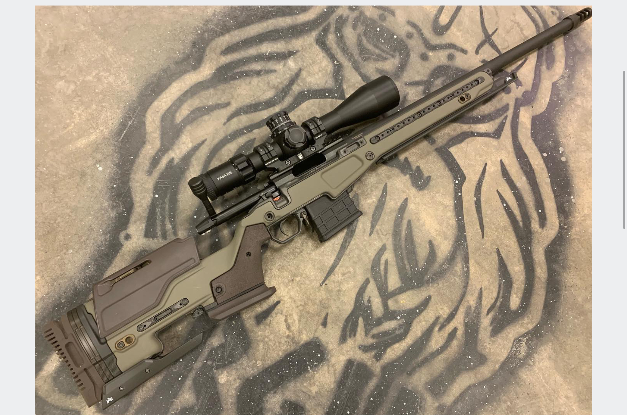

Bought a used JAE-700 for my comp rifle, had never seen one in real life before as it's super rare on this side of the pond and just had to have it.
That build quality is hard to beat, and it got quite a few innovative things going for it.
Not tested it yet tho as i'm still waiting for the new optics for the rifle...
But from just playing around with it at home, i'm pretty sure i will buy another one for the next build when MDT gets them to the market.
I do hope they add some threaded screw holes or keylocks at the fore end for weights, that's the only thing i'm missing as it's quite back heavy even with the original super long(6" i believe) Arca rail. Still trying to figure out a way to solve it on my chassi, without drilling and tapping holes.

I saw now that It has predrilled holes in the metal part of the fore end, so just need to drill the polymer and make custom fit weights for it. Also looks like a cut out for nuts inside at each hole so should be an easy fix.
Impact will drop right in as well with no problems.
