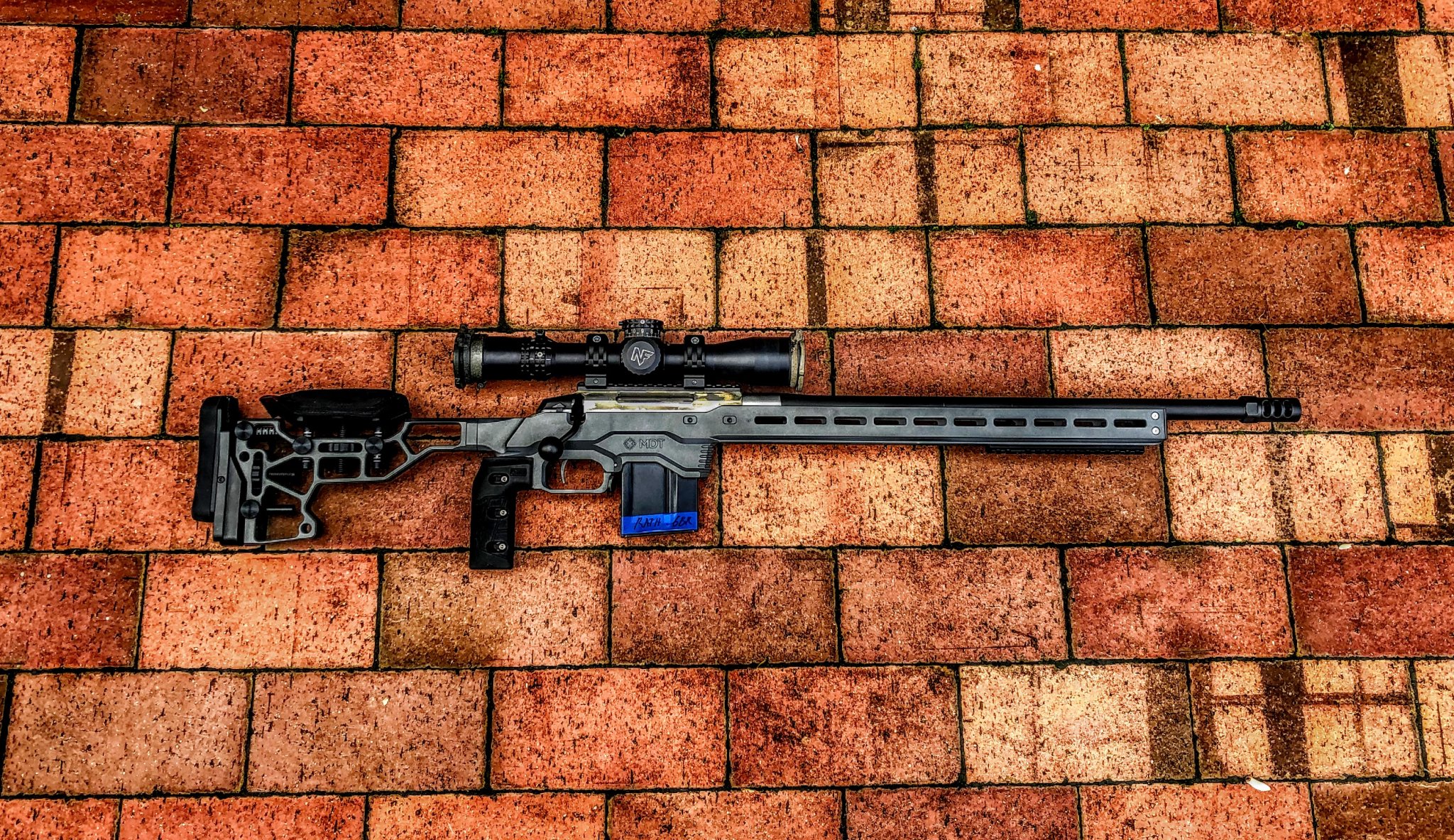

    I’m looking for a little advice, I’m toying around with switching from 6cheatmoor to something a little bit more barrel friendly but don’t know where to look. I’ve know all the 6br based stuff is the new jam but I’m not sold on them.
    I’ve been considering reaming both my 6mm creed to a 243ai and my 6.5 creed to a 260ai lapua brass for 243 and 260 much cheaper but I don’t think the barrel life will be any better

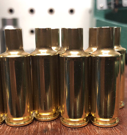

    6mm Sheldon improved is the new hot number.
    90 degree shoulder is where it's at
    The 243ai can use h1000 or h4831sc. Either one of those powders can get a nice mild 243ai load in the mid 3100s. Should be better barrel life that 6creed. You wont need to trim brass with ai cases either.
    I have a criterion remage 243ai that I ran shit hot, 105@3290fps, it still groups in the mid .3s with 1800rds. Obviously it wasnt used in prs stuff because of speed limit, but it's been thrashed on several times that it was hot enough to smoke bullets 40yds downrange. Have 400rds on it since it did that.
