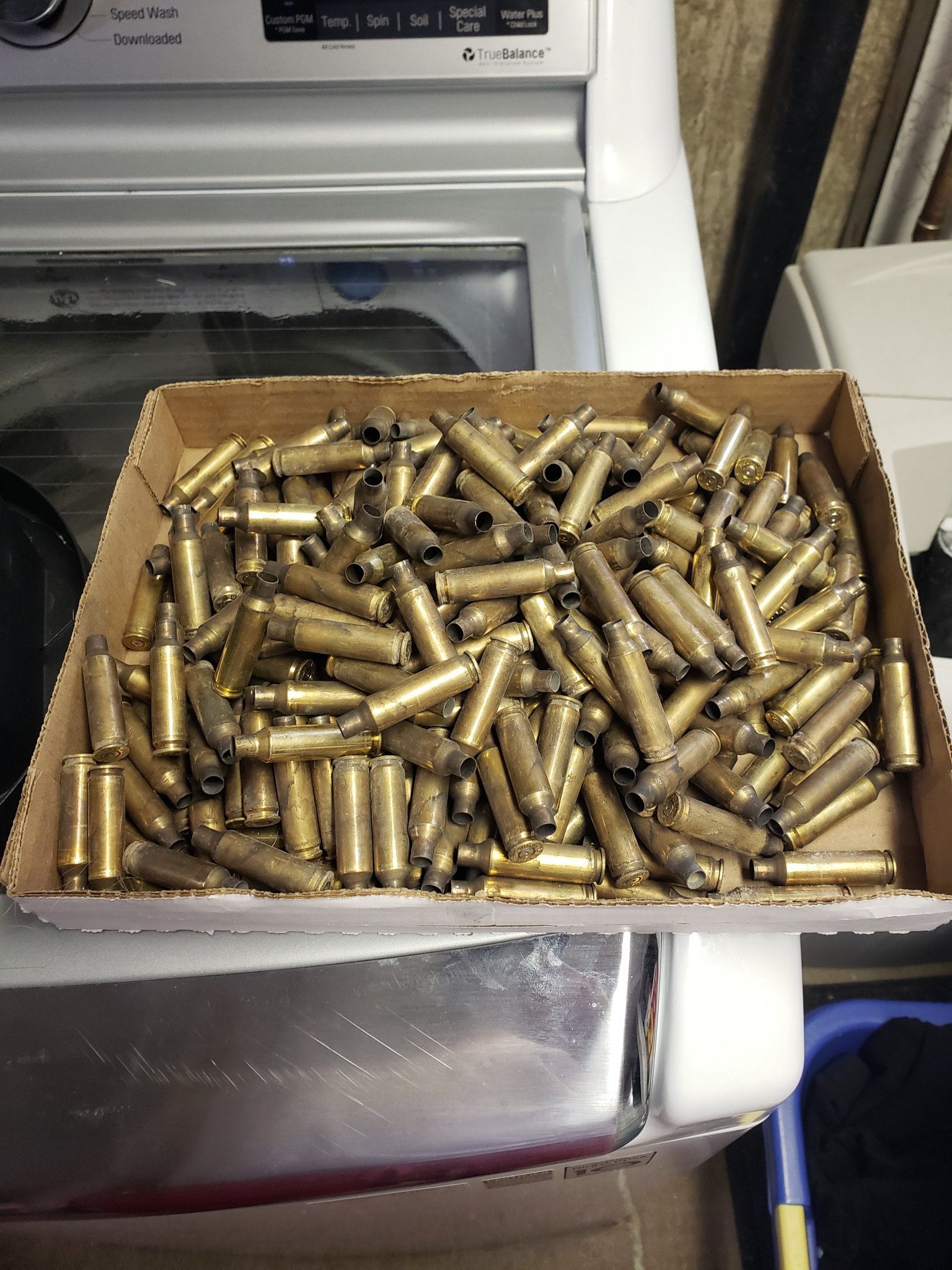

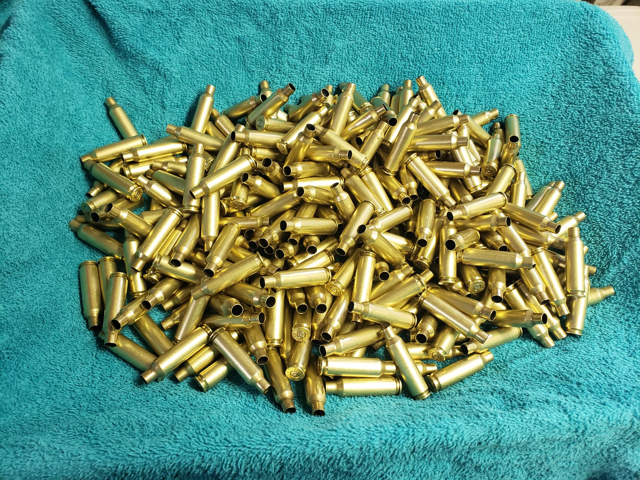

Wet tumbling rifle cartridges with ss media is retarded....
Look no pins just a pinch of lemishine and oxyclean.....but if you wanna keep dealing with ss media and all that have at it.....
Before
After
Reactions: Jefe's Dope

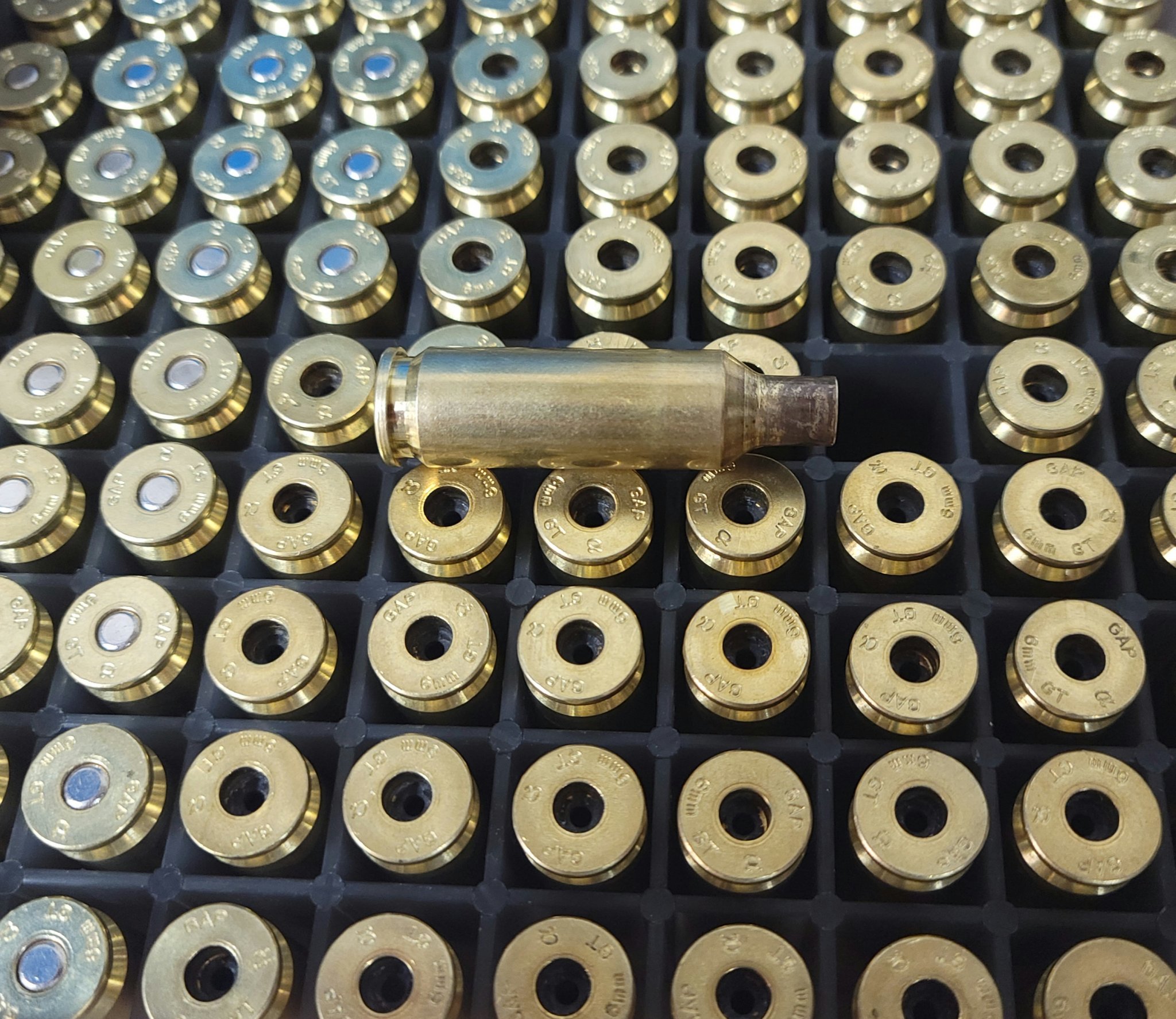

I clean and tumble as needed. If the brass has been on the ground I'll rinse it off. If I size a large lot I'll tumble off the lube with corn cob. Otherwise I just focus on what is important, which is everything besides how it looks.
Here's an example:
6GT
Turned
Annealed
Neck sIzed (.241 ID)
Trimmed and Chamfered
Less than .001" runout
Less than .001" headspace variation
Less than .001" overall length variation
Less than .0005 ID neck variation
Consistent seating pressure
SD under 10 over 100 rounds.
