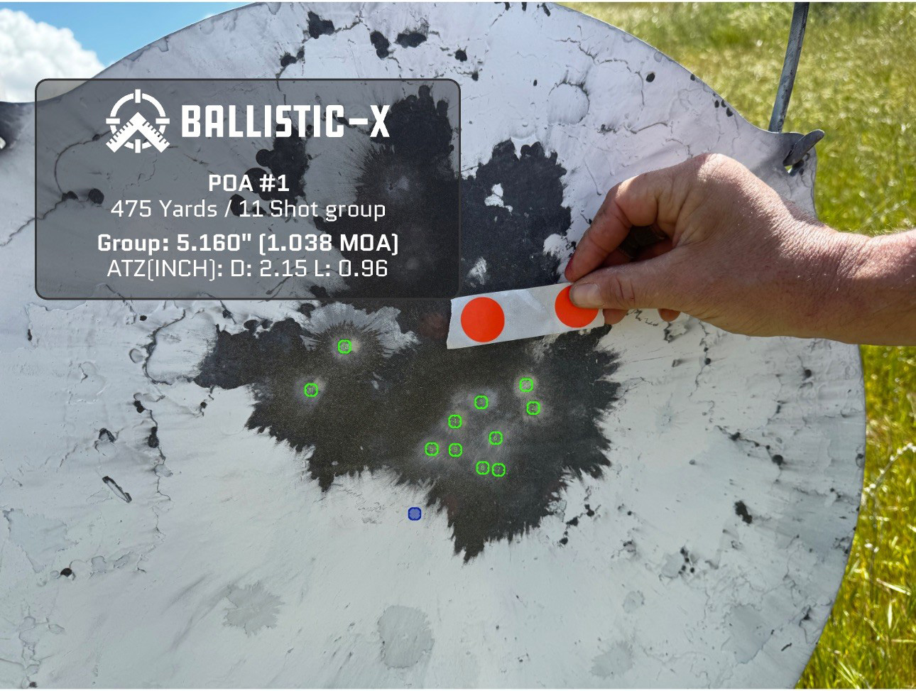

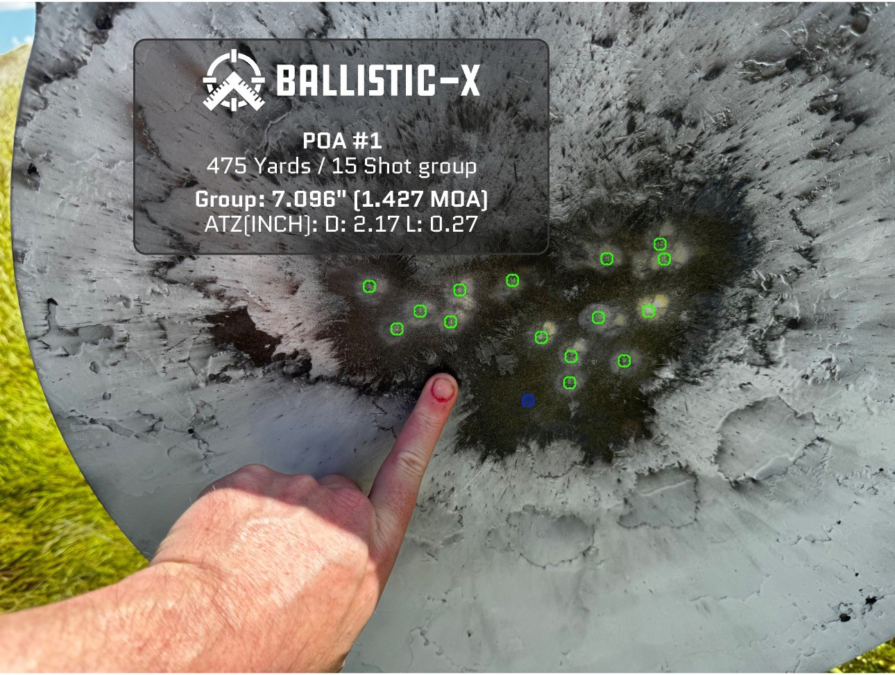

Which picture goes to which treatment? Sounds like you had three batches, and I only see two pics?
The first picture is the 13 from the lube-before-mandrel group. The second is the 15-shot, no-lube group. I didn't take a pic of standard group because it was the last batch shot and looked through the scope as substantively similar to the first one. The SD was also similar, and I didn't want to make another trip down range to paint the target - we then splattered it up with some 308.

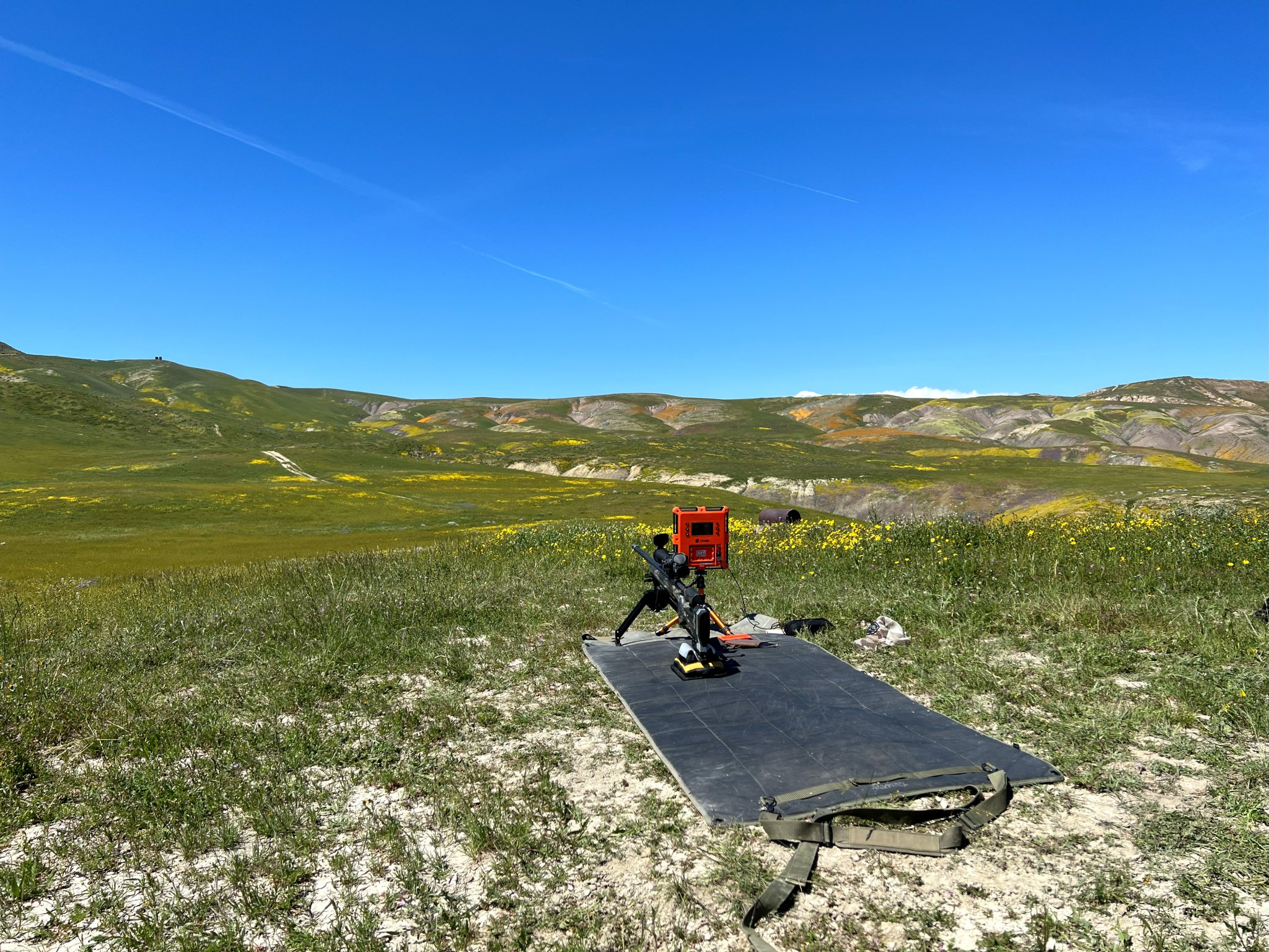

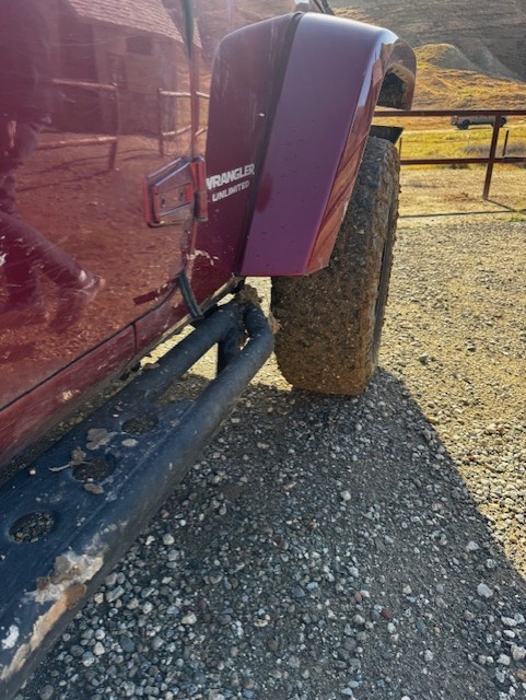

So, I was hoping to shoot yesterday in this:
Trying to get there, I got this:
When you're going up hill on a shelf road in 4WD low, and you're doing so sideways because you have no traction due to mud filling your treads, it's time to turn around. I have to say that coming down carried much more pucker factor than going up. I don't care to do that again.
The end result is actually positive for the purposes of this thread. We ended up finding a spot just out of the hills and set a target at just under 500 yards to shoot groups.

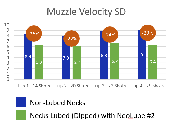

I shot 14 shots of the "champion" lube process (lube after mandrel - one bad primer in this group), 13 of the one where I lubed before mandrel, and 15 of no lube. The SD results were not surprising.
The first two came in essentially the same at the same of 6.6 and 6.3 fps respectively. The no lube group came in at 8.4 fps.
The big surprise to me was grouping. I hadn't anticipated doing anything group related, but due to my near-death experience on the attempt to get to our normal shooting spot we had the "opportunity" to do so. Below are pics of the 13-shot group and the 15-shot no lube group.
On the 13-shot group these were the first we shot of the day. My scope had gotten away from zero and the first shot was high, I adjusted for the second (still too high), then shot the remaining 11. The results are below:
The dispersion on the no-lube group is measurably higher than the lube group. I frankly didn't expect this. I expected some SD difference (which we got, but not this much dispersion difference.
Could this have been wind? It was maybe 3 - 8 mph all day, so I don't believe wind alone could be responsible. Could it have been me? Yes, I'll never rule that out. I'm not ready to make any conclusions based on this, but I may go run another test at a similar range - where I can actually drive to the target to paint - got to say that hoofing it 500 yards up and down stream beds and along steep terrain just to paint the target was not the most enjoyable.

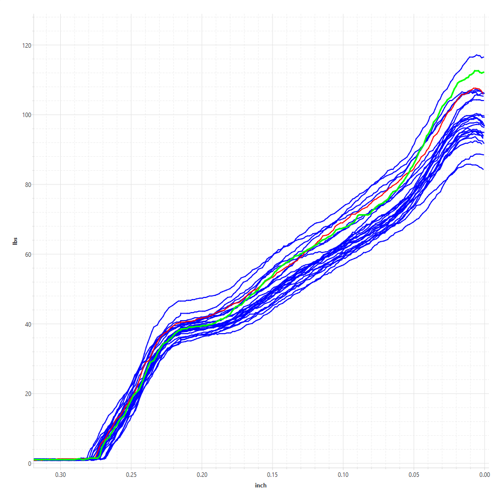

Before @Rio Precision Gunworks enlightened me to dipping in NeoLube, I had found moly dry lube to be the most consistent. Here is a plot comparing (NeoLube in blue EDIT: ORANGE):
Very similar, which is why NeoLube is winning out for me due to time and ease of application.
EDIT: Note that NeoLube (orange) is tighter except for the highest one - an aforementioned flyer.

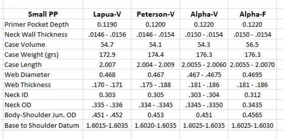

How does alpha brass compare to lapua? Landing for 6.5 Creedmoor. Going to order some more brass soon. Thanks
I've not shot Alpha brass a lot, but I have shot Lapua a lot. So far, I like my Alpha brass a lot. . . as much as Lapua. But a lot more time with Alpha will tell the tale. I feel confident you won't be disappointed using Alpha brass. The only "comparison" I have with Alpha vs Lapua is case measurements, which I found interesting. This was for .308 cases, not 6.5 CM, but it still might give you some ideas. . . here (V=virgin, F=fired):
I've not shot Alpha brass a lot, but I have shot Lapua a lot. So far, I like my Alpha brass a lot. . . as much as Lapua. But a lot more time with Alpha well tell the tale. I feel confident you won't be disappointed using Alpha brass. The only "comparison" I have with Alpha vs Lapua is case measurements, which I found interesting. This was for .308 cases, not 6.5 CM, but it still might give you some ideas. . . here (V=virgin, F=fired):

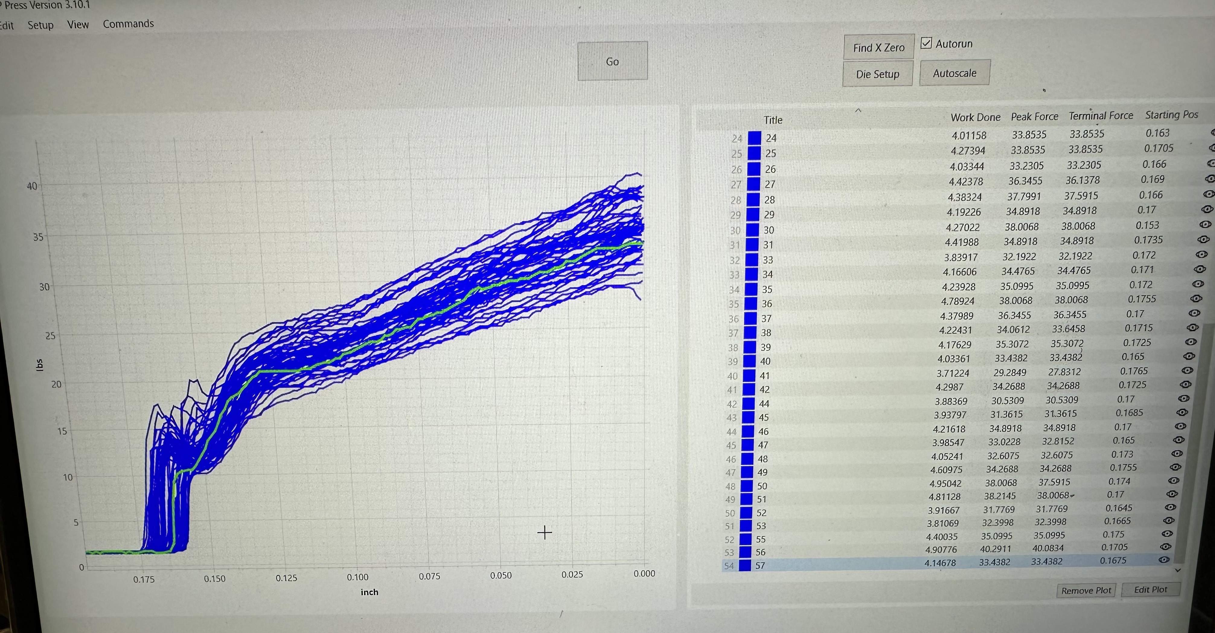

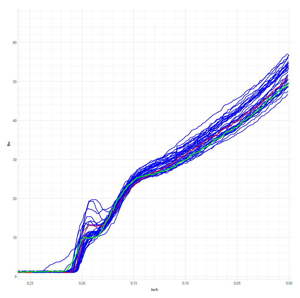

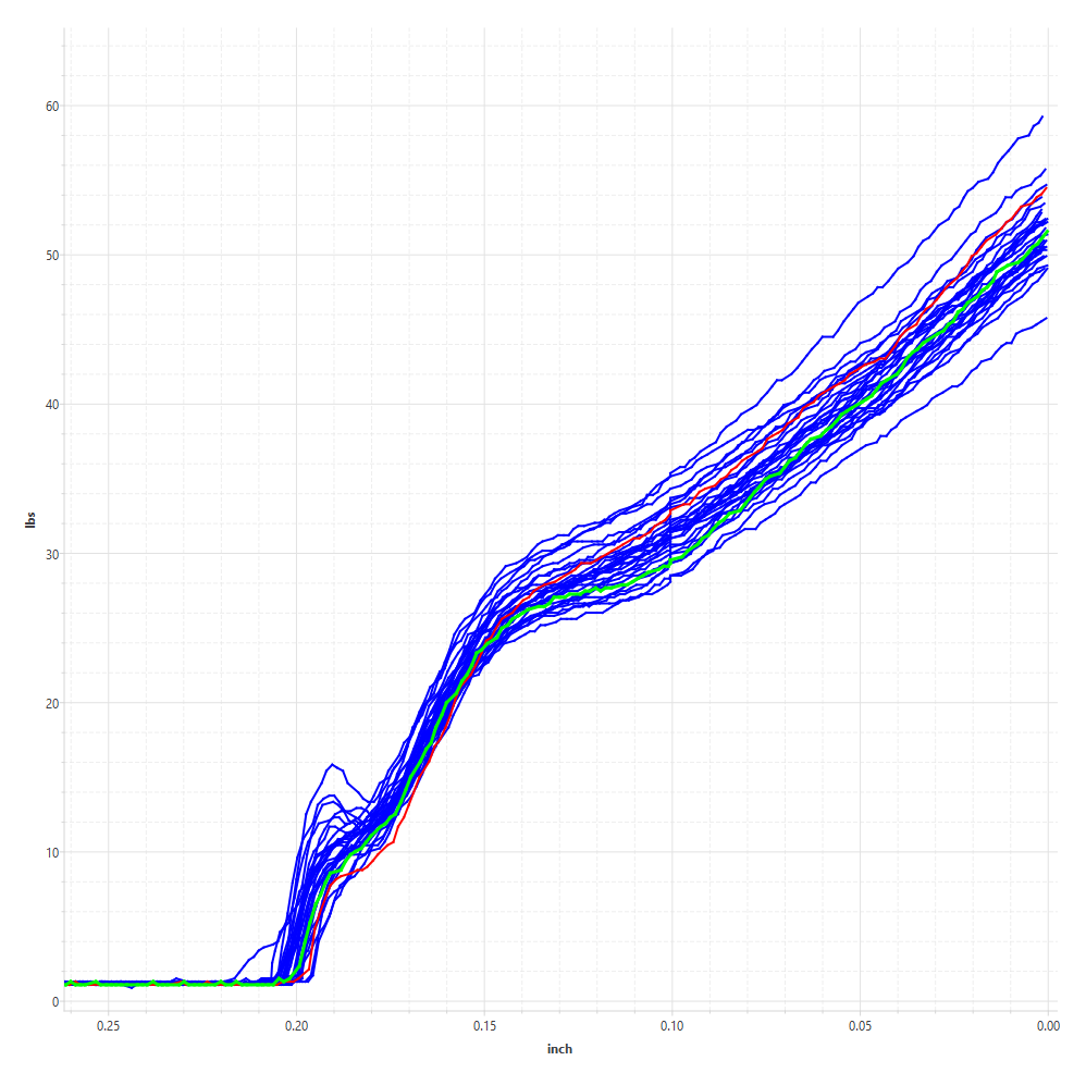

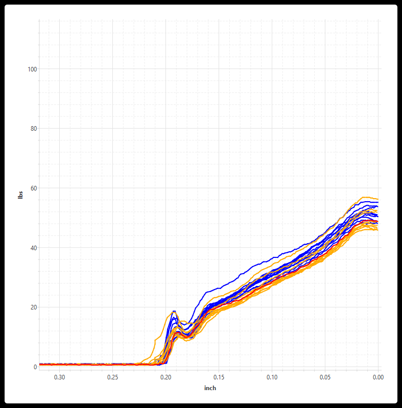

I'd ask you to explain how I got this data - and this isn't over 5 shots, 10 shots, etc. - it's a total of 82 shots each of lubed and non-lubed - all other factors were the same:
This is .300NM Lapua brass with 250 A-Tips.
Fired brass...
  1. Deprime
  2. AMP anneal
  3. FL size, neck bushing is slightly under final neck ID
  4. Tumble
  5. Expand neck to final neck ID
  6. Neolube #2 generously but not enough to drip down into shoulder
  7. 3-way trim/chamfer/deburr
I did a batch a few weeks back where I did everything the same, except 10 rounds I dipped the cases (wipe outside). Seemed like a bit of a waste and didn't see any obvious improvement in seating consistency, but I should probably try a larger sample.

The only things you're doing differently than me are:
- I clean before I anneal (so, moving your step 4 to step 2). I don't think that should make a difference, but I'm not sure.
- I use an ultrasonic instead of dry tumbling. The only possible difference here could be cleaning solution residue that the ultrasonic leaves inside the case neck - OR - if dry tumbling leaves some dust inside the case neck.
- I trim/chamfer/deburr on a Henderson right after your step 5. Applying lube is the last thing I do before priming/charging/seating.
EDIT: It is interesting to see that you've got very similar average seating forces - low to mid 50s.

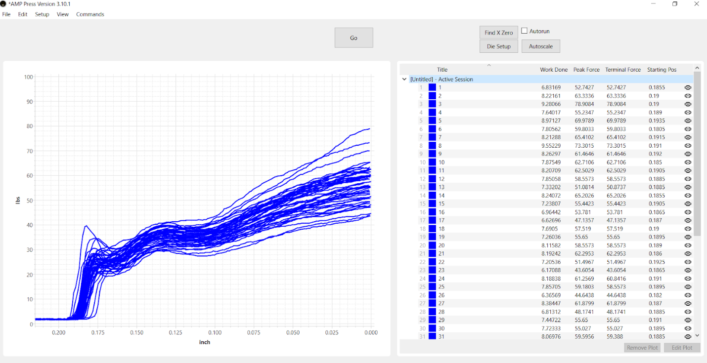

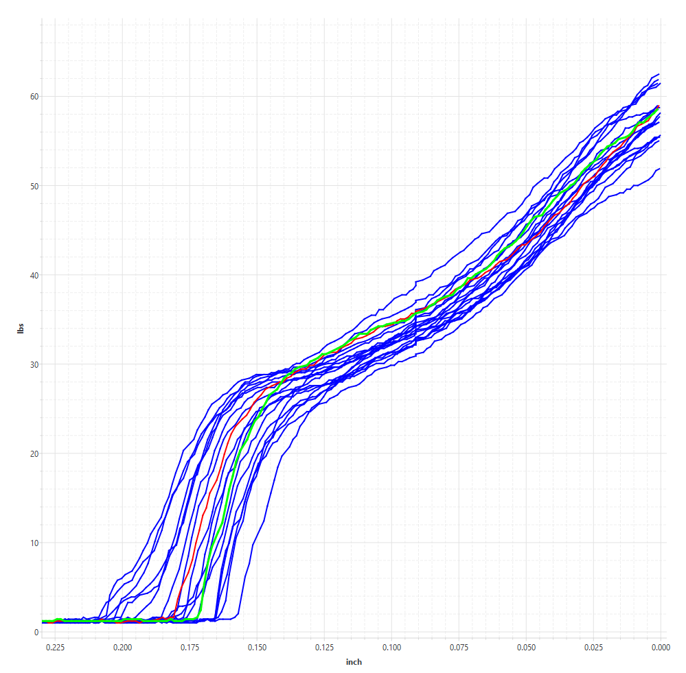

I have seen a difference when I thoroughly rinse brass after the ultrasonic. Here are some plots from my 300 PRC:
Want to guess what's different about this one?

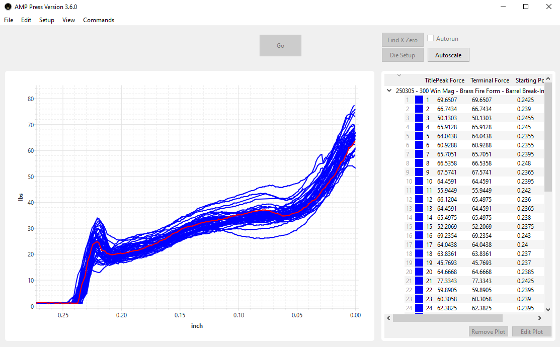

This is my second go-around with an AMP Press. I got one when they first came out, but at the time I was pretty new to arbor dies and didn't like the process. The SAC Infinity die changed that for me, and I started using it for all of my precision cartridges. Frustration during a recent ELR match motivated me to try again with the AMP and get some new equipment to support just this cartridge.
I started over with virgin brass, actually turned the necks (gasp!), switched to a Micron bushing die, and got a Giraud trimmer (been almost twenty years since I had one of those). I've also been using an Accuracy One primer gauge to check primer seating uniformity - another one of those things that felt excessive in the past.
All of that was probably overkill, considering I think I was doing fine with my Redding and SAC dies as well as a shelf full of WTF trimmers, but I wanted to change things up and see if any of this would make a quantifiable difference. On Neolube and expander mandrels I'm very much a convert, and now use those in all of my precision loads. But going back to the AMP Press makes me want to use its data to make the seating process as consistent as I can. Anecdotally in the past, it seems that consistent seating force does correlate to more consistent ammo....to a degree. How much variance actually makes a statistical difference in this case and what's the point of diminishing returns? That's the question.

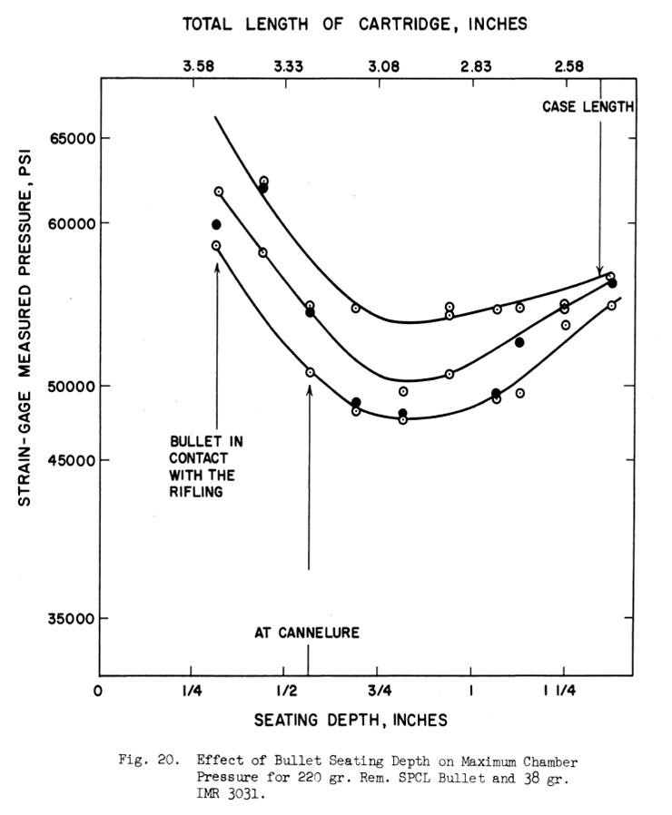

Here's my take on the issue:
It's a great deal having to do with the timing when the bullet is being released and blowby occurs. Seating depth effects that and how quickly the bullet moves forward. When the necks are lubed for seating, it allows less pressure to move the bullet forward and results in the blowby occurring earlier than when necks are not lubed. Such changes effects when the start pressure spike occurs. Just as seating depth does this, different neck inference also does.
A college science study was done back in the 60's with an extensive report on the effect of seating depth. The graph below from their data is something I feel makes for a good visual to get an idea of w
hat's going on.
A college science study was done back in the 60's with an extensive report on the effect of seating depth. The graph below from their data is something I feel makes for a good visual to get an idea of wView attachment 8554094hat's going on.
Pretty much right on - though I'll add that the pressure profile impacts more than just bullet expansion, and since pressure and burn rate have a reciprocal relationship, things that impact one, impact both... to an effect out of relation to the actual magnitude of the event itself. This is especially true when the event happens early in the combustion lifecycle - effective neck tension is one of the earliest elements to exhibit itself. The only one earlier is primer ignition and the earliest stages of powder burn.

If you closely look at my plots you can see a center group that’s pretty tight surrounded by outliers. I noticed that I got those outliers, both min & max, when the ram came down slightly offset center, either front or back of the die.
Reactions: Rocketmandb
If you closely at my plots you can see a center group that’s pretty tight surrounded by outliers. I noticed that I got those outliers, both min & max, when the ram came down slightly offset center, either front or back of the die.
When you push your die all the way into the “foot” of the press (they call it a Load Cell Retainer, I call it a foot. Mmmm Hmmm), does it not automatically center the die under the ram? What die are you using?
This is an interesting observation
SAC Infinity Die.
It fits just fine, but there’s a little room for a slight offset. I just always assumed it was a downward force regardless, but there does appear to be a correlation to causing force variance. I’ll do another round of testing and record it.
Reactions: vh20
What is your brass prep? What is your neck tension and how are you measuring your neck tension? I just started using my AMP press with a couple different cartridges and I'm seeing quite a bit more peak force 243 win average 65 at .002 neck tension and 200 on a 28 Nosler at..0035 neck tension both using Neolube #2. Both measured with pin gauges. I can post the plots if folks are interested?
  • FL Size with SAC neck/shoulder bushing on annealed brass
  • Dry tumble to remove lube
  • Neolube #2 inside necks
  • Mandrel up to 0.002" neck tension (pin gauge test to confirm every ten or so)
  • trim/chamfer
I generally store the brass after tumbling and when I'm ready to do a session for a particular load, I pull some of that brass and then do the final prep. Sometimes I'll re-apply Neolube after running the mandrel, and I like doing the chamfer as the last step as a way to help keep track (easy to see the clean cut brass with lubed necks).
For those who have an AMP press, I thought it would be interesting to see others' plots and what prep they did to get said plots.
This is 50 rounds of virgin Peterson 300-WM ...
- Peterson 0x
- Retumbo 74.7
- Berger 200.20x HT
- Bushing 0.333
- Mandrel 0.308
- CCI LRM primers
I use NeoLube #2 before the mandrel step, and leave that residual lube in the necks prior to seating. This method work well for me, as I haven't needed to lube the inside neck twice, as lon as my final cleaning step comes before I mandrel the case.
I felt like this was a pretty tight chart for a whole load of virgin brass. It actually grouped better than I thought it would
