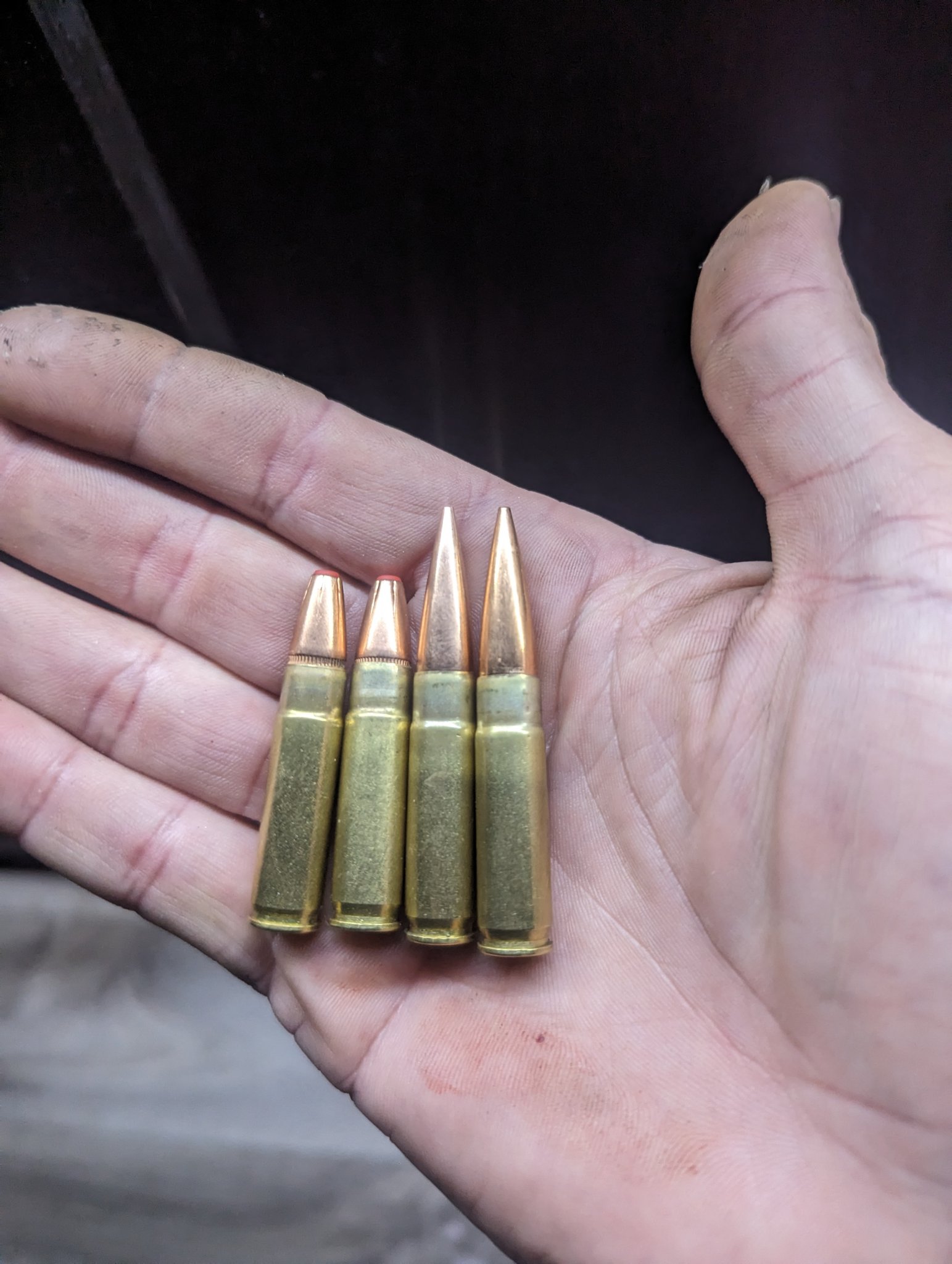

    Just wanted to throw a learning experience in since I just recently added 300bo to the reloading list. The max length can vary greatly depending on the bullet profile. I had some eld's laying around, and I had picked up a box of some Hornady sub-x (175). And I had started loading everything, like a full run, maybe a hundred pressed ready to shoot. And everything was right in the middle of all the spec that I could find. (That's me assuming the credibility and guilt, lol). So in the most amateur way possible, before I put everything up for the night to take to the range first thing in the morning, I just wanted to verify that they fed through the mag and chambered properly etc...
    Of course, they didn't. Not even close. (Like 40 thousandths). Of course I'm sitting there dumbfounded with a stupid wtf look on my face as I'm looking over the cartridge drawings and load info for what must have been 45 minutes...
    Like an idiot...
    Until I finally realized how much different the shape of the subsonic's compared to some super high bc bullets really was, and how much of a difference in the CTBO between them actually was.
    I guess point being the lesson I learned right out of the gate with 300 BO is that the bullet can make a major difference in the seating depth, which in turn GREATLY changes the case volume for powder. I'll attach a quick picture to illustrate what I'm trying to say. Hope this saves someone else some time and frustration.

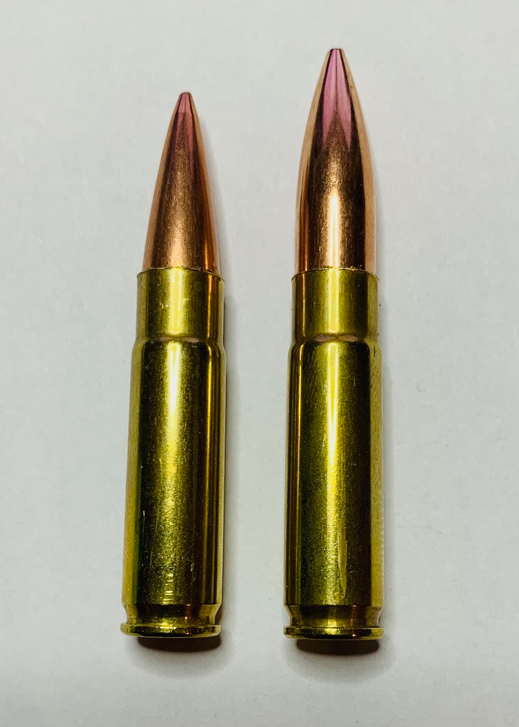

    No doubt ... the left is my Supersonic cartridge with 16.6g of IMR 4227 and a Sierra MK 125 with a COAL of 2.060 ... the right is my Subsonic cartridge with 10.1g of IMR 4227 and a Sierra HPBT 220 with a COAL of 2.260. The size difference is obvious.
