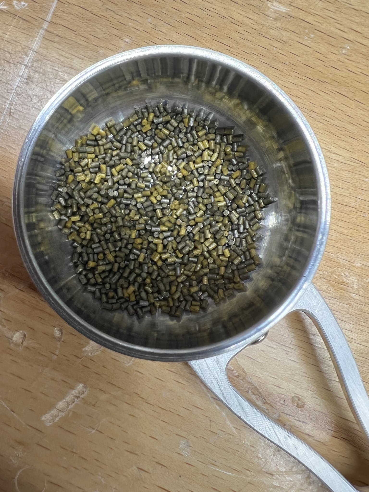

EXACT same thing happened go me except I was shooting 6GT with CCI 450s and H4350. I found the EXACT same results as you.
I took a picture of the powder that came out of the case.
Reactions: Average guy and KZP
I had this happen recently with CCI 450 primers and H4350 in a 22CM case. No wet tumbling.. Virgin Alpha OCD Brass.. NO drinking on the bench. powder was clumpy like you said, primer was "spent", and there was some charring? on the bullet.. All others in that string of fire were fine. I chalked it up to a bad primer.
I think it’s a bad or “weak” primer as well. Strange though that 4350 was used for you, jefe and myself. All with the same issue.
