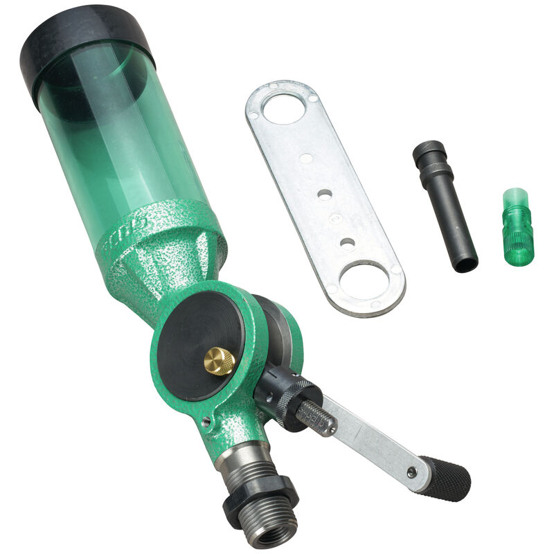

Hey guys. I picked up an RCBS Uniflow III for quick powder drops on practice ammo.
When using it with Varget, the drum was binding/jamming up every so often, probably smashing some kernels in the process.
Has anyone experienced this and, if so, any remedy not involving tossing the away?
Using a baffle and the double tap method helps, ie moving the lever about half way down then a quick up then dump, the RCBS unit is perfectly fine, there is a reason they are on all Gen 1 and 2 Prometheus scales, and yes I have a Gen 2
