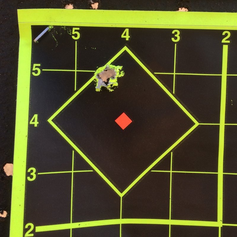

I just tossed out the powder from the factory Hornady rounds I pulled (for brass) because the relatively short barrel life of 6mm Creedmoor makes it unwise to try to reuse unknown powder. H4350 yields good results:
