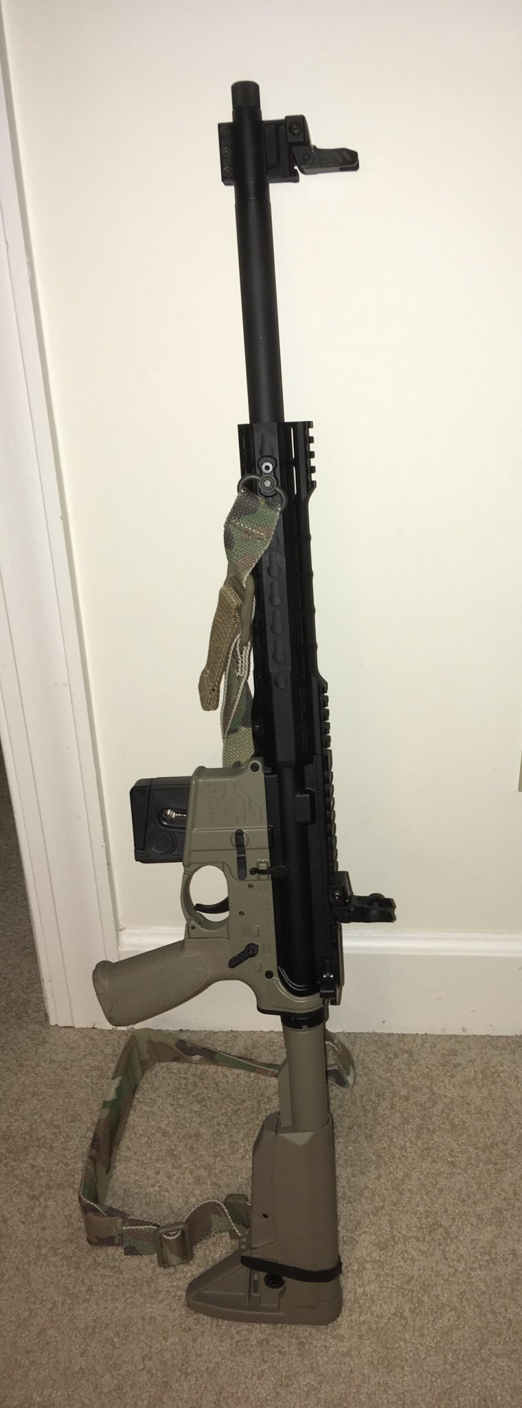

I just finished doing a dedicated ar in .22 for my son to train with until hes ready to step up to the bigger caliber in this platform.
I spent a bit of time searching and deciding on something that would give me
around 1moa accuracy
not cost a fortune
look, weigh, and function exactly like my rifles so he can have the best training experience with it
I settled on the following and I am very very happy with it
For the lower I took one of my tax stamped mil specd lowers that was already built
the only things i needed to change were running a Catch 22 bolt catch
and a Catch 22 S&W mag adapter for the mag well
(both of these were around $30)
also running
RRA 2 stage trigger
milspec buffer setup
moe stock
for the upper i went with
RTB (made by CMMG) 16” M4 profile barrel
I cut the barrel down to 9” so he can handle it a little easier and put a griffin 3 lug adapter on it so I can run my griffin can on it when I need to do some quite varmint hunting
RTB .22 dedicated bolt (made by CMMG)
Raptor charging handle
9” quad rail ( i think YHM)
ARMS Buis set
Aimpoint comp m2
Magpul sling mount
Magpul hand stop
Magpul sling
This setup functions like a proper AR does
(bolt locks back on an empty mag,
bolt stays locked back when the mag is released etc)
It is a lot of fun to shoot especially for my little guy
We zerod it with the CCI AR Tactical ammo and have shot it with a lot of other high velocity .22 ammo and it holds a consistent 1 MOA at 50yds
a little closer to 1.5” MOA at 100 yds
Biggest thing is it didnt cost a fortune
The Right to Bear branded barrel and bolt are made by CMMG for RTB and are a little cheaper in price
I built this setup with a lot of spare parts I had in my parts bin
but I wouldnt hesitate to build this again if I had to buy everything brand new
