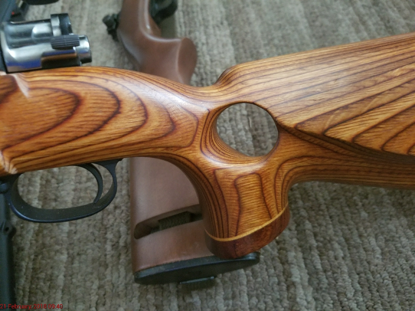

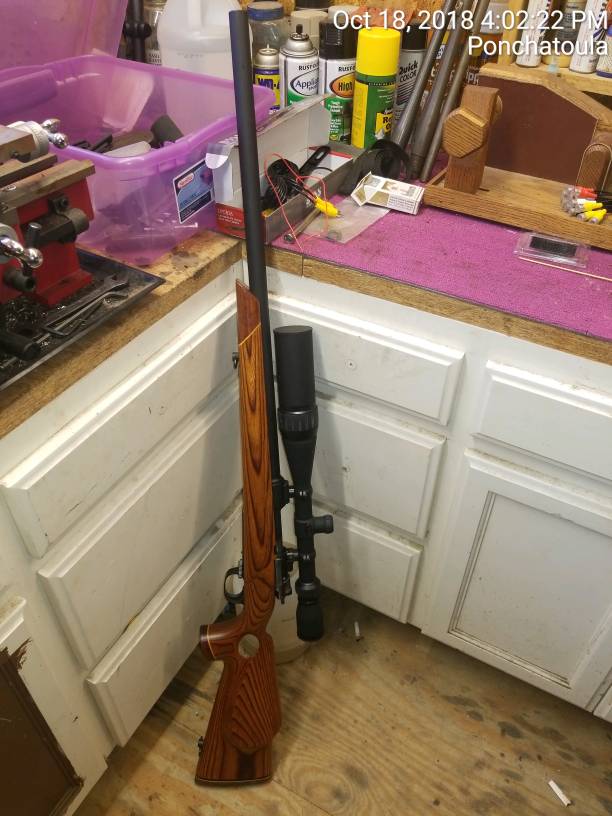

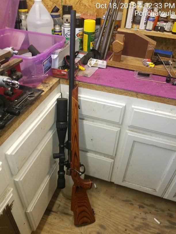

I went the Mauser route because I had one that had sentimental value. This is what I did to it. Took off everything but the action, was a 1910 Amberg. Decided on 30/06 to save messing with bolt face and mag box.
1) lapped the lugs until bearing was as equal as I could get. Welded and shaped aftermarket Brownells Model 70 bolt handle
2) PacNor 26" 1.250 to 1" straight taper
3) Clymer finish reamer .005" (didn't want too tight)
4) Timney Sportsman Deluxe w/ safety
5) Brownells bolt shroud
6) shaped existing trigger guard to taste ( a LOT of work)
7) oversized laminated stock, hollowed out barrel channel, Acra glass at tang , recoil lug, and 2" ahead of "ring" to totally free float.
Rifle shoots WELL!! Would I do it again.... maybe? It was fun, I had the action, and the time.

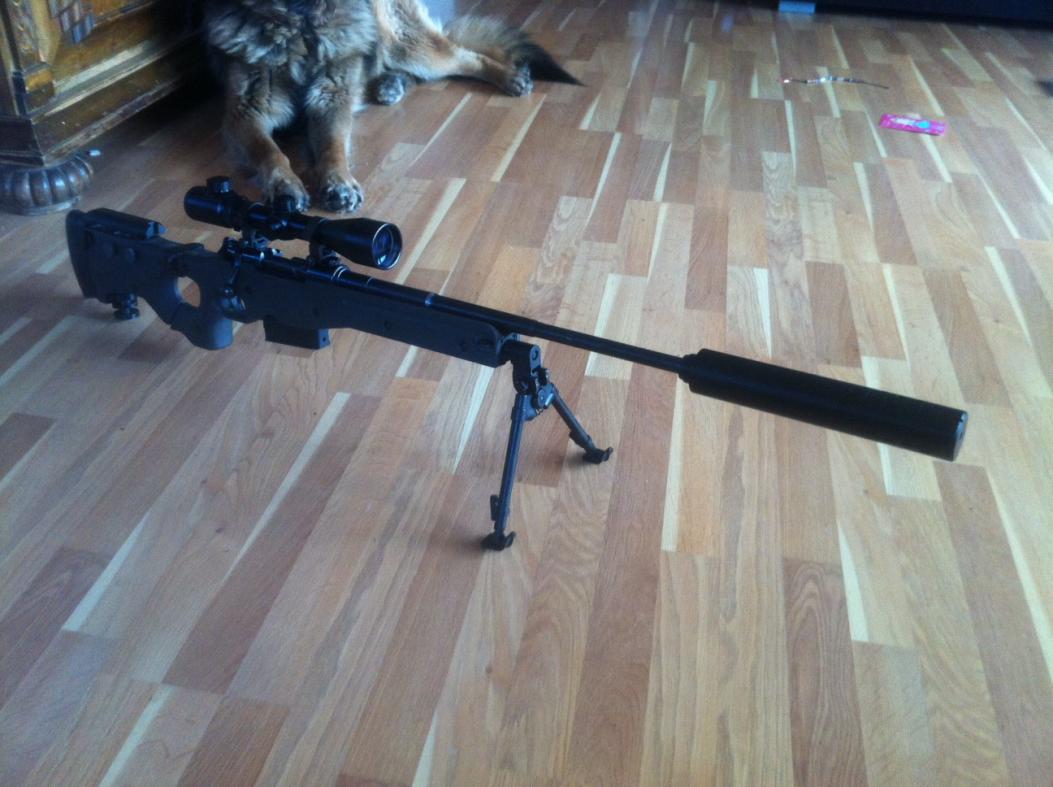

Here is my custom mauser 98, action is produced in 1942 army model. served in ww2 and later in the Norwegian army.
barrel was changed in 1965 to a Kongsberg, then chambered to 30-06 (was 7.92org)
mounted a AICS clone stock from a Ares aw338 airsoft rifle, the stock have a solid square alloy bar like the real deal so its plenty powerful and stiff enough to take the beating from the 30-06.
action is bedded to the tube!! magazine working perfect.
pulling out under 1moa @ 100meters even with my poor shooting skills..
safety is changed to a 1/4 safety of unknown brand, charging handle is cut of and turned.
two piece weaver base, ordered a one piece undrilled 20moa rail now and a timney trigger.

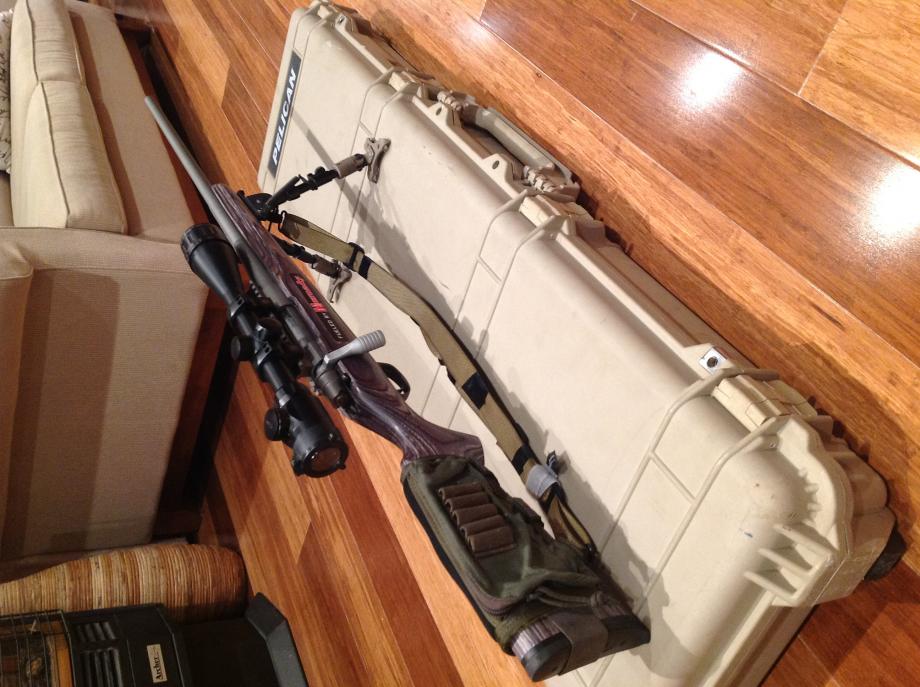

This mauser shoot around 0,40 moa
Price around 1000$

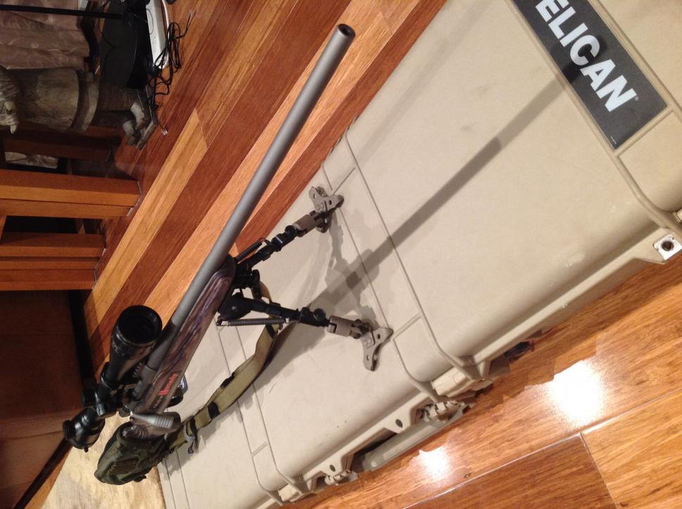

Another Mauser Shooting around 0,40Moa
file.php
Shooting around a moa, price around 260$

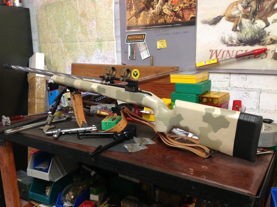

Another mauser build
file.php
My own Mauser build is starting to shape
Is working on another stock atm. Got allmost all hardware for the build, but stil need a scope mount for my NF scope, a recoild pad and some hardware for cheekrest.
I guess, for the money i used on my build, i could have brought a rem700 and upgraded it, but whats the fun in that? now i got to do some gunsmithing myself, i have learned so much more abourt the gun, i just love to do some smithing and make a unique weapon, whit my specs, and how i want it to look.

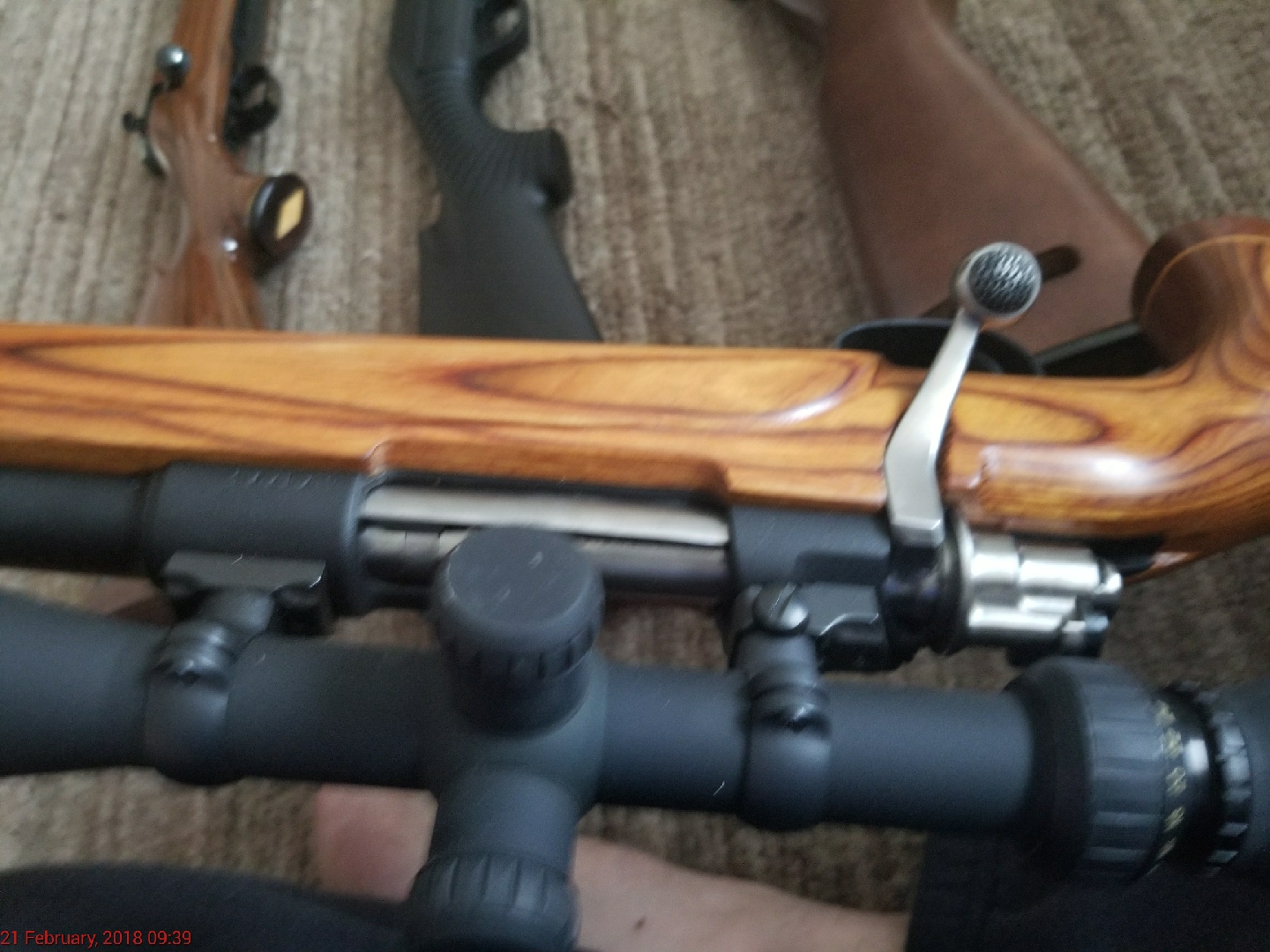

I have a K98 large ring in .308 with a bull barrel, jeweled throughout, bedded up in a Boyd’s thumbhole stock. 2” groups at 300 with federal match grade 168gr, ringing the 8” plate at 600 all day long. I bought it already done and hate to fool with it but I’d love to ditch the stock and go with a nice chassis. Any rec’s for a large ring with a bull barrel?
