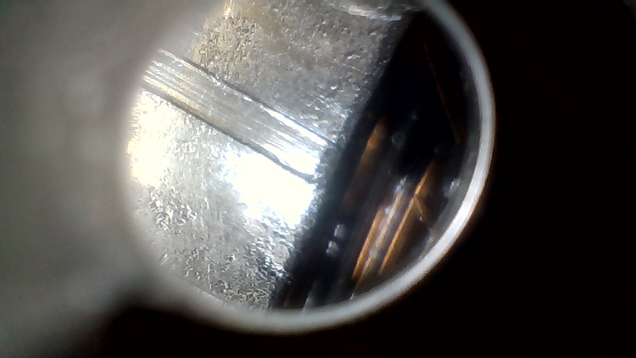

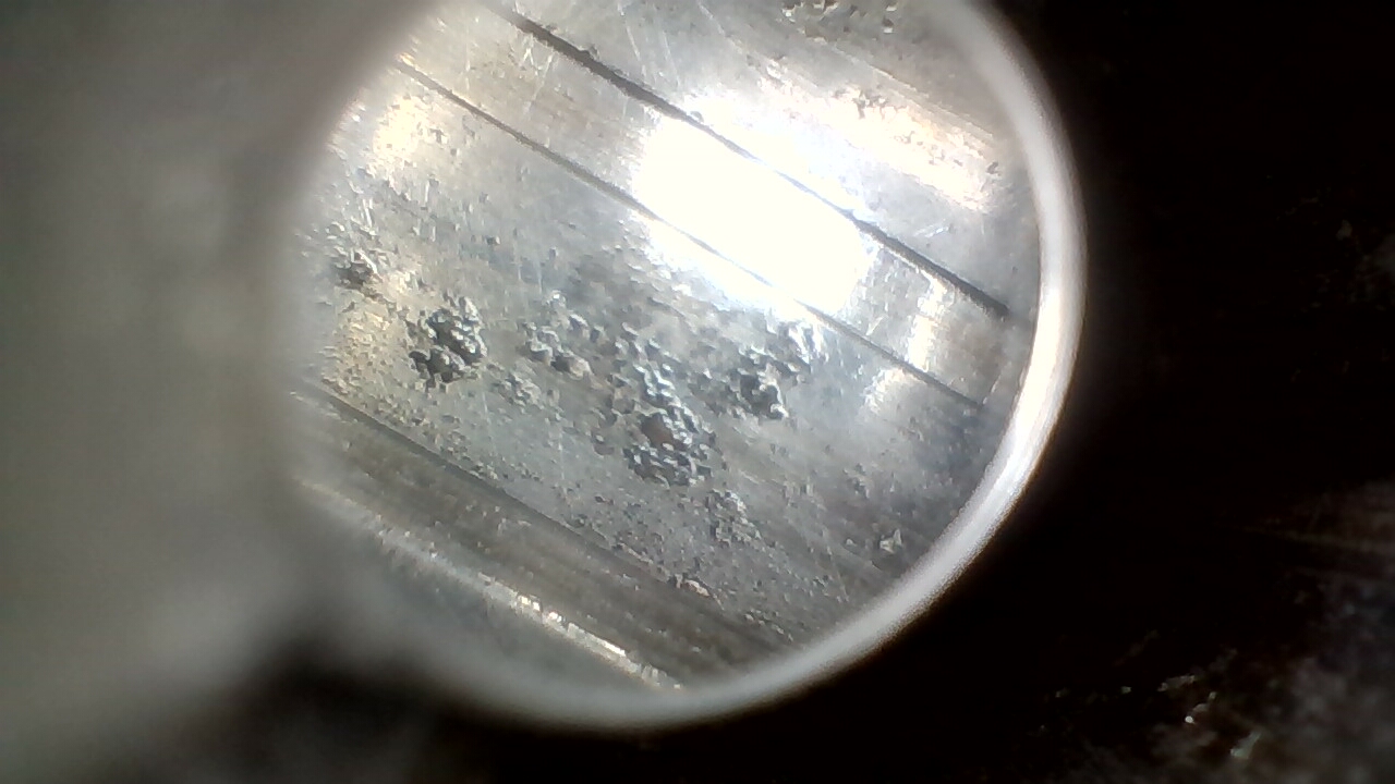

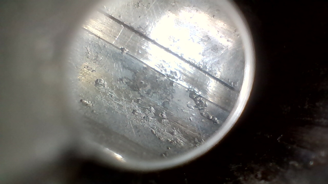

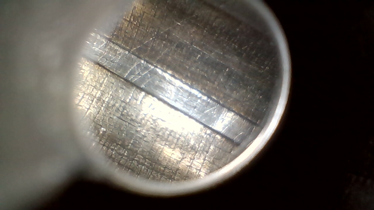

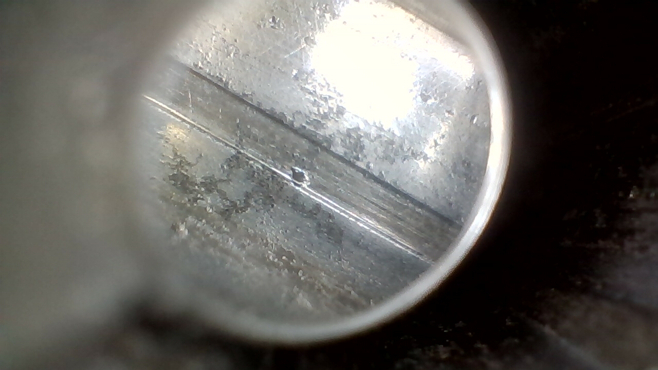

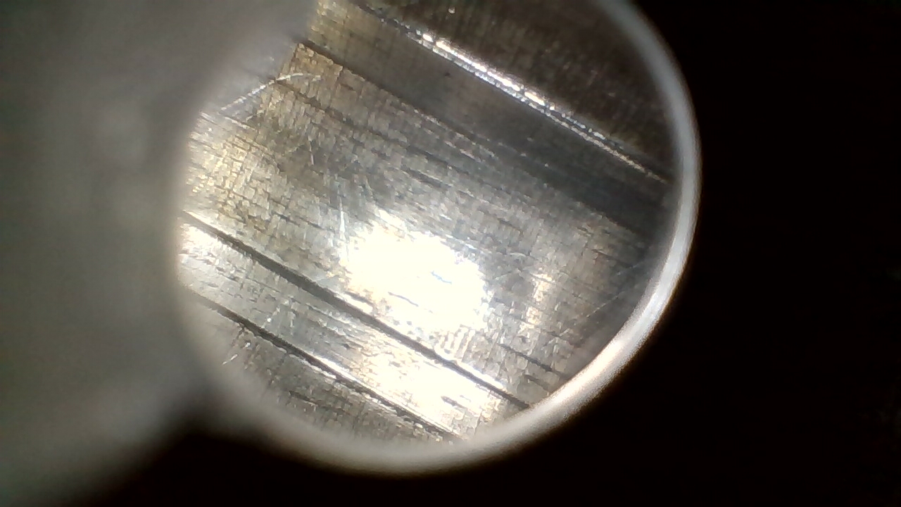

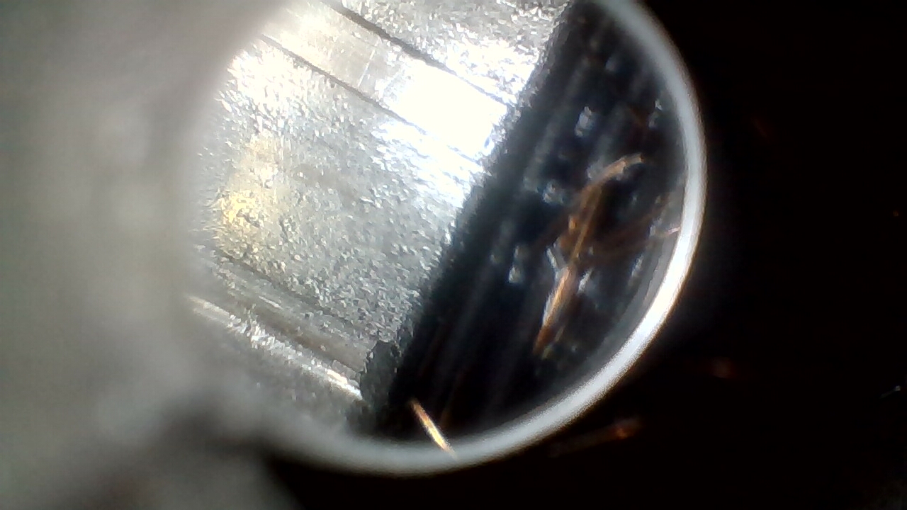

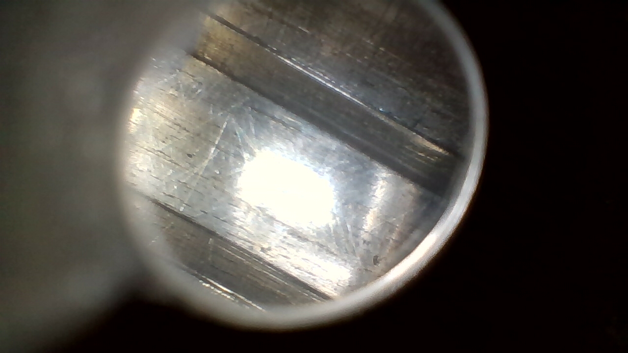

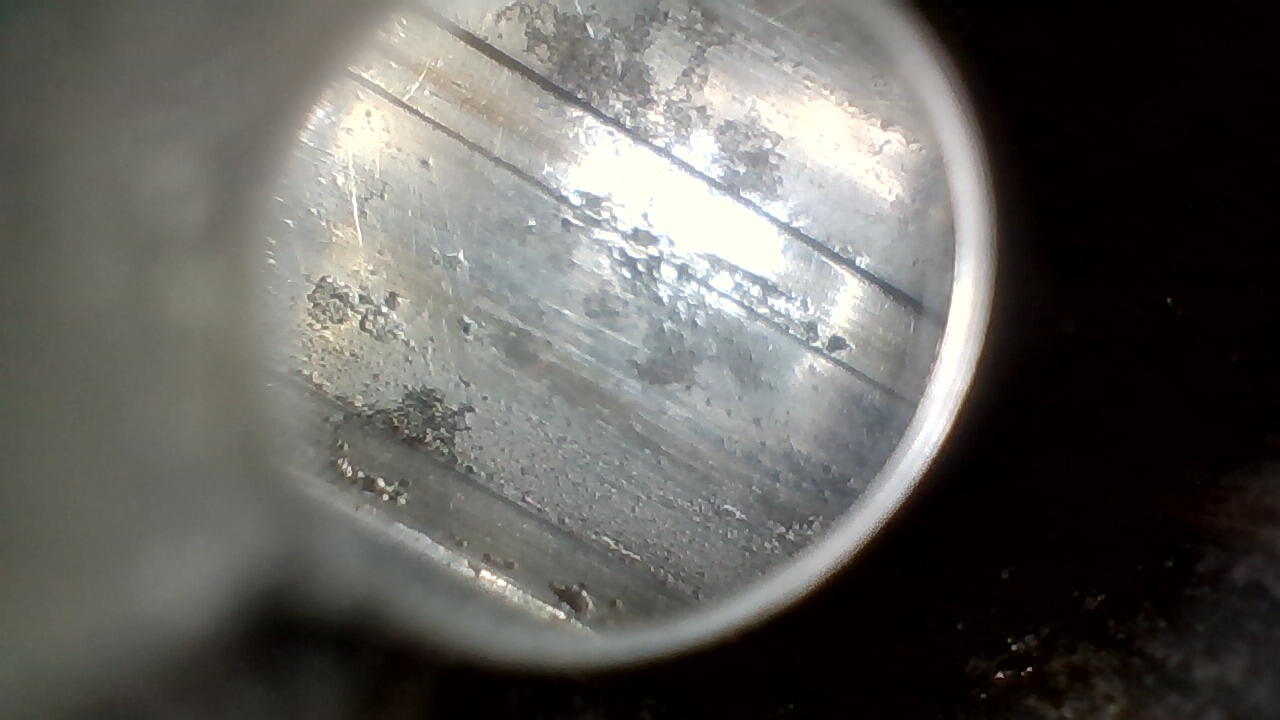

The results are in! Took the Dewalt to the old 700 today. It's nice and shiny in there now but I think that barrel. Is just pooched. There's some pretty bad rust pitting in it. Even worse in places now than I had previously seen. Now that it's clean in there and you can get a good look.
Not sure as to hardness of ss barrels vs cr-mo but I ended up with a slight cross hatch pattern in the bore now. Rings ought to seat nicely. Used a tiptons best 30 cal. bore brush with boretech eliminator and cu²
Went out and shot it but didn't get a pic of the target today. Group stayed fairly centered where it was but instead of horizontal shift it had more vertical in it. And it didn't group all that great. Shot with the same box of ammo as the last target. I think it needs at least 10-20 shots to calm it down after cleaning it to smooth things back out in the bore. Some of the pits are pretty bad. Some on the lands, some down in the grooves. Pics to follow.
Starting from the chamber working towards the muzzle. You can see the light cross hatch scratches in places. Looks like there may still be some carbon stuck in it in places. Hard to tell what's pitting and what's stuck on.
Not something I'll be doing to any of my custom barrels that I care about. This one's days were numbered as it was. The twelve twist has got to go!
Well, thanks for letting us know that's a dumbass thing to do to a good barrel. You didn't really lose anything on that one I guess so glad it could be of use. Seriously, thanks for the test and showing the results.

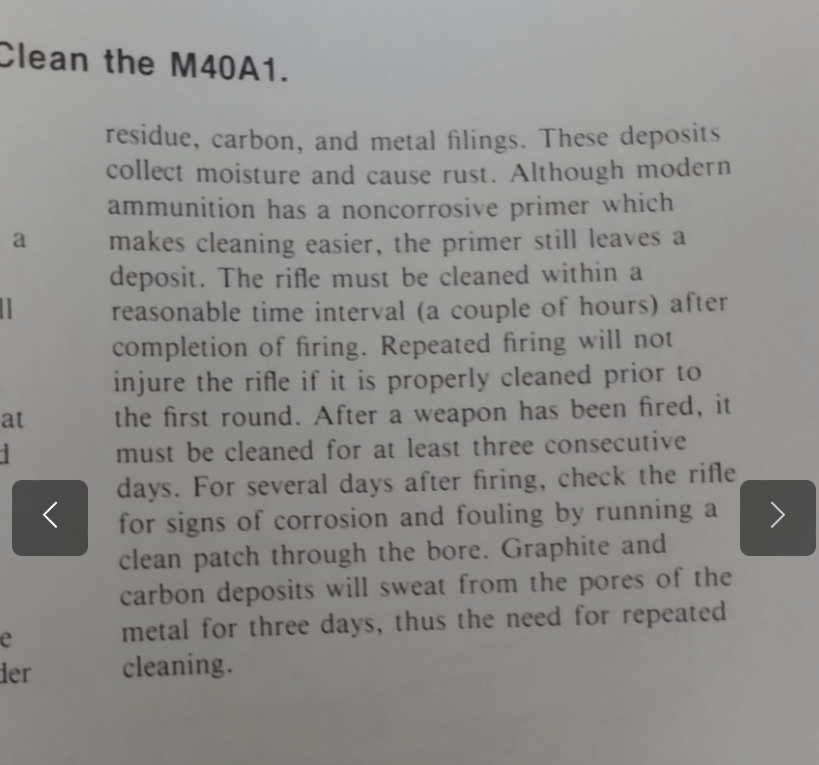

Pretty wild to listen what other people do when cleaning barrels. Things I learned, don't use a wood rod chucked up on a drill with sand paper on the end lol, be careful with abrasives, and certain chemicals, use a bore scope it will tell you when it's clean and not all cleaning regimens are going to be the same even with the same barrel.
Reactions: Frank Green
I stick to proven and conservative methods on all my shooting. Just like I don't use moly coated bullets. There is a polarizing subject. There are guys out there that swear by them and guys who report ruined barrels do to moly ring in the chamber. Anytime there is contention like this I don't use the product. If David Tubb (sponsored), Larry Potterfield (billionaire) or anybody like that wants to try something with their $400 barrel that it great but I'm not in that boat so I will be sticking with Frank Greens advice.
Are you saying the barrel doesn't weep for a few days after the initial cleaning? And running a patch down the bore to check for that weeping is false?
This is something I would ask @Frank Green, not the military.
The military is notorious for over cleaning. And while that article doesn't outright state it, it hints/suggests further cleaning if weeping is observed. Not just merely running a patch down the barrel.
I'm open to learning something, but I'm extremely skeptical of that much cleaning.

Also, you mentioned listing to the military as a bad source of info. I think there is a disconnect from the drill sergeant who yells at teenagers and the engineers who designed and wrote the manual for the M40A1.
The military spends more time and money on testing things like this than any one. Why would they make that up and put it in a manual??
This is where is came from.
I am curious as well
Perhaps I should give them more credit. I just feel like they are always way behind on precision rifle stuff.

First thing I always say is "pay attention to the rifle. It will tell you what is going on, you just have to learn how to read it!"
Also, the barrel will change over the course of its life. When that throat starts to get rough (looks like the dry riverbed, alligator skin, cracking going on) and when you clean it the patch goes over the top of the surface. It doesn't necessarily get down into the cracks/fissures. So, the solvent will sit down in there and keep loosening up the fouling. So as the barrel wears you will see this more than when the barrel is newer/less rounds on it.
Same thing the patch will not necessarily get right into the corners of the lands/groove junction. This is one reason I feel from a carbon fouling standpoint the 5R rifling might seem to clean a little easier vs conventional 4 groove or 6 groove, 3 groove, 5 groove, 8 groove type rifling where the lands meet the groove basically at a 90-degree corner.
So, when you run a dry patch or a fresh wet down the patch down the bore sometime later on you might see some dirt streaks on it etc... it's what I refer to as the barrel is sweating.
Food for thought for you guys!
Later, Frank

Never seen that before! That’s pretty cool!
I also feel the barrel will clean easier when it is still warm. All the fouling is soft. Now this isn’t alway practical to do. I get it.
and I always say… put it away dirty for extended periods of time and it will pit. It will corrode!
