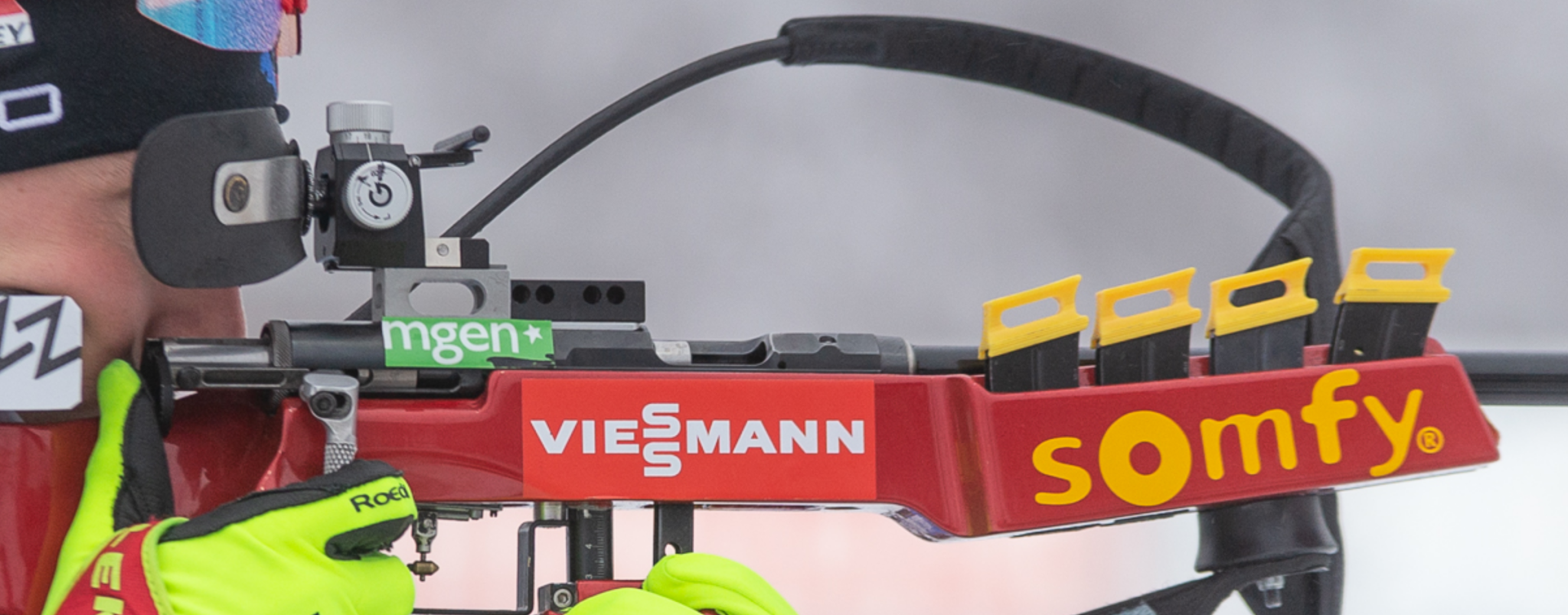

    Pretty sure rifles like the 54-18 repeater ("MSR") and 1827F (Biathlon) were originally setup/optimized around 5 rnd mags.
    Check out IBU or in NRA small-bore regs. It's 5rnd/per mag in both disciplines.

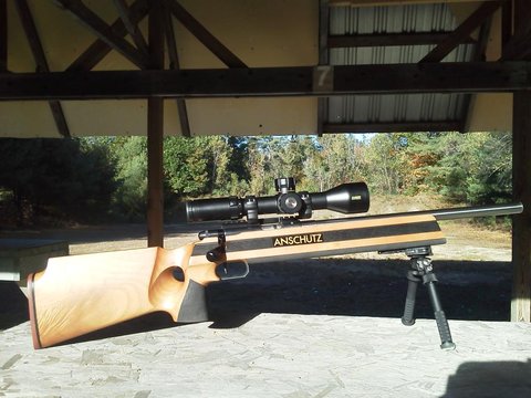

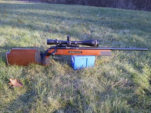

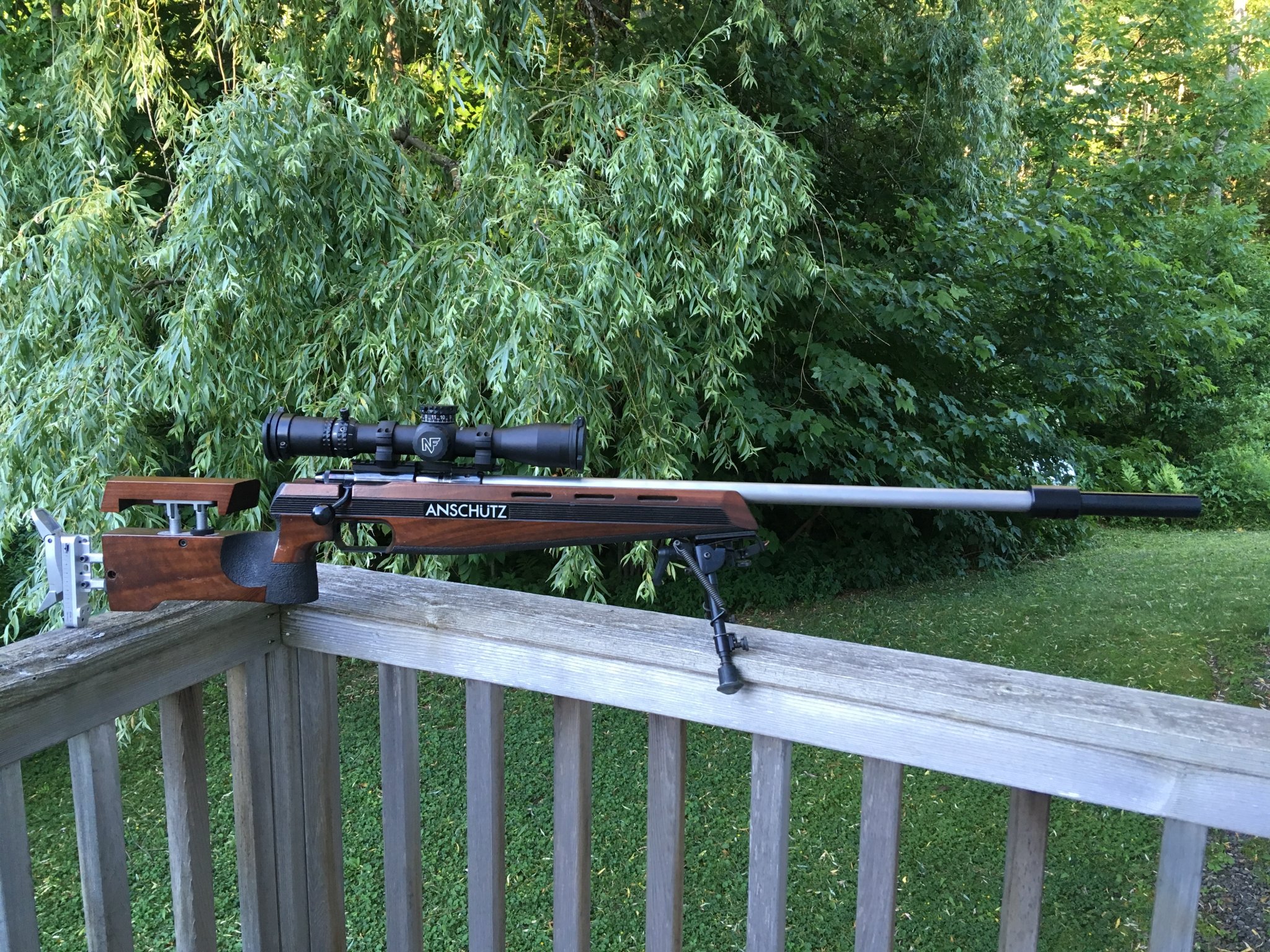

    This was my favorite, an 1827B action that I had Mark Penrod put a 3 grove 15t Benchmark on and I inlet and bedded in the stock. It was a shooter!
    These are the other 2 I had:
