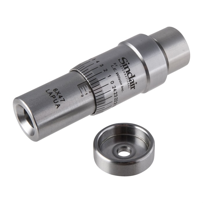

Not only do I think they're the best as well (even when spending a small fortune), but the entire setup (arbor press, force gauge) allows you to understand where your problems are and how best to maximize consistency. I consider getting an arbor press and LE Wilson Seaters to be the single most consequential addition I did to my reloading process.
Not just LE Wilson dies, but Sinclair's modified version with the much better micrometer seen above. I chucked all of my old school arbor dies for these newer Sinclair dies - so much easier/faster to accurately adjust.

What do you find as superior about the design?
Oh dude, it's so much easier to use. No loosening/tightening screws - just twist the micrometer head like a traditional die. It's been about 10+ years since I was using the old fashioned LE Wilson dies, so maybe they make an easier to adjust version now? I just know that the Sinclair-modified version, while pricey, is so much faster and easier to adjust.

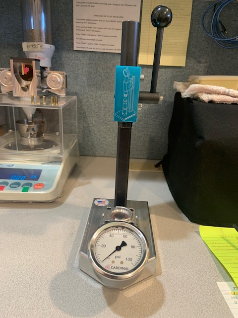

This is the rig I use with my Sinclair/Wilson bullet seating die. The base is made by Dale Carpenter (DC Firearms). All the hydraulics are sealed in the base. The arbor portion is a standard K&M press.
That looks sweet. Thanks. I like how small this looks and seating long for a range trip appeals greatly to me, because my range is a good hours drive and with todays gas prices I can save buying this tool (just practicing for when my wife asks..)..
Reactions: M.A. Matteson

The Sinclair/Wilson die is a bullet seater not a sizing die.
What you see is the complete bullet seating die.
Any chance you have a link for DC Firearms? I googled and found a place but not sure its the right place. Thank you.
Nice! I love mine - might be getting an AMP press so I can 'see' a little more detail, but Dale's setup is pretty nice.
Had fits with mine for a while, but that turned out to be my own fault. I'd previously had the K&M force-gauge washer setup on the press, and just took off the dial indicator when I bolted the press onto the hydro base - I left the damn washer stack head in place. Made the thing all 'squishy' and messed with the feel a bunch. Won't even mention how long it took me to figure that out... :rolleyes:
