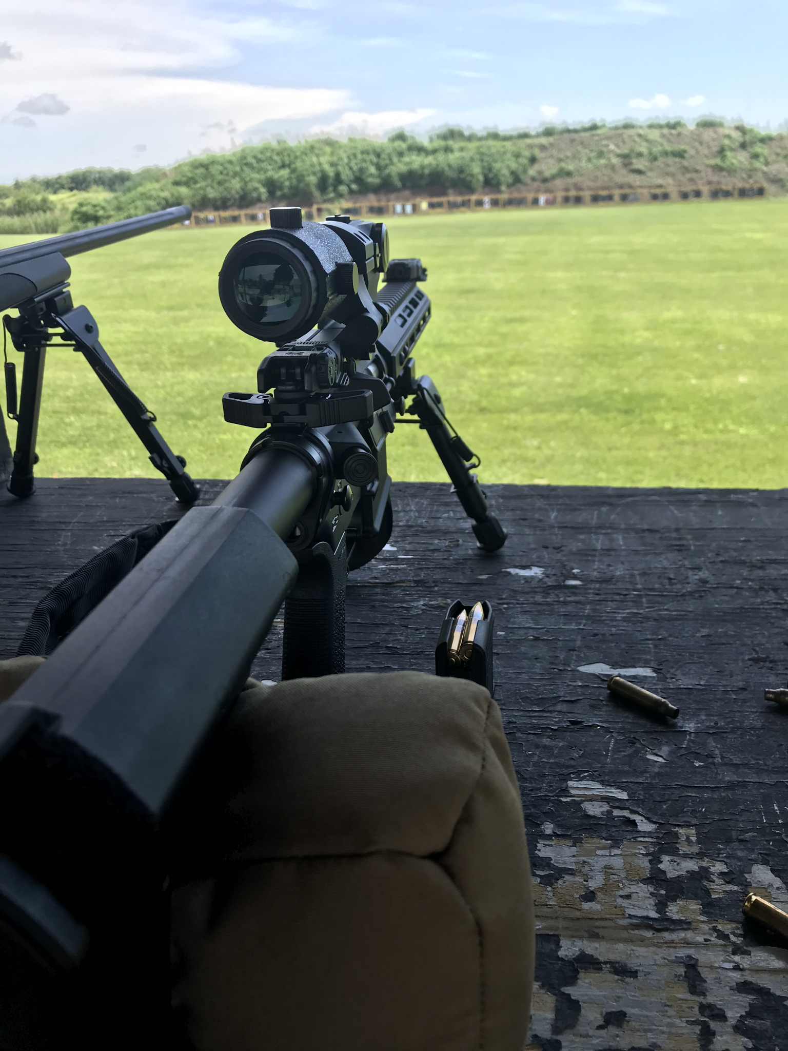

An ELR 3D bag with light fill....got me a 6", a 5", and an 8" group in a 1000yd bench rest match today...shooting tactical class with an Atlas Bi-pod and the PU rear bag.....on a concrete bench.....just saying...the bags are solid performers....oh....and it also got me another 1 mile win...can't forget that.

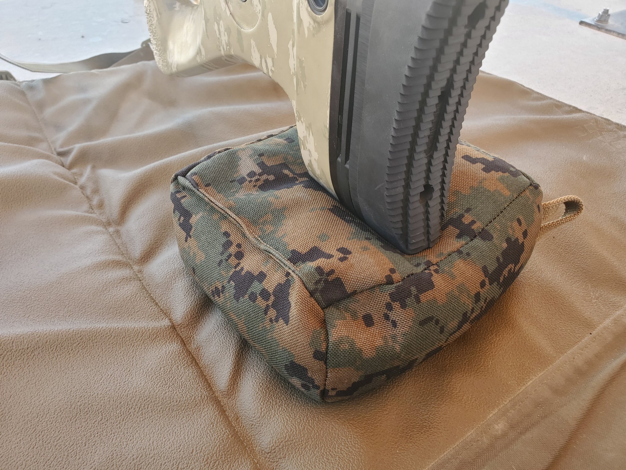

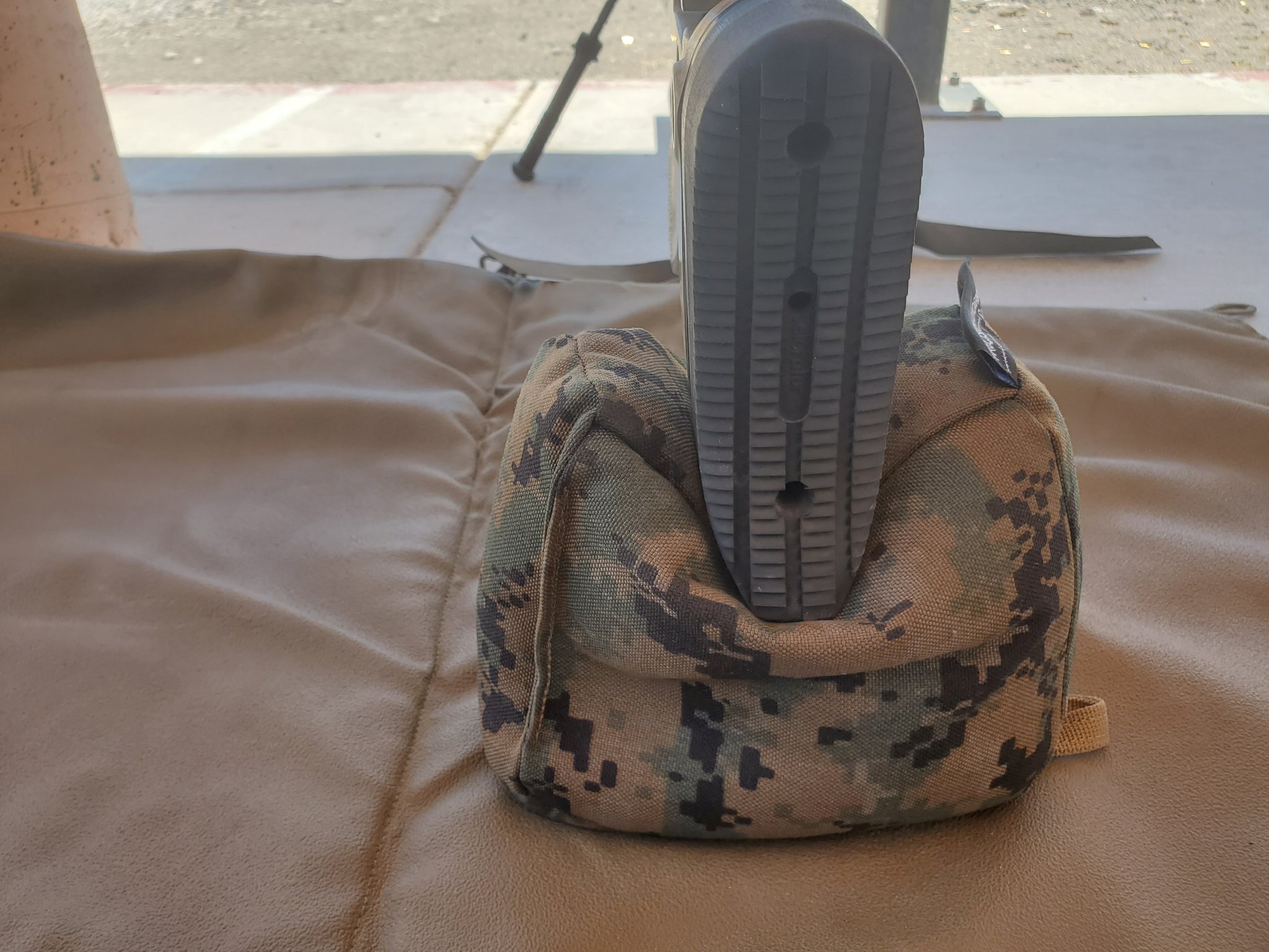

I’m liking mine. My wife thinks it’s not as solid since she’s used to a bunny ear bag. I like how the light fill behaves. Have to get my boys to give it a try next time we’re out👍🏼
If you can get her set on a side where the stock can sink into the bag a decent amount the corners will fold in and mimic a rabbit ear bag. This is especially the case on the ELR because of its shape but the 3d will do it too more so on the shorter side(not flat but not the tall side).
That’s how I normally use the 3D lite fill.

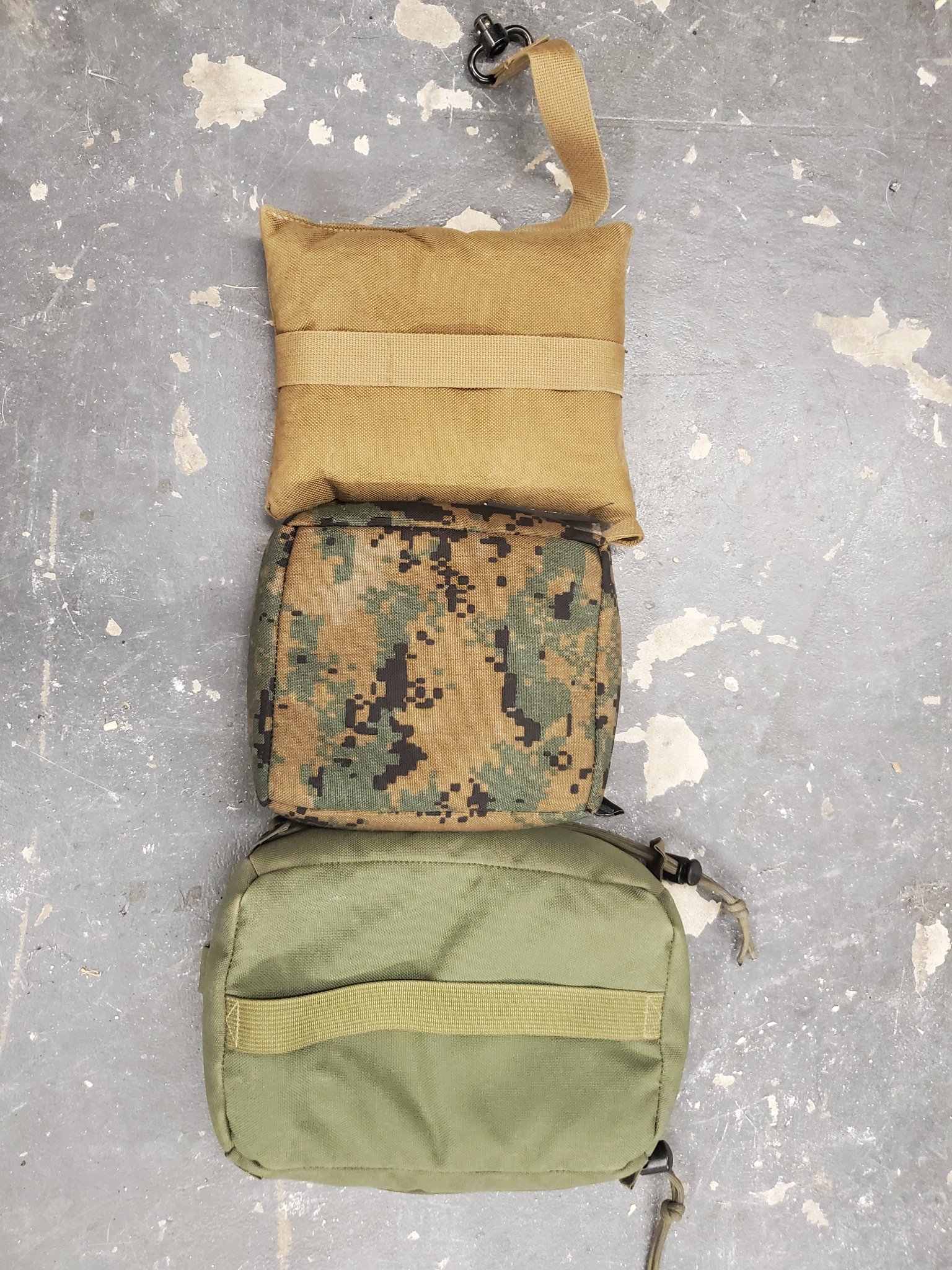

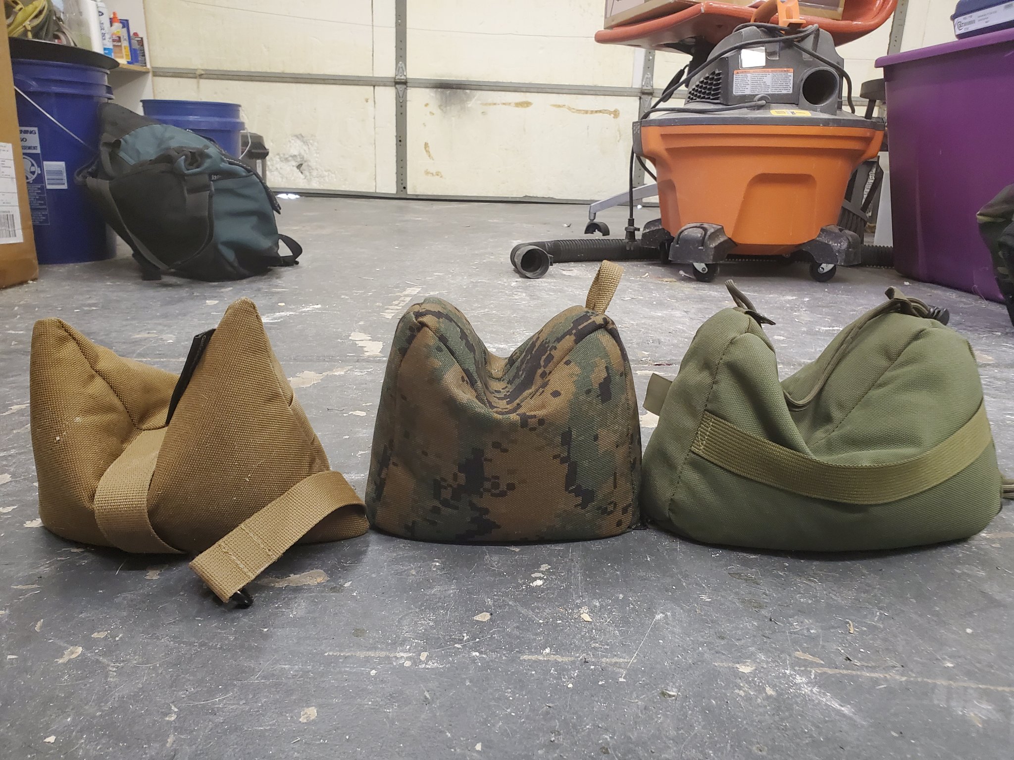

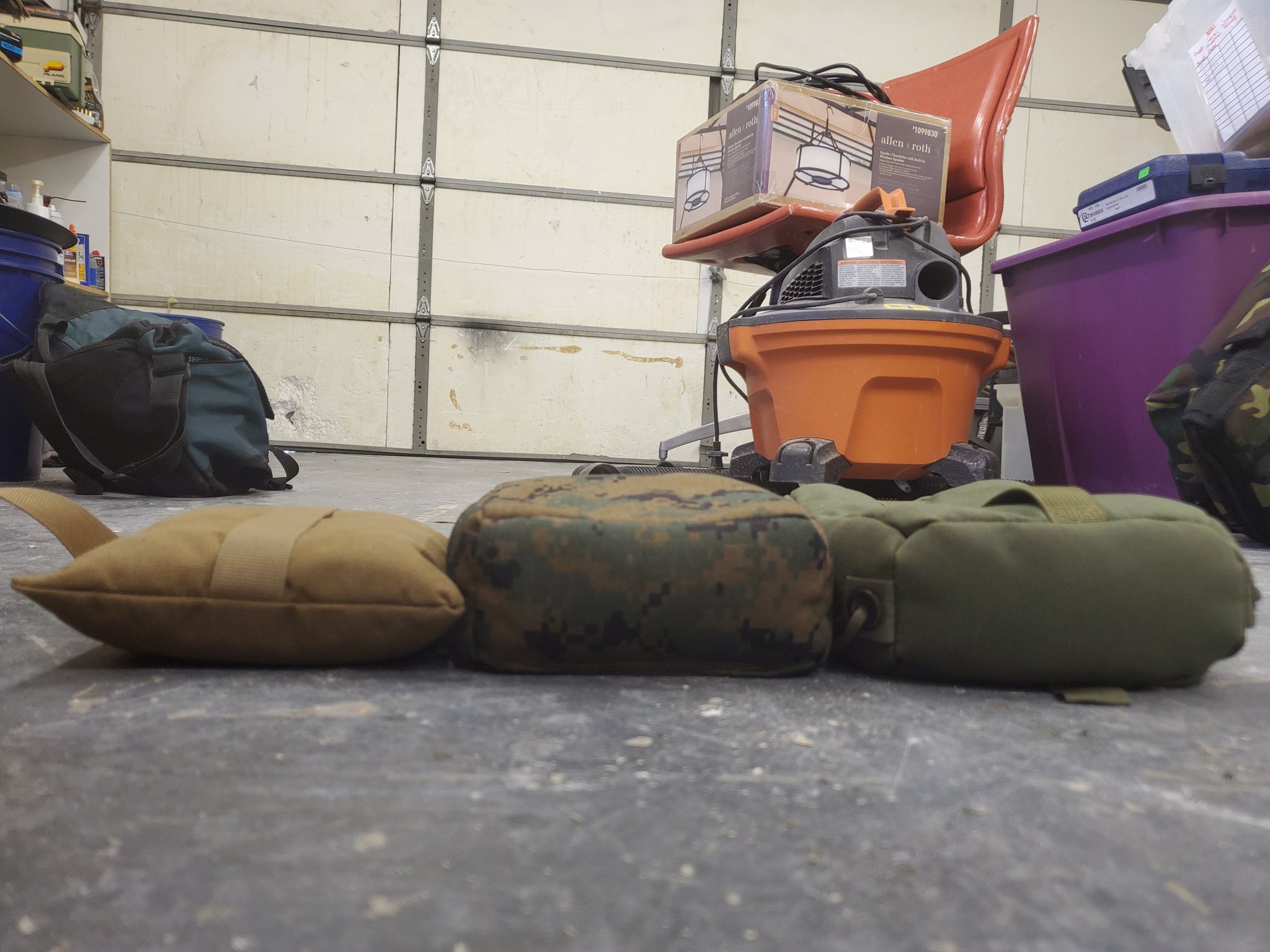

The way my rifle stock is designed and perhaps based on my positioning i often have to layer bags or find myself squatting lower that comfortable. It's too old a design and so doesn't have a bag rider.
Do you happen to make an 8 inch or 9 inch tall rear bag that would still fold up a bit to yield the rabbit ear configuration.....(preferably not a huge block /front bag type) if that makes sense?
Which bag are you using?
The large tab rear bag is 9" tall.
https://www.tabgear.com/products/rear-bag and works specifically for what you're basically asking for. It's not a PU bag but it works.
this is the bag i currently use but it's not a great design, there are little ring holes so filler leaks out...i finally was able to get some tape on the inside cavity, i teased it through the tiny fill valve so it no longer leaks but i seem to fight the bag, it's not forgiving...maybe it's the filler i'm using? walnut shell turns to fine dust and ends up leaking. I purchased some little plastic beads which are ok but the bag doesn't really conform to the stock (the tall side doesn't indent much if at all and if i use the 4 inch side it's not tall enough so i end up stacking bags...the other being a sock filled with rice.
i'll check out the tab rear bag...thank you
