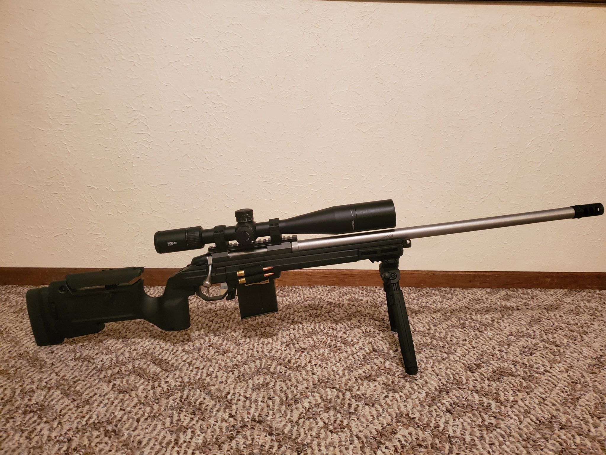

Got my barrel installed, and muzzle break on.....but need to remove a little of the handguard. Not a big deal with the tools at the shop.
Will say the finish and quality the barrel looks too notch. Planning on putting some rounds through it Friday, just for function tests.
