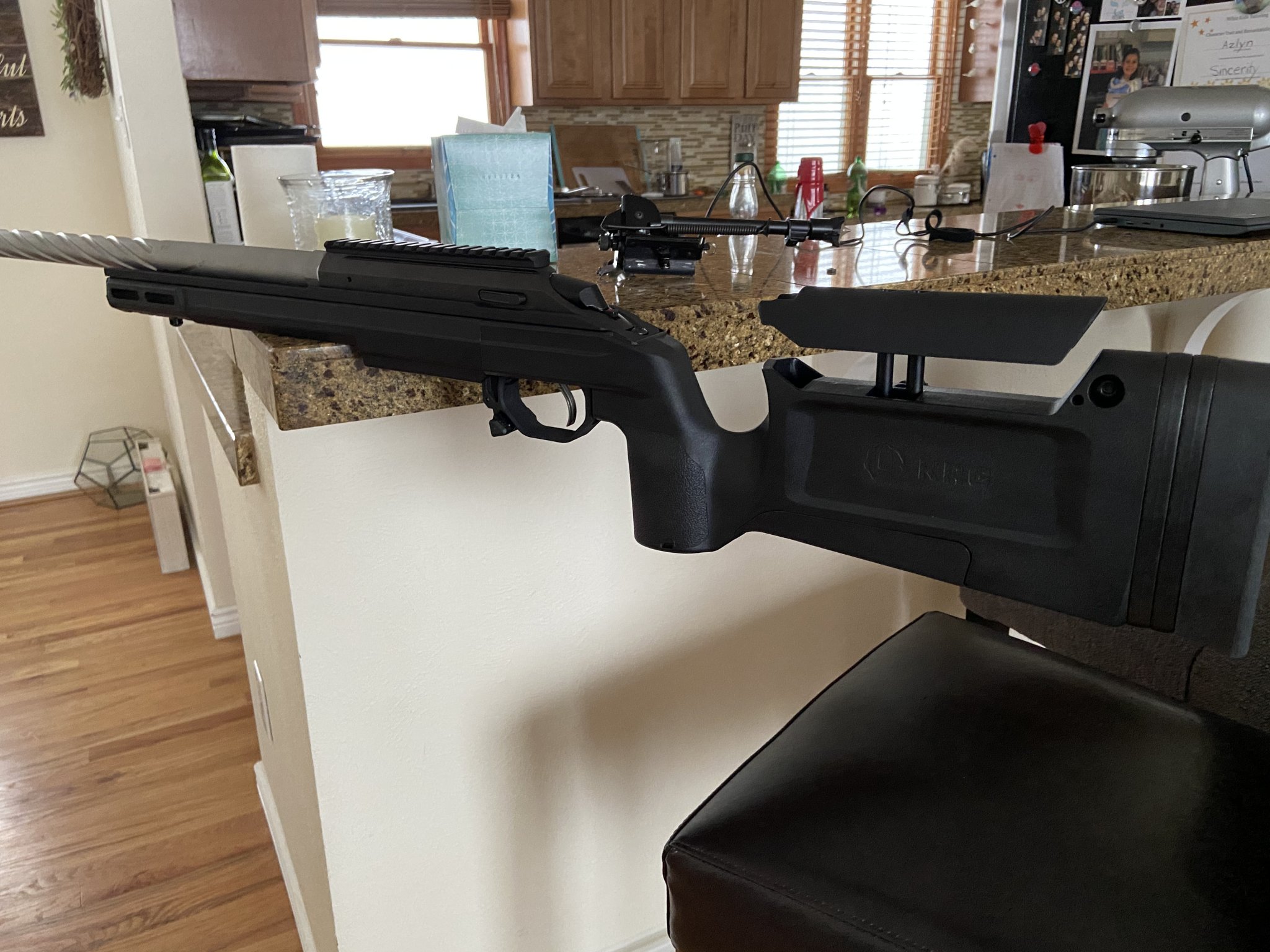

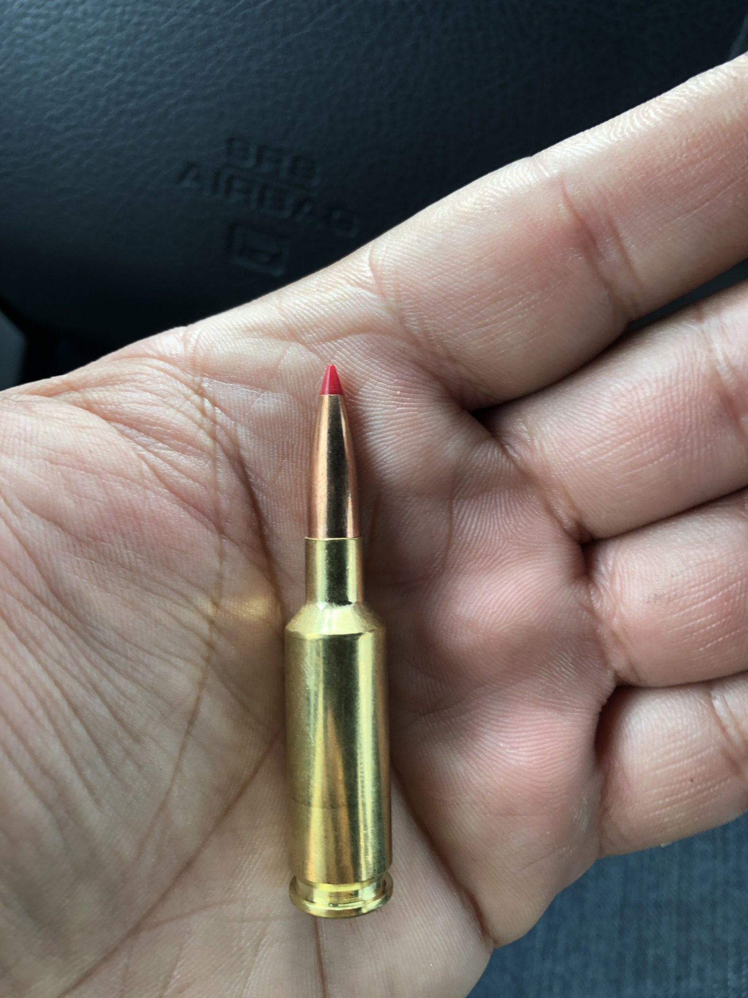

Well my 260 barrel arrived yesterday. I’ll try to put together as much info on it as I can and document my journey. Starting with the install on my origin, headspace and then see how the oal compares to my current 260 barrel. I think I’m gonna throw 60-80 rds of just a mild generic load to see if I get much of a change in velocity before starting my load development. My current barrel is crazy fast pushing 140 gr up to 3050 fps but I don’t plan on that for this one. It will also be interesting to see how the zero shifts both between barrels and between installs as I do plan to have multiple barrels for this rifle in the future.

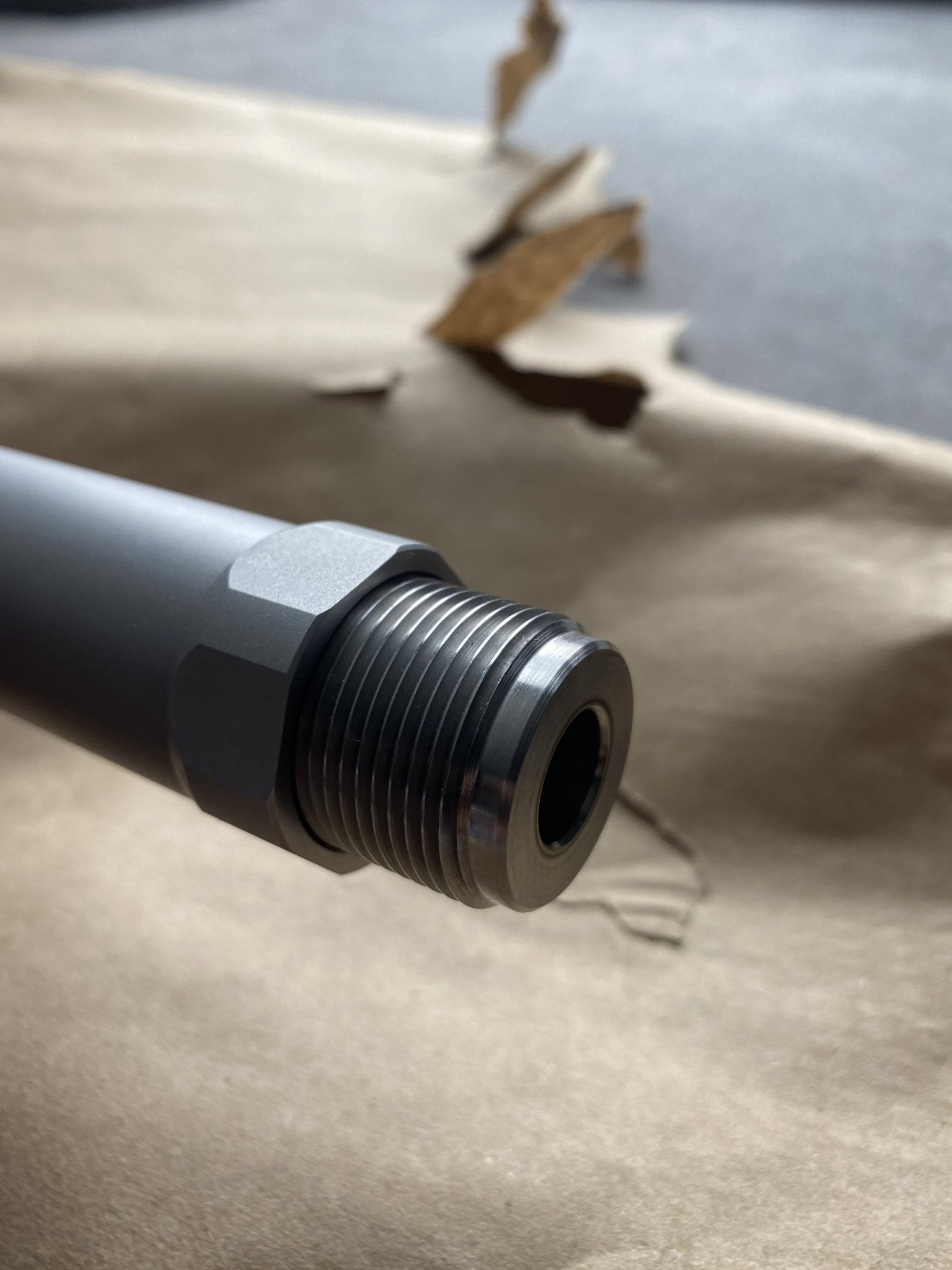

Finally got the time to rent my 224 valkyrie and to my dismay the tenon threads are no where near correct cant even get it to go two turns in. I'm very disappointed as I was planning on shooting it finally this weekend. My 308 barrel from them is perfect and threads on without any problem. Hoping they will make this right.
So I had that problem as well when I had received my pre fit barrel for my tikka. Called them and they sent me a paid label and got it back a week later.
Disappointing but, from what I've seen reported, they will make it right.
Bob
I messaged them today and was told I needed to send the barrel and action in cause they've never had an issue with the threads being wrong before. When I measured the tenon threaded though the 308s minor diameter is .003-.004 deeper than the 224, and the 308 barrel has a tight fit when screwing on. So I know it's not my action. Just waiting on there reply now.

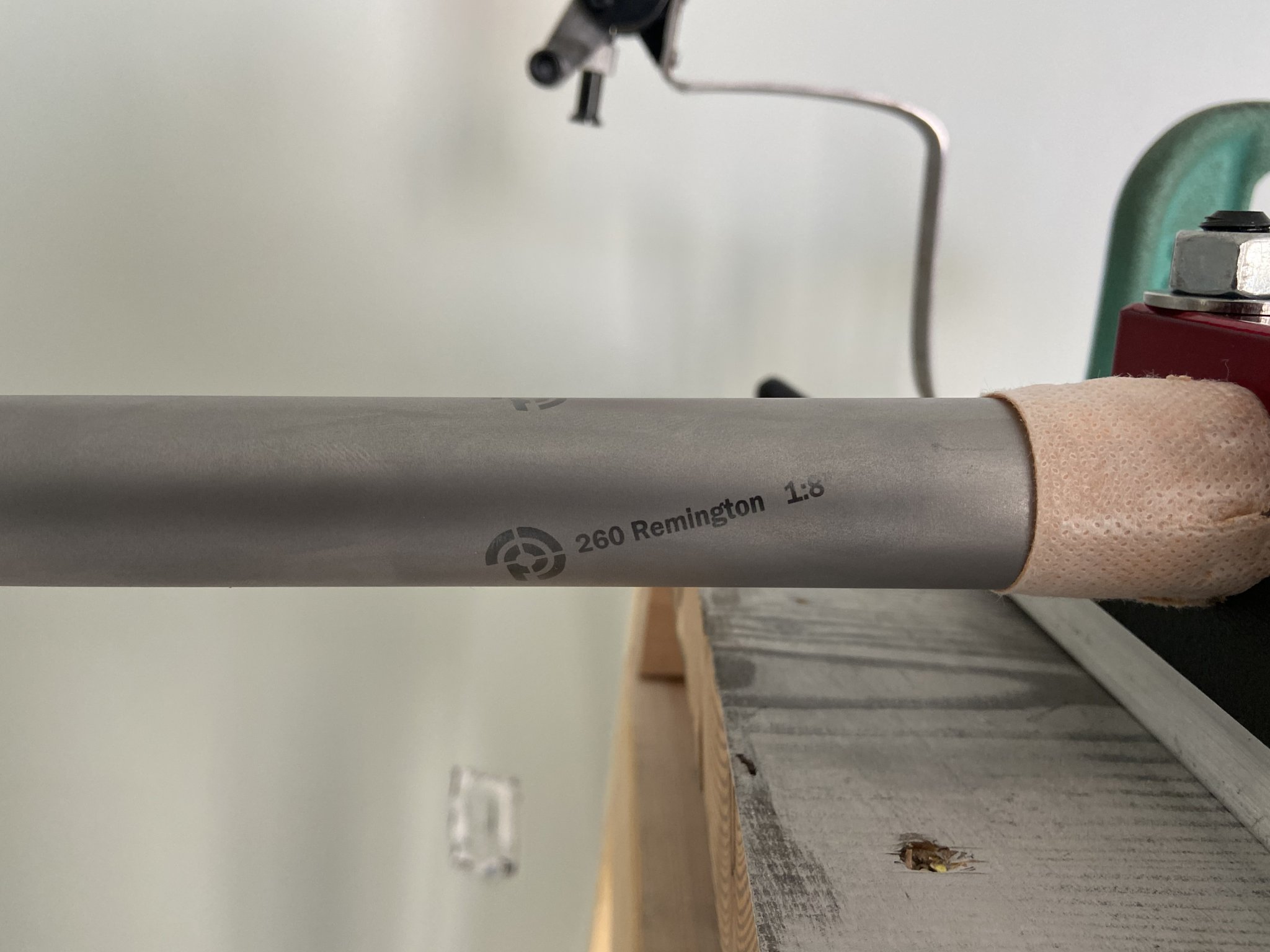

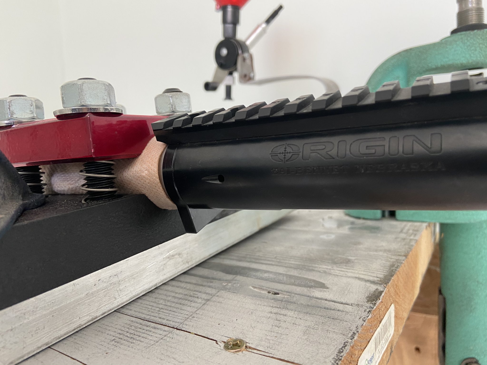

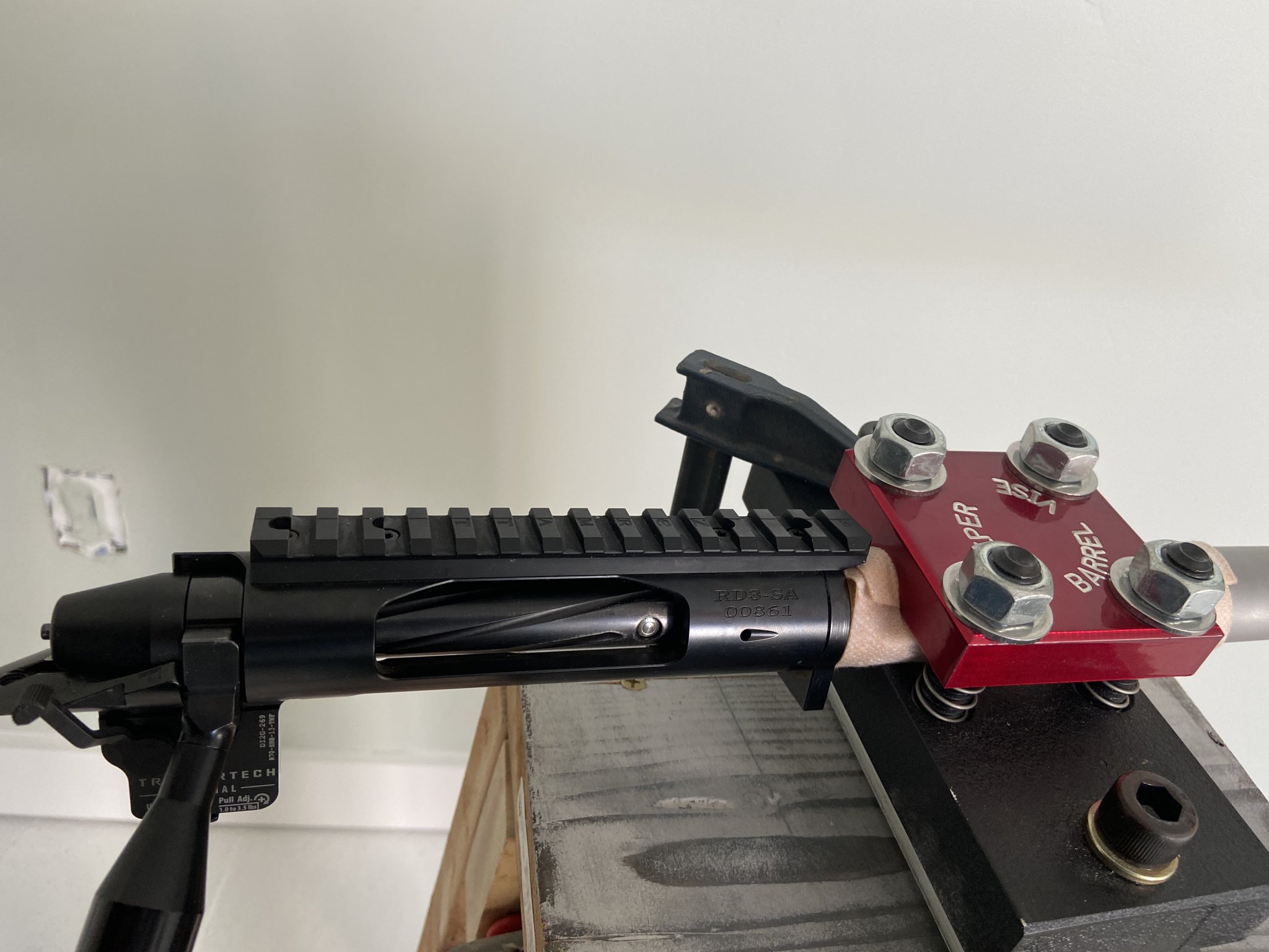

Well I got my 260 barre and it went on with zero issues. I was worried with all the reports of thread tenons not being correct, but for my origin action it was a perfect fit! In fact the threads had less slop than the barrel my smith put on there! Got it installed and the headspace seems spot on! Unfortunately I was not able to shoot it but I measured a few bullets to the lands and they are practically identical to my barrel from my smith. Must have used the same spec “match” reamer. 140s fit nicely in my mdt mag.
If you’re bored I attempted to make a video of the install.

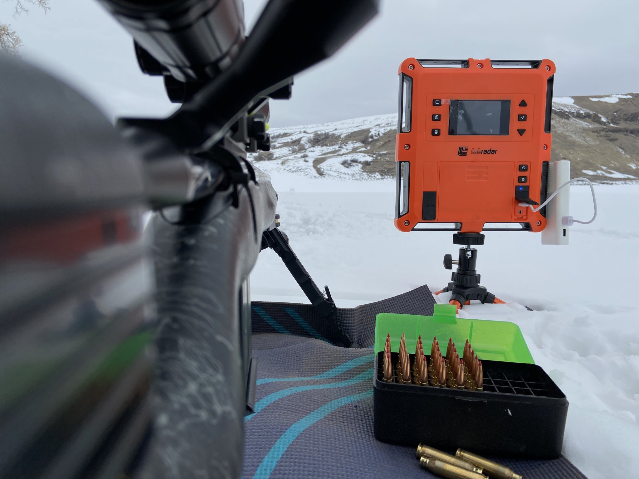

So holy shit this bad chicken can shoot. These are shots 518-538 on the barrel and rounds 40-60 after cleaning the bore. Didn’t get to run them over a chrono today but previous data for this load had them avg 2755fps and an sd of 10.3 across 10rds. Think this is gonna be my go to load until it sells. Running hornady brass, .290 neck bushing (Redding type s dies and comp seater) 20thou off lands and CCI BR lrp.

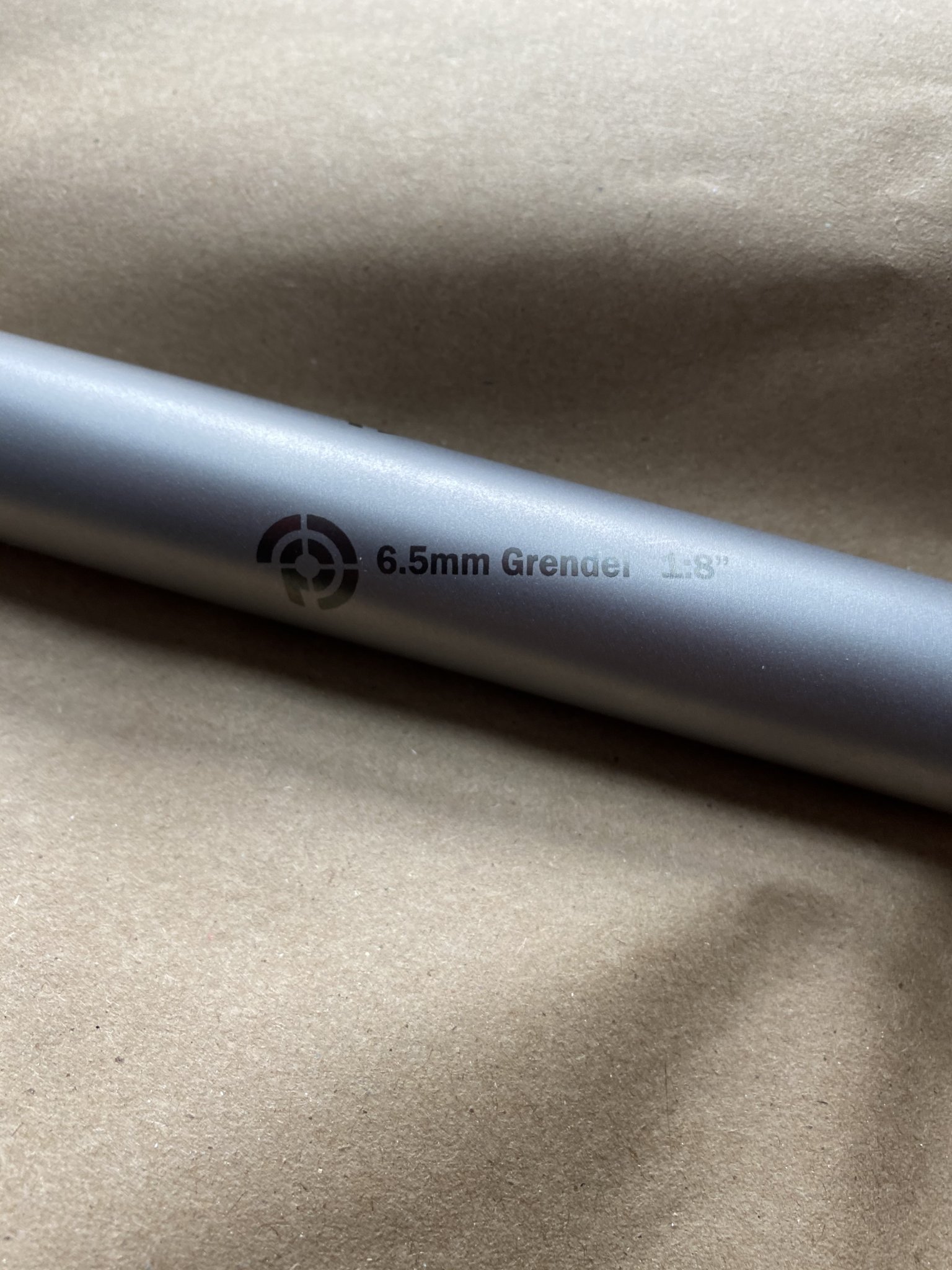

Any updates? I just read that entire thread trying to convince myself to get a barrel for a Howa and RAR in 6.5cm and 6.5grendel.
X-caliber barrles. 1/2 moa and they have sales once every 3 months that make it worth it. $330 for a savage pre-fit is hard to beat and I've put over 2500 rounds through it with no issues.

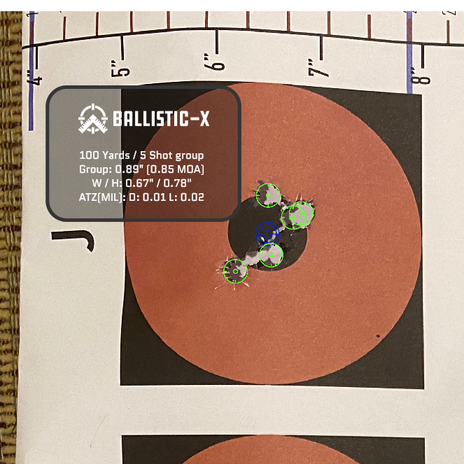

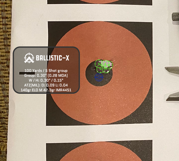

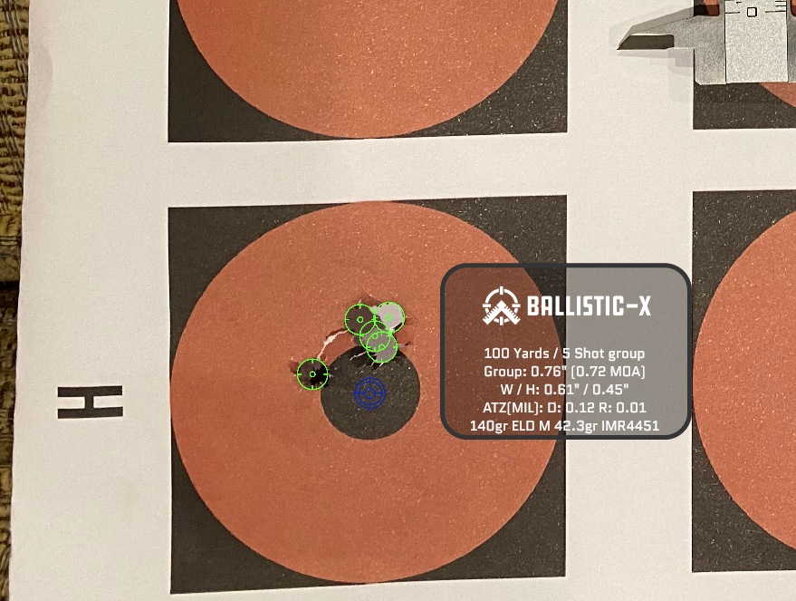

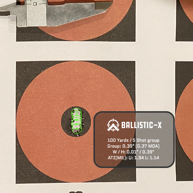

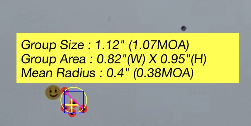

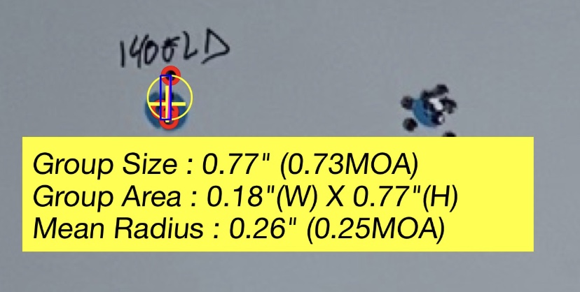

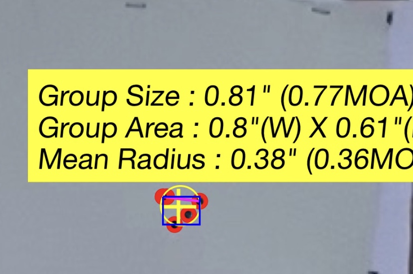

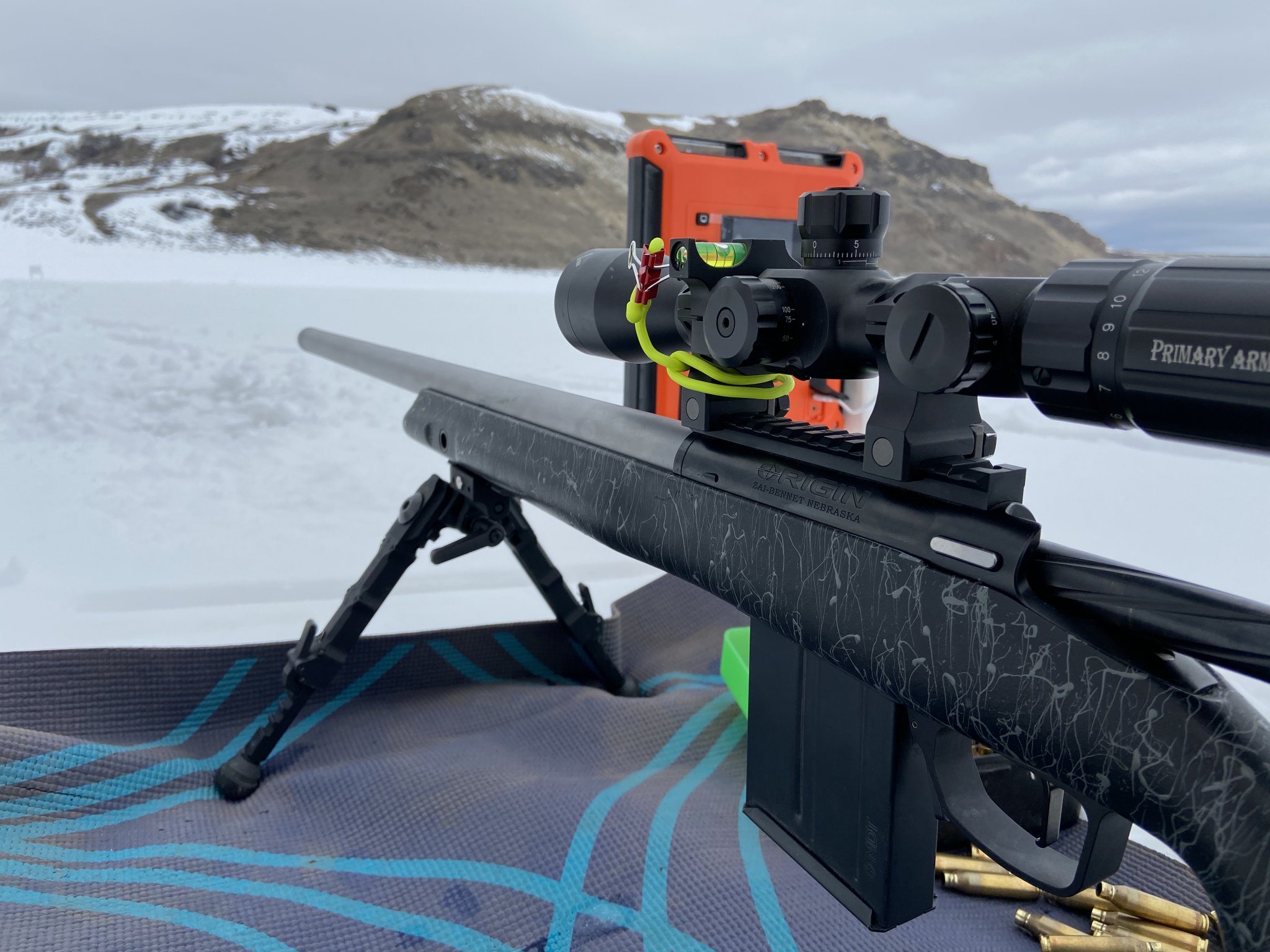

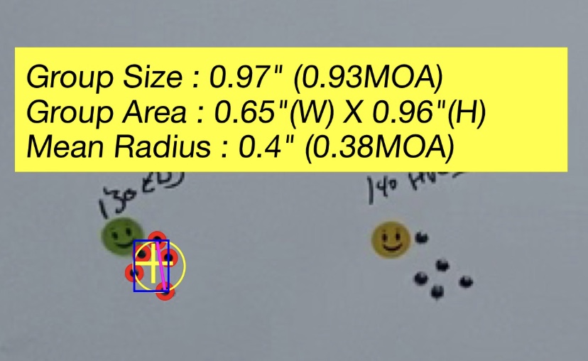

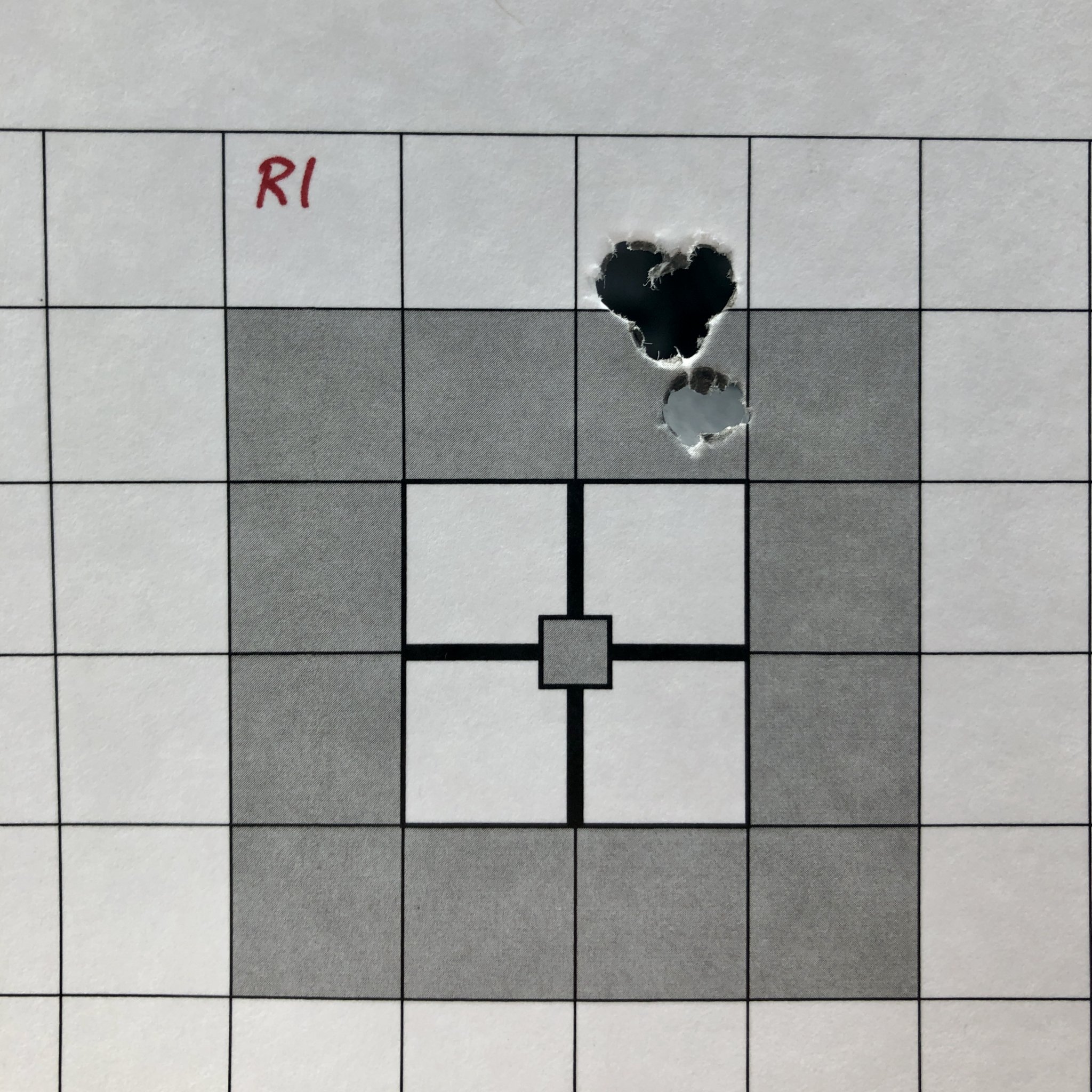

Well I finally was able to take my 260 out to shoot. I’m excited! I threw together a mediocre load and shot. I had contacted PBB about break in and they told me to just shoot it. Typically that’s what I do but it’s nice to have barrel mfg companies getting along with the times. I put 45 rds through it. 35 of them were 140 eldm and i chronograph ed 25 rds at 2795 es 21 sd 10.1. First 5 rounds through the barrel went into .77” group! Now I’m typically a .5-.75 shooter, seems like
More on the .75 than not. So I think this barrel is shooting as well as I can hold. Second group after adjusting sights were shots 11-15 through the barrel going into a .73” group. Now this group I was doing a terrible job controlling the rear bag and rear of the rifle as you can see from the verticale stringing. I loaded 5 of the 140 HVLD BERGERS at the yellow dot which shot .97” and same speed and sd. I loaded 5 of the 130eldm and they shot at the green dot going 2835 sd 8.4 and a 1.12” group. Next, I shot at a rock 654 yds away and put 4 rds in a row which appears to me to all hit within a 3-5 inch spot. After about 100 rds I will load up a little ladder test and see where I get pressures and what kind of velocities I can get. So far I’m really impressed being its a pre fit for my origin! Gotta love being a gun enthusiast in this day and age!!
That’s excellent yeah I’m impressed with their barrels. I’m happy so far as well.

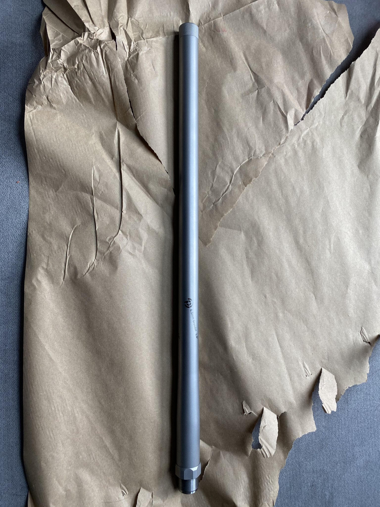

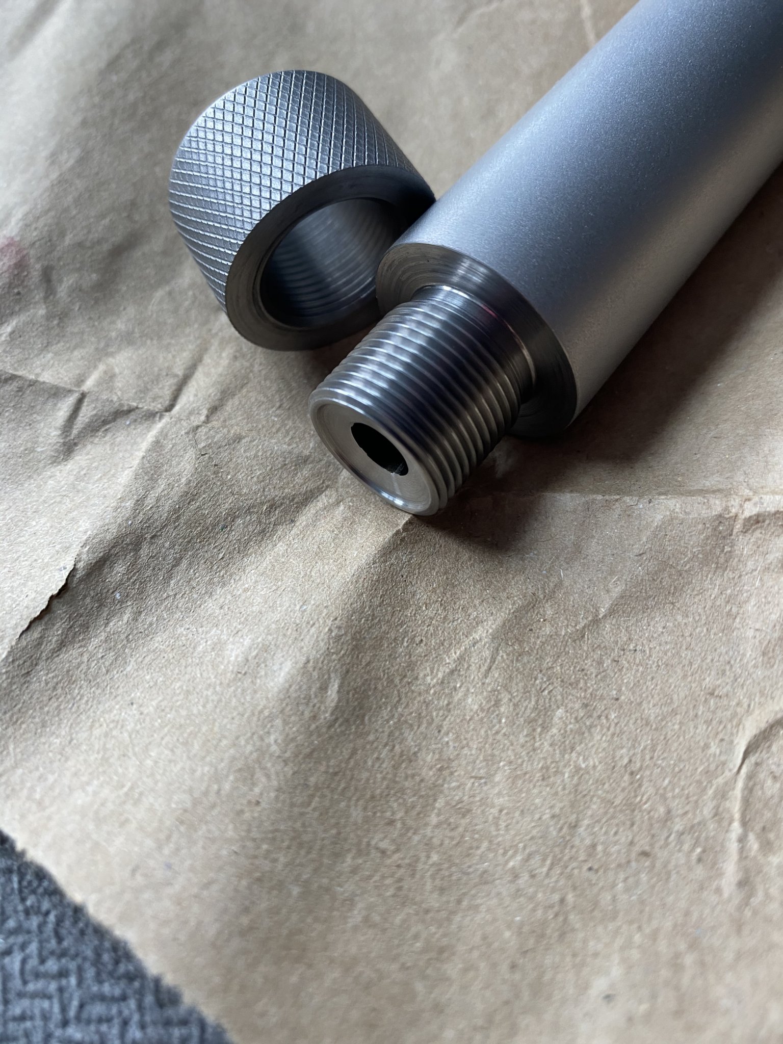

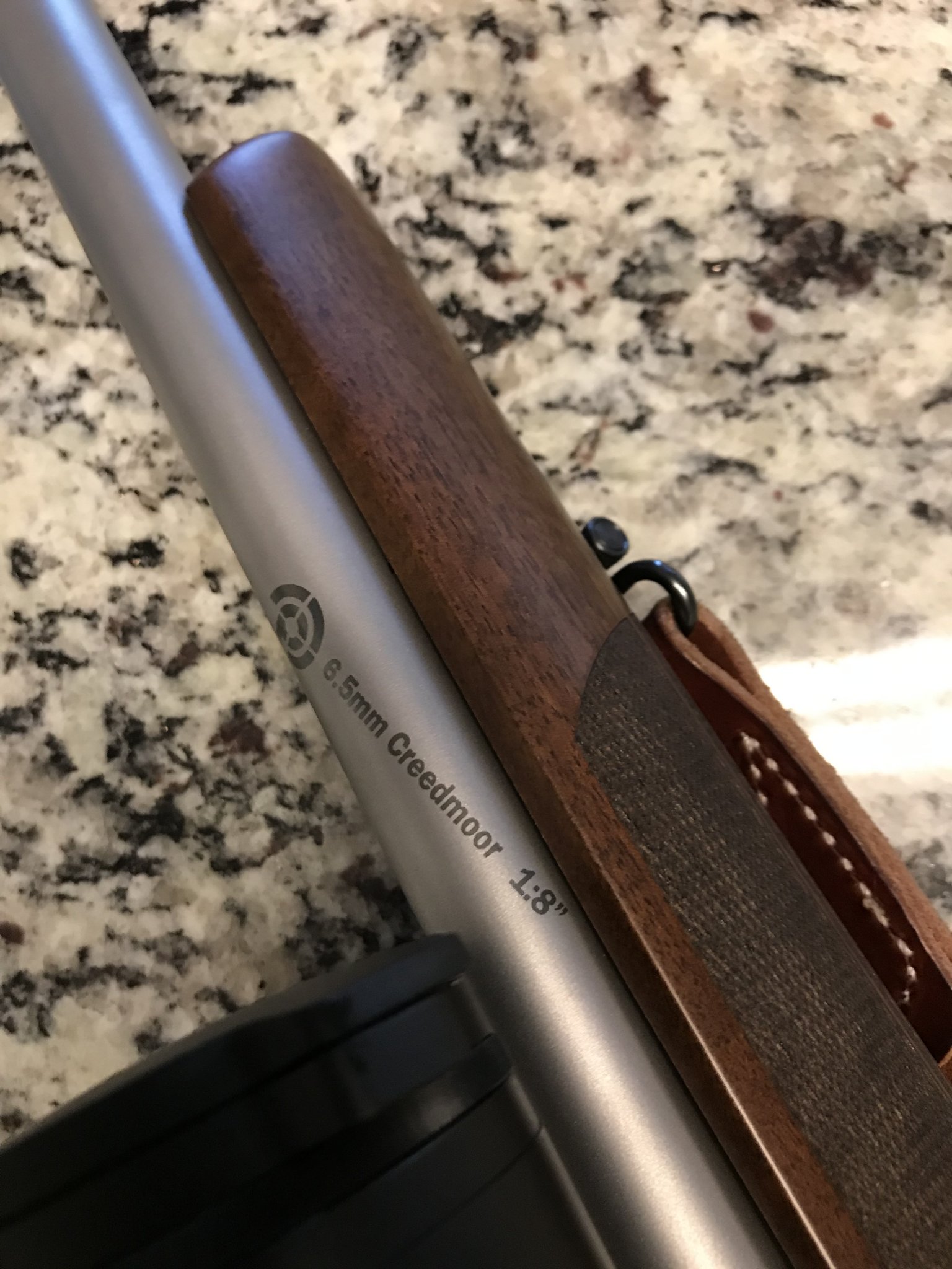

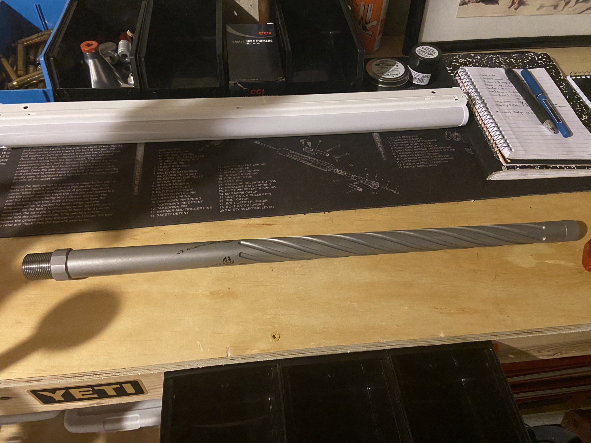

Got my 22” 6.5 Creedmoor PBB in today. First impressions are great. Beautiful barrel, although not the best picture. I’m excited to get this thing on my Tikka.

I now have 95 rds through this barrel. I saw a speed up. At shots 46-50 I was still at 2795. Shots 70-75 chronod 2845 and I had to take .2 off at 900 to keep hitting. I was hammering the 900 plate but when I shot my Last 5 shot group it opened up quite a bit, from the barrel speeding up I imagine.

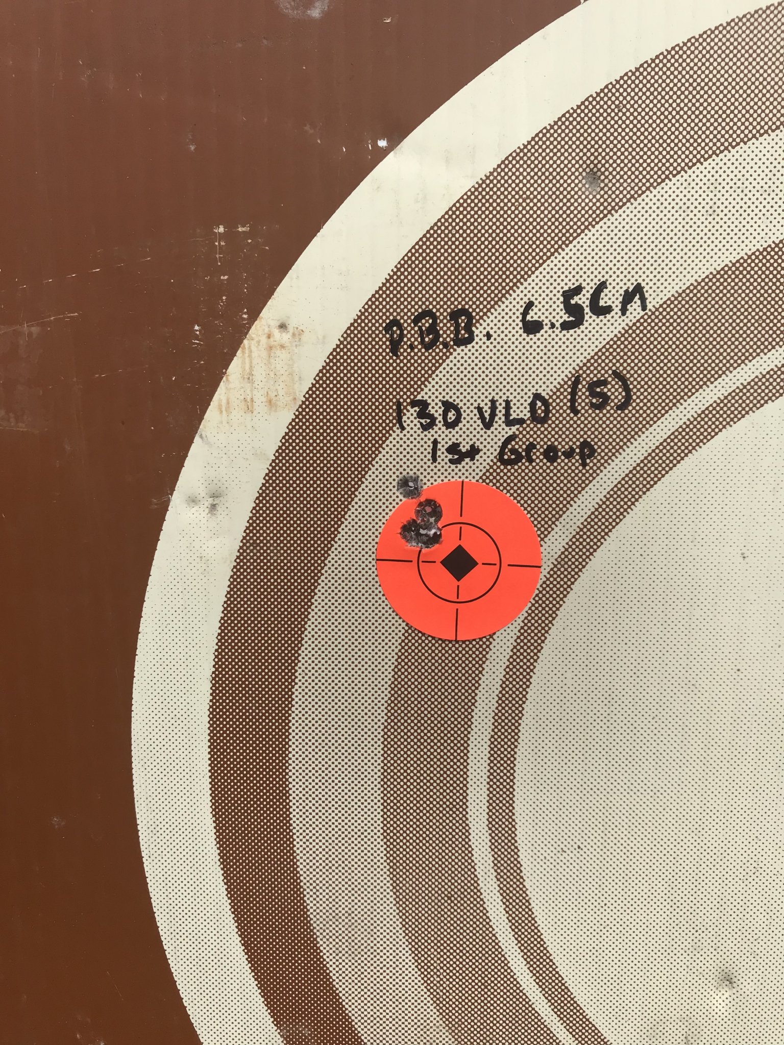

100 rds through one of their barrels right now. Load dev this weekend. First 10 shots out of the gun that I shot on paper were all sub MOA. Also get to see their barrels shoot regularly at comps as I’m local to them. They shoot well.
