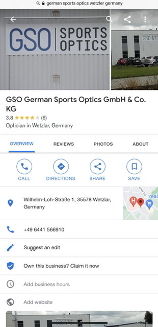

He’s likely referring to the these folks
