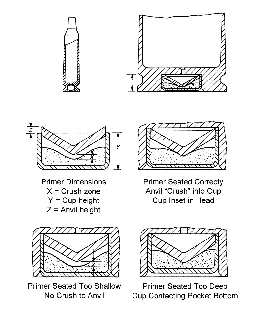

Ideally the primer cup will contact the bottom of the primer pocket to prevent primer creep and the anvil will come into contact with the primer compound. Primer pocket depth can vary from one brass mfg to another, so you will want to measure it with your caliper depth guage. Seating consistency can be affected by factors such as the priming tool being used, case rim thickness, or the user.

Primers aren't a one-piece thing. There's the cup, the anvil, and the compound. The primer as a whole should be seated deep enough to where the anvil is contacting the bottom of the pocket, but (usually) not so far as bottom out the cup in the pocket. You can't (generally) compress the cup itself. The post before this shows this graphically.
Measure the depth of the primer pocket - say 0.125". Measure the height of the entire primer - including the legs - e.g. 0.121". Now take the tip of the blades of your calipers and measure the height of the cup itself. This part is a little tricky, getting in between the legs of the anvil, and with the radius of the cup, etc. Let's say this part is 0.113".
Given those numbers, you'd ideally want the primers seated at least 4 thou below flush - the primer pocket depth (0.125") minus the primer height (0.121"). The primer pocket depth (0.125") minus the primer *cup* height (0.113") gives you a total depth range of about 12 thou. So somewhere between 4 and 12 thou would be an acceptable range, given these specific numbers. 3-5 thou of 'crush' seems to be a pretty common range that works for various folks.
Usually when you see people refer to primer 'crush', they're referring to feeling the primer 'bottom out' in the pocket, and then begin to compress, consolidate or 'crush' (depending on which literature you're referring to) the anvil a small amount. Lots of people do it entirely by feel, and have perfectly good results. Other people like being able to attach a number to things, and go down that path. Whatever works for you.

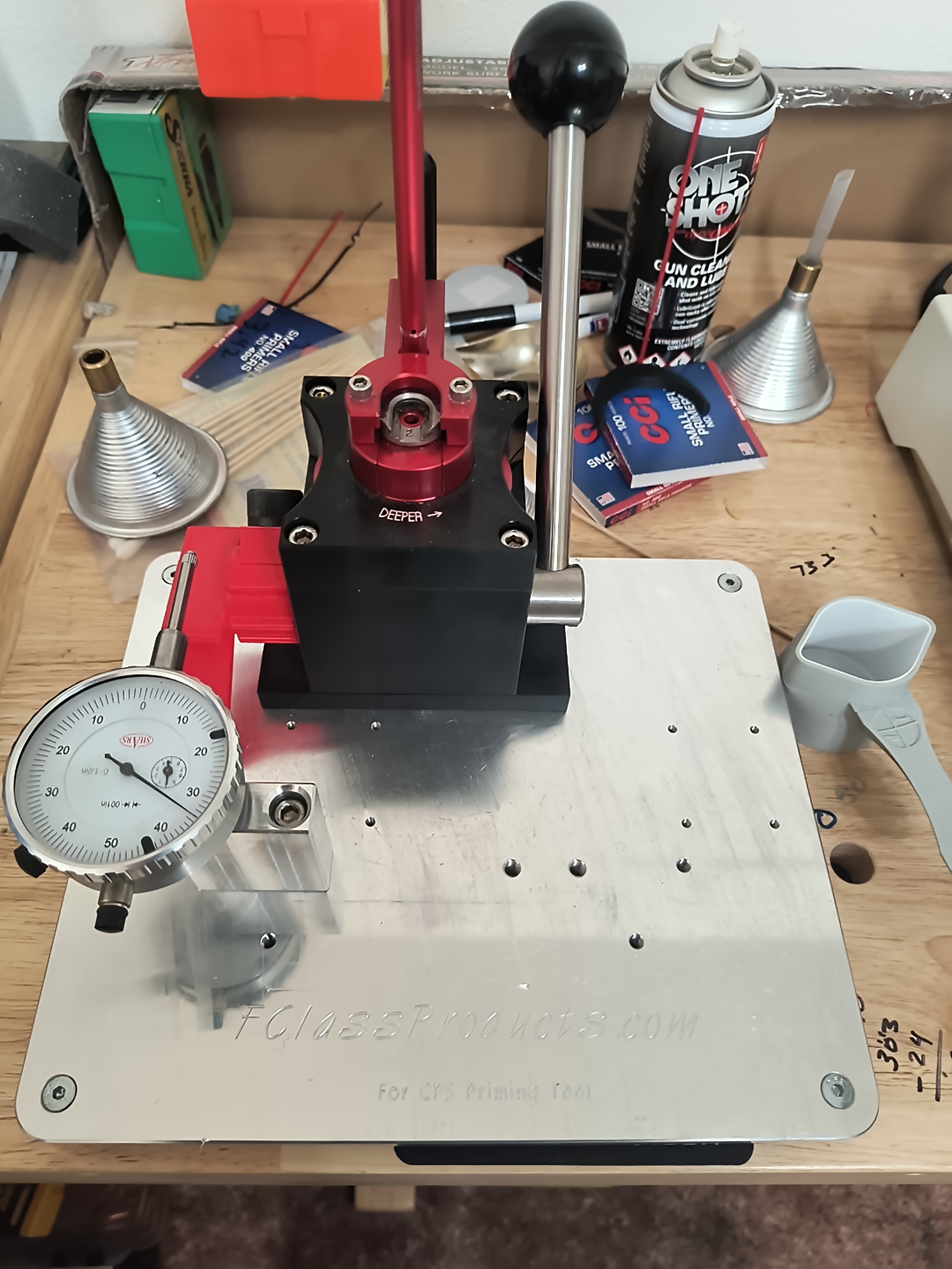

Variance in cup height, anvil protrusion & rim thickness led me to seating the cup to the bottom of the pocket then applying a specific crush. This is with a uniformed pocket.
Even if you're pockets are within a thou and you measure every primer and get it installed exactly as the math would indicate you still get a variance from rim thickness.
I use a Primal Rights seater on an F Class products base with indicator to measure the crush.
From there I'll sort the primed cases for below flush of the case head. I know it sounds like a lot but I'm still only handling the case one time in the priming operation.
