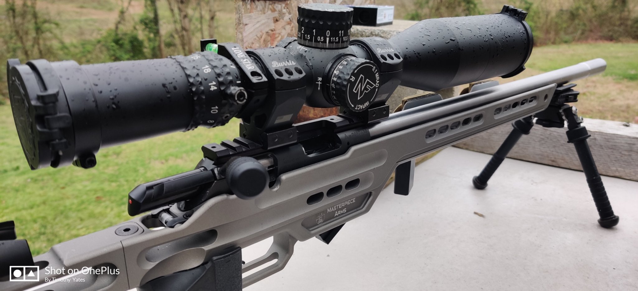

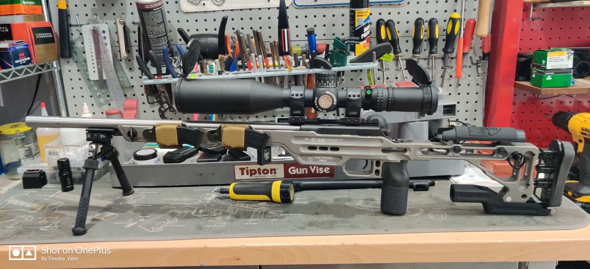

Yeah, those are very very nice. I don't have the folder but do have the non-folder.
