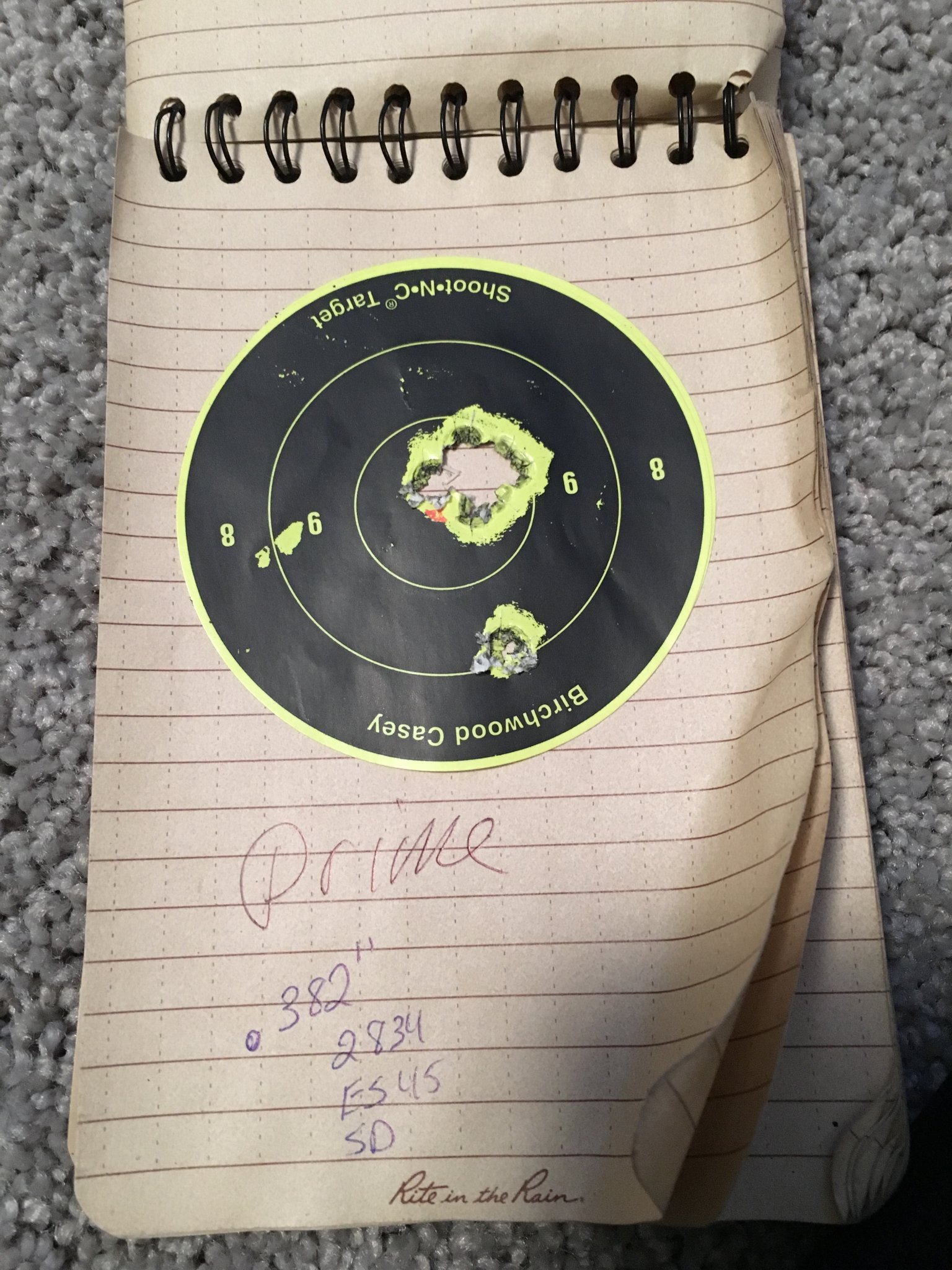

Here is a picture of the first 10 rds out of the Proof with prime, shot 1 and adjusted, the following 9 are in that hole. It’s consistently printing sub 1/2 groups but ES is pretty high, not a factor if you’re inside 750ish. 3 rd groups have been in the .2’s and better, not saying that’s the norm...overall though it’s a great barrel and I’m happy with it.
ETA you can sell that once fired prime brass for a descent amount...

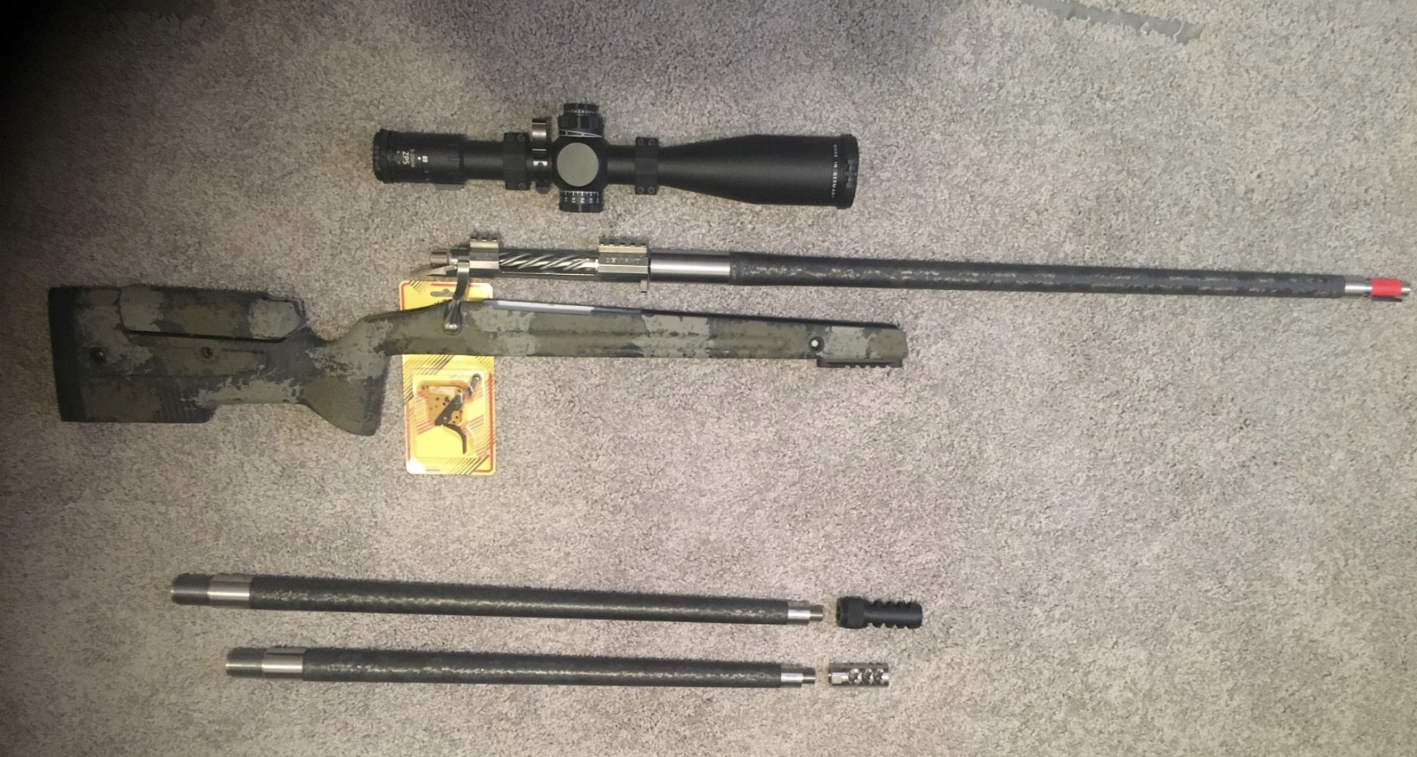

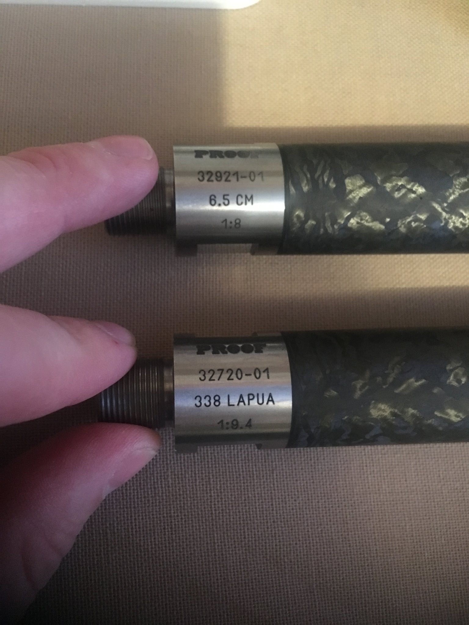

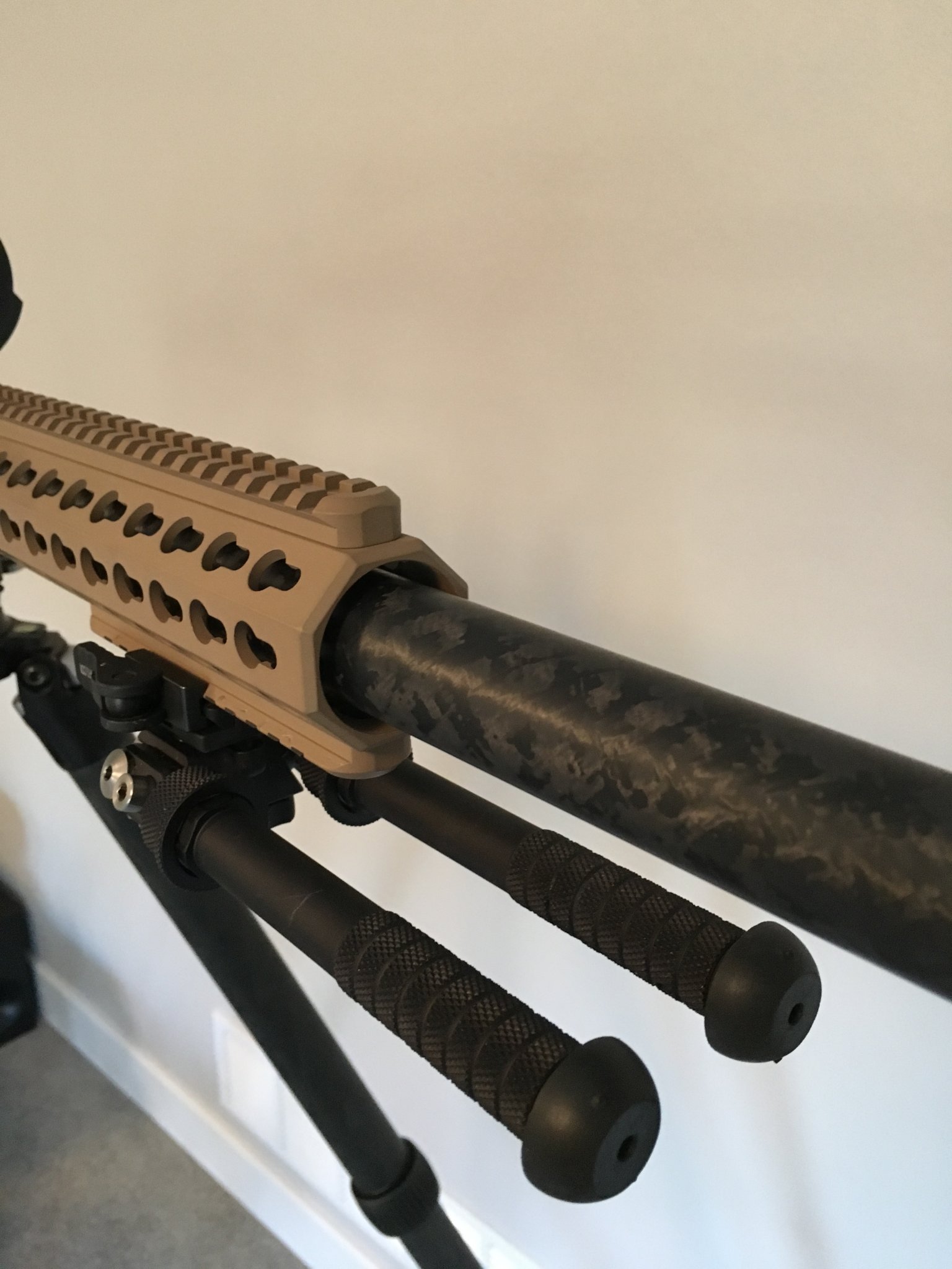

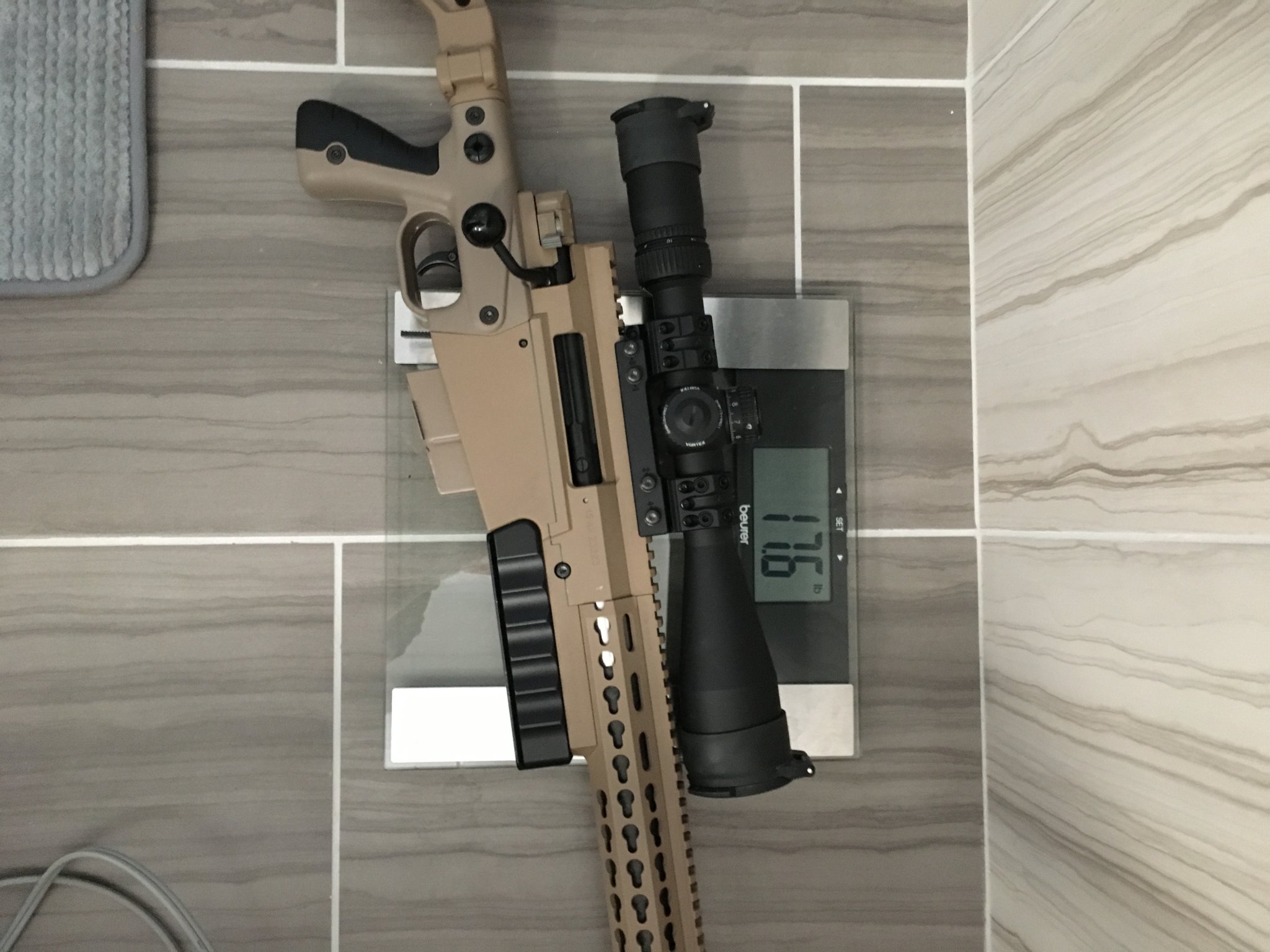

ARRIVAL!
24” 6.5 CM - weight 3.6lbs - BTO 2.250 to lands with 140 Berger - total weight 17lbs with Atlas, magazine, & PVA Brake
26” 338 LM - Weight 4.0lbs - BTO 2.965 to lands With 300 OTM Berger - total weight 17.6 lbs with atlas, mag, and hellfire Brake
The chamber for the 6.5CM is identical to the .001 of my 6.5 Barrel from Tooley
The Chamber of the 338 is .060 shallower than my Factory 338......Thank goodness. I hated loading to most common BTO to clear the mag which happened to be .100 0ff the lands WTF right. Looks like a common BTO to clear the lands will be .040 from the lands, I’m digging it.
These boys are fatties! Lots of carbon fiber on these ones, a lot more than my 338 sendero that’s headed out for assembly tomorrow. The brown truck dropped off a but load of stuff today, like Christmas in March!
If you want something measured or have questions fire away, I’m not flying this week so I’m just going to finger F my new kit and load some test rounds. I also have 300rds of prime to try out that should be here by Friday. I just want the brass and to see if it’s as good as people say.
