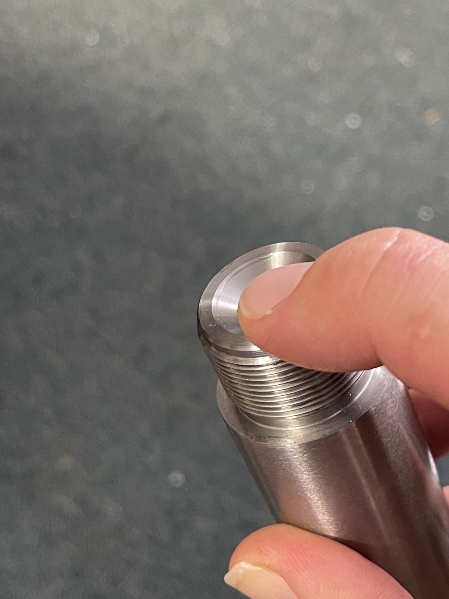

The geometry of the ARC Coup chamber cone was updated early on in the production actions due to an extractor geometry change and that was causing actions to drag the extractor across the bolt face when the bolt was being closed. It leaves a characteristic mark as seen in the photo attached.
Discussion:
The photo attached is a false positive. Yes, it left a mark on the chamber cone, but it's not repeatable with a cartridge in the chamber or with a trigger installed. In fact, now that we have data on this and have realized that many folks testing them aren't aware of the proper test procedure, it's very likely that none of the PVA prefits we have ever shipped truly needed to be modified because we had appropriate clearance to start, however out of a modicum of caution for customers we made a change and ensured 0.010" of clearance on the extractor nose to breechface.

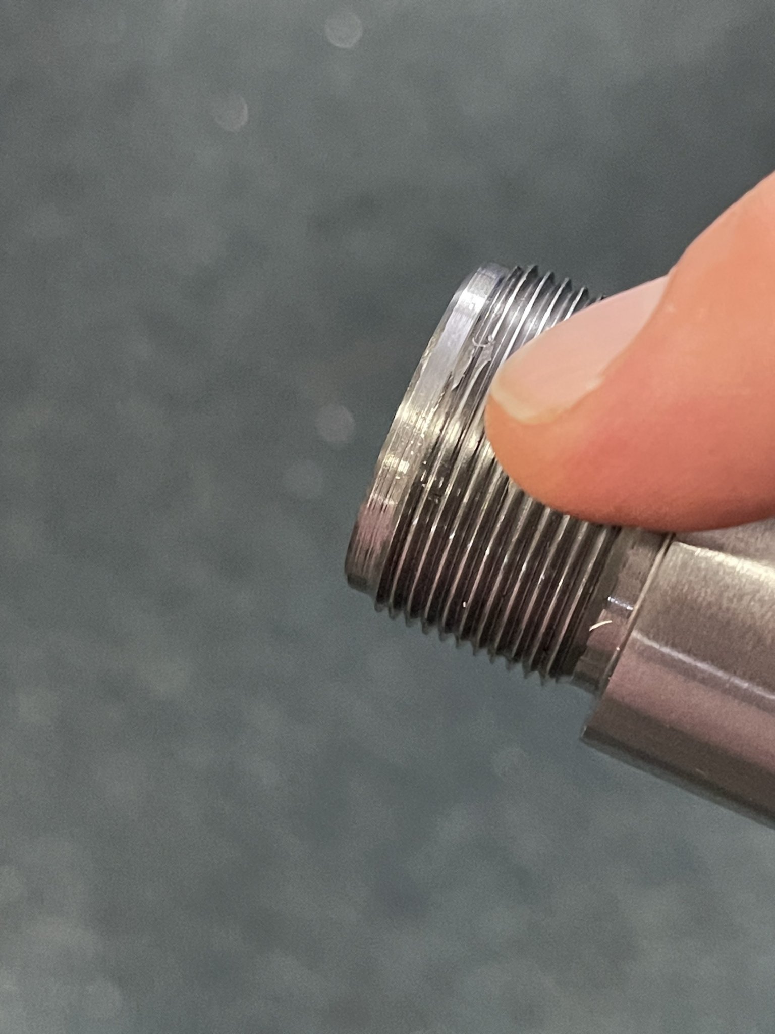

Note that the second picture shows a damaged tenon. The barrel in the photos showed up for the call "My Coup barrel is wrong, send me a call tag". The customer sends it in and packs it poorly, which the package handling hyenas can smell from a mile away, and the barrel gets damaged on the way here. Insurance right? Nope, not a chance... "improper packaging". Unfortunately, now the barrel does need fixing, but not for the reason originally thought.
Barrels must be tested under one of two conditions: With a GO gauge in the chamber OR with a trigger installed and set to SAFE. These two conditions are critical because otherwise the clearance in the actions will allow the bolt nose to come forward approximately 1/32" and it will ALWAYS touch the breech face. This is not unique to the Coup. It will do it on a TL3, Origin, Defiance, Impact, Lone Peak, etc. If you take off a barrel from a TL3 that's been on there for a few hundred dry fires you can see a shadow of the bolt face on the breech face. It doesn't mean anything is wrong, that's just how these machines work.
Proper Test Procedure:
1) Sharpie the chamber cone and Install barrel
2) Put in a dummy or GO gauge
3) Close the bolt several times on a chamber that "loaded"
4) Remove barrel and look for the mark that is shown in the first photo.
Alternate if you don't own a GO or can't make a dummy round for some reason:
1) Same as above
2) Install trigger and put the trigger on SAFE
3) Same as above
4) Same as above
Important Detail: If you test on an empty chamber you will be able to create a swipe mark every single time you attempt it on a Coup. It's a false positive.
