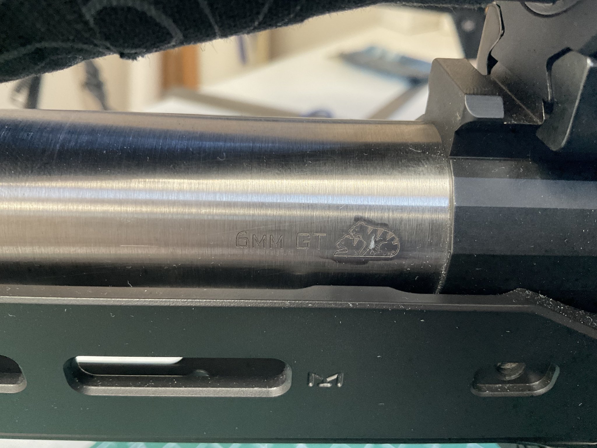

I vote dasher. I personally run BRA right now, and it's excellent. I shoot it at 2785 FPS with 105s or 109s and Varget, and it's great, BUT: I could run the same node in Dasher with 8208 XBR, Varget, h4895, or h4350, and you likely have access to h4350 more often than you do for Varget or h4895. To top it off, I could also run my bullets in the 2950 node if I wanted, which I'm not really willing to do with my BRA, because faster component wear at that pressure.
I had a 6 GT before the BRA and didn't love it. Speed was great with h4350 and 107s, but feeding in a KRG was a no go. The only magazine I could reliably get it to feed from was an ARC mag, and there is no shortage of BR mags for Dasher, and I kind of wish there were an AW mag kit for the GT, but there isn't. GT seems to me like a solution searching for a problem. I never had issues with my 6 XC with speed, load development, or feeding, and I had issues with feeding in the 6 GT at the same speed as the XC.
TL;DR: Dasher can do anything with any powder/bullet combo unless you want 3050 FPS, and you don't want 3050 FPS.
Is lack of reliable feeding the only drawback to the 6GT ?
> Is lack of reliable feeding the only drawback to the 6GT?
In my opinion yes. Both me and another local competitor have had a ton of issues with GT whilst everyone else running dashers gets the same ballistic performance but no feeding issues with their MDT mags, AW HRD mags, and ARC mags. Obviously some people have no problems with the GT, so I'm not dogging it, but if you're about to dive into the short cased 6mms, it's worth noting.

Surprised on feeding issues with gt. I've ran gt on impact, origin, and nucleus using pmags, arc, and mdt without much hiccup. I know guys running gt on ai rifles install hrd kits in aw mags but thin the rear block plate a bit and have had good luck with that.
Reactions: pengilly
I think it depends on setups. I run KRG chassis where all my buddies run XLR and we all have different issues. The guy I know who had problems ran an MPA. The biggest problem is that as the rounds move forward in the mag under recoil, the back of the top round becomes unsupported and the bolt fails to pick it up. I had other serious issues running GT in an accurate mag too. I switched to ARC mags and the problems mostly went away. Hrd with a thin back plate sounds like a win. I wish hrd would make a GT plate.
