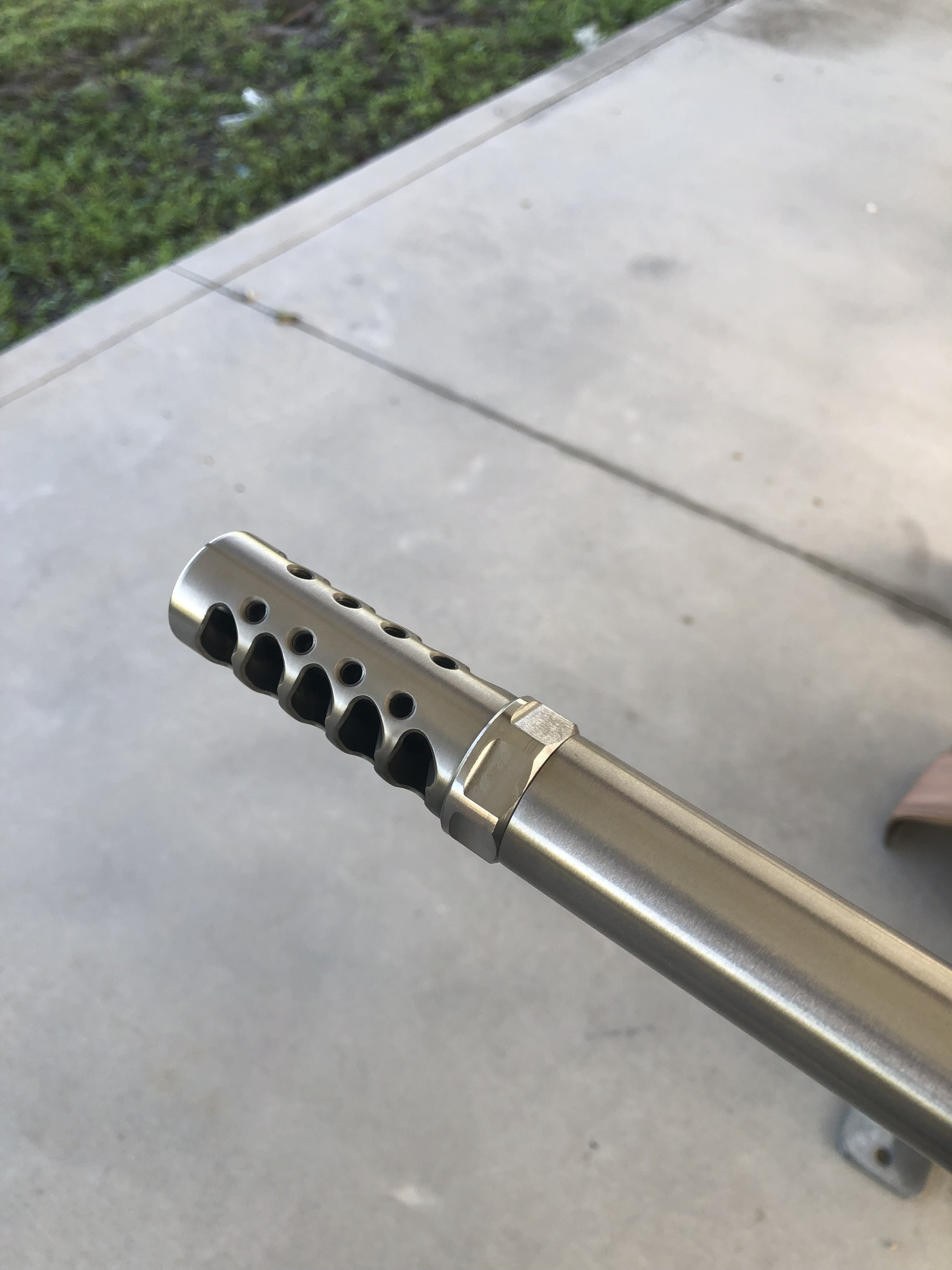

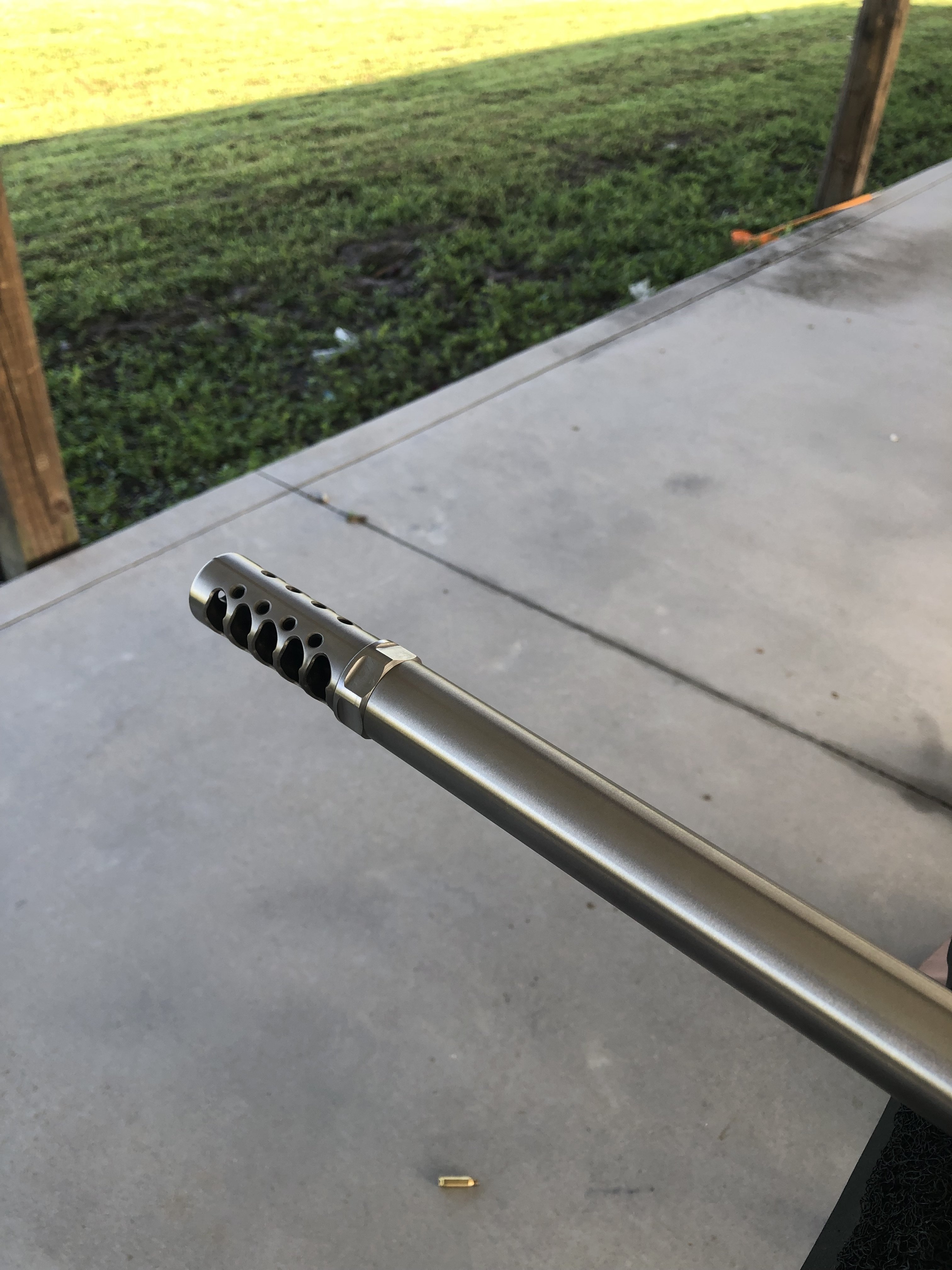

after building numerous rifles that weren't quite ideal I will toss in my advice. go with a straight no taper as it puts more weight up front and 26 is a good length but 28 will give you a little more velocity and weight up front. I totally don't see the point of a tapered barrel in a PRS rig. I go with a 28 inch 1.1 diameter and the new fat bastard brake. it balances perfectly with no weights.
