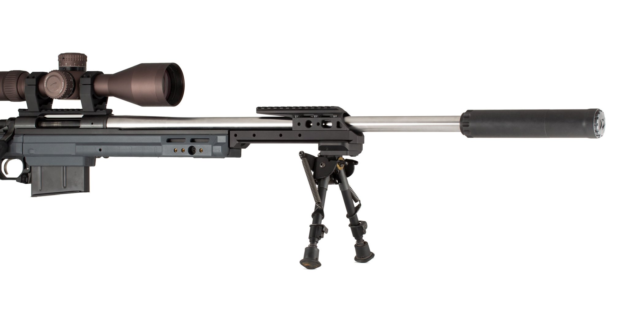

No, I have not tried a bravo. I have just found that if I cannot reach the bipod with my support hand from behind the rifle, it is too far out for me. That bit me in the ass once “on the clock.” If I am not mistaken, I went home and bought a full length arca rail for that gun. If it wasn’t immediately after, it was before the next match.
That said, the stocks you posted do look kinda short on the fore end.
They are short.

Have you looked at the heavy accessories for the butt of the bravo? Might be able to bring that weight a little more centered
No reason to buy accessories just for weight. Fill the rear with some lead shot and you will be fine with rear weight for cheap.
