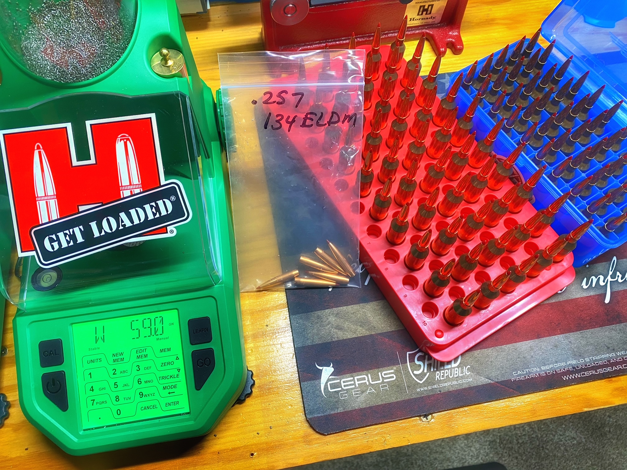

And now... add the Hornady 134 ELDM to the mix !![]()
59gr retumbo in a 25 prc or what?
Thats like a standard load for the Creedmoor around here.59gr retumbo in a 25 prc or what?
If you hover over the pic it says 25 SAUM59gr retumbo in a 25 prc or what?
Ahhh got ya, prob H1000 and N565 then in a saum.If you hover over the pic it says 25 SAUM

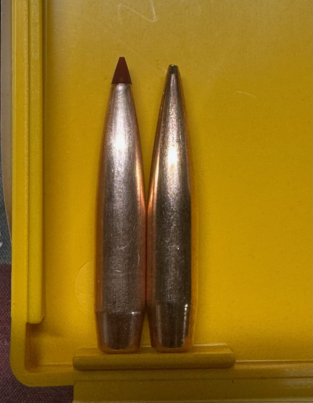

Look at the difference in boat tail lengths. Bearing is near 0.050 longer than Berger? Can't tell but that bullet needs 180-200k freebore by the looks of it.

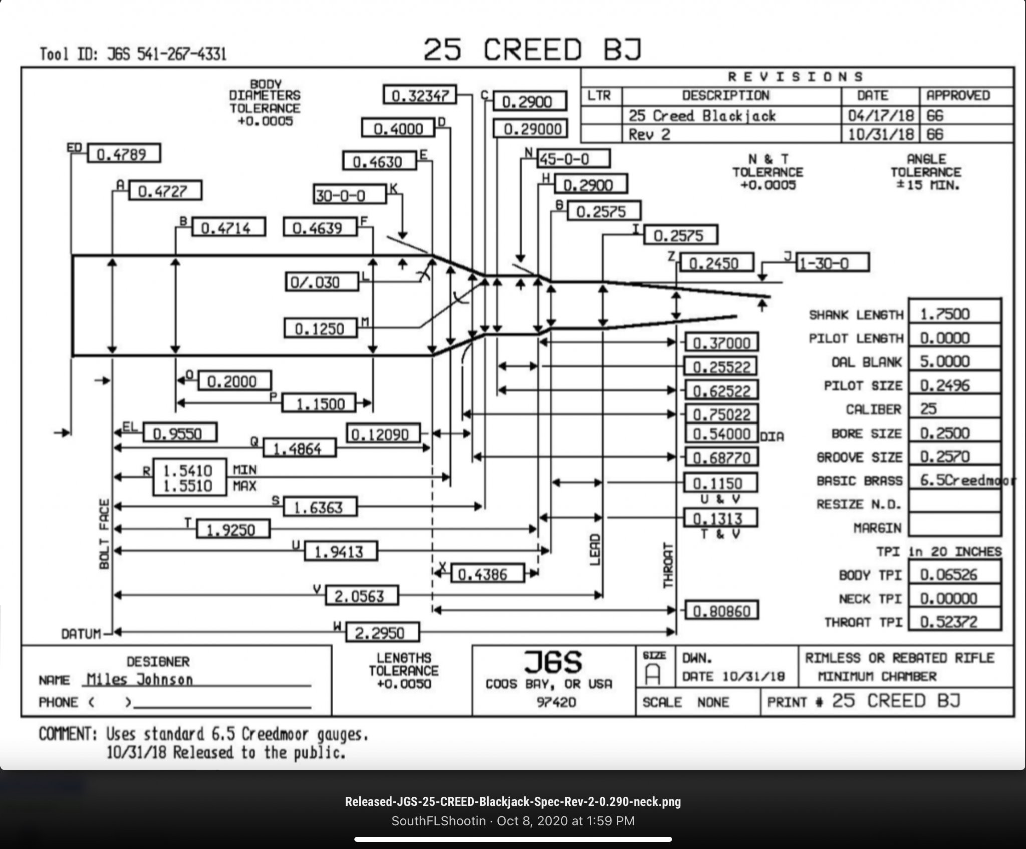

The diagram I’m posting should be your reamer. The only difference I see over version 1 is a little more clearance in the throat to lessen the need for neck turning. Hope it’s been shooting well for you.135s with a standard Blackjack reamer here too… no issues. Wouldn’t mind a little extra freebore but not really a hinderance in its current state. I’ll see if I can get the dimensions from my smith.
