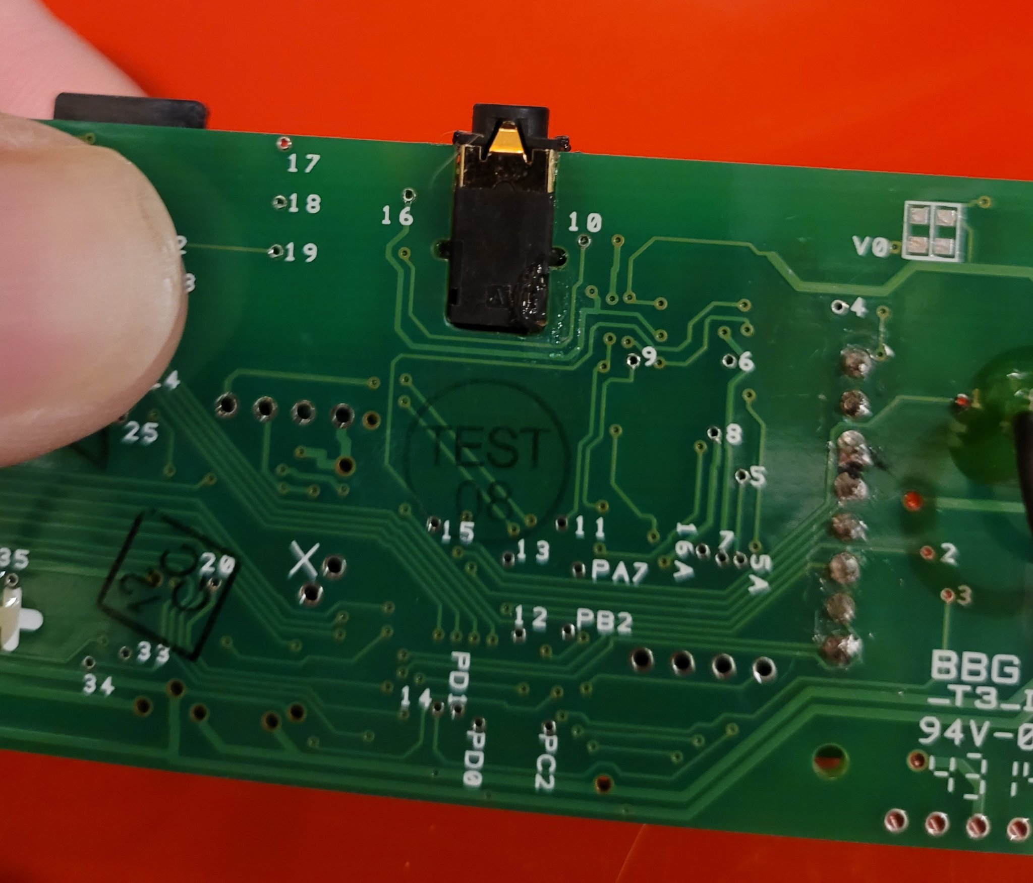

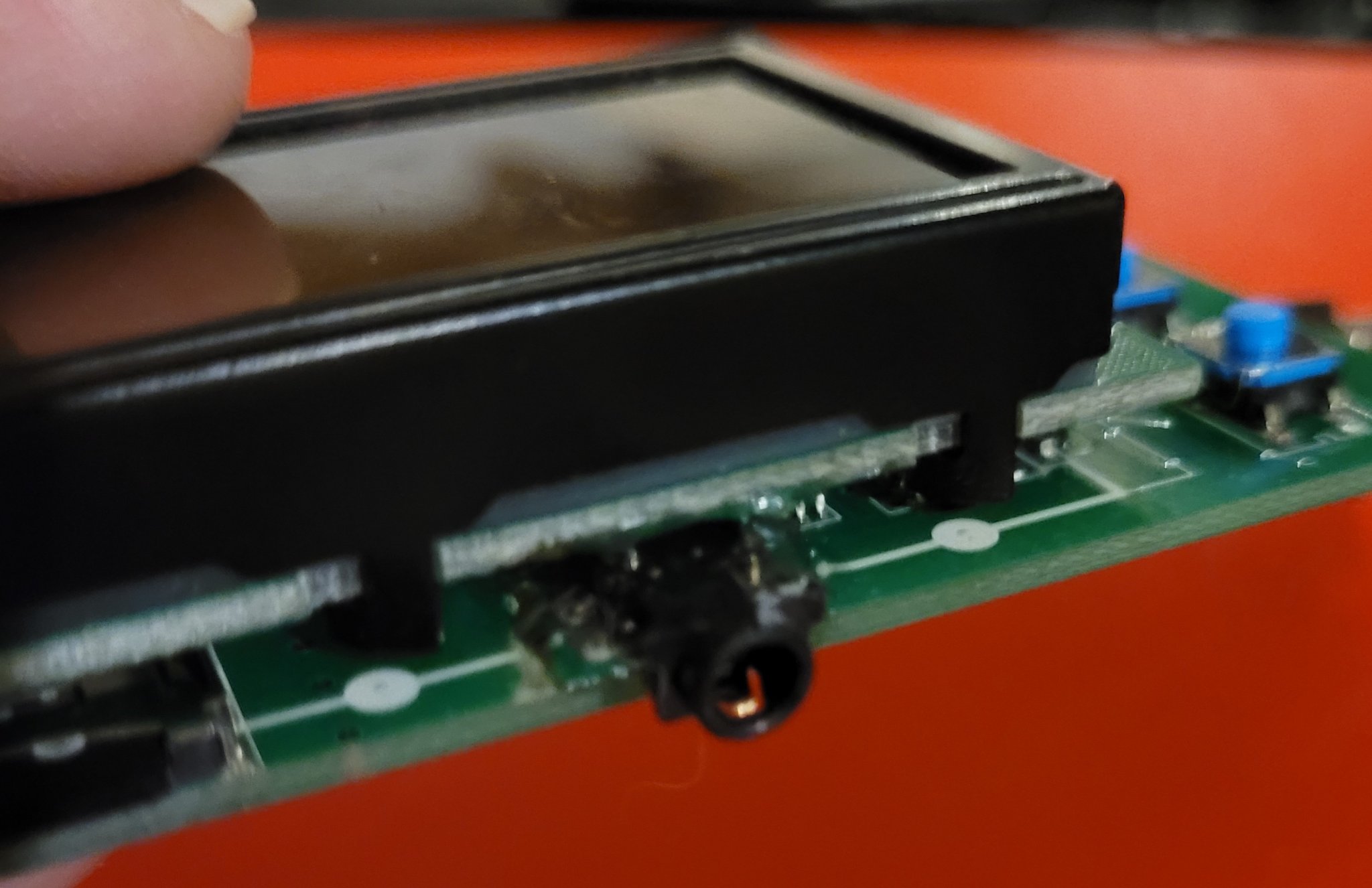

    Just thought I'd let everyone know what happened to my magnetospeed and what I believe the cause is.
    I was getting funny readings and then I just got an error message "connect bayo" ect....
    After contacting magnetospeed support, and getting a generic trouble shooting type response, I started looking at it closely. The bayonet was fine, so I took apart the display unit and plugged in the cord so I could look at the cord jack connection. I quickly found that the jacks solder connections to the board were broken. Obviously this is my issue. I would have just repaired the connection but because of how it's made, you can't get to the solder connections on the Jack after the display unit is assembled. I just ordered a new display unit......
    I think this probably happened because of my use of the mount that allows the bayonet to be mounted on a arca rail and not touch the barrel. This mount also has a spot for the display unit to clip into so that it too is on the mount. (Which means it gets impact from every shot fired). I feel sure that the repeated impact is what caused the brake, though it does seem odd that the only thing holding that jack in place is the solder connection. Seems like a really good spot for some epoxy....... but it was never designed to be mounted on a rifle and endure that impact either, and I don't want to be unfair.
    The magnetospeed V3 is a great tool, but don't put your display unit in the mount that attaches to the rifle, the display can't take rifle recoil.

    My post was not intended to disparage magnetospeed or the design of the V3 display unit, nor was I suggesting that there is some widespread issue, or make any negative assertions about magnetospeed speed customer service. It's a great tool as I said. I can buy any crono I want to and I choose a magnetospeed.
    That said, I don't feel that anything in my post is not accurate. I don't know what all testing you guys have done and I'm sure the testing you did showed good results. You have a good product that I like so much, I just bought a new one..
    The testing that I did showed me that putting that display in my mount as I had been doing is a bad idea, due to the potential torque that can be put on the Jack repeatedly over time by rifle fire and pulling on the cord. Therefore, I won't be putting my new display unit back in that mount. If it is sitting beside the gun, it won't get the impact, and will also be able to just move a little if the cord is pulled on vs the jacks soldering points having to withstand and endure that force.

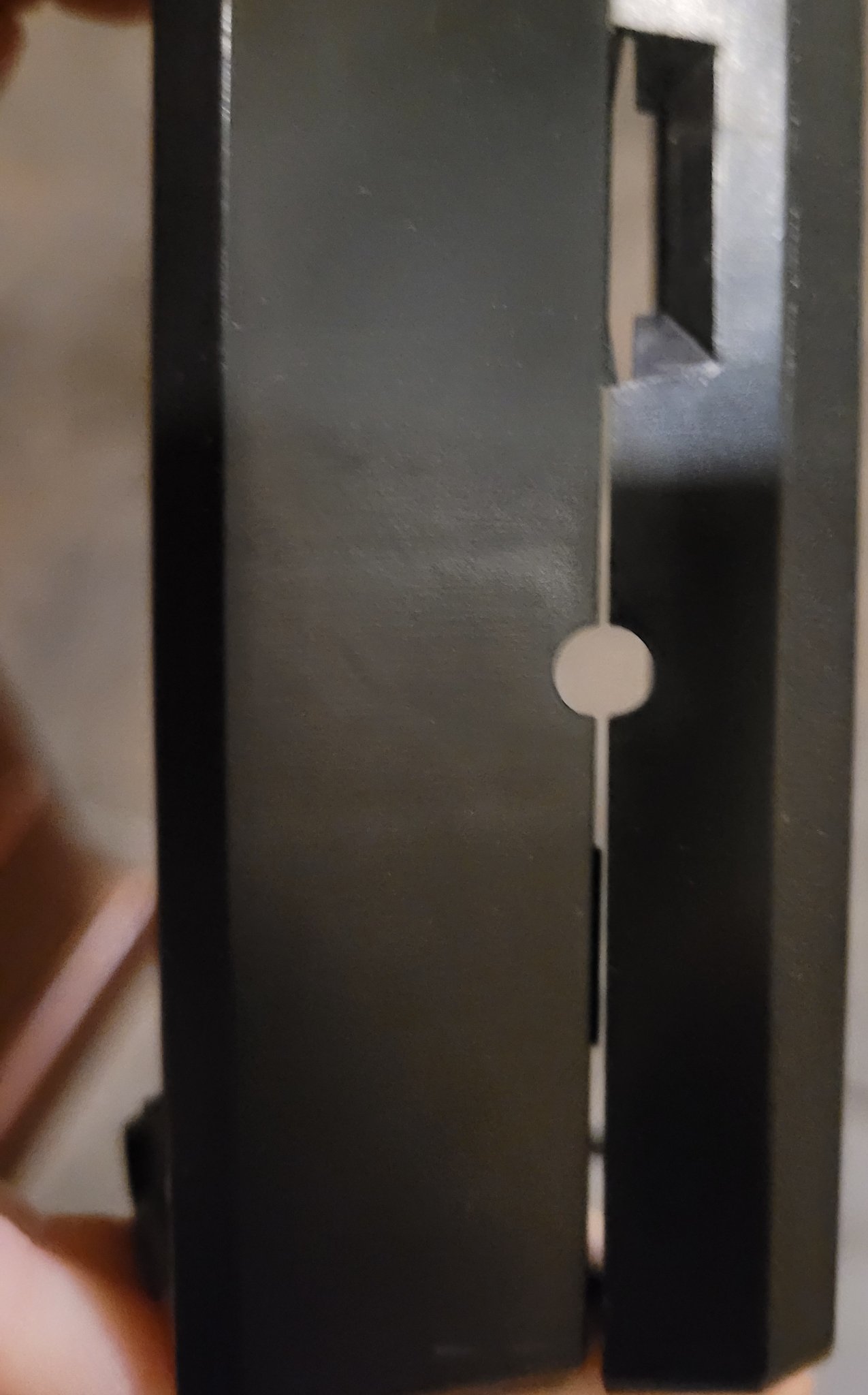

    I think he was referring to the rail mounted gizmo that holds the display. Some have a hole for the cable to pass through, and the cable bumping the inside of the hole could be causing strain on the connector.
    Oh ok. Mine had a very large hole so the cable doesn't touch it I don't think. I'm on a job site so I don't have it with me but I will post some pics when I get back to clarify. I just didn't want to make an issue for the mount manufacturer either. Trying to be fair and not be "that guy". The magnetospeed folks have been VERY good to deal with thus far and I'm still doing that, so just want to be fair and not say something that comes off differently than intended.

    This is the Jack without the housing and then a pic of just the housing showing the hole where the plug goes through the housing. I don't think the plug touches the housing when plugged in but I'd have to re assemble to be sure. There are some marks where I tried to get a small soldering iron in there as well as some super glue where I attempted to glue it in place so the connection would be maintained but it didn't work.
