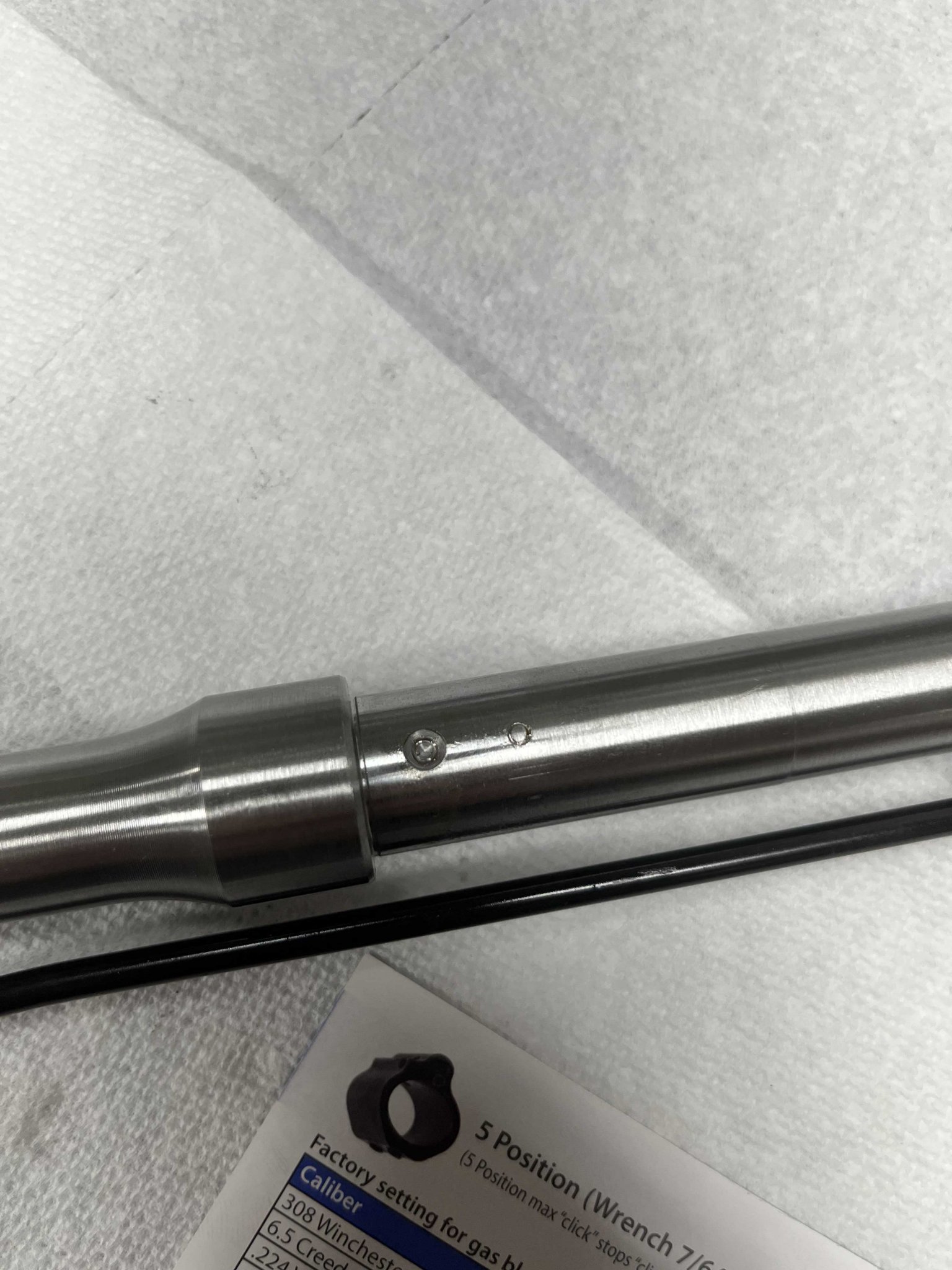

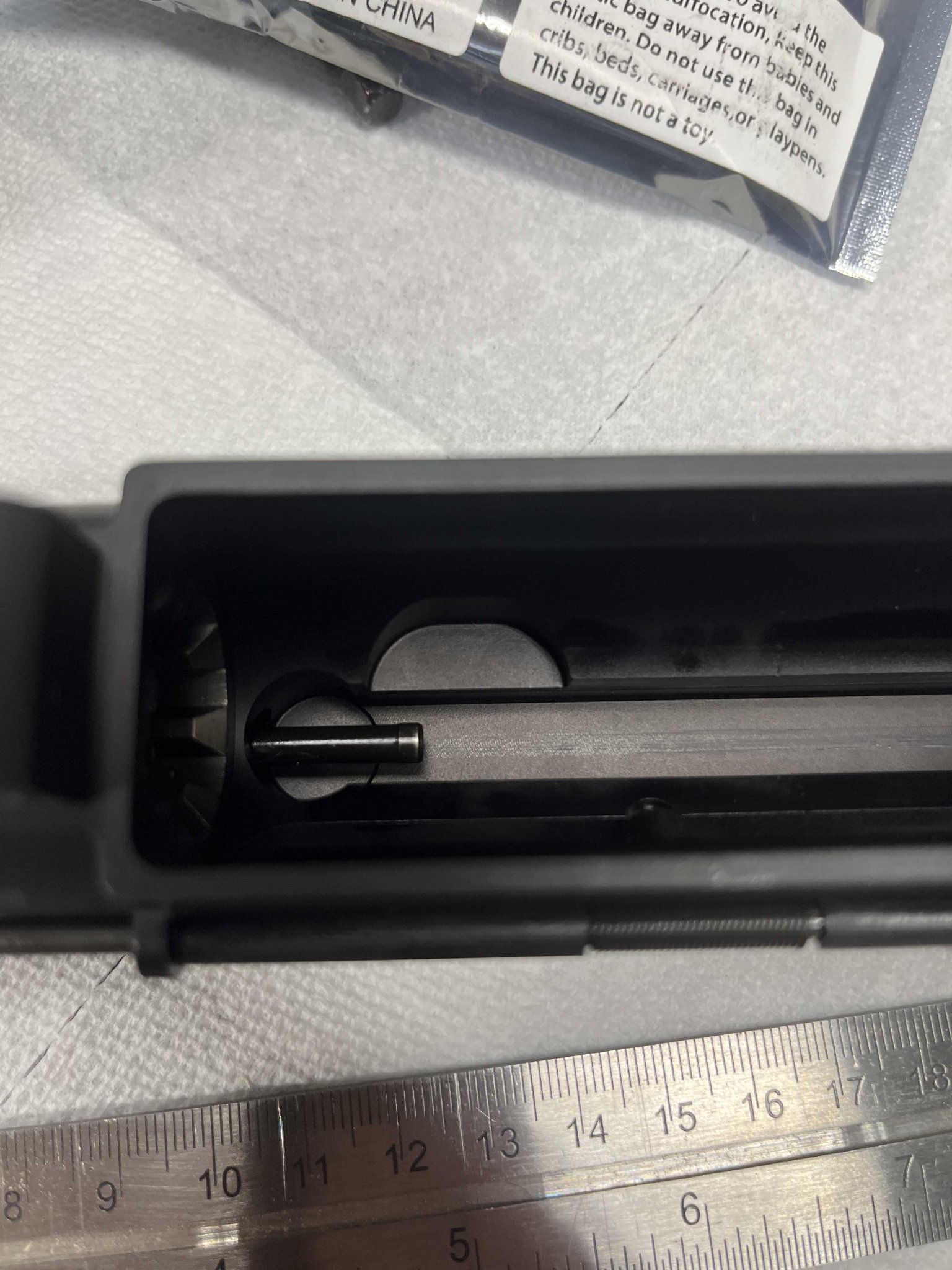

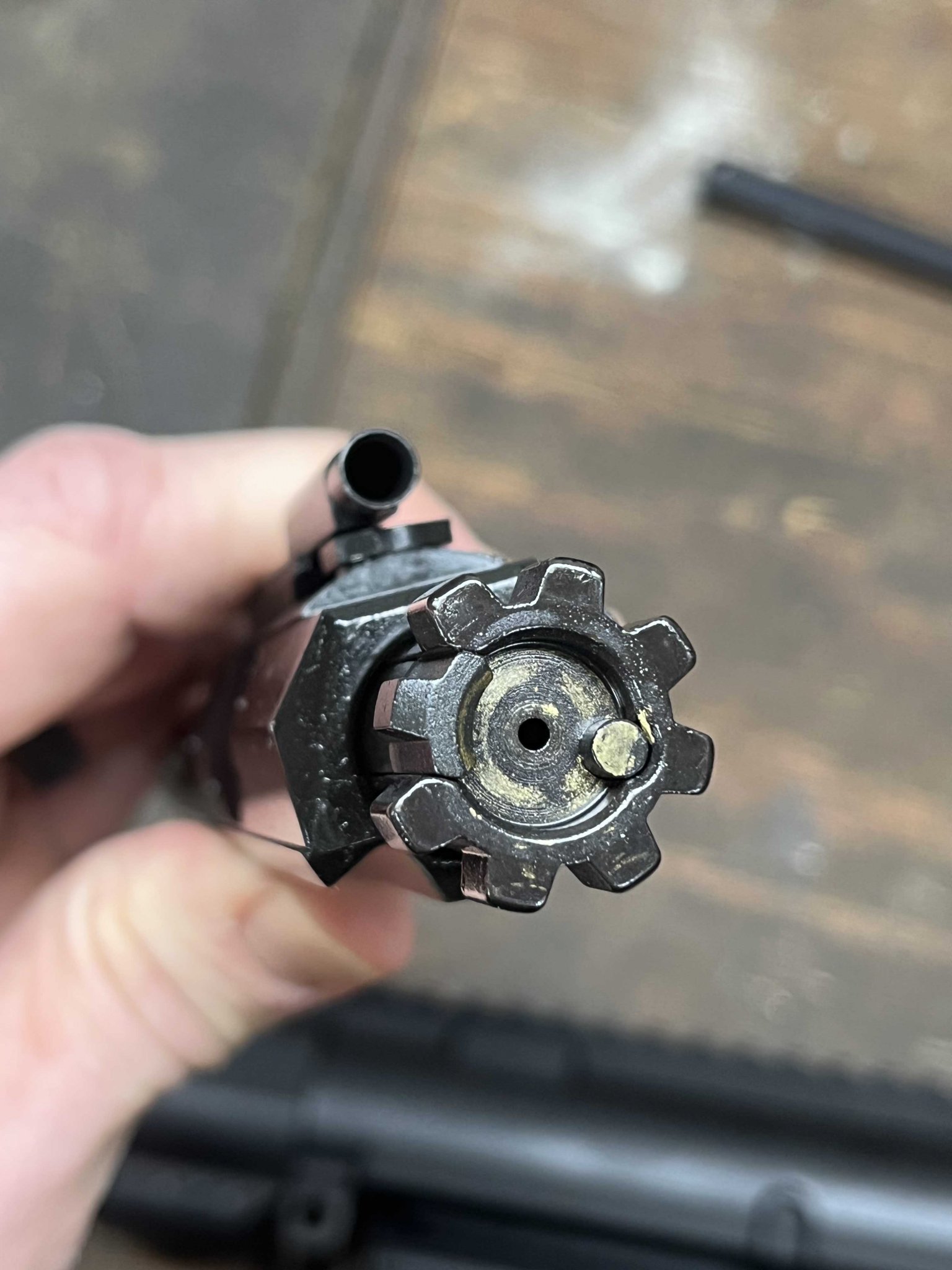

    Before I start shooting, I was going to take a few measurements to see how "in spec" it is and what specs they're using for my specific rifle. I'll check:
    -Inside depth of buffer tube
    -Length and weight of my buffer
    -Gas port diameter

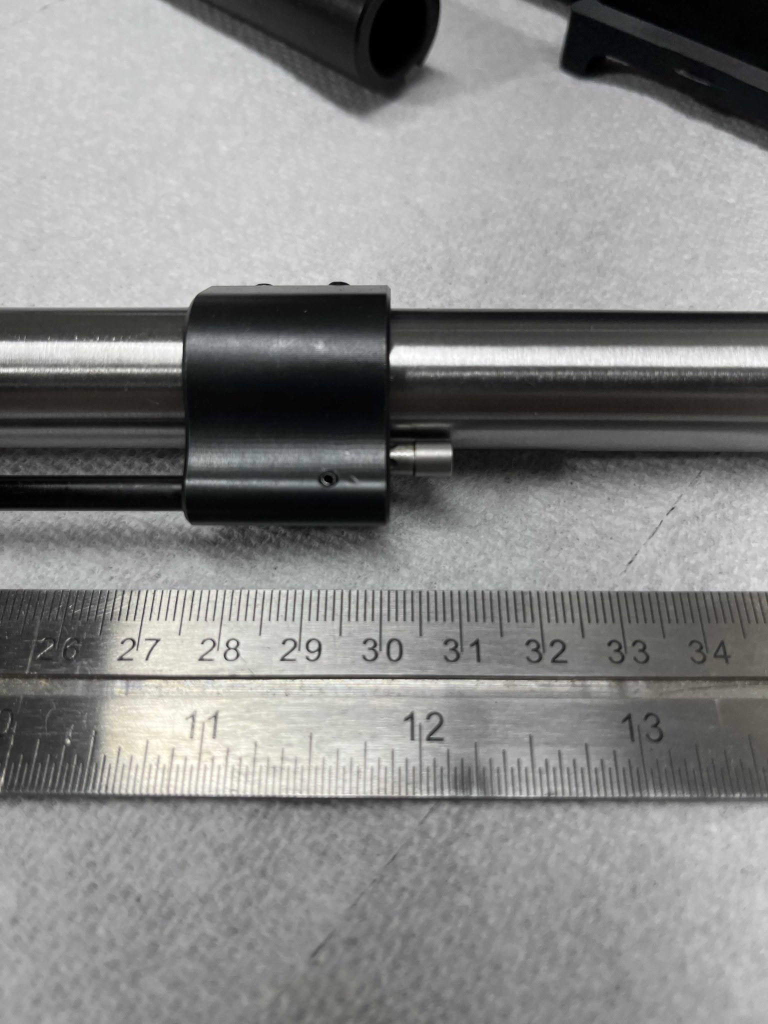

    -Gas tube length and position in relation to cam pin cutout in the upper.
    -How far back the BCG rides in comparison to the lower buffer tube ear area.
    -General fit/finish
    Once I get it put together, I'm gonna lube it up and run a few different factory rounds through it and see how she goes. I'll try to get a "feel" for recoil and how it shoots, obviously any function issues, and some basic accuracy tests.

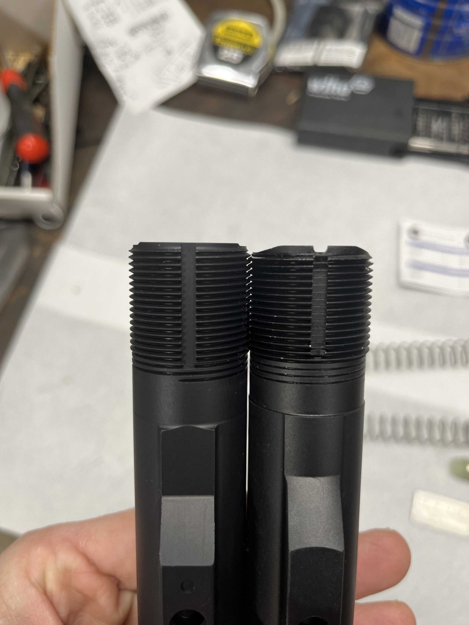

    -Superlative arms AGB
    -308 carbine buffer tube, 5.4oz carbine buffer, and 308 buffer spring; all from Armalite.

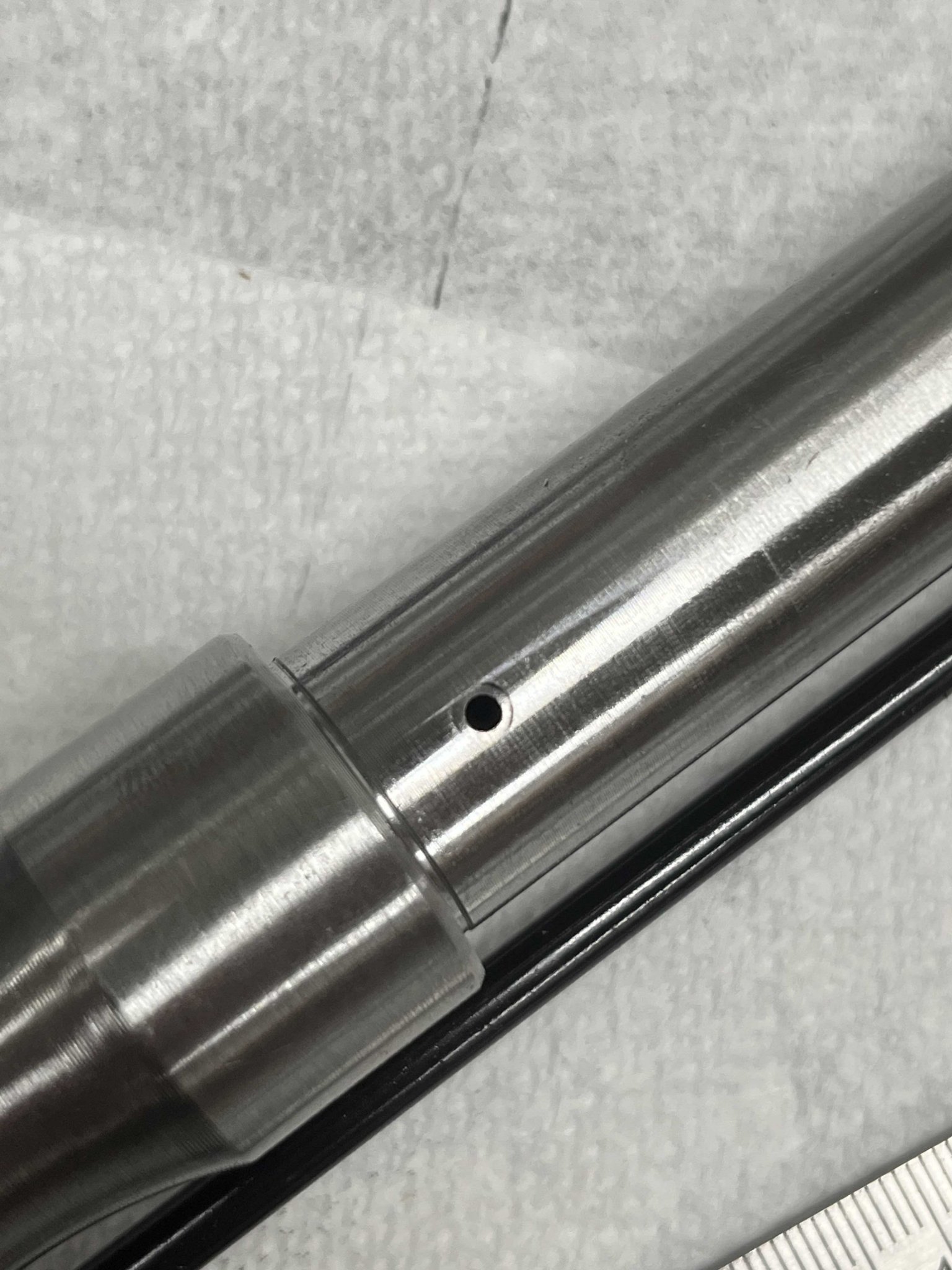

    The other main concern was gas port size. To my knowledge, most guys I've seen measure them in the Gen 3's said it was around 0.90" which should be about right I think. We shall see though. I'll measure that first.

    Looking at your to-do list it looks like you have everything covered. IMO you need to check headspace too. I didn't at first and that set me back considerably on troubleshooting. The fact that my original bolt allowed too much headspace coupled with all the other problems on your list had me chasing my tail for quite a while.
    That too short gas tube is a sneaky one that most never think to check. Learned about that one over on 308AR forum.
    Pretty much everything on your list was required to fix mine. It runs now pretty good.

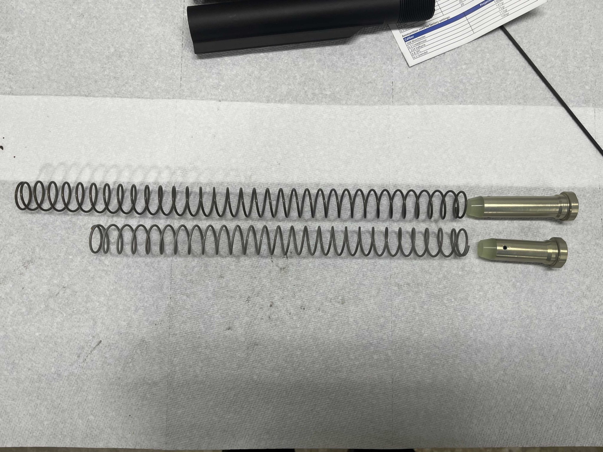

    Also, on the subject of buffers and tubes, I started out fixing my existing buffer system with a Sprinco orange recoil spring coupled with a Kaw Valley 5.6 oz buffer. (2.5" long)This worked well enough and probably would still be in place had I not decided that I wanted to go even heavier. I ordered a 8.5oz XH buffer from Heavybuffers.com along with the recommended Armalite rifle spring. That buffer is 3.25" long and requires the longer 7-5/8" deep tube so I got Armalite kit that I should have gotten much earlier.
    I went off on a quest to get the gun to function with or without my suppressor WITHOUT having to change gas settings with an adjustable gas block. My quest was a failure in that regard. Never found that magic balance point where I could do away with adjustable gasblock, but after extensive experimentation I settled on a buffer wt of 7.6 oz. The gun is exceedingly smooth and soft shooting now and so far totally reliable.
    I've loved a 2 stage trigger since I was a kid. I haven't mentioned it but I do have a PSA 2 stage nickel boron trigger in mine.

    I went through the scenic route to get to where I am today. The shorter buffer system on a 16" bbl 308 can be made to work reliably but the longer system is much easier.
    My suppressor is a YHM Phantom titanium QD, bought back in or before 2010. I'm sure there are more modern designs that don't overload your gas system as much as mine does. I have one other 308AR that is a 20" rifle. It does not have an adjustable gasblock, and it DOES operate reliably with/without my suppressor. It DOES have a Heavybuffers.com buffer system which enabled it to accomplish this without an adjustable gasblock. It ejects about 3-4 o'clock without suppressor and about 130-2 o'clock with the suppressor reliably.
    This gun is an old Bushmaster which is the same design as the Rock River and uses FN FAL mags. The buffer system is proprietary and that buffer won't work in any other design.

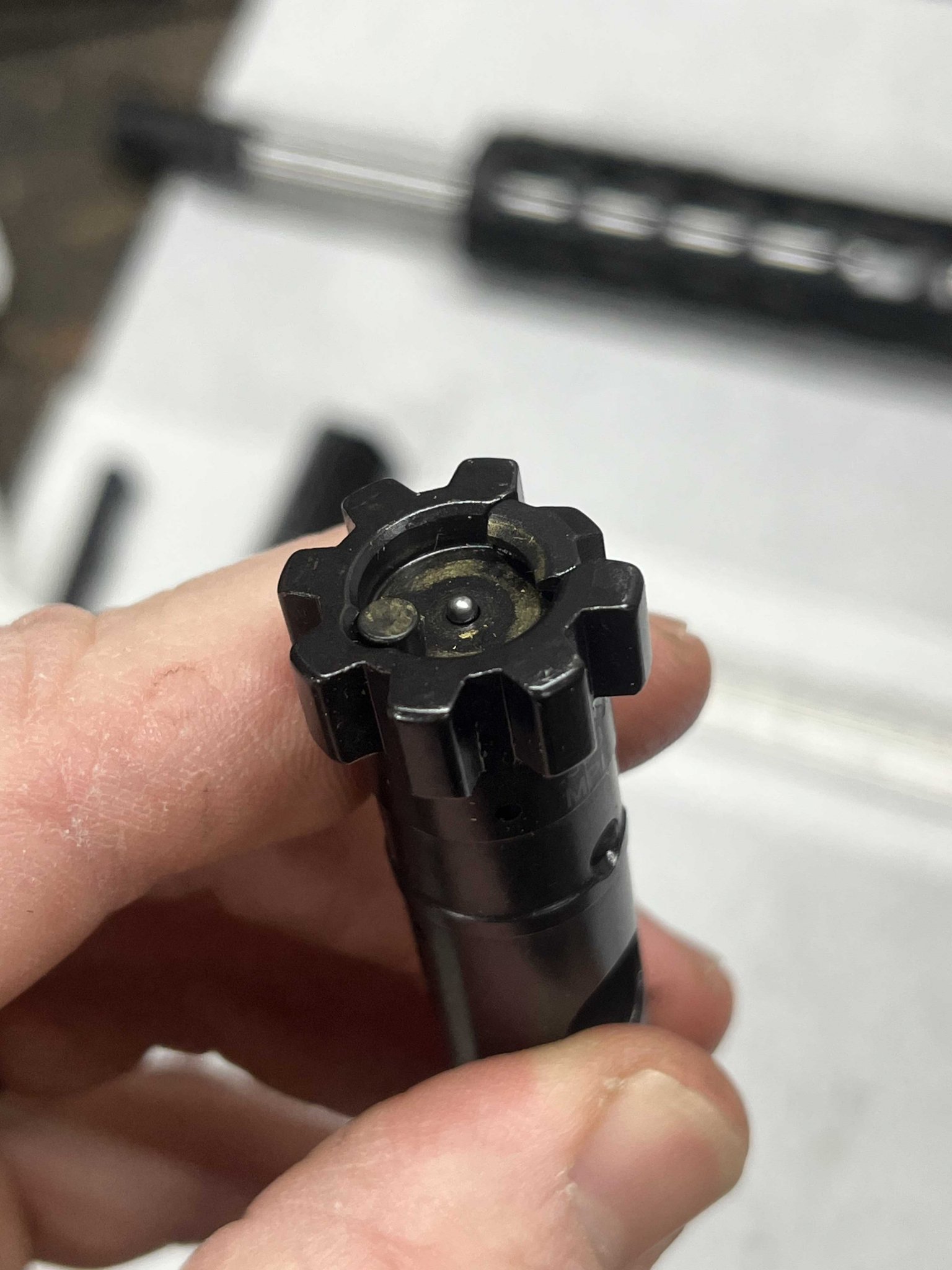

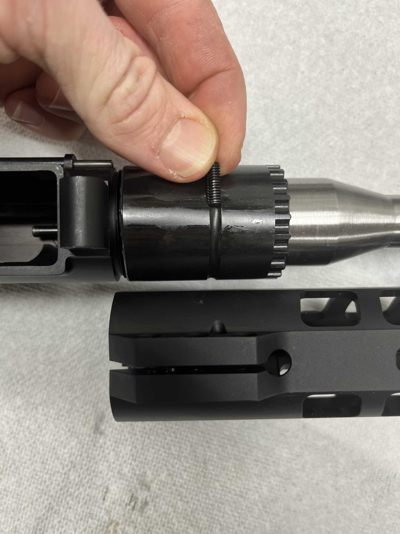

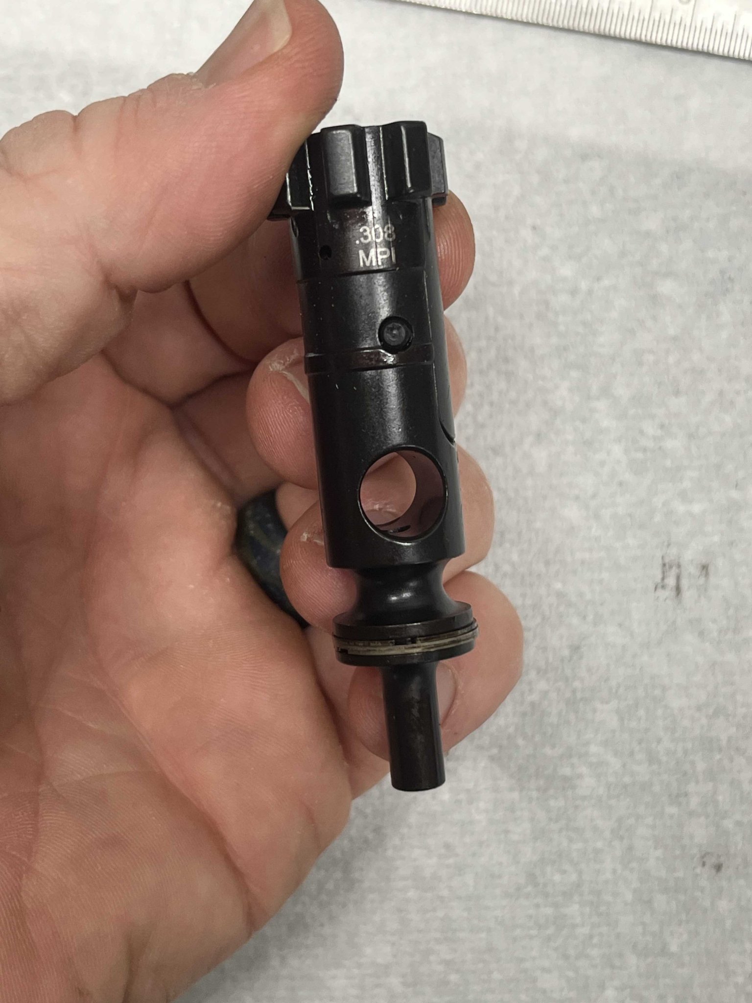

    Extractor, some Toolcraft 308 BCG's can come with a less then precisely cut extractor "claw" .

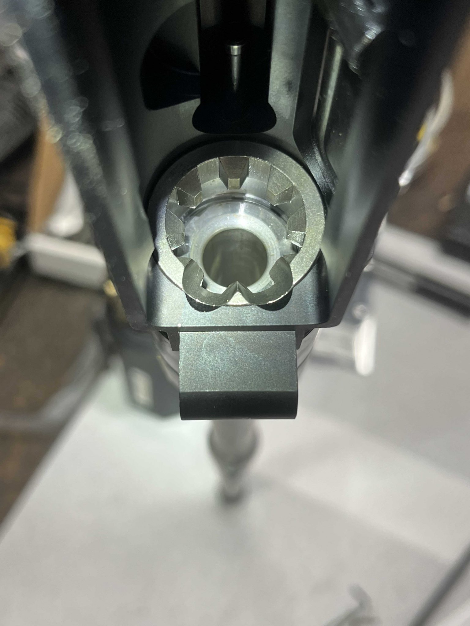

    Make sure the barrel is indexed properly at the barrel extension locating pin into the upper, the feed ramps "should" show obvious out of alignment issues. A poorly indexed barrel extension will result in bolt lug battering. ( Another member had one that was way out of clock, and it beat the hell out of the bolt locking lugs, heck the alignment locating pin freely fell out of the barrel extension )

    Got the upper and lower build kit in. Lower build kit looks normal, we'll see how it all goes together.
    The complete upper weighed in at 5lbs 11oz. Overall, it looks fine, no serious fit or finish issues, especially given the price. BCG and bolt were lightly oiled in the typical "mechanic shop" smelling oil. No real lube of any kind. Bore was clean and smooth.
    According to the little card they give you with the AGB wrench, my gas block had 26 clicks, and therefore was a 5 position gas block. If it had 17 clicks, it would be a 3 position. Not sure how that works that way, but whatever. Adjustment screw seems chincy and the "clicks" are very light and barely audible. Gas block was positioned perfectly over the gas port. The gas port ended up being ~0.077". I'm assuming the fact that its midlength gas on an 18" barrel with a cheap buffer system warranted the smaller gas port. We'll see how it runs.
    Gas tube was the standard AR midlength at ~11.75" and stops just past the start of the cam pin cutout. For anyone looking for possibly higher reliability, the Armalite tube might be a better option at ~1/4" longer.

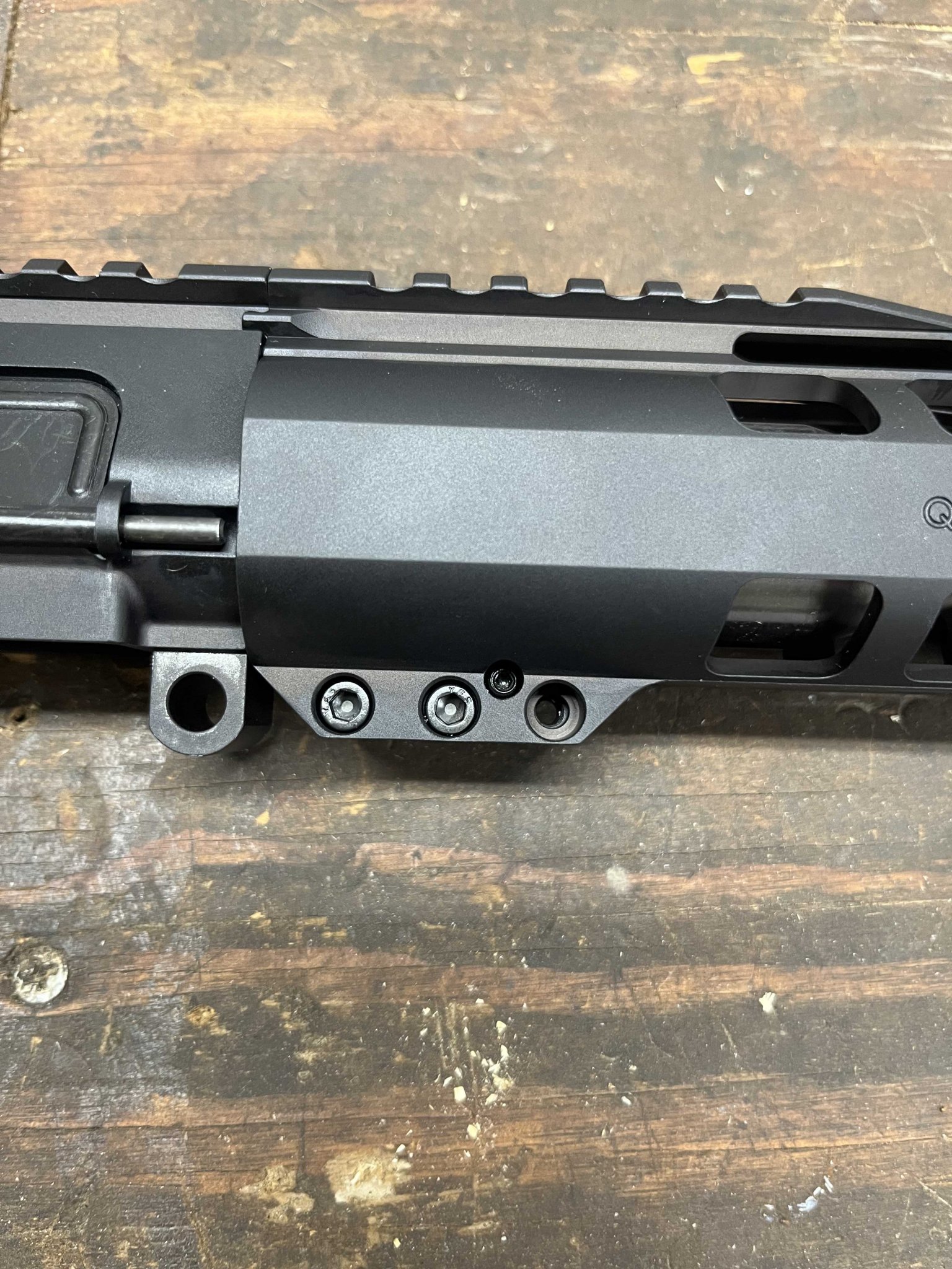

    The M.I. rail is not bad at all. Nothing like an SLR but useable for me anyways. Has anti rotation tabs at the top, lined up close to perfect. There were only 2/3 screws in the mounting portion, but it did have the internal screw that runs in the channel of the barrel nut. All screws were dry.
    Bolt had brass on it, I'm assuming from test firing...or I received a used/returned bolt LOL. Ejector looked fine, no serious sharp edges. Extractor looked fine to me. It had the outer and inner spring with the rubber gasket as well. Seems like overkill, but we'll see. Gas rings on bolt seem fine and were separated. Firing pin seemed to have a good fit.
    Feed Ramps lined up, although they don't look perfect. Did not seem to effect bolt closure but we'll see tomorrow. I'm heading up to Rubber City Armory tomorrow (its 90min from me) to talk to Jeff Larson up there. We have been emailing back and forth and he's going to headspace the bolt and also try out a RCA bolt and BCG to see how it fits and if it headspaces better or worse. Provided its fine, I will most likely pick up a full BCG from him to have an extra, but also because he has been awesome to talk to and very informative and welcoming. Great guy/company.

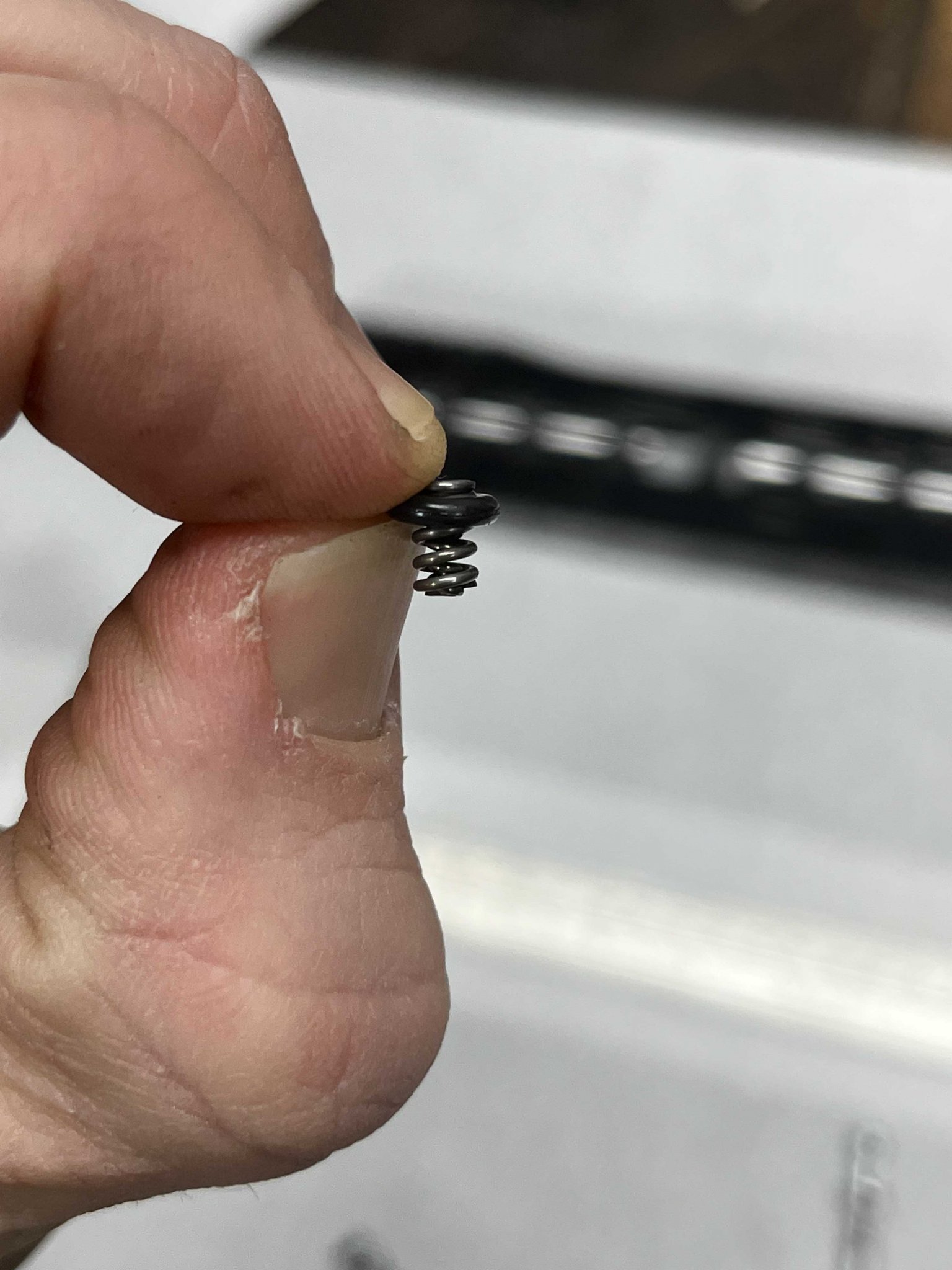

    The carbine buffer I got with the kit is standard 7". Spring is standard and honestly looks/feels cheap. Compared to the Armalite spring that feels/looks more like a high quality Sprinco. You can also see its over 2" longer, even though the buffer tube is only ~3/4" longer. I really feel like Armalite did the buffer and spring assembly this way for a reason. After initial testing, I'll be switching over and seeing how it effects recoil and shootability. Superior build quality of the Armalite tube over the carbine tube is obvious (AR on the left, PSA on right). Buffers weighed the respective standard; 5.4oz for the Armalite H3, and 3.8oz for the PSA shorty.

    If you're going to use the PSA bolt, I suggest rounding off that ejector a lot more than it is presently. If you find pics of other "enhanced" bolts, a lot of the ejectors will be completely round on the end. When a round feeds from the right side of the mag, it tends to "slide" across the surface of the ejector and any sharp edge may gouge out the brass. It will also look like an "ejector swipe" when actually no such thing is taking place leading to false signs of overgassing. I removed my ejectors and chucked them in a drill. Held them at varying angles against a cheap sharpening stone while spinning in the drill to create a rounded tip. Just don't shorten the length.
    Excellent pictorial history of this project so far. None of mine are anywhere near this nice and thorough.
    That’s a good idea. It was by no means sharp, but I could easily see improvement for sure. There were also brass shavings on it from test firing so I’m assuming you’re right.

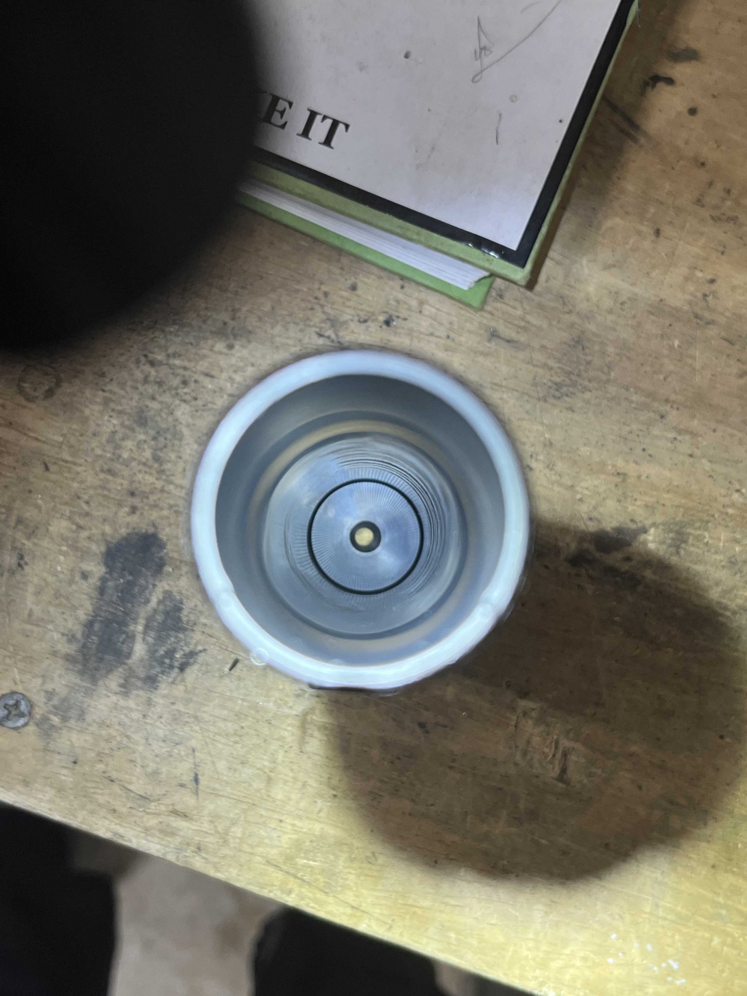

    BTW, how smooth was the inside of the OEM PSA buffer tube ? And while on the subject how smooth is the Armalite buffer tube interior ?
    Looking at the feed ramps they will most likely never give any problems. However, the point in the ramps where the upper receiver transitions to the barrel extension looks to have a slight upset creating a potential sharp edge in the ramp. IF you see copper jacket material in this area, you may have to do some very careful polishing of those edges but the only ones I've seen give trouble were much worse than yours.

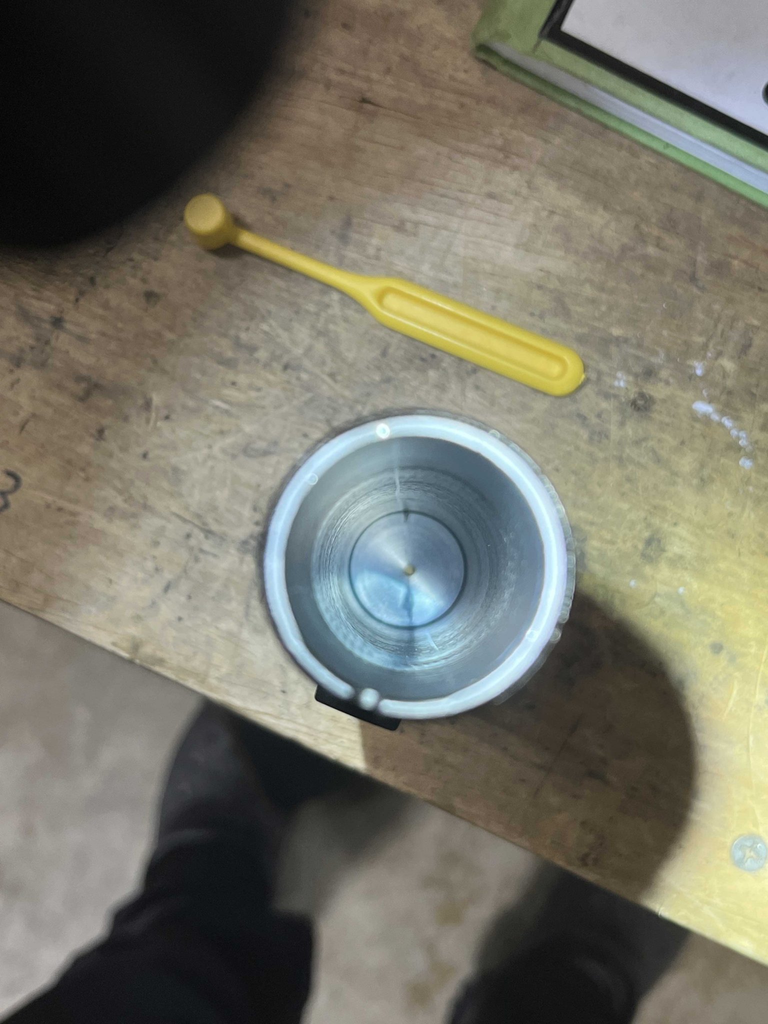

    I would imagine so. I showed Jeff at Rubber City Armory the carbine buffer spring and his eyes got wide, he turned around and showed me what he/they use, and you could easily see and feel the difference in strength and thickness of the spring. The new lowers they use have "cutouts" in the lower ear are by the RE, which now sounds like a cover up for cheap buffer components lol.
    I didn't think to check the quality of the inside of the buffer, so good idea, and its also very noticeable. The inside of the PSA looks and feels like it was drilled out with a dewalt. The bottom also has what looks like a crack, or chipping. The Armalite tube is smooth as glass and shiny. The bottom looks like a perfectly milled out bottom thats shiny and symmetric but shows the mill/finish marks.
    I talked with Jeff Larson, who I found out is the Operations Manager for Rubber City Armory. What I didn't know is they have one of the largest Salt Bath Nitride facilities in Florida and they Nitride most of the BCG/Bolts for Toolcraft and PSA. He was very nice and informative and he ran through the whole BCG and bolt, checked headspace, a few other little homemade tests. He said it all looked good functionality wise, but noted the same thing about the ejector and just to watch it.
    He compared one of their carriers to the PSA and the only main difference was a few corners cut with machining and finish work. He said it shouldn't harm function, but is most likely one way they save a few coins over thousands of carriers.
    View attachment 8064337View attachment 8064338
    I've been told not to trust my lying eyes, but the PSA on the left looks a little off-center on the bore.
    This isnt just a guess, but also isn't verified, but some guys think, and rightly so, that PSA has those bored low on the bottom side to avoid carrier tilt issues.
    When you assemble a cheap LR308 without the more agreed upon variations, you get issue. Carriers hitting buffer tubes both on the bottom and the smashing into the rear because you used shit springs and light buffers. Carriers hitting the lower ears on the receiver due to the same issues. Adjusting gas port size and location to save money on proper buffers and cover up your other cut corners. Now obviously some guns run fine, but my guess is they could run better if they utilized better parts.
    Comparing the two buffer tubes made me realize just how good of a decision the Armalite set up is. I'm also thinking longevity. The PSA stock may run fine, but how long will it last? Changing to a few better parts may reduce recoil, and keep it running much longer.

    I would like to see the difference in a Aero Precision 308 DPMS pattern carbine recoil spring and a PSA one , and I am pretty sure Aero uses the same 2.5" buffer weight of 3.8oz.
    I wonder if the Aero and PSA carbine recoil springs are made by the same company, to the same spec.
    I am glad to see the Armalite buffer tube is smoother inside, since it costs darn near twice as much, and it is good to see the price isn't just for the name.
    I have bought other "name brand" buffer tubes looking for a smooth interior, and quite a few were dubious inside, I could feel the ridges, with my finger tip ! So good to know Armalite is another smooth one.

    I'd bet 6061 would work, but... I would prefer 7075.
    I guess I haven't noticed, but is the PSA drain hole really that much smaller then the Armalites ?
    "This isnt just a guess, but also isn't verified, but some guys think, and rightly so, that PSA has those bored low on the bottom side to avoid carrier tilt issues."
    Are you saying PSA might have a carrier tilt issue ? That is the first time I have heard that.
    Would that apply to the AR15 model as well ? It is the same buffer tube.
    Where did you hear this ?
    I'll measure my buffer tubes, I can't say I have ever noticed any of them being off center, both on AR15's and PA10's
    Anyhow, thanks for the updates
