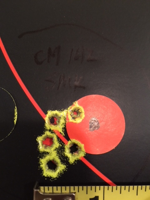

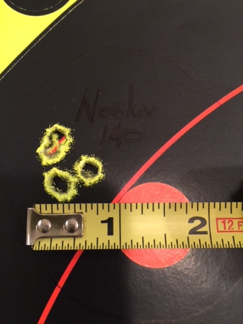

    100yds, benched, scoped, bagged front, wedge bag rear.... 5rds each.... PSA factory 20" barrel, SLR adjustable gas block, Lantac Dragon .30cal brake.
    Please bear in mind.... this is from an AR platform, yes.. IMHO, a bolt action would have most likely been more accurate....
    BUT, from a $500 complete upper, I consider these groups to be outstanding
    Nosler 140gr HPBT
    https://www.snipershide.com/shooting/filedata/fetch?filedataid=79252&type=thumb

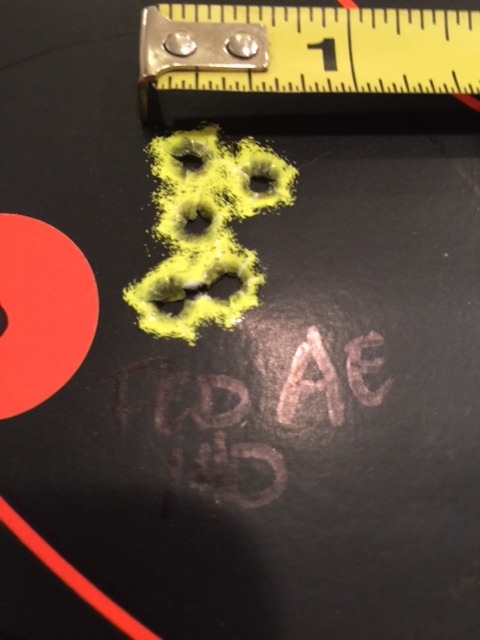

    Federal AE 140gr
    https://www.snipershide.com/shooting/filedata/fetch?filedataid=79253&type=thumb

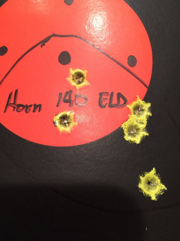

    Hornady 120gr ELD
    https://www.snipershide.com/shooting/filedata/fetch?filedataid=79254&type=thumb

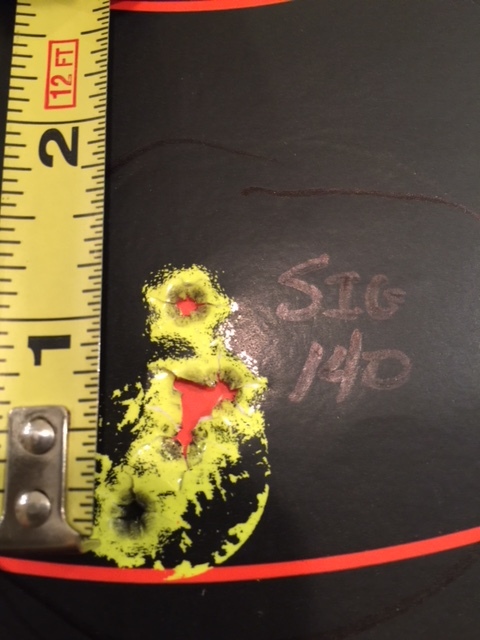

    SIG 140gr OTM
    https://www.snipershide.com/shooting/filedata/fetch?filedataid=79255&type=thumb

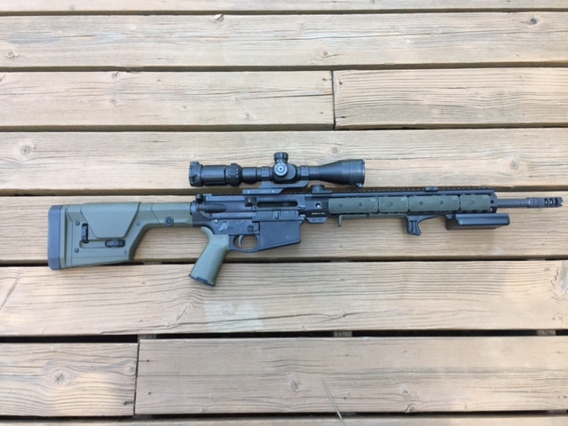

    Details on the rifle as it is currently setup...
    Upper.... PA65 OEM complete upper, 20", rifle length gas, SLR .750 clamp on gas block, Lantac .30cal muzzle brake, Vortex Viper PST 6-24x50
    The .30cal brake seemed to work good enough... well enough that I won't bother to buy a 6.5 brake.
    I mildly polished the feed ramps, and slightly polished the chamber with 0000 steelwool spun on a .30/06 chamber brush via a drill. NOTE: not a AR chamber brush...but one used for a .30/06 bolt action rifle.
    Lower.... The same setup I used in my .308 PSA rifle as seen in the other thread.... PSA "Multi" marked lower, LaRue MBT trigger, Magpul 1.1 grip, KAK 9.3oz .308 rifle length buffer, and a Tubbs .308 Flatwire spring.
    I will add... the lower has been polished at the full length inside of the buffer tube, magwell burnished, trigger face slightly polished.
    I also use Varmint Lights " X-Shims" to minimize the play between the upper and lower. I am one of those guys that believes it makes the firing the rifle accurately "easier" and more consistent in my shooting stance at the bench.
    I am happy to say, there was no interference from the barrel nut against the gas tube... the charging handle did not bind as a result.
    Frankly.... the whole upper was a trouble free affair... after changing parts ( that I wanted ... SLR , muzzle brake ) it was a plug and play deal.

    As you will see... the PSA 6.5CM barrel had its likes and dislikes accuracy wise... perfectly normal.
    For the most part, and given its price point... I think the barrel performed very well.
    Onto the accuracy photos....

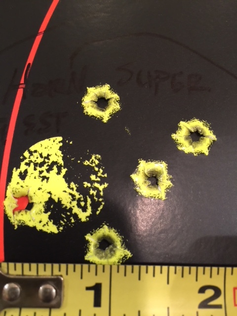

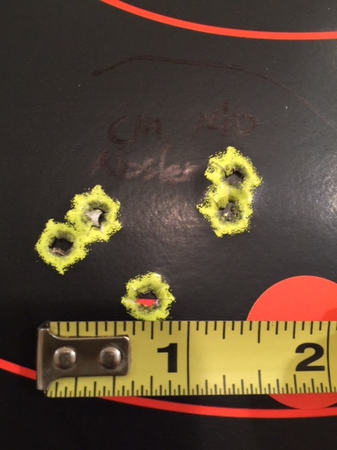

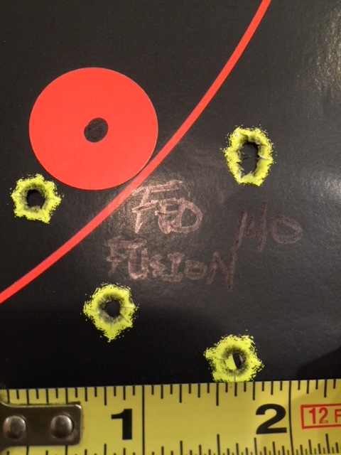

    I didn't fire a bunch of 5rd groups of each ammo, just 2ea 5rd groups...showing the best of the 2.... the reason being, I will retest later after I true up the receiver face and Loctite the barrel into the receiver.
    I am hoping that will help with the overall consistency of the different ammos.... and help clean up the dreaded cold bore flyer, as well as some of the other fliers.
    Did I mention how happy I am with this upper !!

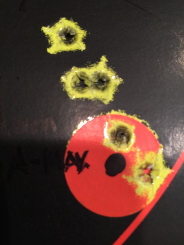

    More ammo groups

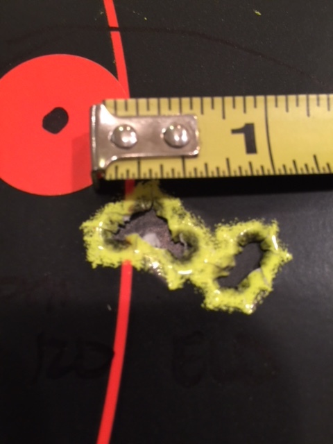

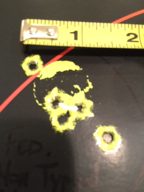

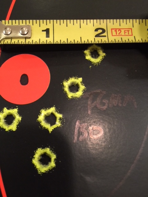

    Federal "Non-Typical" 140gr SP.... ( I was hoping these would do better ....Flat base and all )
    https://www.snipershide.com/shooting/filedata/fetch?filedataid=79258&type=thumb

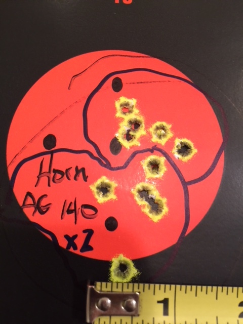

    Hornady American Gunner 140gr BTHP ... NOTE 2 separate groups with two separate POA
    https://www.snipershide.com/shooting/filedata/fetch?filedataid=79259&type=thumb

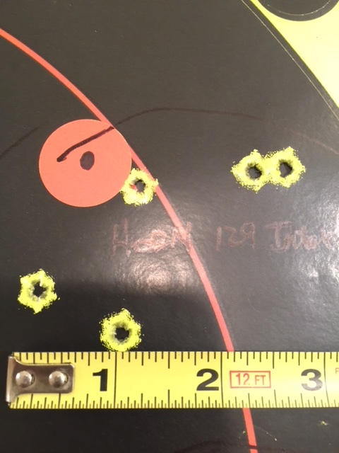

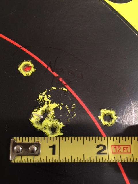

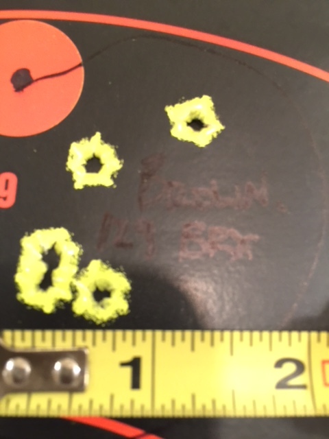

    Browning 129gr BRX
    https://www.snipershide.com/shooting/filedata/fetch?filedataid=79260&type=thumb

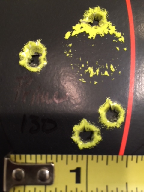

    Hornady American Whitetail 129gr Interlock
    https://www.snipershide.com/shooting/filedata/fetch?filedataid=79261&type=thumb

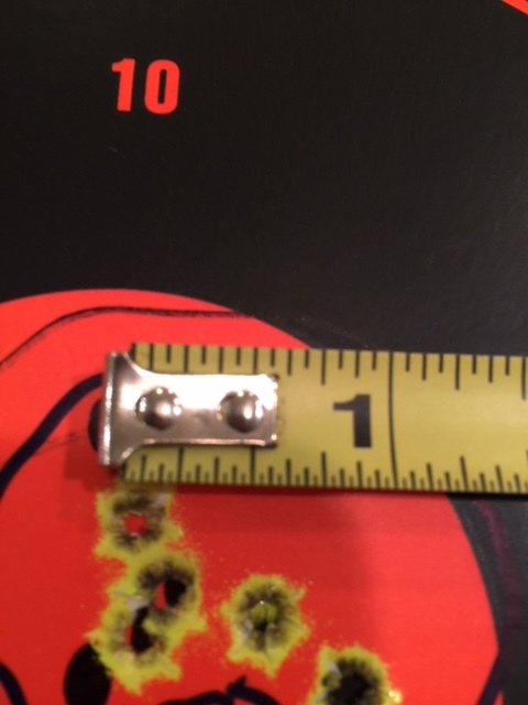

    Finally got to the range today for the Trued n' Glued testing.... If anyone isn't sure if it helps, I can say, either my shooting skills dramatically improved... or the Trued n' Glued worked.
    I will do the Tn'G on all my AR platforms.... the results are so obvious, that most groups could be readily / easily be seen to be better.... without measuring at the range.
    Improvements in the realm of 1MOA+ will be seen in the following downloaded photos.
    I will note the measured improvements as well as the few "didn't change a thing" ones.
    I am hoping to alter the original posts with a before ( OEM ) and after, True n' Glue photo.
    Give me some time... but, again.. if you aren't sure if you want to do it.... I will argue that you should !! Lol
    Also there will be some added ammo tested from the Tn'G barrel.
    Wow .... I am still impressed with the results just thinking about it.
