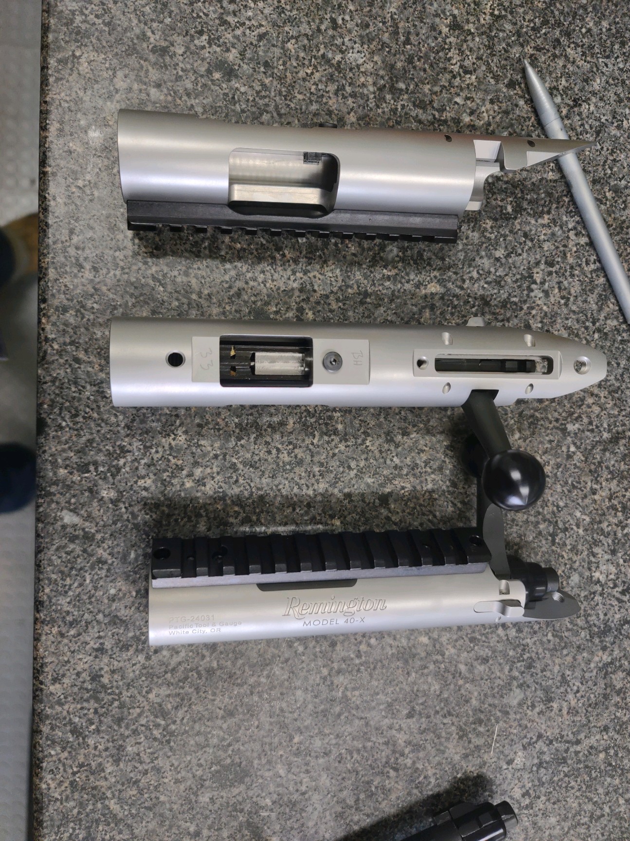

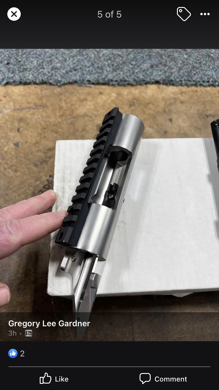

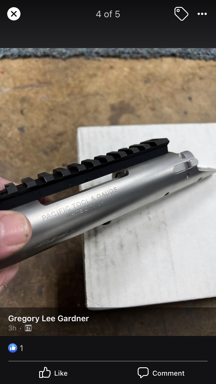

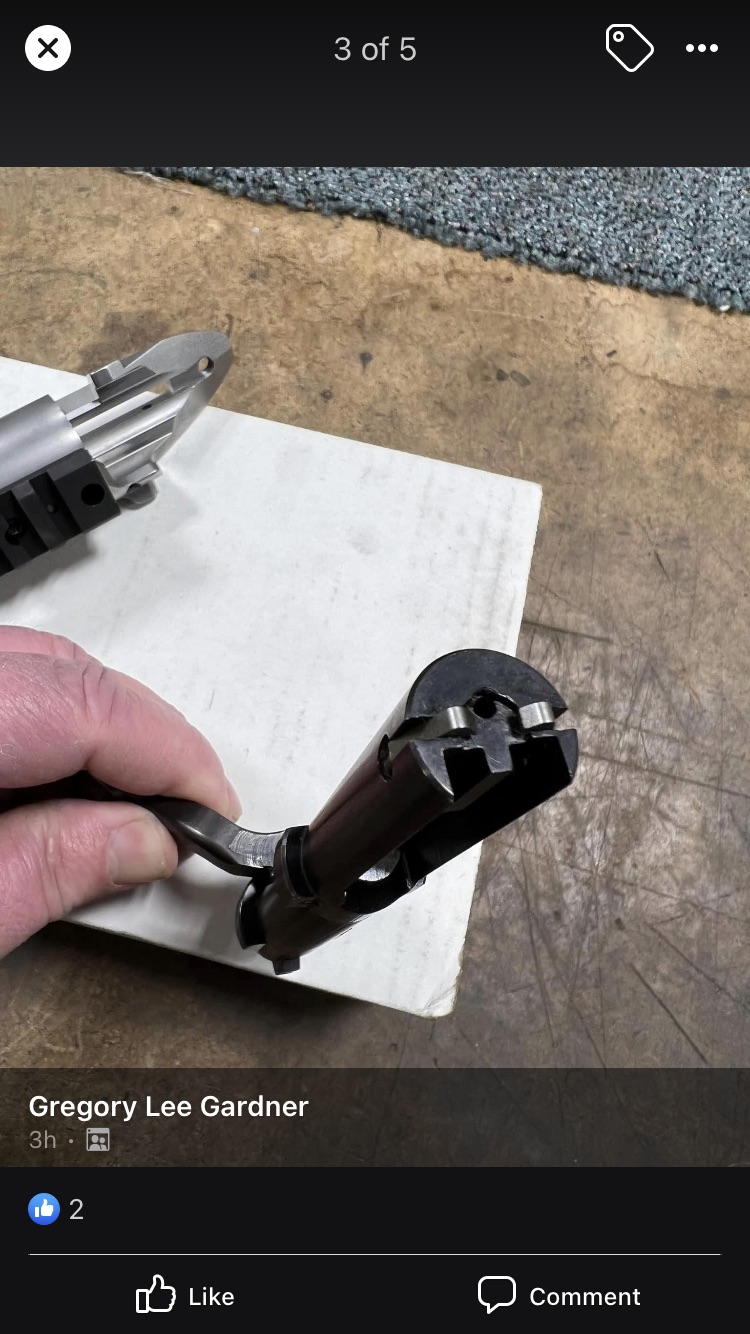

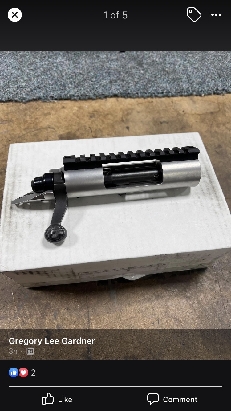

Has anyone gotten one yet? Looks like the have a single shot and a repeater version
Im curious to know how well they shoot and what mags are used. I do know they have a bad rep on customer service but just curious on how the action performs.

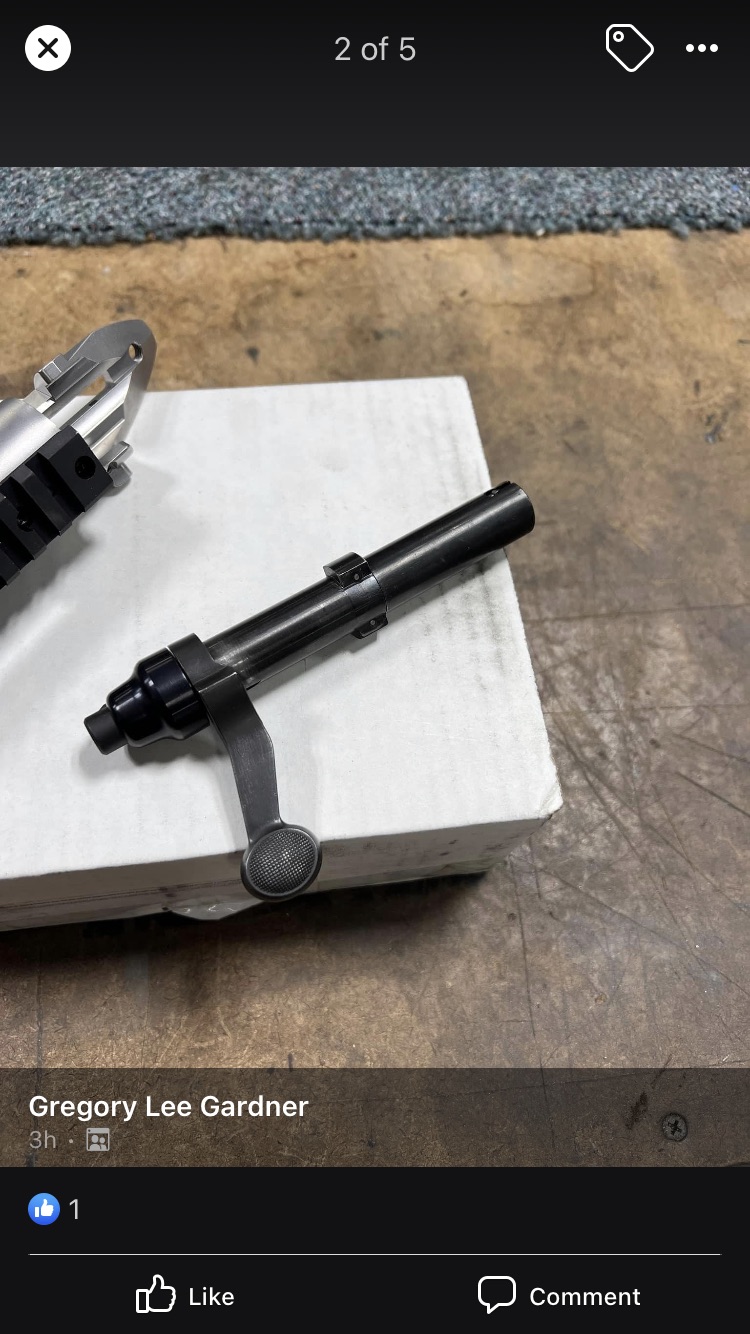

A guy on FB posted some pictures of the action ge received and it looks pretty good

I dont know if they are significantly better or not as i havent found any information on them yet. As far as price they are cheaper than rimx and vudoo
From my opinion it looks like a 40x with an Bush/Elrod conversion for vudoo mags and they added a side bolt release as well. So maybe an improved version of the original 40x? (Side bolt release looks like one on the stiller lonestar)

Here are some additional pictures

Hard to really tell from the photos posted whether that action had been modified to work as a repeater. The feed tray for single loading appears the same as my original 40X, which has to be removed, the magazine cut-out made, and the ejector modified to work with the Vudoo magazine. The extractor/pusher also need modded to work in a repeater in order to feed correctly & work smoothly with the V22 mags. I sent two CMP actions (one a 40X, the other a 40XB) to jelrod for the repeater conversions, but since I did the barrel work when they came back to me, Jonathan couldn't do his full extractor/pusher tuning while he had the actions because they neither one had barrels mounted at the time. It took me a considerable amount of time to finalize that tuning, and in so doing, I went too far in metal removal on a couple of extractors, and had to buy new ones from Gun Parts Corp and start over. Because the springs that power both the extractor & pusher are longer than the later shortened ones that VGW started supplying with their V22 actions, it was much more difficult to remove & replace the extractor & pusher in the 40X actions that it is today to do the same thing in a V22 action. Had I known to shorten and how much to shorten these springs back before VGW worked that issue out, I'd have had a lot less trouble while finalizing the shape of those parts in my two 40Xs.
After I'd bought my 1st V22 action, other owners were reporting ejection issues, so Paul got to work (maybe with help from Mike, IDK), and designed some changes in the shapes of the extractor/pusher, radiused the noses of the dinky little pushrods that the springs push against the foot of the extractor/pushers, and shortened the springs that power them. Paul sent me a baggie of extra parts, and texted me a video of where to make changes to the shapes of the parts, and after that help, it took me maybe 15-20 min to remove, modify, and replace these parts in my bolt. I'd only just started to have a few ejection issues with my rifle after 500+rds through it before making the changes, and these mods have given me 100% reliable extraction/ejection for the four or more years since. A guy with jelrod's experience & skill might not have any problem getting the PTG action to function reliably as a repeater, but for the rest of us, it would seem to me to make a lot more sense to just go with a V22 to begin with...
The magazine cut-out looks similar to the one that Mike Bush sent me drawings for, to use with his prototype V22 mags. I've never been around a Bergara rifle or magazine, so don't have much of a clue as to how close to the V22 mags they might be. But if you're able to get good, reliable feeding & ejection with those PTG-sourced actions, it's hard to argue with success...

How do they differ? The cocking ramps are machined onto the lugs instead of into the receiver, there is no notch under the bolt handle. The action is just as smooth as a rem 40x, the bolt head is supported in the FWD ring,but there is no Spring/Filler in the LHS lug race...so brass occasionally finds its way over there. I'm as pleased as punch with them. All the HORROR stories about PTG, and guys telling me I'd just thrown my money away...They're really well made and at a price point that's hard to argue with.

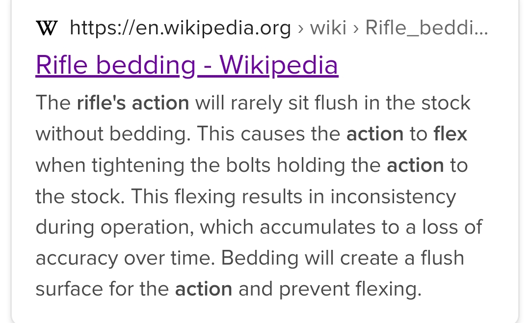

No the correct term is flex absolutely. The 40x and even rear lock up actions you can see the crosshairs move when locking the bolt. That is flex , that's why you see a lot of shooters moving to the rails to mount across the loading port. It reduces or eliminates that flex in the scope.
My god you guys are serious...How about you wikipedia wonders take this speculative pseudo-engineering thought exercise elsewhere??

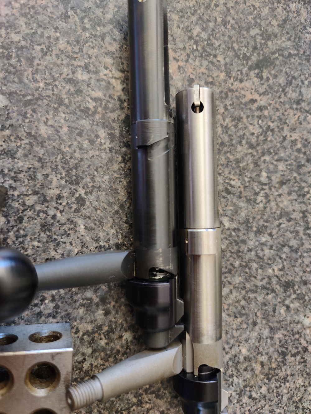

Looks to me as though the repeater uses V22 magazines, though LeShagal said in his reply that he's been using Bergara magazines if the four repeater actions he bought and built into custom rifles. Guys have asked if anyone is making pre-fit barrels for the V22 as well, and the answer is that it's not practical due to having to perfectly time the extractor slots - same is true of the PTG action.
The aforementioned four PTG actions have CNC Timed threads. It would APPEAR that the PTG actions could support Prefit barrels (not unlike a B14r). If there's sufficient interest that's something we'd be willing to offer.
I mentioned to another member in a PM, Given the options on the market (and a killer house made action) I think the SS PTG actions are a SCREAMING deal for the $$$

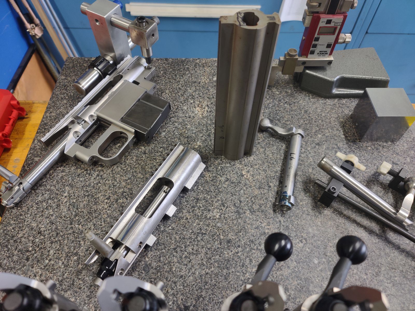

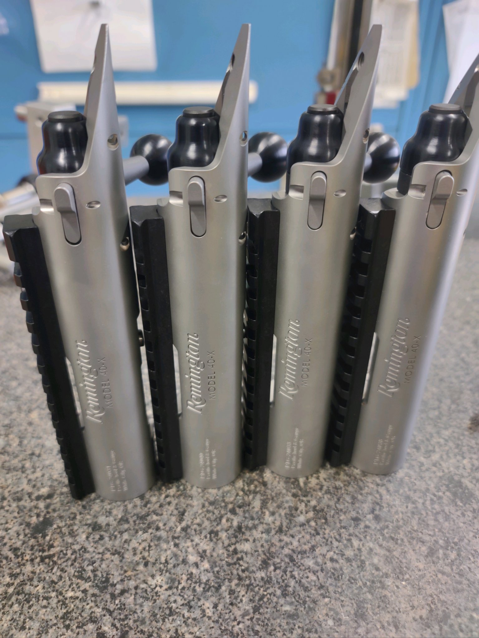

I received the very first PTG 40x repeater action from Dave several months ago. I checked it all out and it was actually true in all dimensions that i could measure. within .0003 anyway. I had some issues with the extractors on my particular action but i had some that ended up working properly in my parts bin. After the extractors were replaced i had some issues with feeding from vudoo magazines. I was under the impression from Dave that a proprietary magazine system was in the works? Perhaps not? I got busy and never did follow up much with Dave. I ended up putting the rifle away to visit another day. I didn't try the Bergara magazines and i appreciate whoever shared this info above. I have a couple in the shop at the moment so ill give them a go. I chambered a shilen ratchet for mine and it did shoot well. Pin strike looked good, location and depth. Ill follow up once i try these Bergara magazines.
