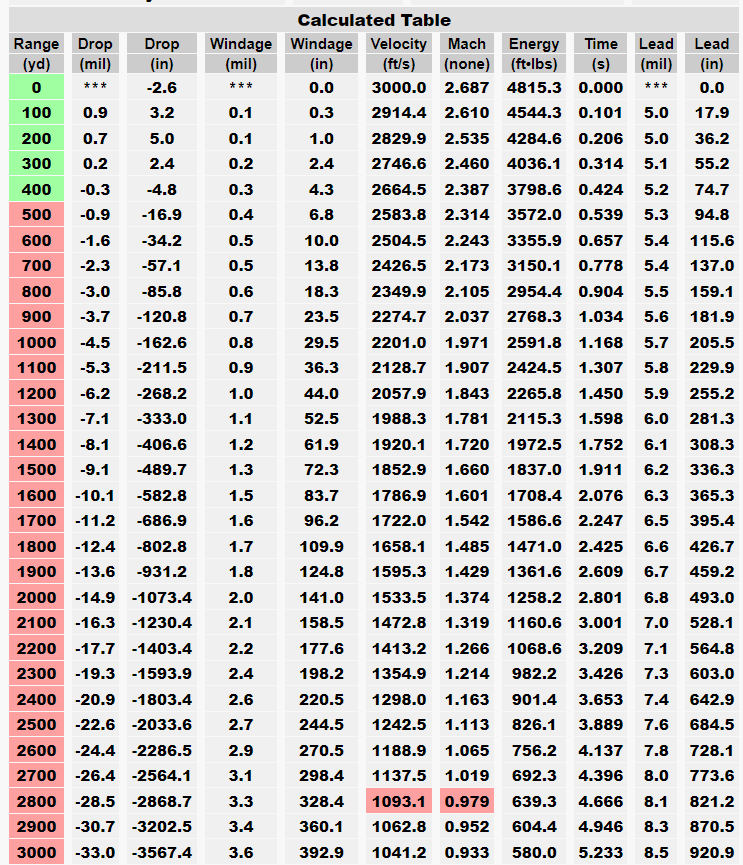

I'm finalizing a .300NM load with the 212s and expect to test them at distance next month. So far I'm really impressed. But then I noticed there's a 241gr that requires at least a 1:7 twist and when I crunched some numbers and it looks like it wouldn't be hard to get those up to 3000fps, I'm thinking it's time to order a faster barrel.
Supersonic @ 250' AGL out to 2800 yards is bonkers!

I know someone who is shooting the 198 Seneca at 3100 through a 300 Norma (not pushing at all) and said bc is just about spot on out to 1k so far.
So it’s seems the PVA bc is pretty good
