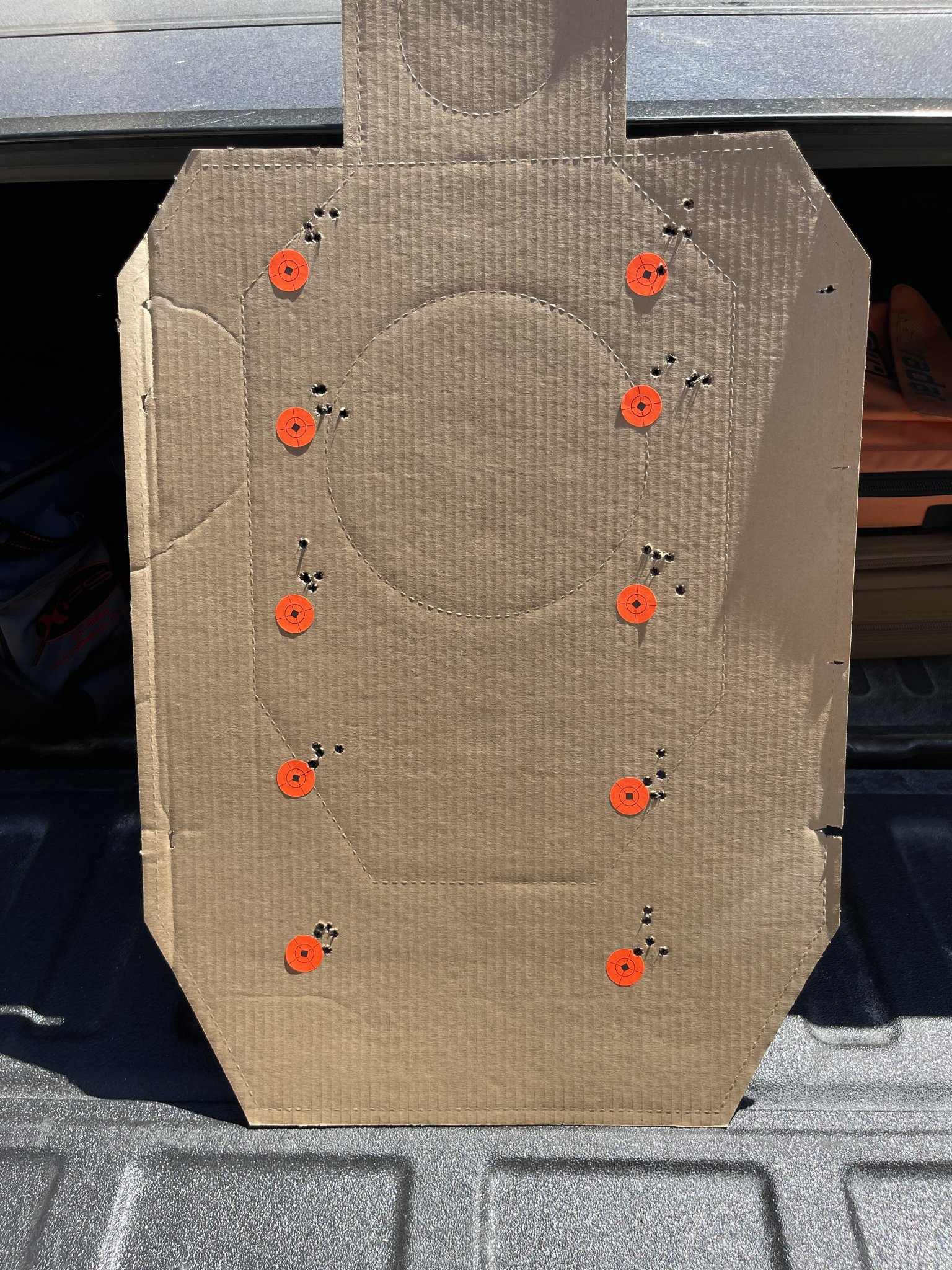

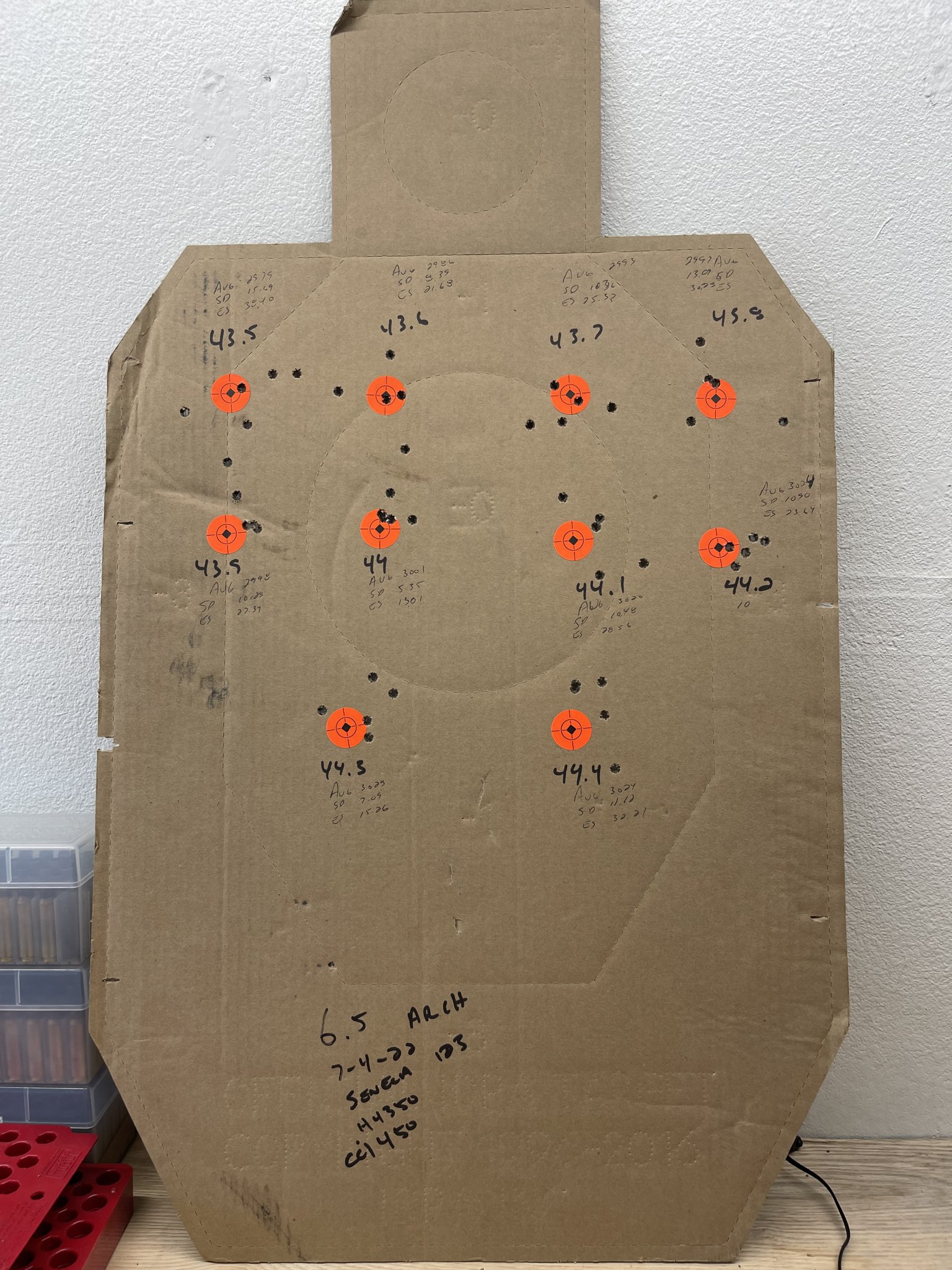

    43.5 - 44.4 Loads
    Longest load 2.952 on the top left Column best group of 2.917 at bottom of left column and shortest load on the bottom of the right column.

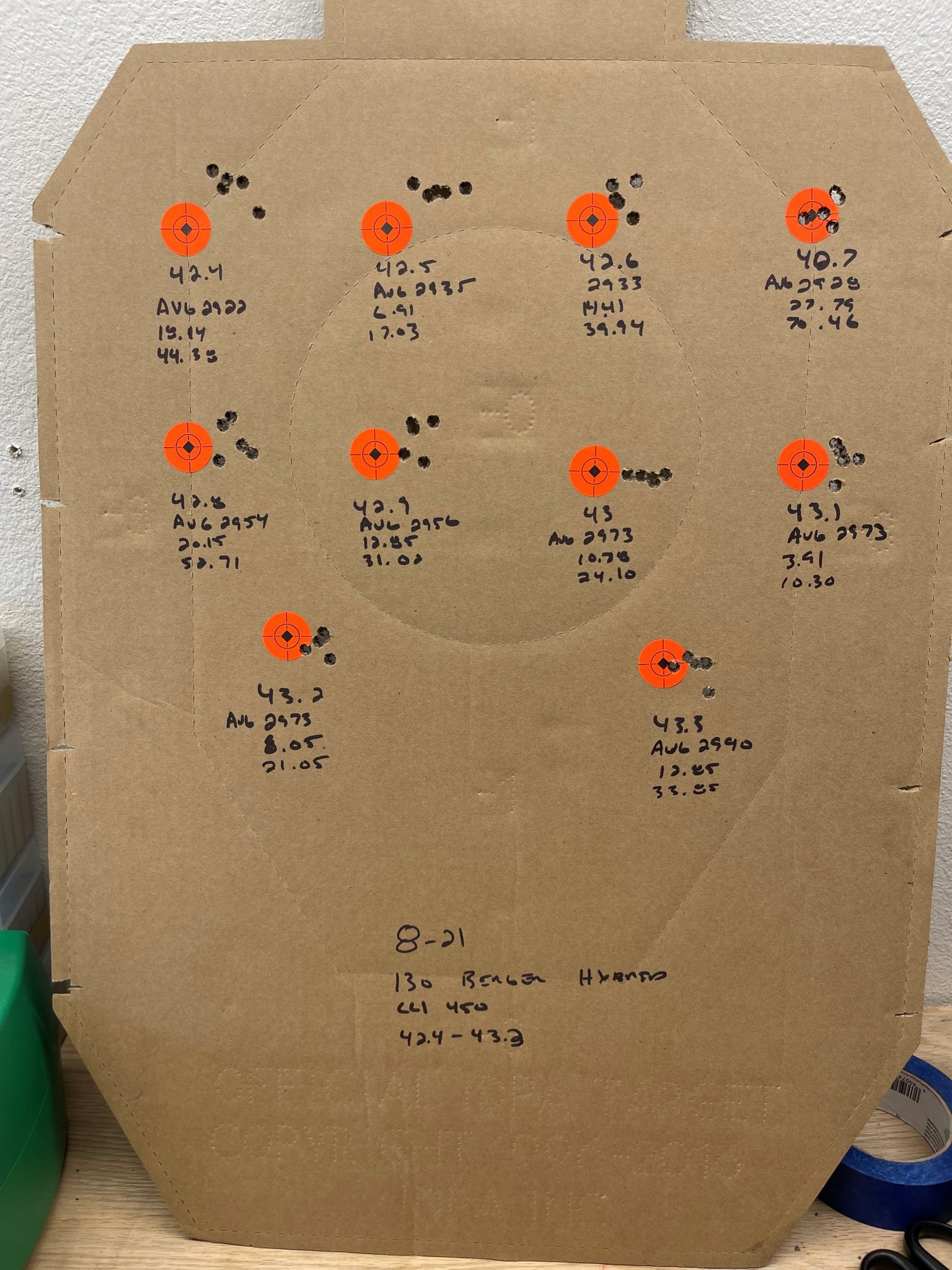

    Finally got out and tested the Berger 130 OTM.
    As you will see from the target below the Berger's are way more consistent for shooting out of a standard length AICS Magazine. The barrel is way more forgiving to the cup and core projectiles over the solids in charge weight as well.
    The largest group on this target might be 1.375" with the smallest being .5-something".
    For the Seneca's I fire formed all of my brass before starting my load development and for the Berger's i did not. Berger's still out preformed them from a group size stand point.

    I will be doing a bullet seating depth test shortly and will post the results of that as well. Which charge weight do you think should do it with?
    I'd go with 43.1, I'm assuming that's ES/SD written on the target. 43.1 looks about as good as any other group and the SD/ES and groups .1 grain higher and lower at 43.0 and 43.2 are also good.

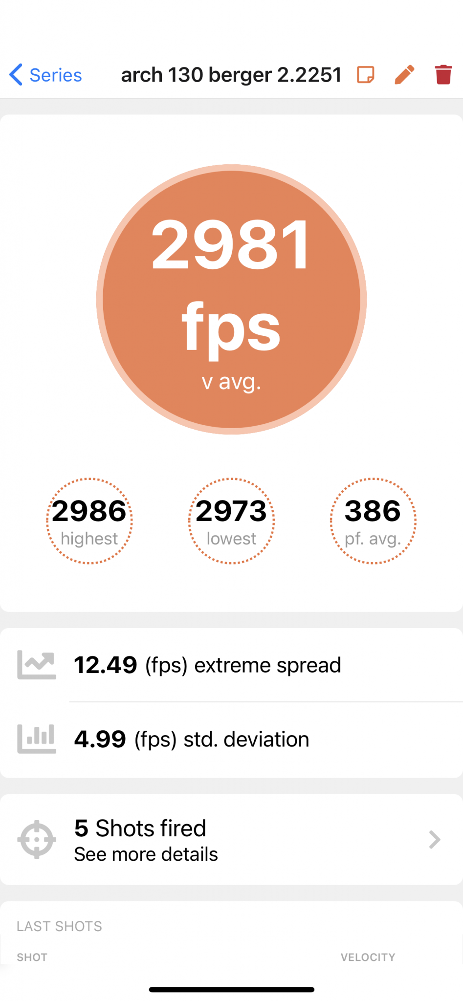

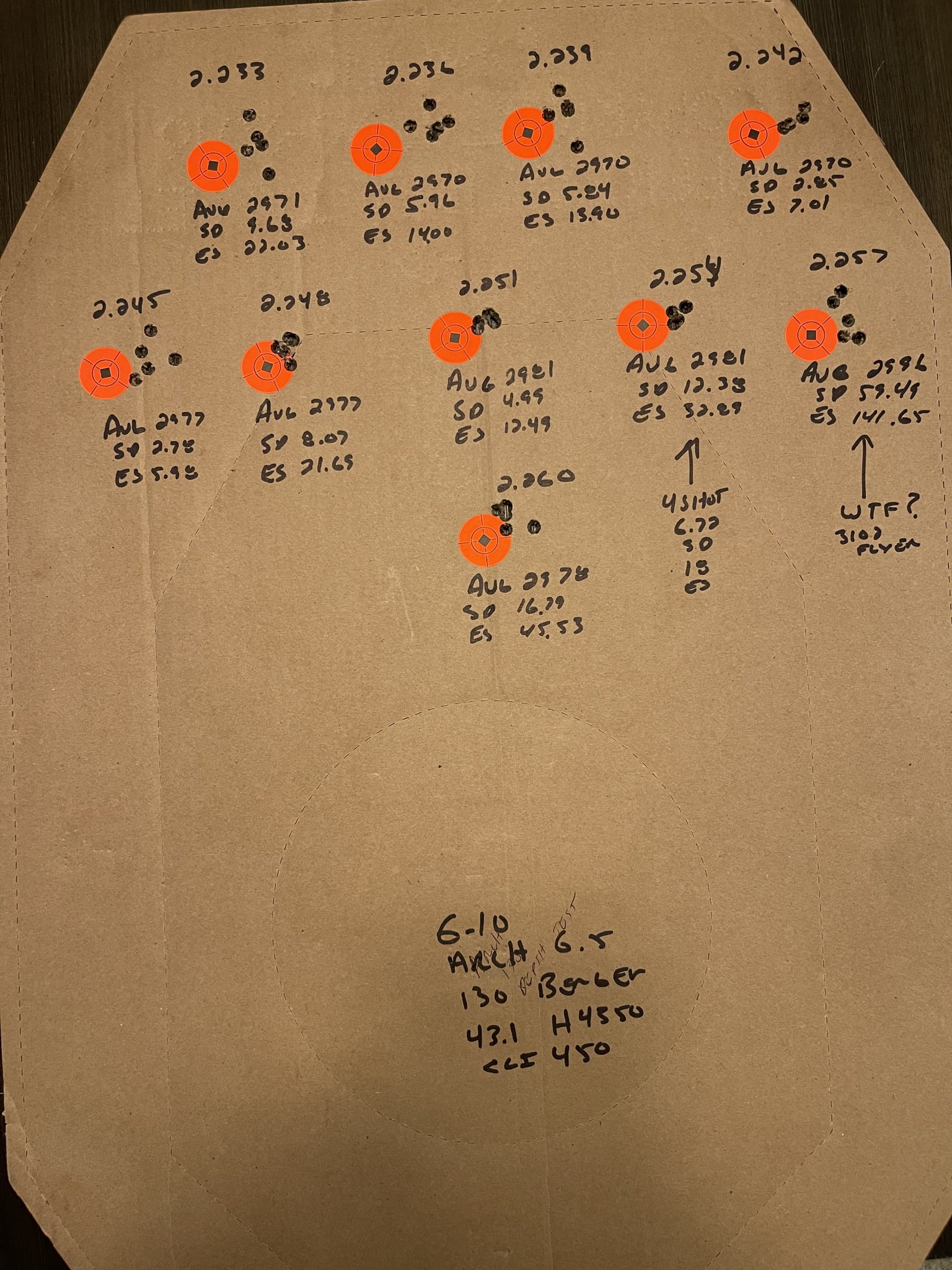

    Between work and IDPA matches I finally got a chance to do a seating depth test on the bergers and the result were pretty good.
    I’m going to load 25 of two of these lengths (2.251” & 2.254”) and chrono them in a one big sample to see what the stats are and then I’m done done!!!
    This PVA Osprey barrel is the shit. I can’t say enough good things about it.
    Here are the total test results and some group sizes.
    I’m going to lower the pull weight on my Triggertech trigger from 1.5lb to 1lb for this next test. I’ll keep everyone update of those results.
    Thank you to America Rifle Co., PVA, Foundation stocks, and Trigger Tech for this awesome combo!!
