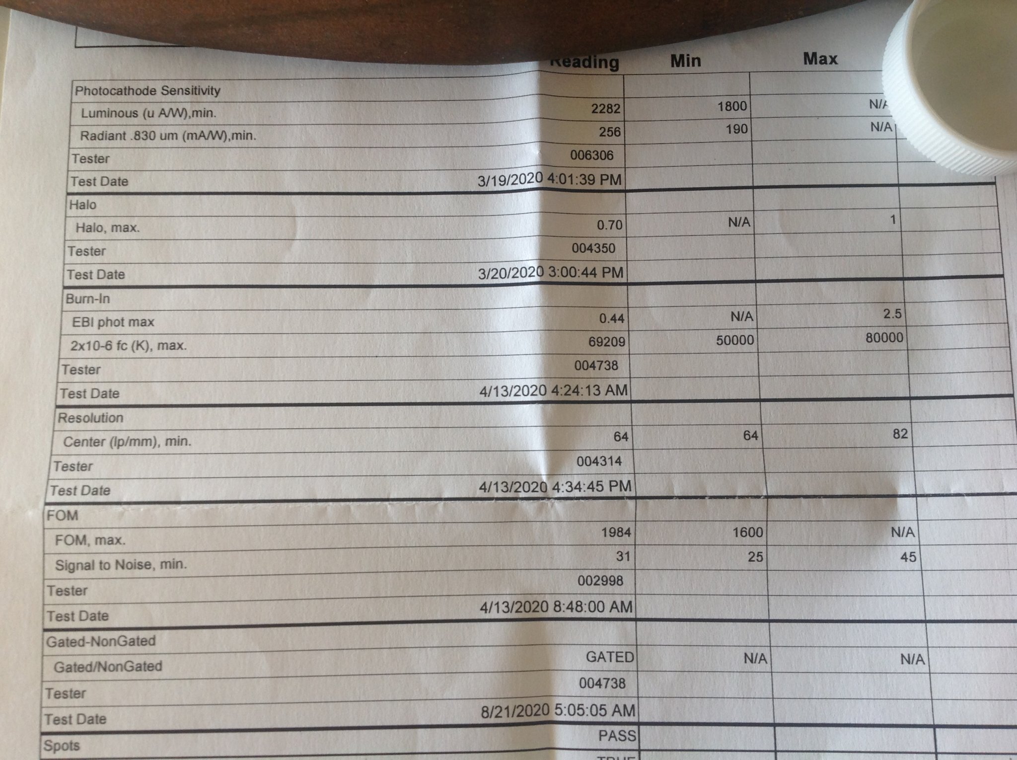

Just purchased a new setup from USnightvision. I had asked for help on another forum finding something fast because of the uncertainty going on right now and was pointed in the direction of white phosphorus. I would have asked here but had forgotten thismforum even existed, (SORRY). I'm vaguely familiar with pvs14 and thermal in general but just enough that I may have spent more money than I should have. I would have went with the setup Steve in 29 went with but they were 90 days out and I was afraid to wait that long. I'll try and post the specs and see what you guys think. If I have posted anything I shouldn't please feel free to edit\remove.
I paid $3600 for this filmed unit. Steve Gibbons @usnightvision told me I was better off using the filmed unit as they last longer and that the us mil has stopped placing orders in general for the filmless units. I'm so new to all of this that I took his word and hopefully he's a straight shooter. Let me know how I did considering circumstances please. Thanks for the time and answers.

my question to you would be a, are you pleased with the tube when you look through it.
If so then give it a rest--if not then tell the seller.

Agreed and well said. As for the tube, it does have solid specs and hope the OP is happy with it.

BTW - that's a great tube. You'll be happy with it.

In answer to OP’s original question, what you got and what you paid are just fine. Nothing special, nothing horrible, just... fine.
Use it without getting hung up on specs. It’s a perfectly serviceable unit that should perform just fine for many years to come.
