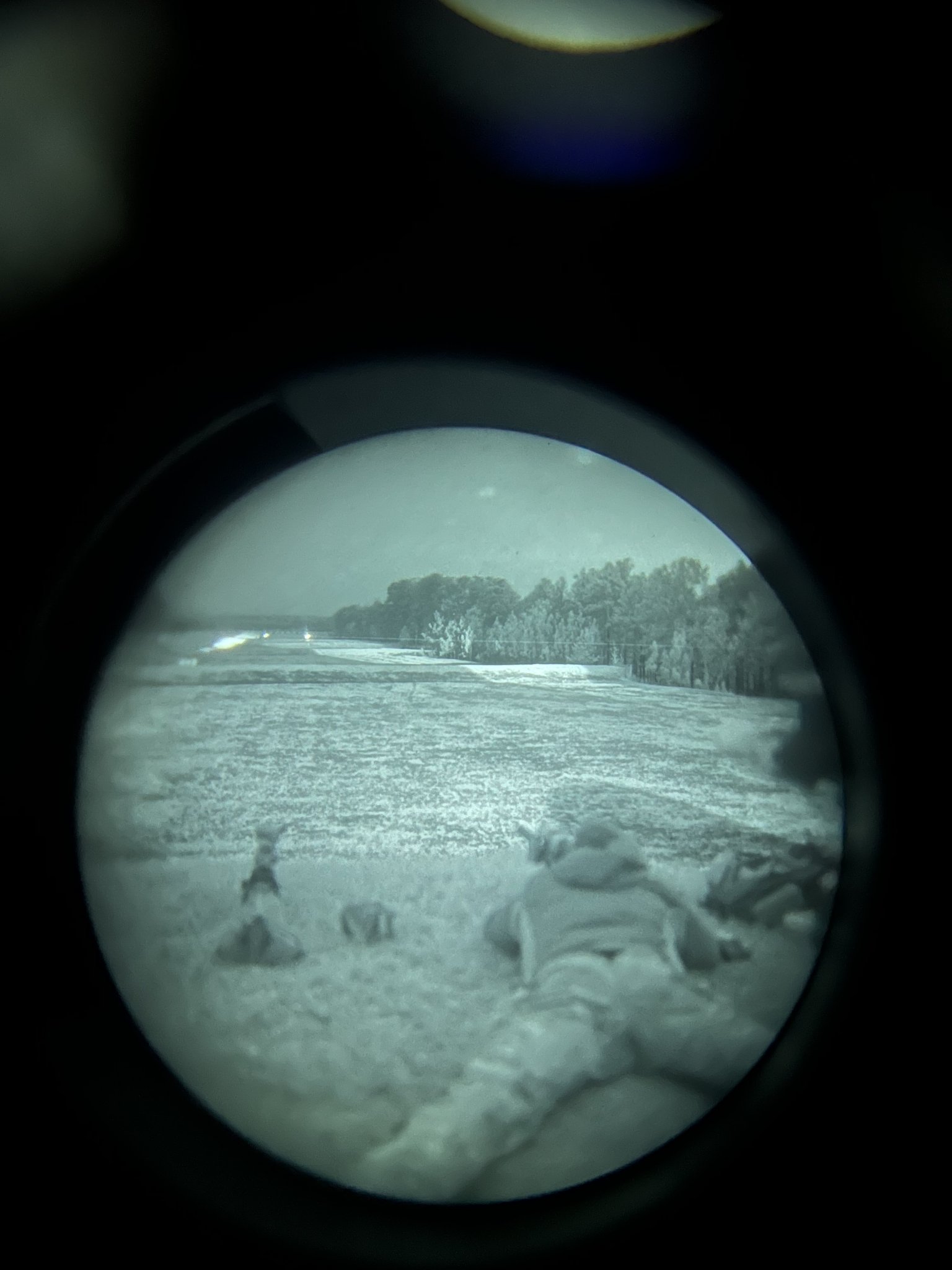

If you look in the top left of the nods pic, you will see the illumination from their IR Hog light. It was this brand I believe.

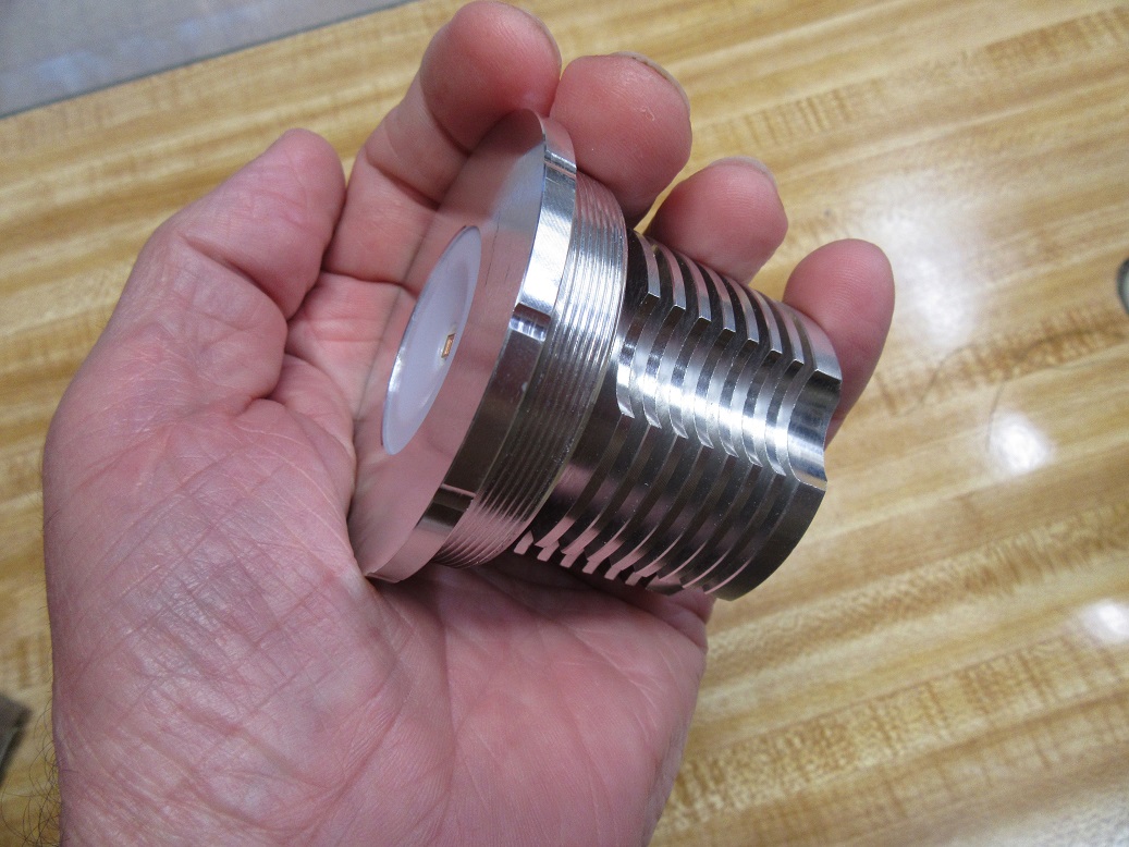

I don't think a lot of people have seen these. The Diode module that go's inside the 'coyote Canon' is friggin respectable for size and design, easy quick change-out also for, 850, 920, red, green .

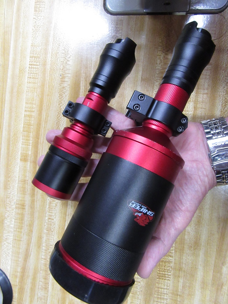

I did set-up mount that ( 38LRX ) 850nm light to check it out, and it actually is about the right size/weight and illum. power for for Pic. rail rifle mount . Size and weight are nice easy coat pocket carry also .
38LRX uses the 18650 rechargeable batteries that are pretty common found. I already pretty dialed with that battery use already with having Nightcore charger and batteries at the house.
It also has pretty easy change-out for switching different diode modules in the head . The Rheostat tail-switch does add extra length to the unit, but still it pretty tight package. and I can't see a person not using a rheostat for this kind of illum set-up, over just a On/Off tail-cap button.
Was a pretty low cloud ceiling and dark last night. I checked it out pretty good with PVS14 and a NV Scope on the rifle . It throws both a pretty intense Flood or tight Collimation beam. I had ZERO problems Illum. objects out 300 to 400 yard last night. Reality is all my dog shots are all inside 200 yrd. I did not even have to crank-up the rheostat power to even illum. 200 yard. The 38lrx had a lot more illum. to give that I was not using.
So.. I going to say 38LRX is REAL Solid illum. unit for working 300 yard rifle shots with NV. that ( you can ) squeeze more yardage from depending on night shooting conditions.
sales Price-$ is pretty fair also for the quality construction you getting. Even with the extra's added like, 'turbo' diode, rheostat tail-switch, QD mount kit. I think it was delivered under180-$ .
here a quick Pic. for a comparison .
Both In the hand, The monster Coyote Canon, and smaller 38LRX unit.
