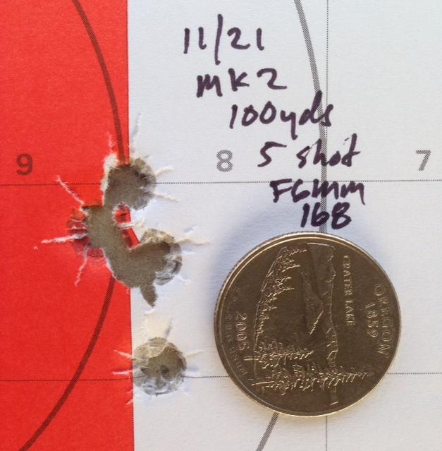

Today's best 5 shot group at 100yards, posted below:
I expect MOA groups on my next outing, with or without the Geissele!

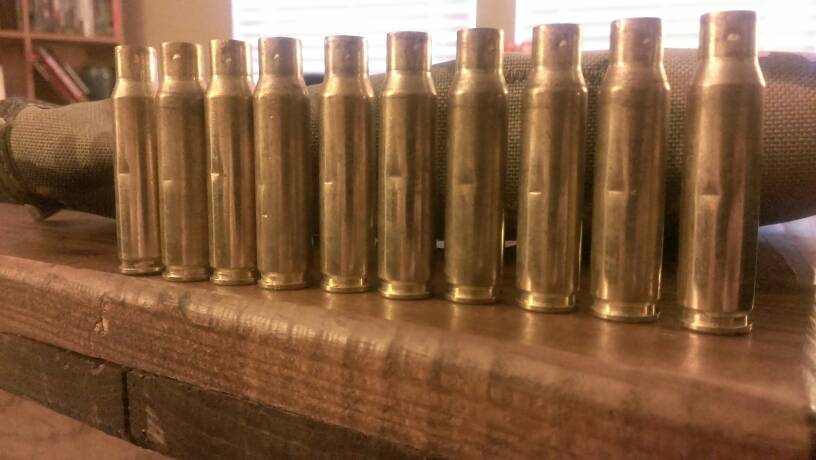

I also recently got a 216. I have only shot 50 rounds through it. It functioned great without any malfunctions. I also noticed it was hard on my brass. From what I have read a lot of semi auto 308's are hard on brass. Some suggested to clip a notch or two off the ejector spring, or adjust the gas block, or also put some velcro on the brass deflector to act as a cushion to the brass. I haven't tried any of those yet. It shoots great so I'm not to worried about it being hard on brass. It can still be reloaded.
I attached a picture of my spent brass.
