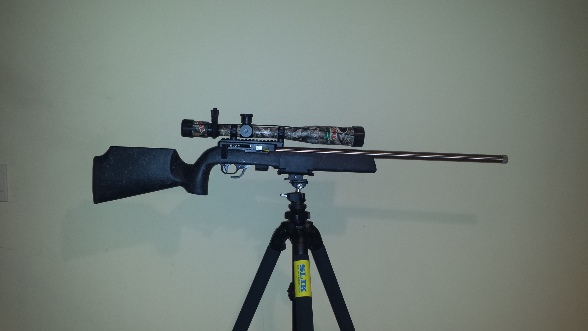

    Just want to share my VOLQUARTSEN SUMMIT WITH CUSTOM PACNOR SUPER MATCH BARREL AND PACNOR CUSTOM SUPER MATCH CHAMBER. I have only 65 rounds of it until this day.Shoot damn pretty good using wolf extra.Trigger custom from BS 1 lbs.

    Just want to share my VOLQUARTSEN SUMMIT WITH CUSTOM PACNOR SUPER MATCH BARREL AND PACNOR CUSOTM SUPER MATCH CHAMBER. I have only 65 rounds of it until this day.Shoot damn pretty good using wolf extra.Trigger custom from BS 1 lbs.
    That's a helluva rig! What stock is that? Looks serious.
    I'm leaning toward a biathlon/offhand stock for precision position shooting and a modest optic with enough adjustment to make good hits out to 200 yards.
    THANK YOU sir! the stock is BELL AND CARLSON Anschutz style. BTW this IS ALSO RECEIVER BARREL THREADED TOGETHER and bypass the VBLOCK.For stable shooting BY professional gunsmith work.Good luck.
