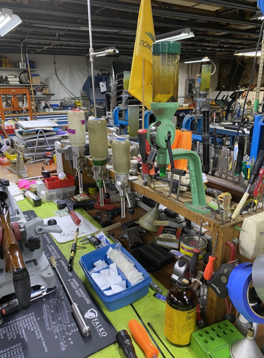

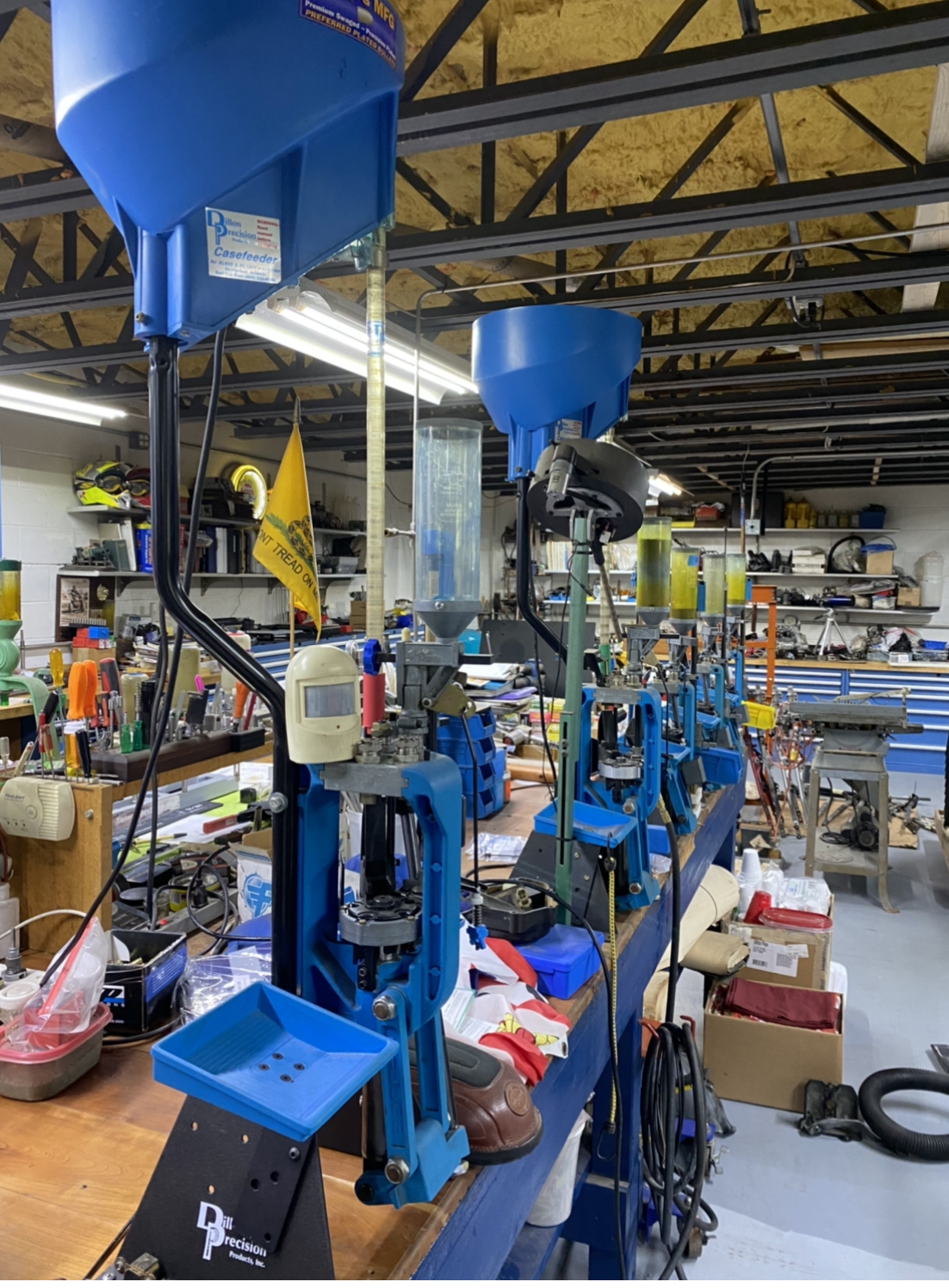

.......I must have pissed them off when I sent them these pics of my reloading room and told them that it's my faust as none of my equipment works well enough for their mini fix.
