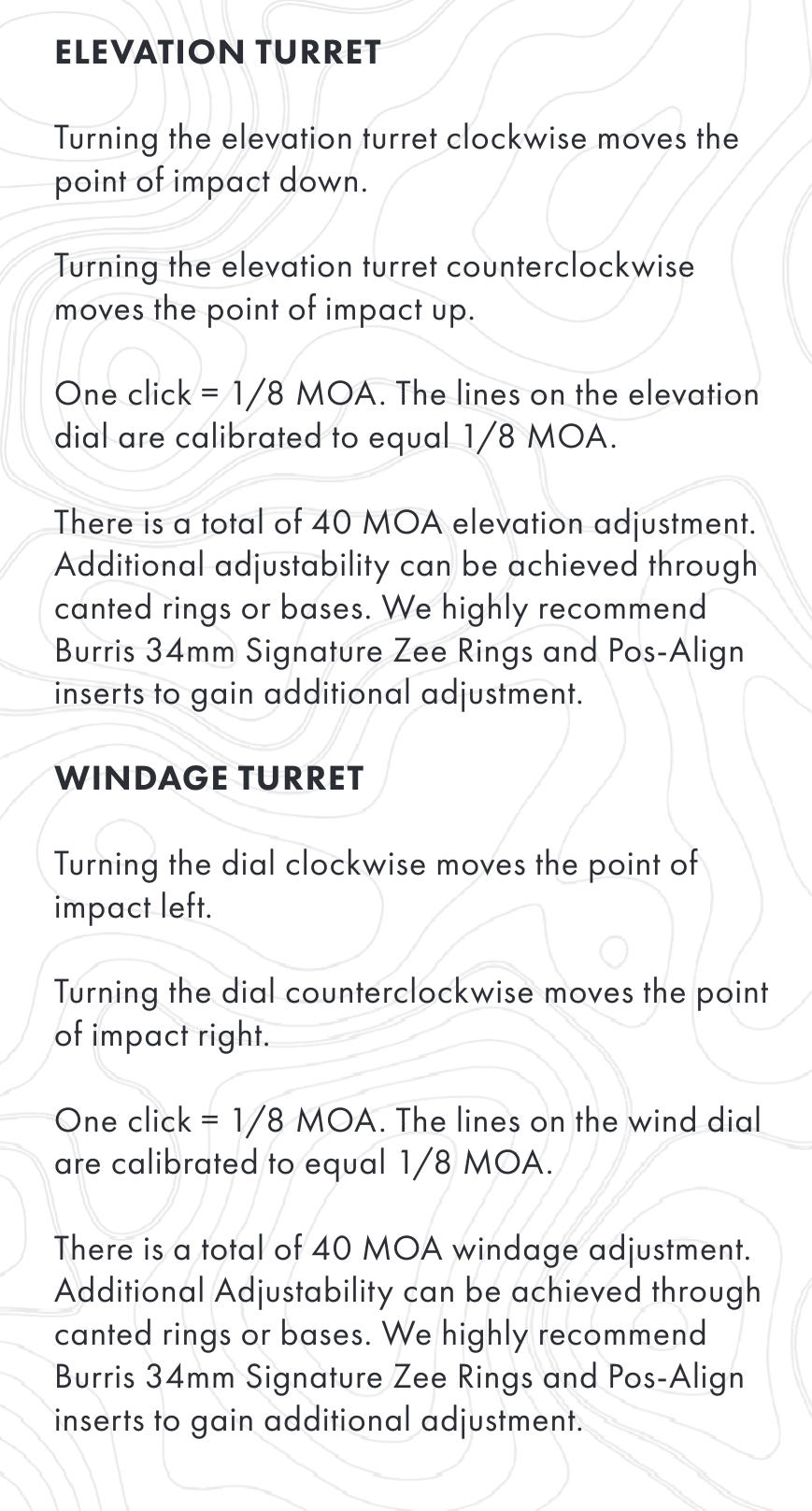

Does the Eliminator benefit from a rail mount that has 20, 40, 50 or 60 MOA inclination? For example, the Era-Tac adjustable inclination mount has 70 MOA, if I were to attach the Burris to the Era-Tac will that give me more elevation to shoot farther or does that only work for regular non-digital scopes?
The Burris E6 user manual says one can use canted bases, rails, or mounts with this scope on page 11:
Seems there is a disconnect between the Burris Eliminator 6 user manual (1/8 moa turret adjustments) and Burris' official Eliminator 6's youtube debut if you go to time 1:14 in this video which seems to say 177 clicks of 1/5 moa:
@koshkin determined it to be 1/6 moa, as above, so maybe he will clarify.
