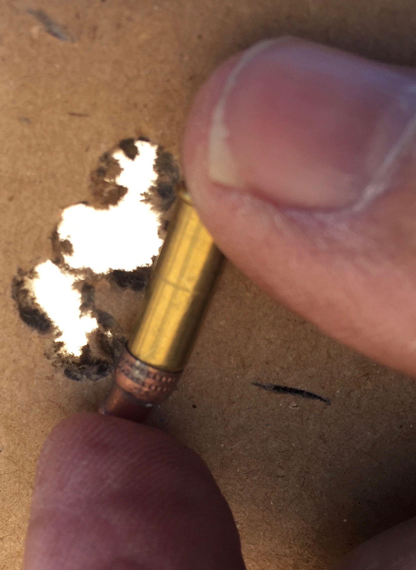

I've been struggling a bit myself with kind of this same thing lately: I've decided I like shooting long range enough that I can throw some money at it if I want to... I can afford to spend whatever I want (within reason), so a $4-5K rifle is on the menu if that's what I decide to do...
But, thing is, my lowly/cheap/starter rifle is shooting .3" at 100 and ~1" or so at 400yrds, and I've rung steel at 1000 (which is as far as I've gotten to go thus far)...
IMHO and from what I've experienced: buy a nicer stick if you want to, but past a certain point money-wise it's totally a diminishing-returns proposition.
