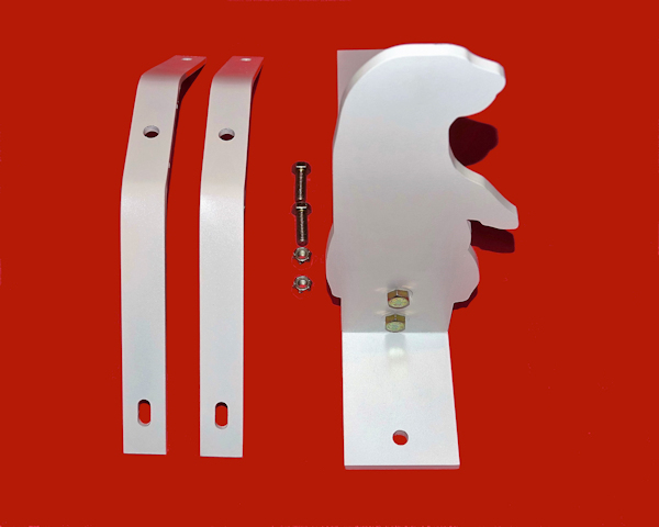

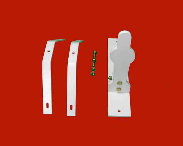

    I have different targets for different uses. I have a 1/2" thick AR500 popper with 4" dia. target, that we use for matches at 95-100 yards and it holds up very well. Except when hit by small rounds going over 3100 fps at that distance. Then it will dimple slightly or if hit on edge, will take a small divot off the edge. At 200-1000, 3/8" Ar500 works fine for everything including .338 LM and even .375 Cheytac. Sometimes I'll hang a 1/4" thick AR500 10" round target at 1000 to make it more sporty. That one really rings out. I prefer that nobody uses .375 CT or .50 on that one.
    The one thing to remember is that when it comes to shooting steel, speed kills. It's the speed of the projectile that makes the biggest difference and impact on your steel. There was a good article posted a year or so ago on the last version of SH that gave a good estimation for different speeds and what thickness AR steel was optimal at different distances and speeds. It looks like I didn't save that one or I'd post it up for you.
