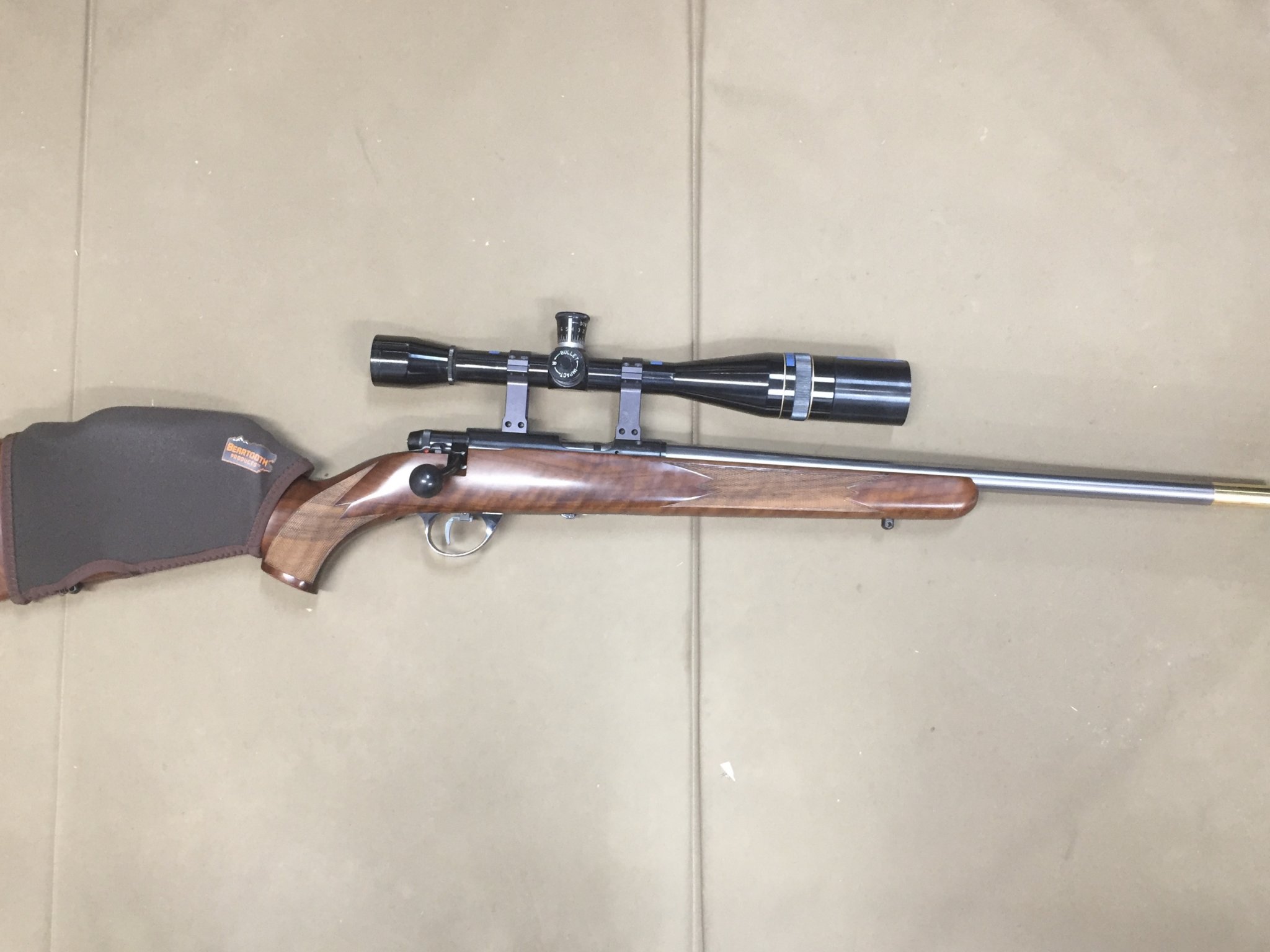

    22LR does not generating the amount of gas volume or heat to damage your chassis, this isn't .556 or larger where I have seen a short barrel ending under the hand guard actually damage the aluminum structure. Worst that is going to happen is a carbon residue mess. I get that on the inside of my barrel tuners, easy enough to clean out. A screw on muzzle device of some sort will alleviate this. I use a barrel diameter , 2.5" long brass thread protector on my 18" anschutz silo rifle with a .350 bore to give a little better balance to the front and protect the threads. I clean the carbon out of it once a season. In fact a piece of 1.5" roundstock 1/2-28 threaded brass in your barrel diameter couple inches long would give you that desired weight where you want it

    I roll my own, what exact diameter and how long do you want it? I’ll see what type of scrap I have laying around in the brass bin. You pay shipping. See thread protector on this 1712 that weighs in at a portly 8lb 6 oz all in.
