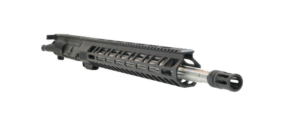

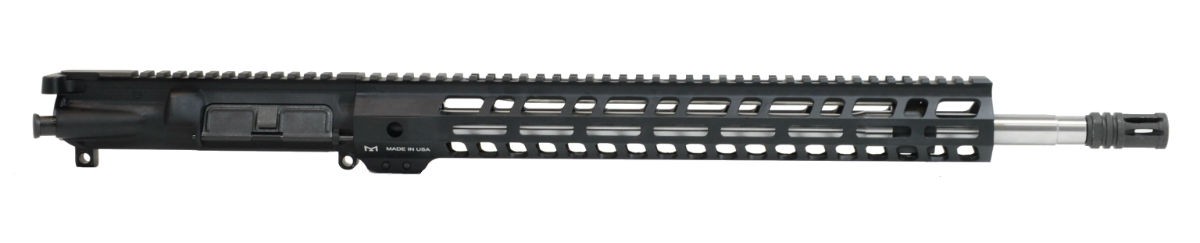

Here is the upper, went ahead and bought it for 359$ couldn't pass it up, if the barrel isn't up to snuff I'll replace it later but lots of reviews saying it shoots great. Almost looks like it's not an A2, PSA being what it is, all the details on the listing might not be 100% accurate.
