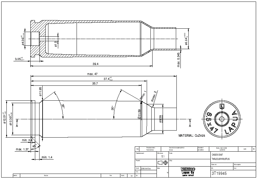

To see how much work a bushing can save your brass you need to measure.
Measure the neck wall thickness, double it and add the diameter of a bullet... or just measure a loaded round if you have one.
In this image it says that the the brass thickness is .345 mm (/25.4=)or .0136" thick.
.0136 x 2 for both sides of the neck is .02716 Plus a bullet of .264=.291" for a loaded rounds neck diameter using this images sample brass.
A normal die might size the fired neck down from .295 to .280 and then use the expander ball to open the neck up to .289. (That difference between the fully sized brass at .289 and the loaded diameter of .291 is .002" of neck tension which is what most people go for.) What a bushing does is allow you to avoid sizing the case necks down to .280 or where ever it actually ends up being and instead set them at .289 saving you .007" of work. You can also use a slightly smaller bushing of .287 or .288 and use the expander ball or a separate mandrel die to open them up to .289 if you have inconsistent neck wall thickness. The current dies could also give you exactly what you want, you just need to measure and see.

.289 loaded means your brass is .0125 thick, if you were to use brass that was only .008 thick you wouldnt be able to use the die because the case walls would be thinner than the amount of brass displacement so they would just sort of pass right through the forster and never get sized down far enough to grip a bullet.

With a .289 and your measurement compared to lapuas design chart I would recommend honing it to .286. Typically forster recommends .004 so that it works well with varying brass types and not perfectly even necks. So .004 under yours would be .285 so that the expander ball can open it back up by .002 to .287 (that’s only working it open .001 on each side of the neck but neck walls aren’t oerfectly even thickness so that makes the inside surface concentric instead of the outside of the neck) but with lapua saying that their brass is .013 thick yours is on the thin side so honing it to the thin side of spec at .003 under would seem safe enough. .285 of you really want to be safe.
