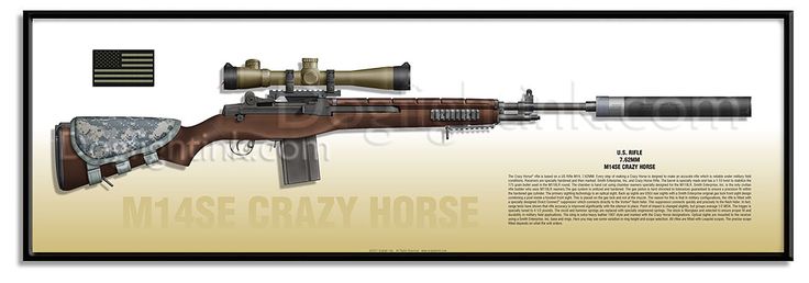

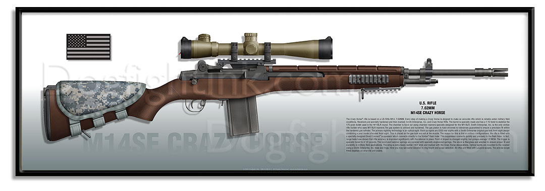

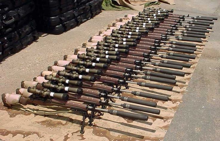

As for the M14 in the 200Xs, yes it was used by the USMC who had about 400 of the dedicated M14 DMRs made beginning in 2000, and many rack grade M14s were also pulled out of storage by the Army and accurized for DMR use as well in Afghanistan and Iraq, as both showed the need for an accurized rifle with a 600 to 800 meter effective range, which the standard 5.56mm cartridge can’t deliver.

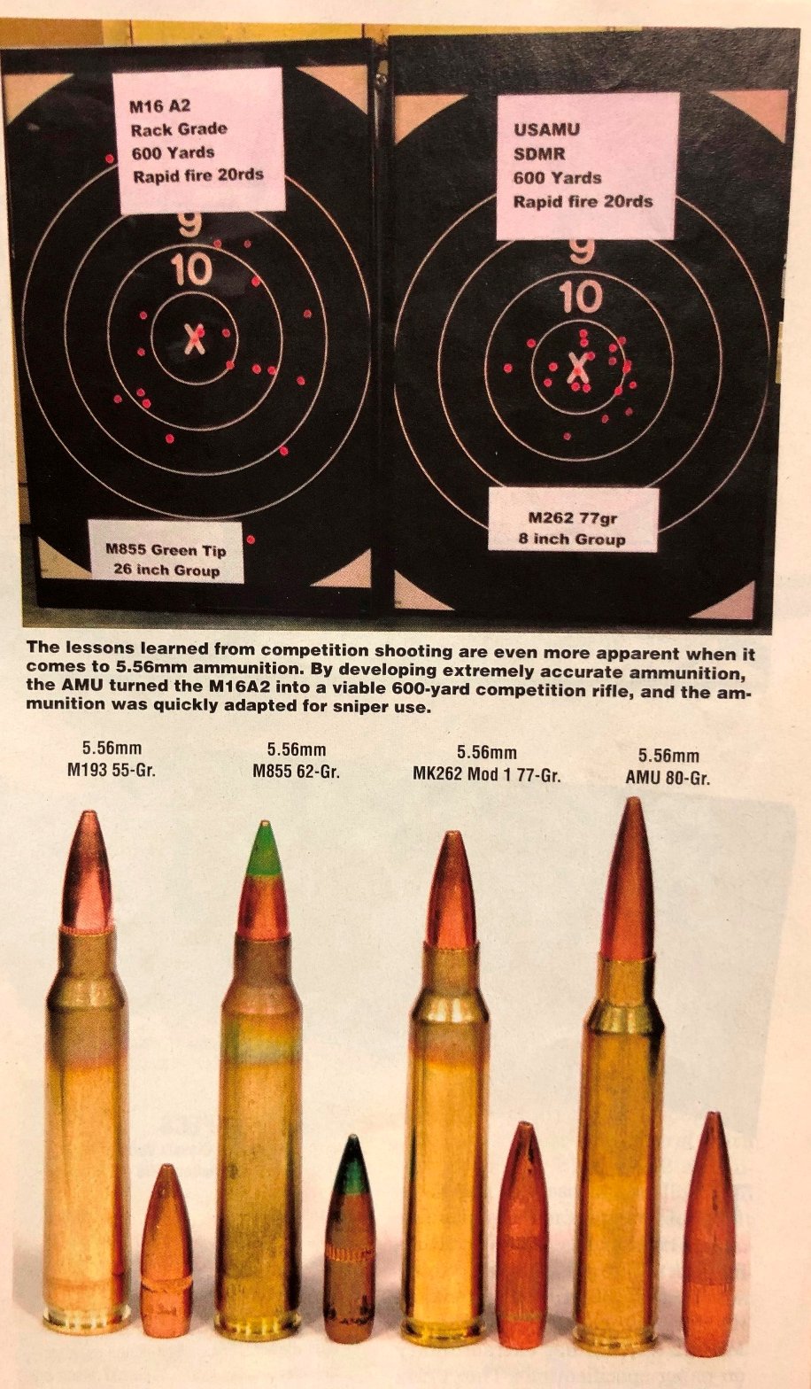

My understanding is that the SPR Mk 12 was developed in late 1990s bc the Sierra (and Nosler) 77grain low drag bullets made it possibly for the first time to design a viable M16-based DMR with the little 5.56mm round that could actually provide DMR type accuracy (~ 1 MOA) out to 600 yards, and also retain enough energy to be effective at 600 yds.
Considering that history, the concept of a Vietnam pattern M16 configured and actually used a ‘DMR’ rifle is strange in the historical context. It wasn’t until 30 plus years later that such a thing was officially fielded by the military (SPR Mk 12 and SAM-R type DMRs) along with the new Mk 262 ammo. My 2cts.

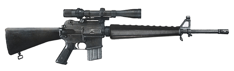

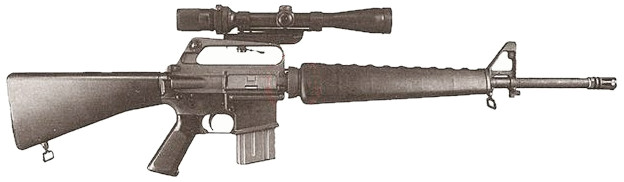

Coupla pics, both models roughly circa July through October 1967; used for US Army trials but never adopted. Note the XM16E1 lowers, heavier barrels, and A1 birdcages.
Colt Model 655:
Colt Model 656 Special Low Profile:

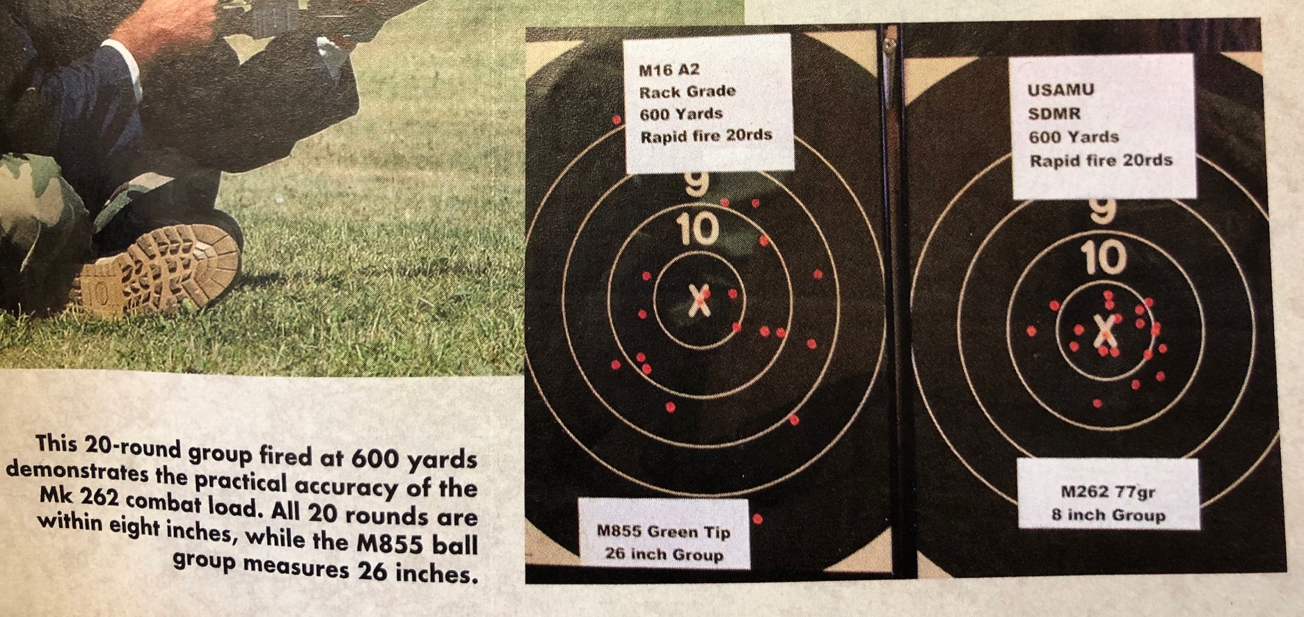

FWIW, the M16 and M16A1 are excellent accuracy platforms using M193 ammunition out to 500 yds. The Marines qualify with it and a ton of experts come out of the Corps. In 1982, the best instruction I ever got on the M16A1 rifle was from a former enlisted Marine, who went on to get his commission and become our S-2, who shot competition with the M16 using M193 ball. The rifle was quite capable, the mindset of leadership was not.
Reactions: Davo308
Well, I think I may have a different definition of "excellent accuracy" with respect to M193. One of the things that the USMC rifle team does is test different lots of ammo at Range 3 and esp Range 4 at Quantico, as not all Lake City ammo is created equally. The lots that shot the best out of certain platforms is set aside and that is what was used in competition.
(Back in the M14 days circa late 1980s/early 1990s, they tested the newly built National Match USMC M14s with Federal "Red Box" 168 BTHP ammo, and M852 ammo, and M118 ammo. The M14s that shot the "Red Box" ammo the best were set aside for the 'short line' at Camp Perry (ie, 200 yard competitions). Those that shot the M118 best were set aside for the 'long line' at Camp Perry (ie, 600 yard events). Specially modified 'Long Range' M14s were also made with modified gas systems that were designed for a specific 1000 yard competition shooting very heavy mojo ammo, etc.). Same type of ammo testing likely applies to today's NM M16 rifles that PWS builds.
However, in a combat environment one does not often get to chose which particular lot of ammo to use, and this is where the issue of being a Designated Marksman and M193 ammo comes into conflict, IMO. Here's my understanding of technical accuracy potential:
"U.S. military specifications for M193 Ball ammunition require a 55
grain bullet (q 2 grains) at a muzzle velocity of 3,250 q 40 fps from a 20
inch test barrel measured 15 feet from the muzzle. The accuracy requirement
from a test fixture calls for a maximum of a two inch mean radius at 200
yards from ten 10 shot groups (which equates to approximately three MOA).
"Statistically average" M193 ranges from 1.2 to 1.6 inches mean radius,
which is equivalent to 1.8 to 2.4 MOA
. Velocity from an M16 rifle or
pressure test barrel usually runs about 3,200 fps due to gas loss through
the port. Accuracy is typically around 2 to 2+ MOA from an M16A1 rifle at
ranges of 100 to 300 yards. M193 ammunition is suitable for use in 1 twist
in 12 inches or faster twists. While commercial sporting rifles in this
caliber usually have one in 14 rifling, the M193 boat tailed bullet is
barely stabilized with that rate of twist at ambient temperatures, and will
not stabilize at all when the air temperature drops below freezing.
"NATO specifications for SS109 (U.S. M855) Ball require a 61.7 grain
(q 1.5 grains) with a hardened steel penetrator at a velocity of 3,025 fps
(q 40 fps) from a 20 inch barrel 25 meters from the muzzle. Typical
velocity 15 feet from the M16A2's muzzle is around 3,100 fps. The accuracy
requirement from a test fixture equates to a maximum of approximately four
MOA over the 100 to 600 yard range
. Typical accuracy of average lots in an
M16A2 is about 2+ MOA
. This round must also penetrate a nominal 10 gauge
SAE 1010 or 1020 steel test plate at a range of at least 570 meters (623
yards). The M193 round will penetrate this same plate reliably at 400
yards, and about half the time at 500 yards. The 5.56mm and 7.62mm NATO
rounds will penetrate it reliably out to 700 yards or more.
Circa 2000, the USMC M14 DMR rifles were required to shoot 5 rds of M118 match ammo into a 3"x3" square at the 300 yard line from the test fixture shack at Quantico, VA. If the rifle could not provide 1 MOA accuracy for 5-rd groups, it was not issued to the fleet, but was returned to the PWS shop for re-work or maybe a re-barrel. I have not asked the old PWS guy the same question re their M16-based DMR black then, the SAM-R, but I believe it was also required to shoot 1 MOA in order to be issued in the Designated Marksman Role. In other words, my understanding is that 1 MOA with 5-rd groups at 300 yards is the technical requirement for a USMC DMR rifle. Any rifle/ammo combo that can't provide that level of precision is not issued to a Designated Marksman...per the guys who made them.
So, my understanding is that M193 ammo out of M16A1/A2/A4 simply won't provide 1-MOA level of accuracy that the Marines required for DMR rifles, at least not in the past 20 years, but I can't speak to pre-2000 era. In contrast, the original Mk 262 ammo spec is not easy to find, but reportedly requires it to hold ~ 1 MOA out to 300 meters. So, while M193 may be good enough to quality with (and most Marines are indeed excellent rifleman), but its technical design specifications - and actual tested performance - are simply not sufficient for use in a precision rifle deployed as a DMR rifle, at least for the past 20 years. (I think the same applied in Vietnam, more or less). The Mk 262 Mod 0 and Mod 1 was a game-changer re the M16's combat role and capabilities...(see attached AMU testing at 300 and 600 yards).
I hope that all made sense.... My 2cts.

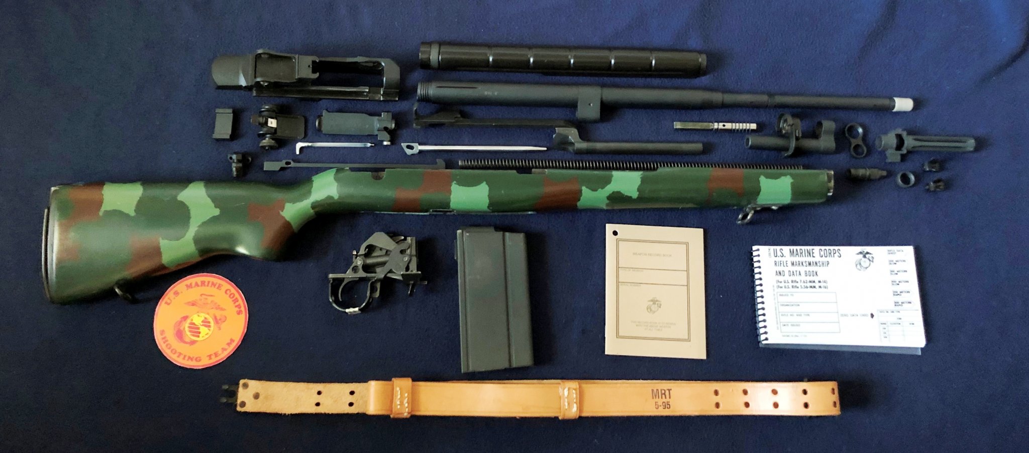

Here's my project. It's ready to be built in 2020, just needs the front lug. It will be a replica of the last of the USMC Match M14s...
Unfortunately I certainly will not be able to shoot such a rifle to its accuracy potential given my middle-aged eye sight, but I think it will be a neat replica build with a USMC take-off stock and various other take-off parts. Its sort of a 'Last of the Mohicans' kind of tribute build....

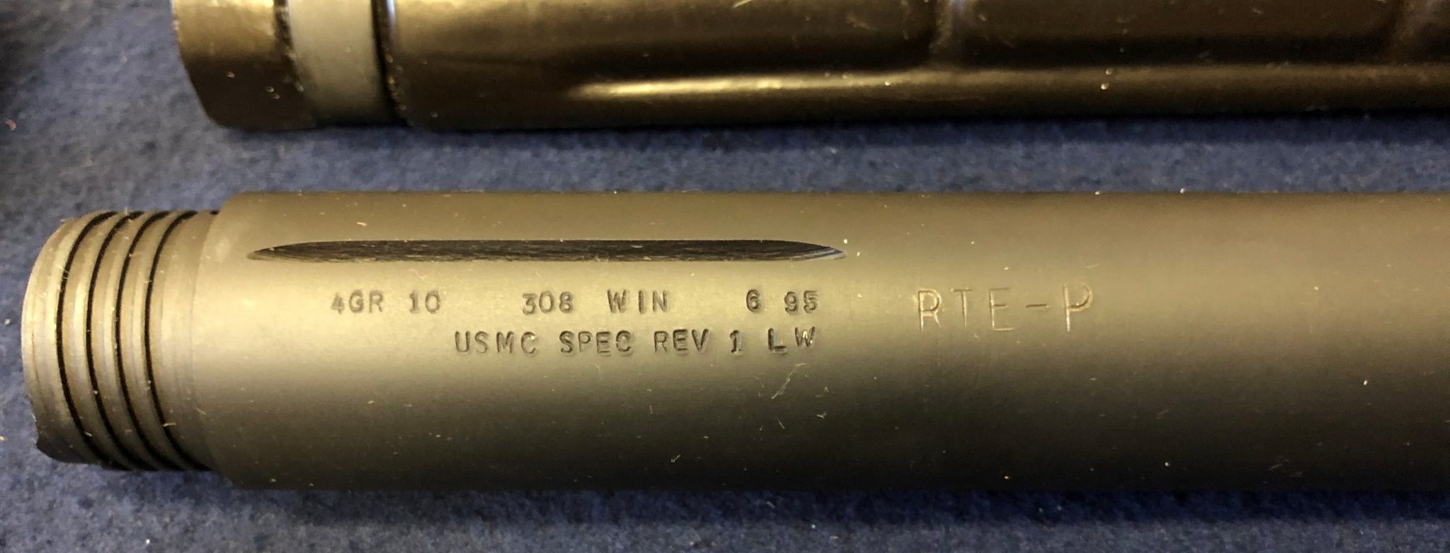

Some of the Barnett barrels on these USMC match rifles are dated 12/95, so I call them: 'The Last of the Mohican's', as the Marines reportedly migrated to NM M16s around that time.

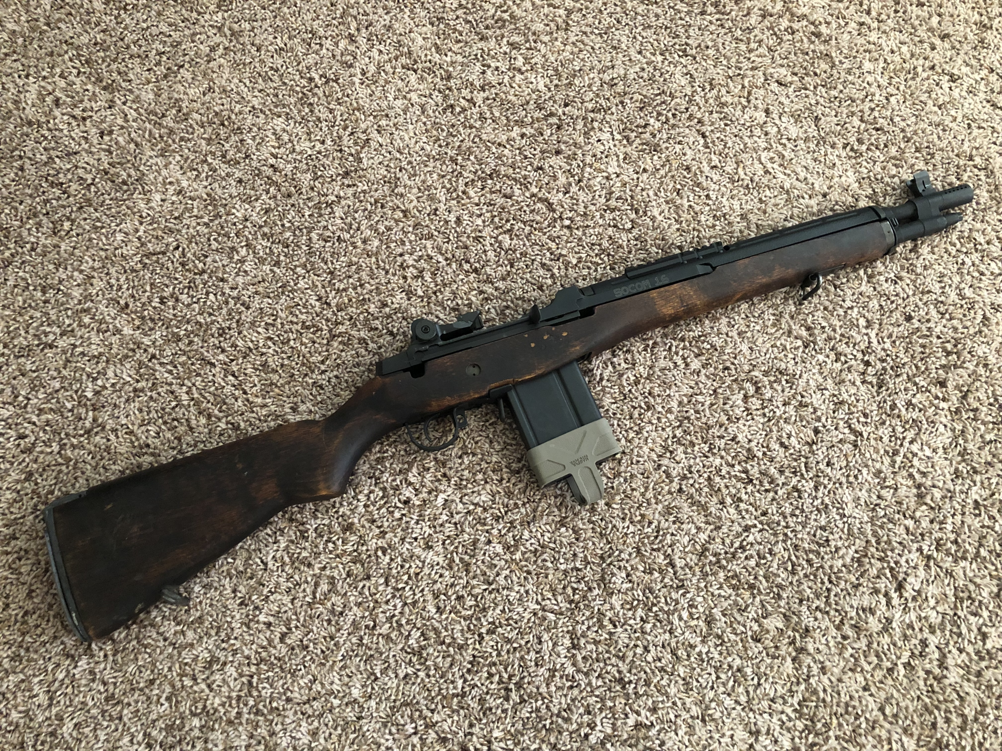

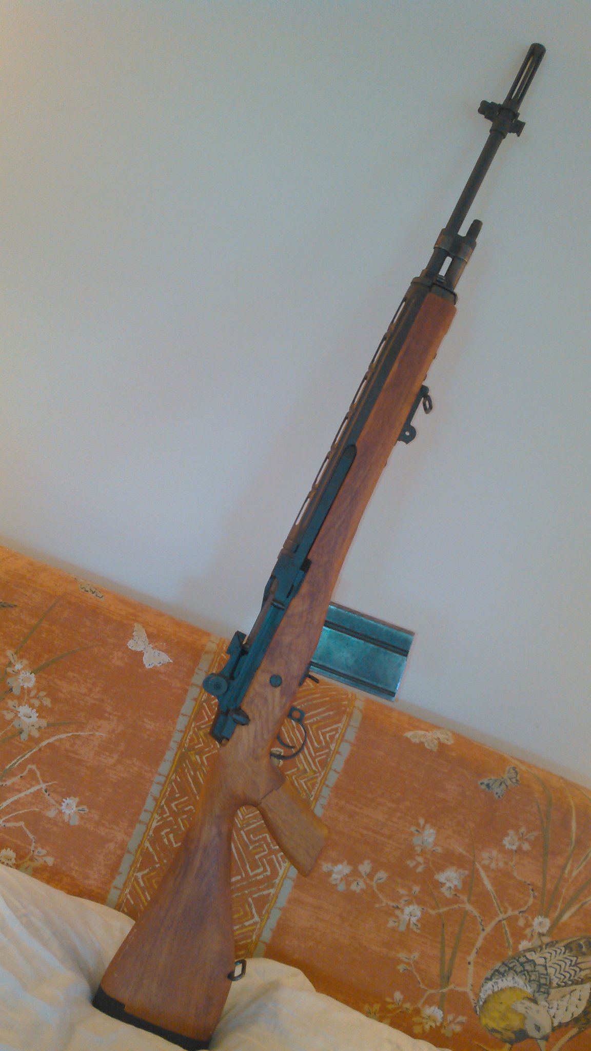

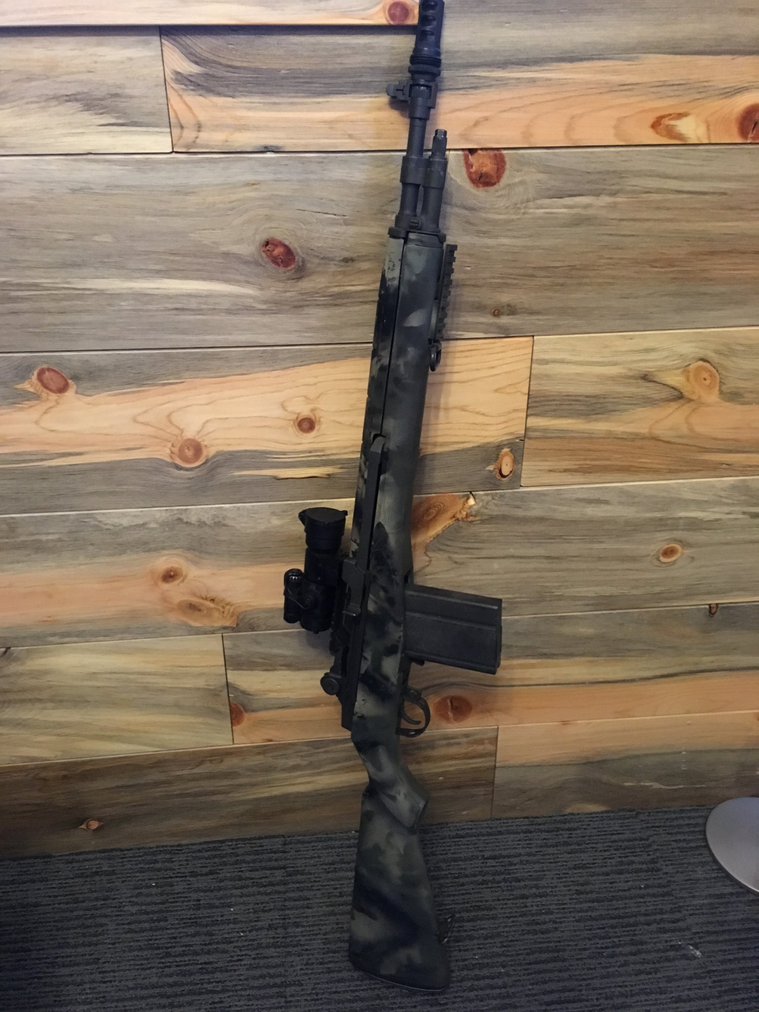

I bought an M21 for personal reasons. We used the M14s in the Navy and as a gunners mate I saw these rifles every day. My M21 doesnt have nearly the consistency of the modern AR10s, but Im not expecting it to.
Id love another M1a in my inventory. This time a shorty in an old wooden stock. Something about these M1a/M14/M21 models just looks so appealing to me. I guess thats why the old muscle cars never lose the nostalgia.
Pic I found on the net of a shorty that Id like to have one day
Reactions: PBWalsh and Davo308

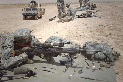

I think these were considered 1 to 2 MOA rifles with M118LR. I'm going to build a replica of one of these at some point.
This was basically a stopgap measure until the SAGE stock M14 EBRs were fielded in 2007-08 time period, although the EBR's lost the sound suppressor capability. Just a random fyi.
Any Idea what bullets were used and when? ADDED: RE-69's and 77's
That whole transformation in that period from light bullets to heavy bullets is fascinating.
I don't have the reference in front of me, but I think the 77gr SMK came out b/t 1990-1992. The US Army Marksmanship Training Unit did not think the lighter bullets were suitable for 600 yard matches until the 77 and 80 grain SMK bullets became available. I do know that the 80gr BTHP came out in 1992, and Sierra made it at specific request of the AMU team. They were called the "V8" load and allowed an M16A2 to compete at 600 yards, although it was a single-load only round. Black Hills won a small contract in 1996 to load that round for the AMU team.
The 77gr was the real game-changer as it could be loaded to magazine length, for both the M16A2 as a competition rifle, and ultimately about 10 years later as a DMR with the MK 262 ammo. I think the reign of the NM M14 pretty much ended when the 77gr bullet was effectively used by the AMU team around 1992-93-94 period. Maybe others know what specific year they came out? Attached is a brief history as outlined by Black Hills ammo.
